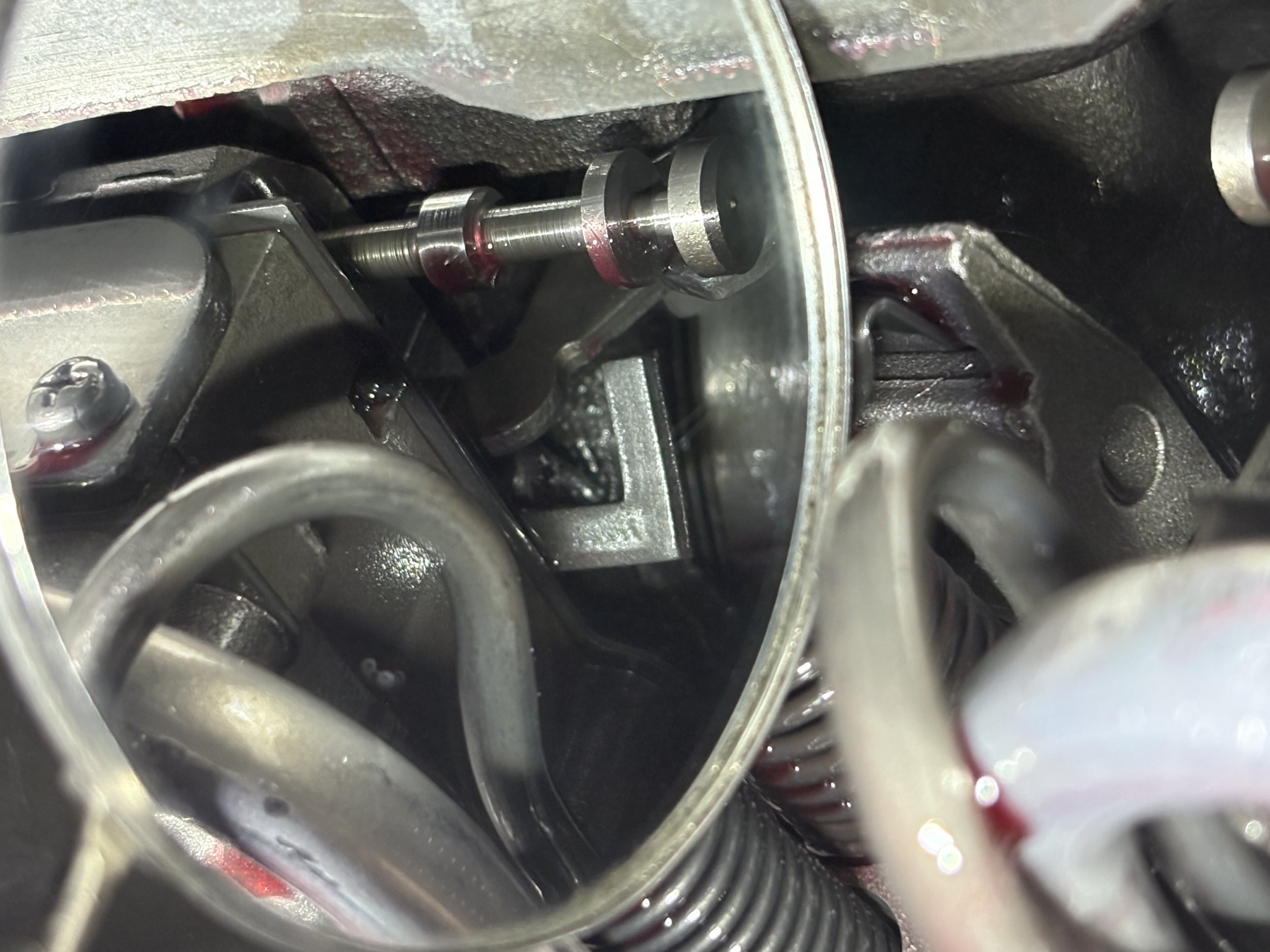

    Thank you, I've taken the linkage out of the equation and worked the kickdown lever on the trans by hand. According to the manual the kickdown valve is supposed to be depressed when putting on the valve body so that means there must be some tension on the lever that holds it in the upward position where the kickdown rod from the bellcrank attaches to the lever. Mine does not have any tension at all, you can push it up and it falls back down with gravity.
  19. Ryans65
    Joined: Apr 12, 2018
    Posts: 154
    Ryans65
    from Yulee FL
  20. Ryans65
    Posts: 154
    Ryans65
    from Yulee FL
    The kickdown valve is definitely stuck in its bore. I'm going to pull the valve body and see why, I'd imagine some junk from somewhere caught in the valve body. I'll keep you guys posted.

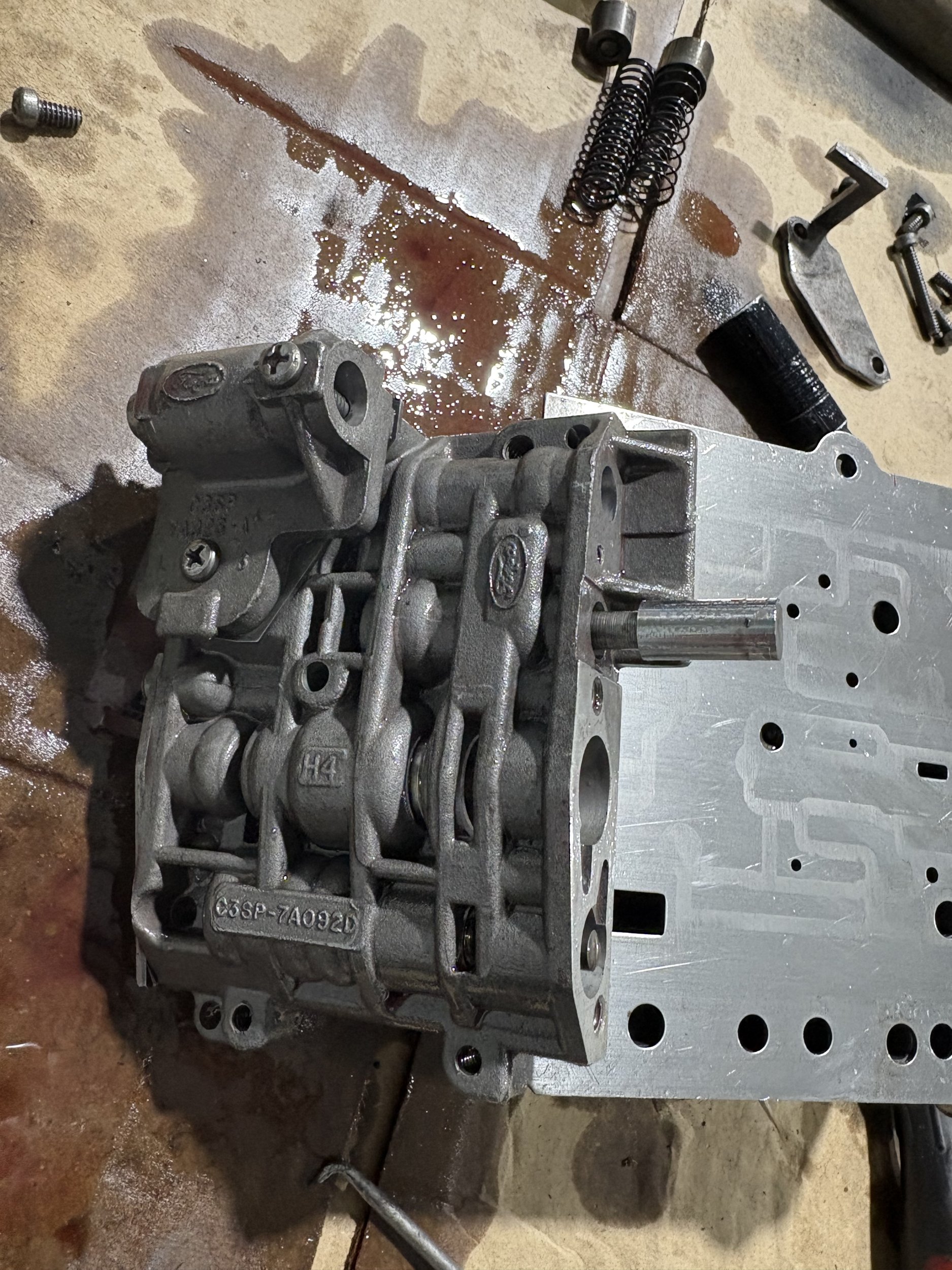

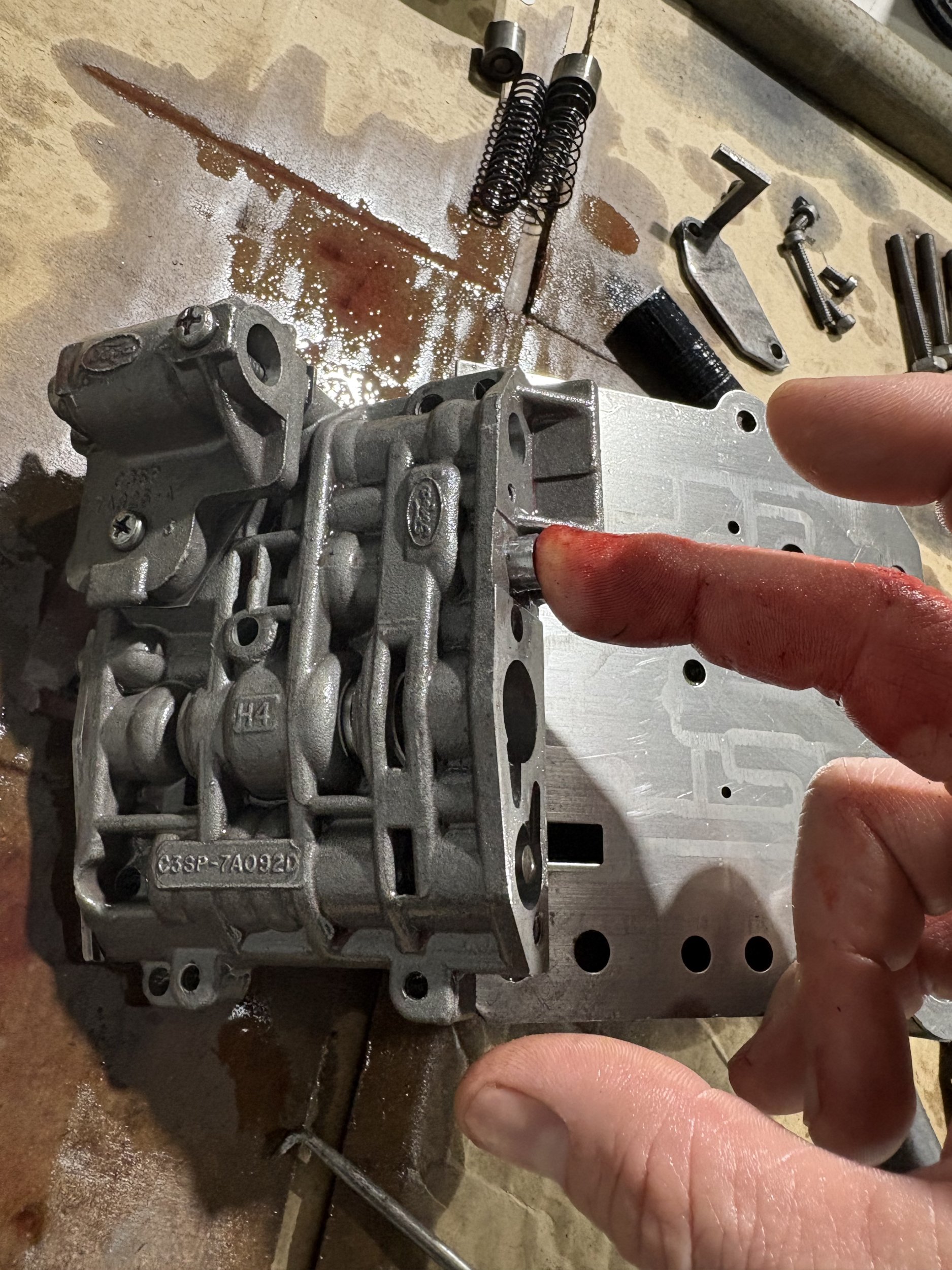

  26. Ryans65
    Posts: 154
    Ryans65
    from Yulee FL
    IMG_0624.png I ended up taking the whole valve body apart suspecting there was more crud in there somewhere but aside from a few tiny bits here and there it was surprisingly clean. I think whatever was stuck in the kickdown bore was leftover from the overhaul. I put it all back together, screwed the vacuum modulator back to where it was new and went for a drive. I now have really smooth 1/2 shifts around 15 mph at light throttle and 2/3 around 30-35ish. The kickdown works as it should and now with the right carb it's running and driving really really nice!
