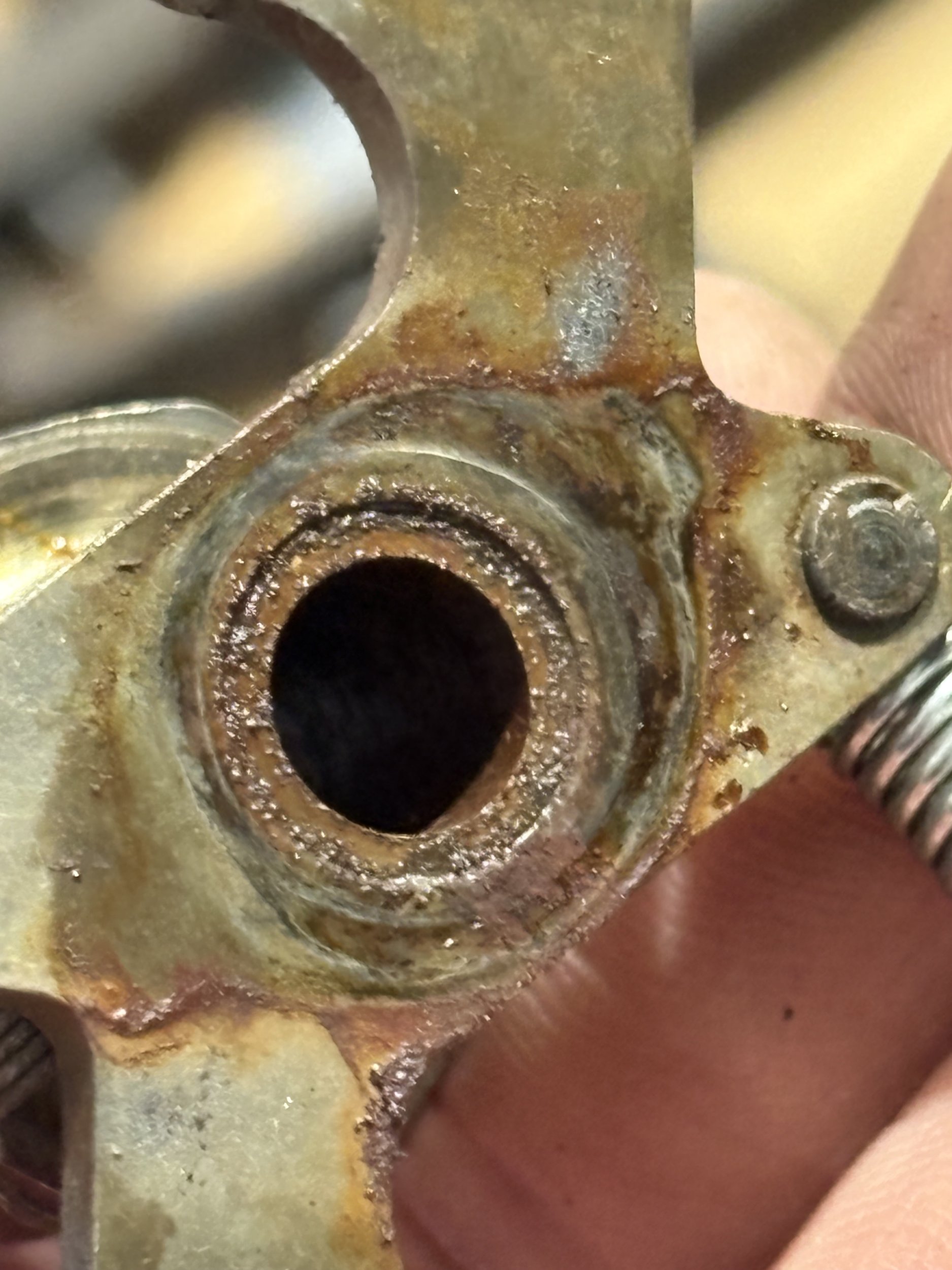

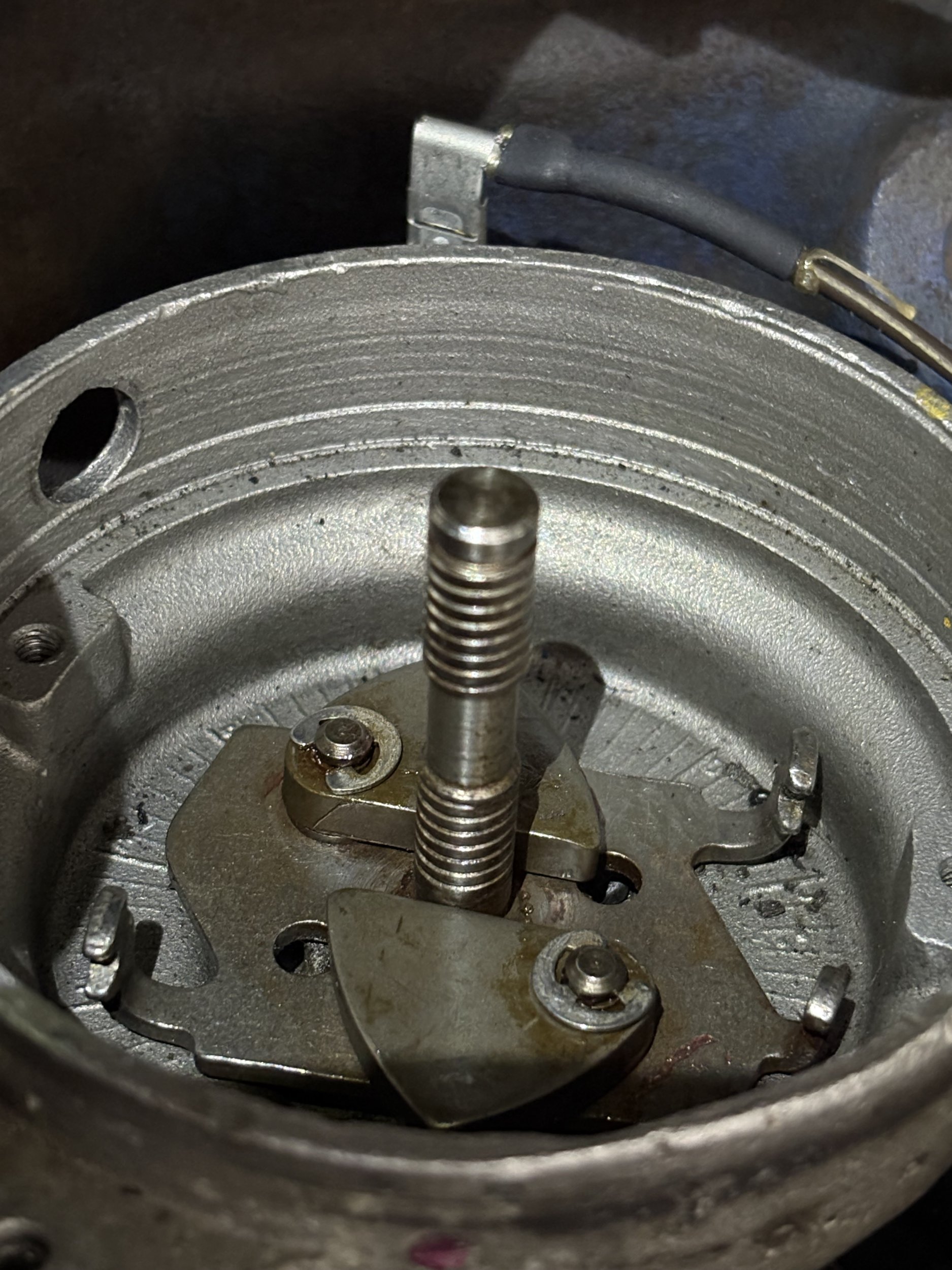

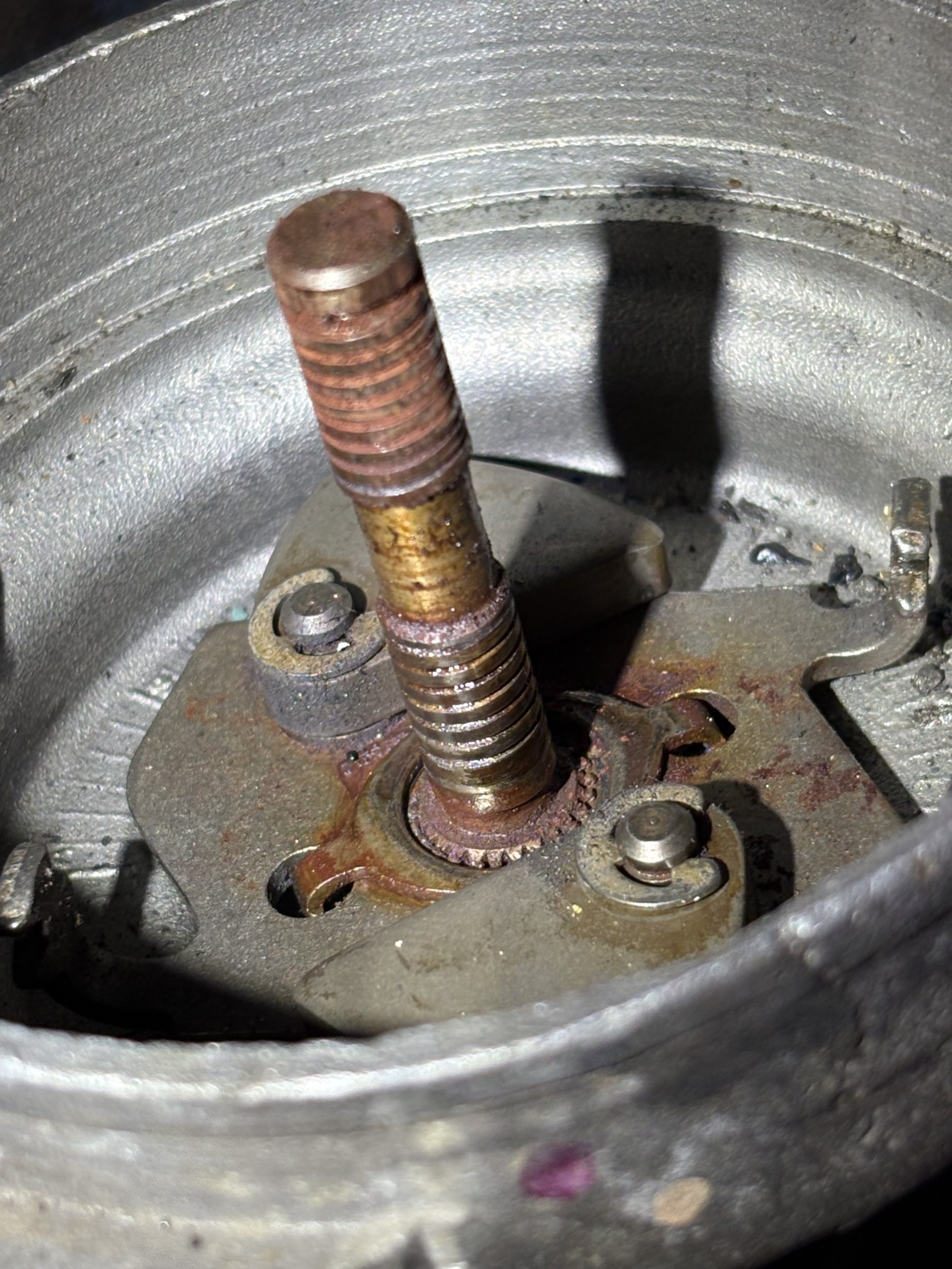

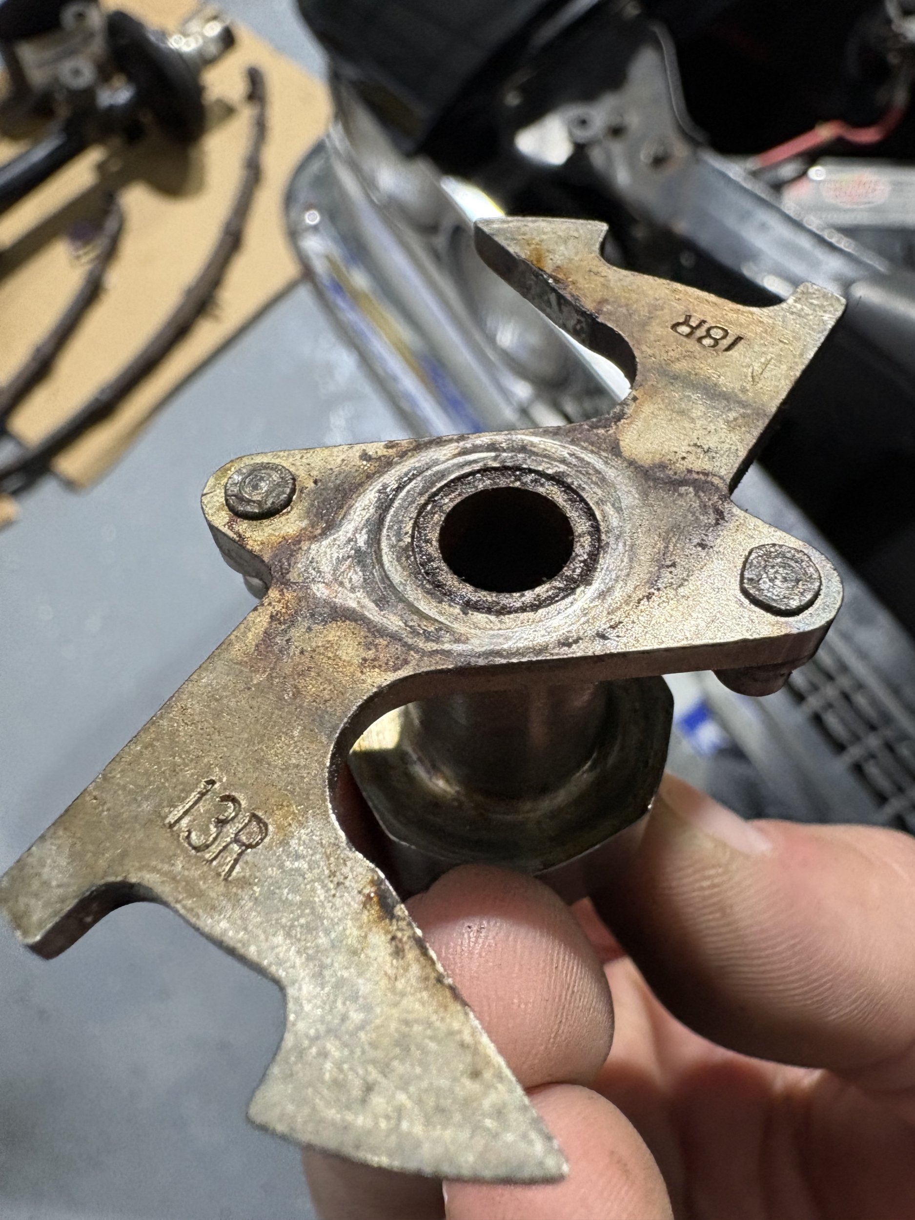

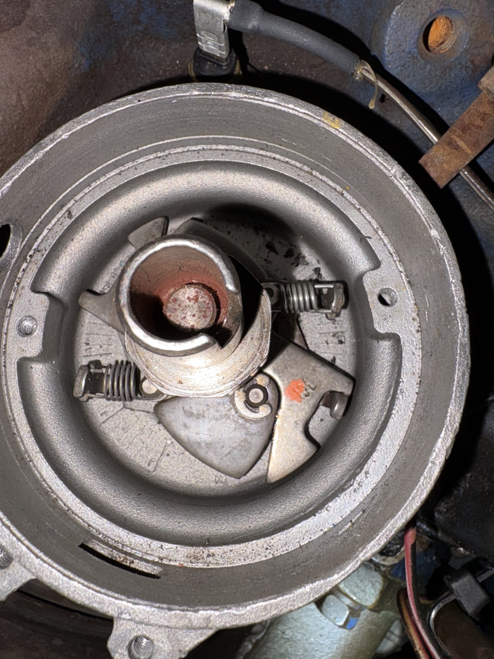

    No broken springs just appears to be lacking lubrication as evidenced by the rusty powder around the shaft. The little sponge thing was missing in the shaft as well so I know it hasn't seen a drop of oil in a long time! I'll get it cleaned tonight and check timing again. I think this is probably why the mechanical advance was hanging up.

  6. Oneball
    Joined: Jul 30, 2023
    Posts: 1,628
    Oneball

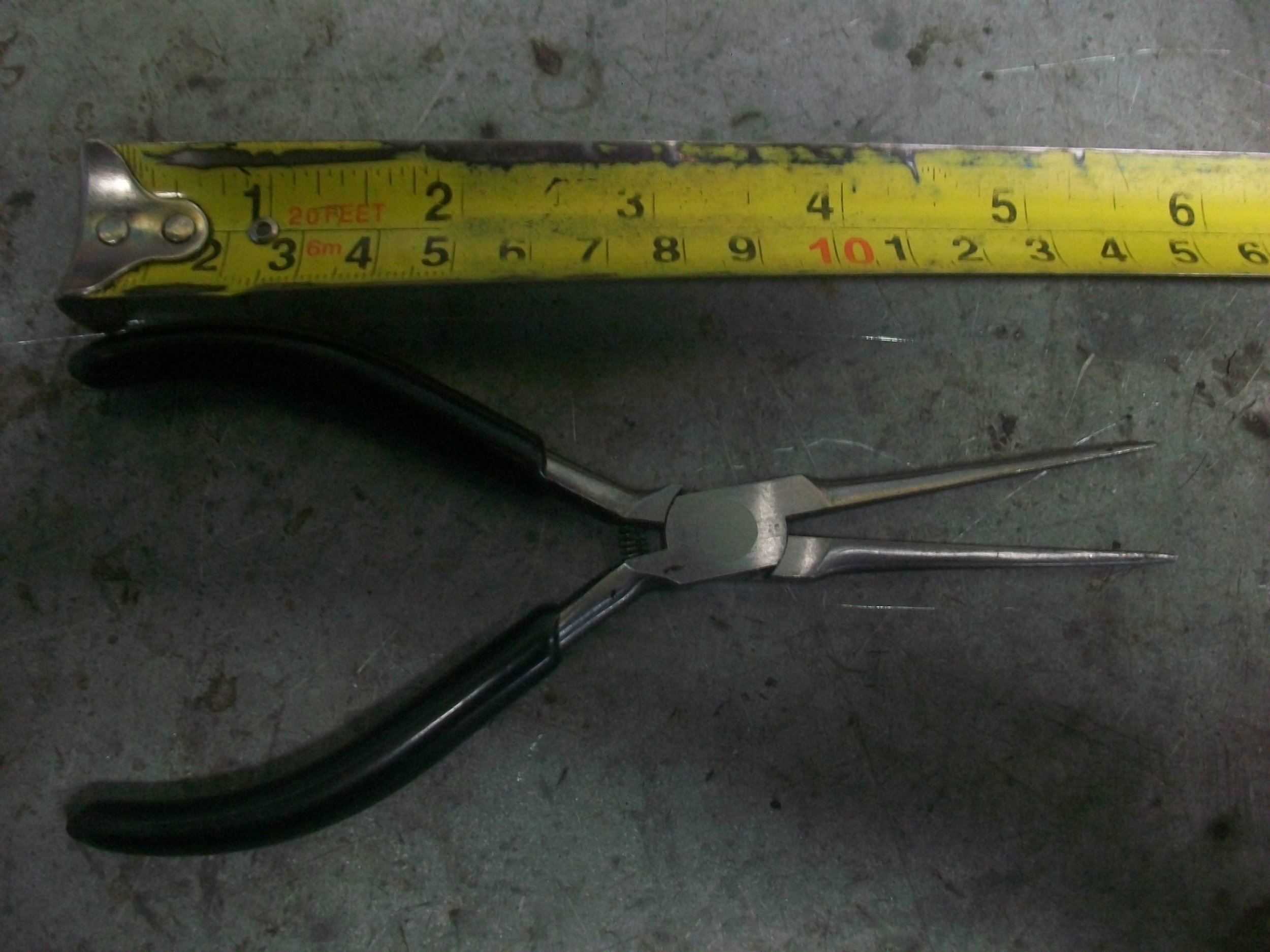

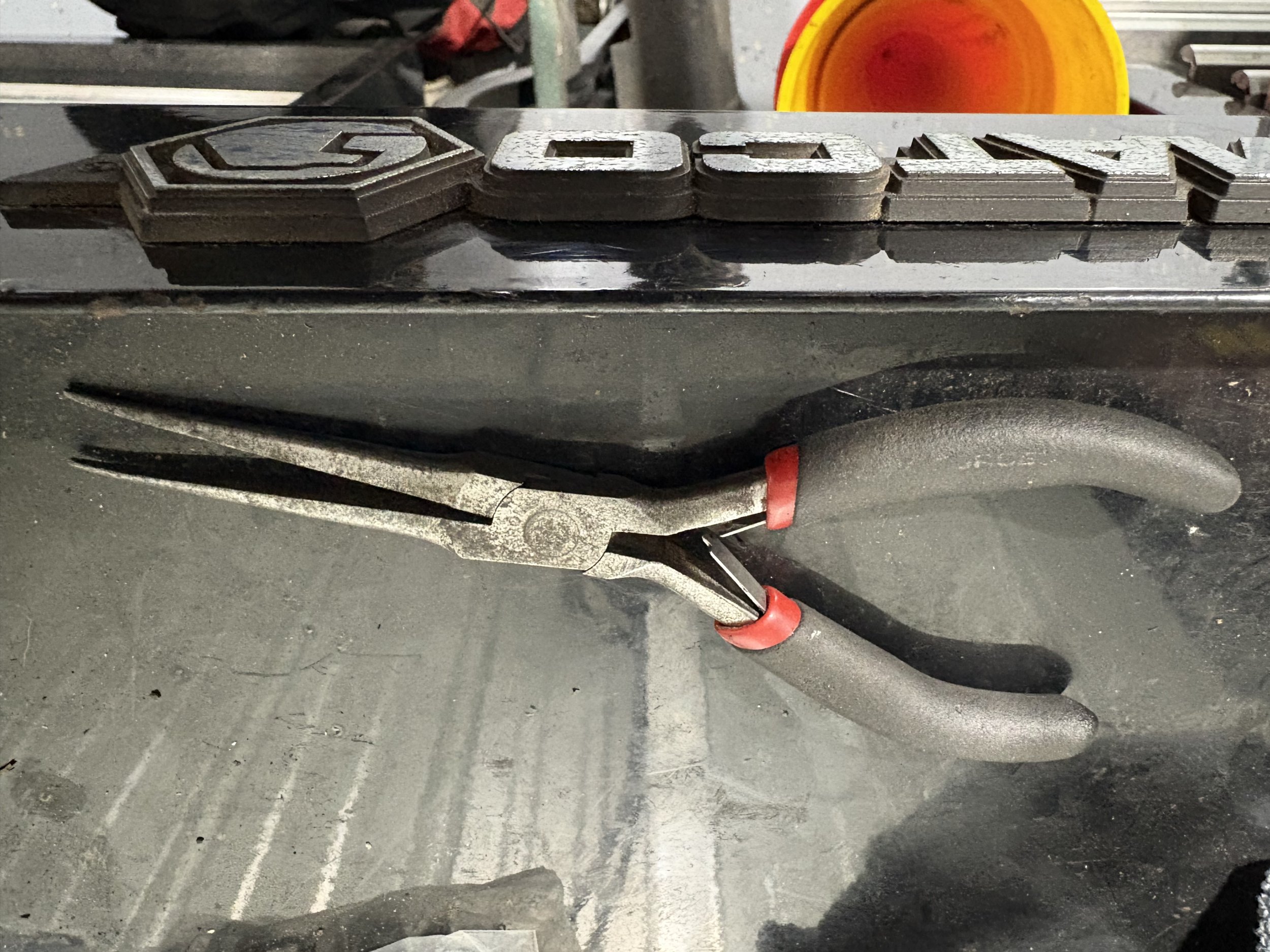

    How did you get the circlip/wire clip out of the top of the shaft to get the cam off? I’ve really struggled with that.
  7. Ryans65
    Joined: Apr 12, 2018
    Posts: 153
    Ryans65
    from Yulee FL
    I have a really slender pair of needle nose pliers that got it out, theres definitely not much room to work with though!

  8. jaracer
    Joined: Oct 4, 2008
    Posts: 3,034
    jaracer
    There is supposed to be a round felt piece just under the rotor at the top of the shaft. That is supposed to get a drop or two of oil at each tuneup to keep the shaft lubed.

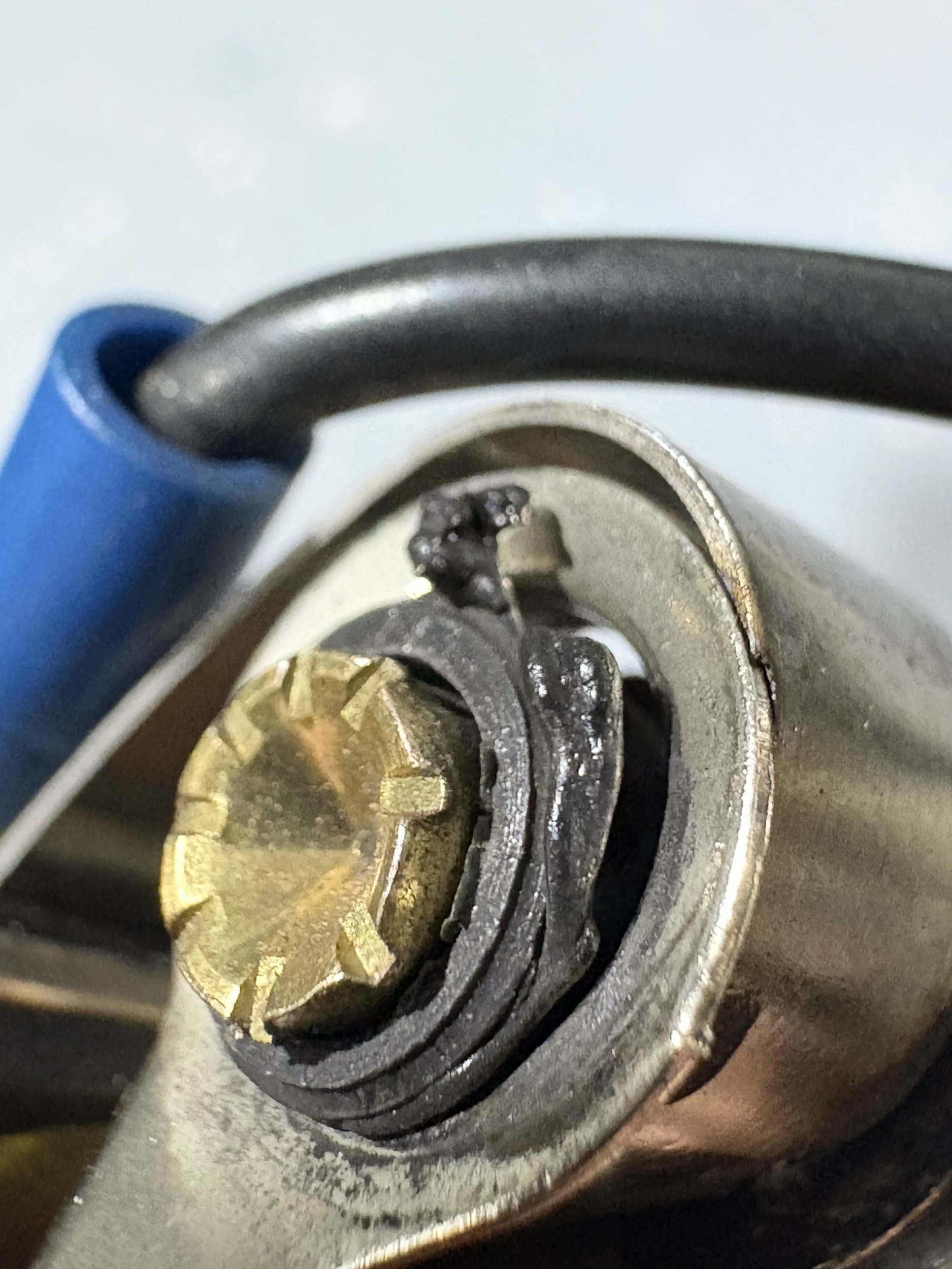

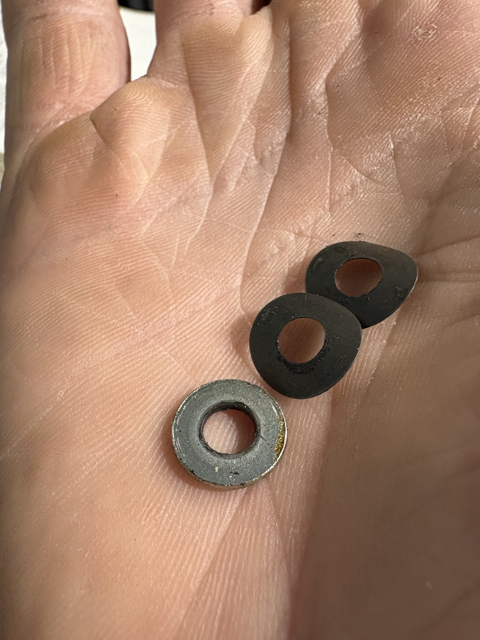

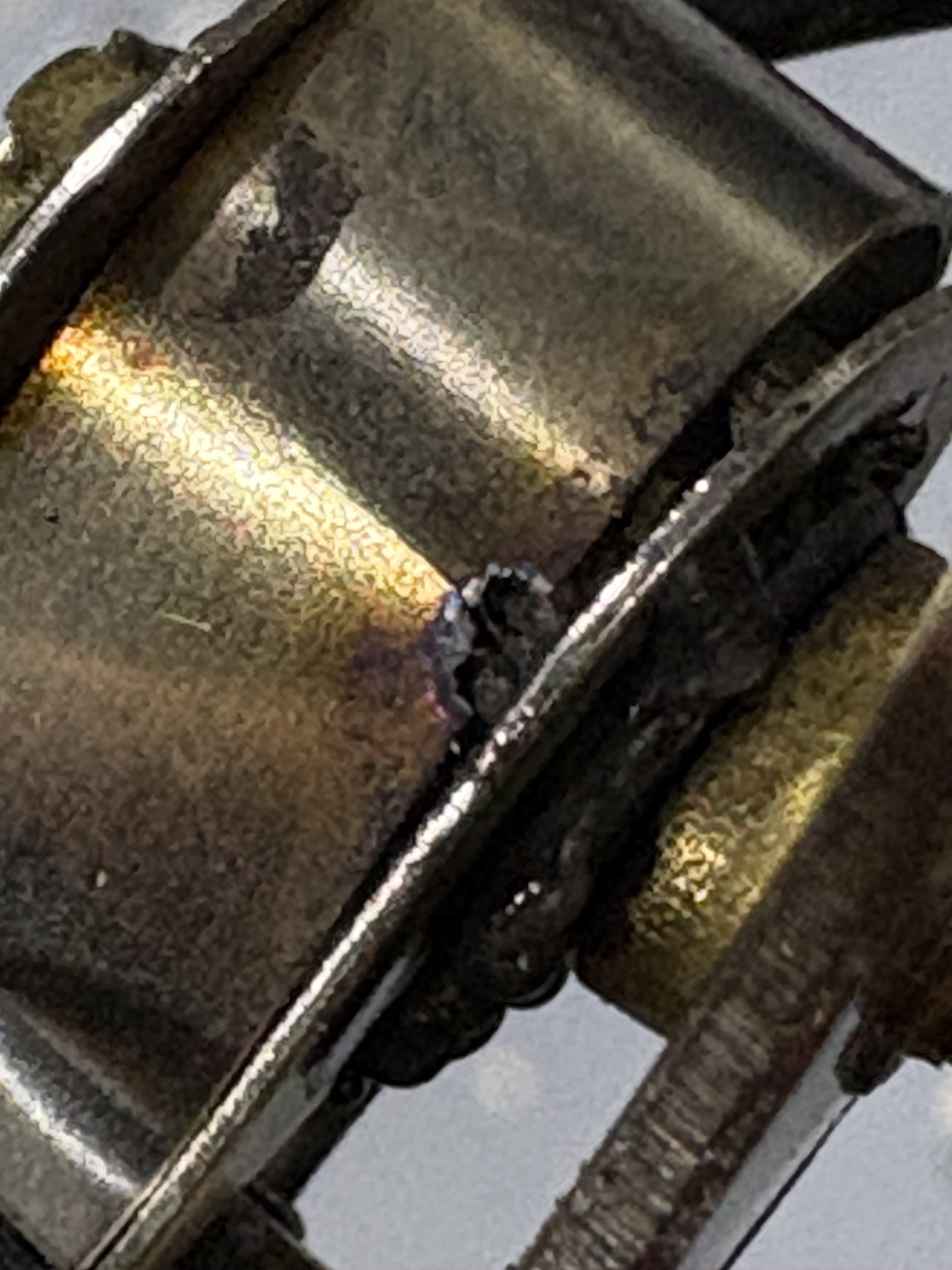

    Well I over thought this one but found a few things along the way that needed attention so that's always nice.

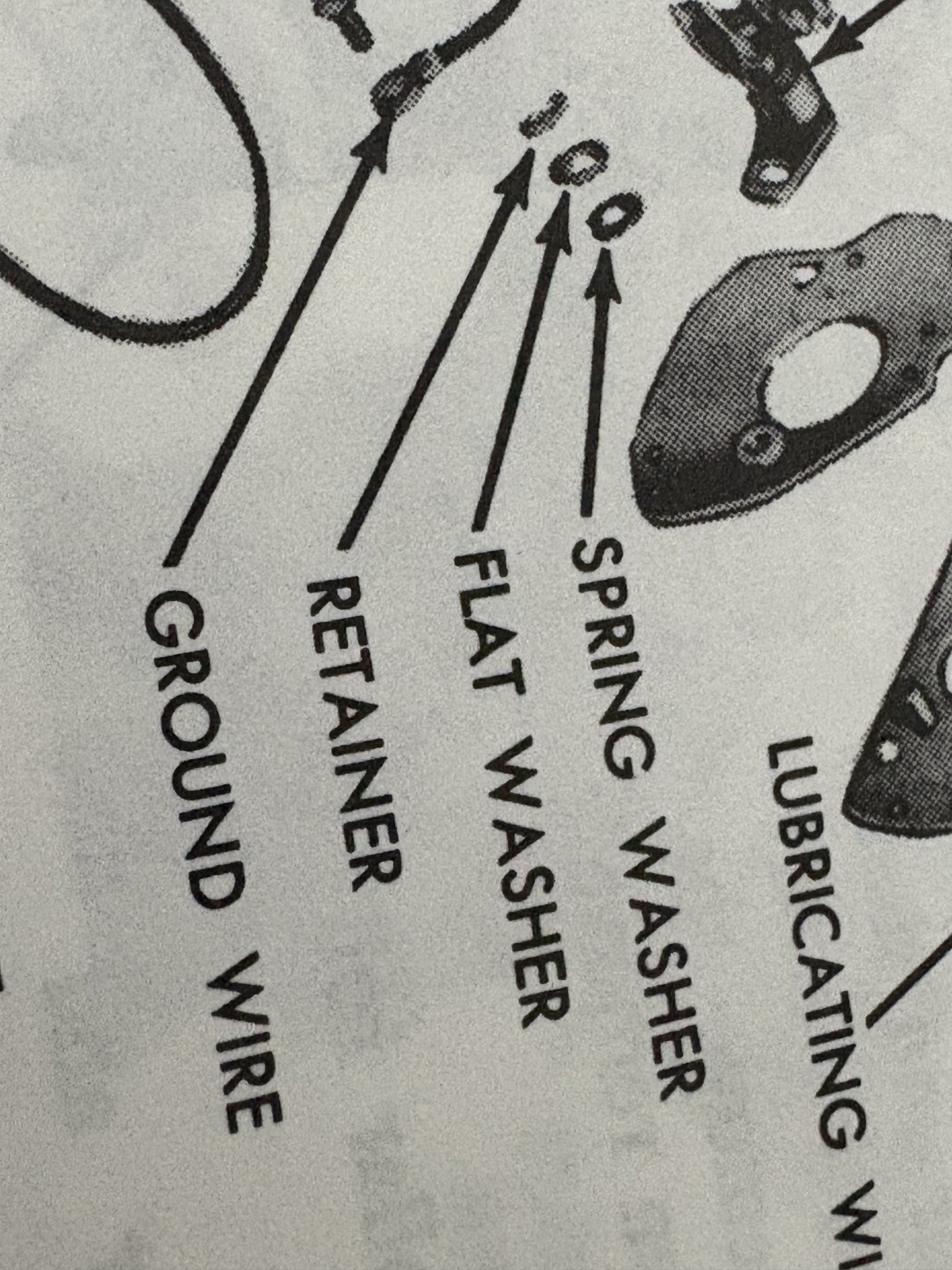

    The breaker points plate felt really tight so as I was reassembling it I found someone had stuffed two wave washers under the flat washer where the manual only called for one. I removed that and it felt much more smooth. I cleaned the shaft and put a little oil on everything and reassembled. It started up nicely and idled well for a couple minutes but then started running like**** again. A closer inspection of the points revealed the root problem here. I'll let the photos do the talking! Time for new points/ condenser.
    In the first photo you can even see a couple blobs of melted plastic from the points.

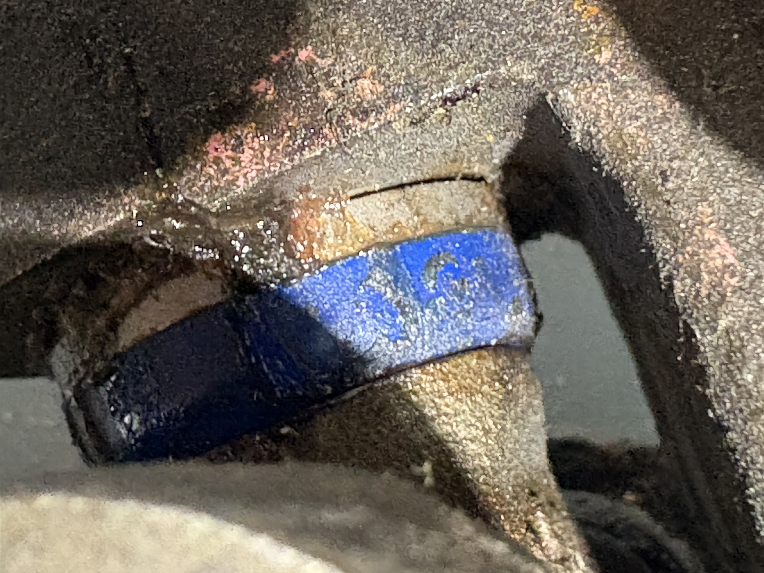

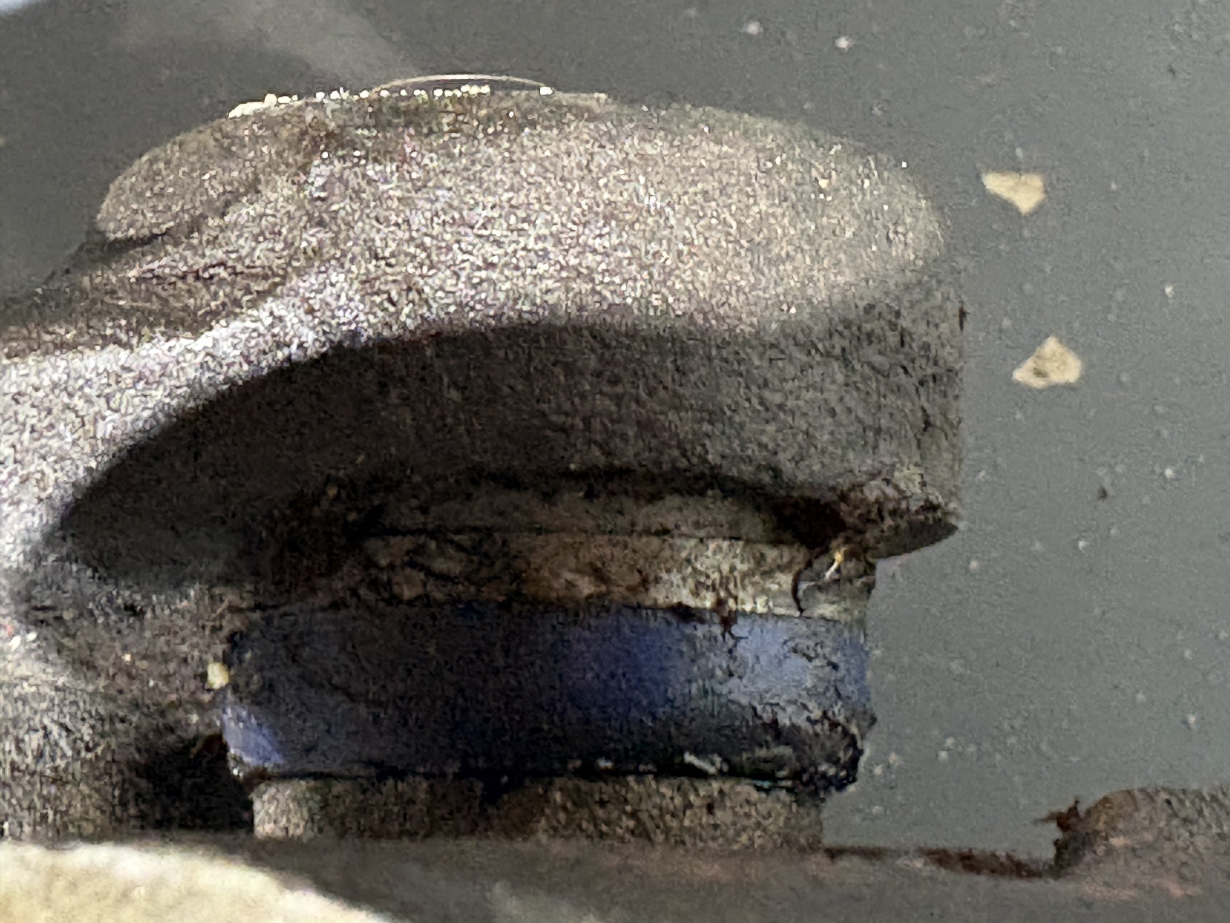

    The yoke on the trans side of the driveshaft was pinched inward so I think the joint was sitting slightly off set to one side. I whacked the yoke back out and both clips went in smoothly but I'm still going to send this for balancing while it's out and put an output shaft seal on it. Looks like it has the wrong one installed.

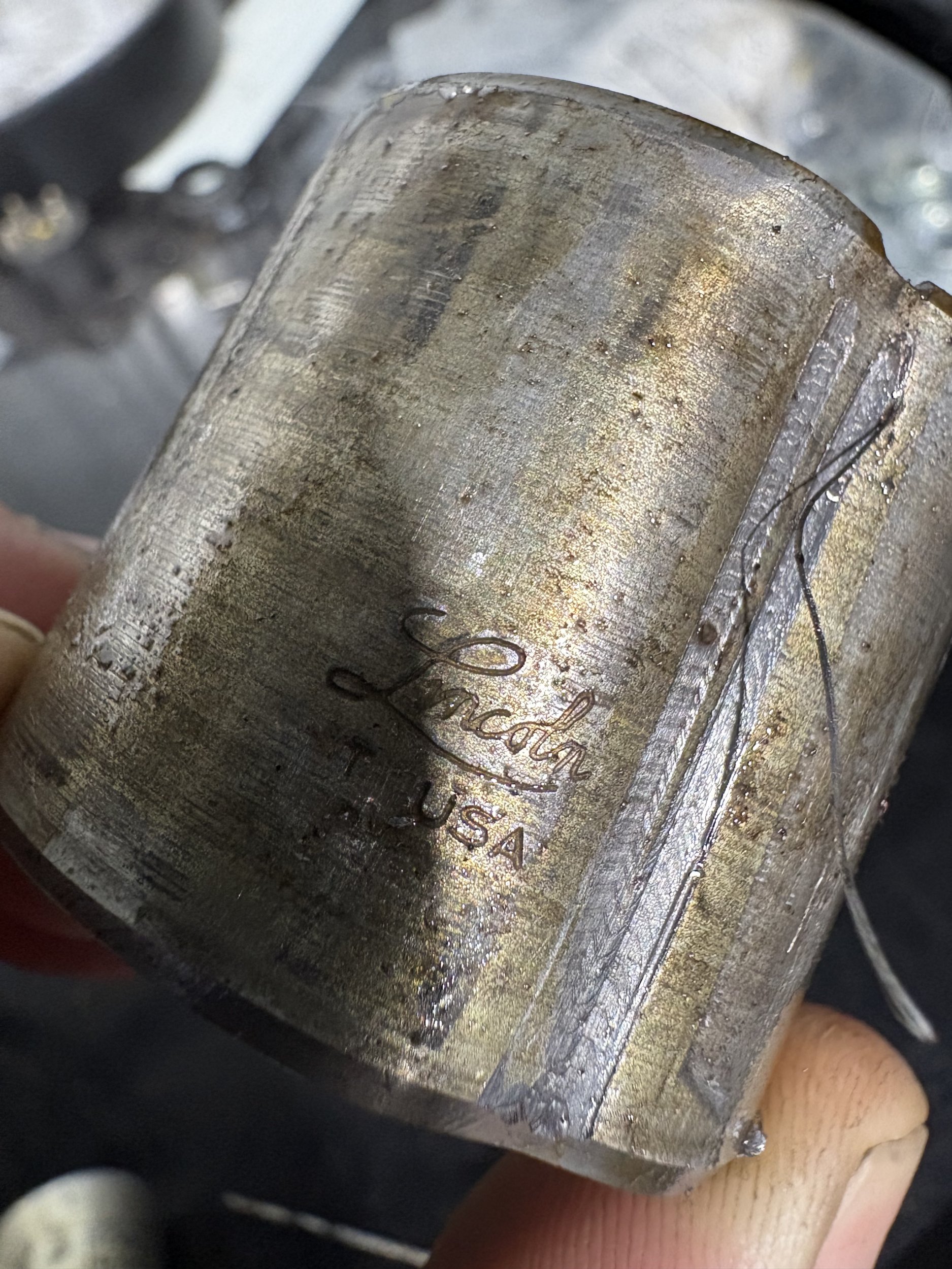

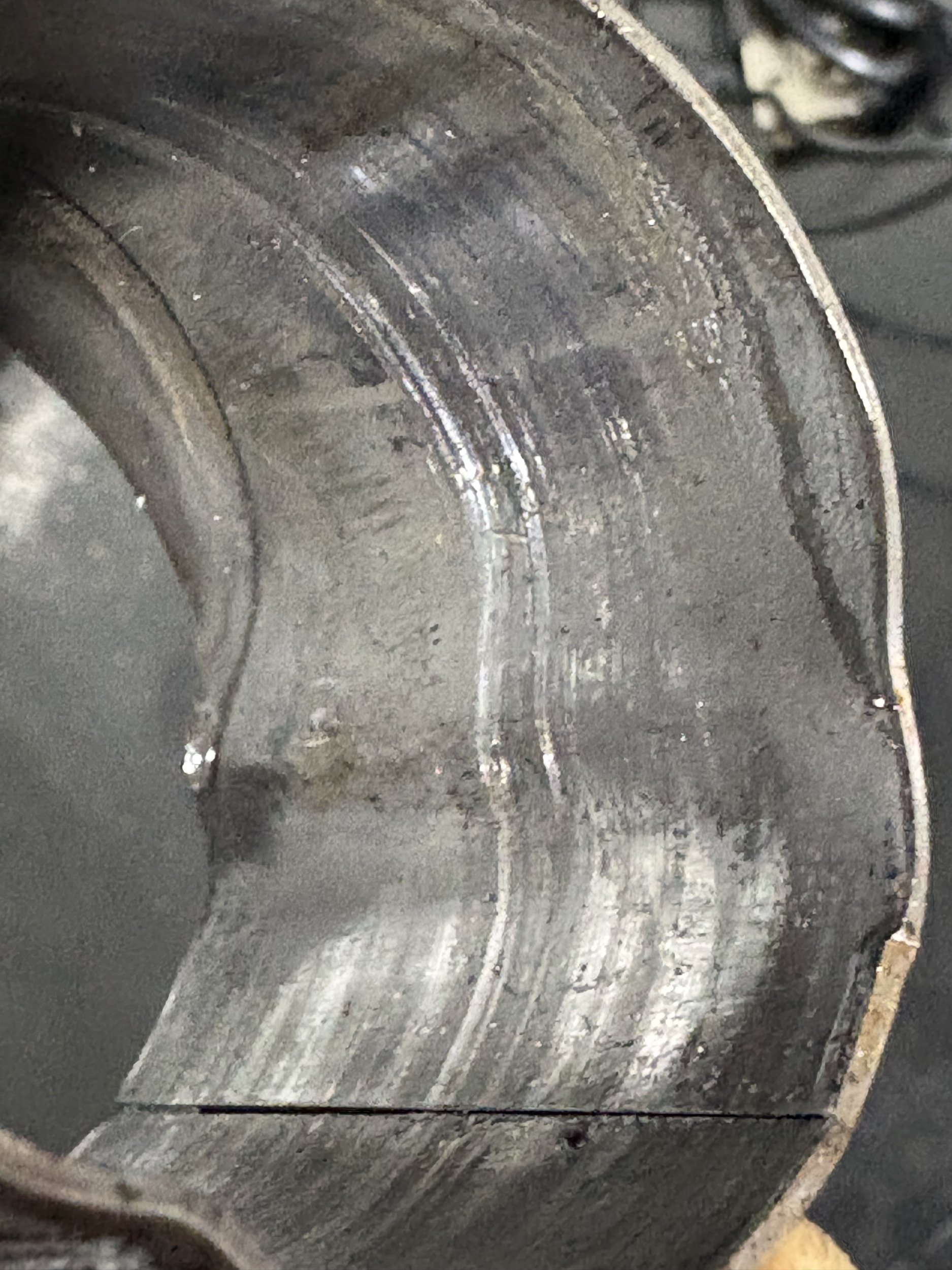

    Got the driveshaft back today, invoice says it was straightened and balanced. I might be on to something here. While it was out I found an NOS tailshaft housing bushing Im planning on putting in as well as a new seal. There is a lot of slop between the slip yoke and the bushing so obviously it needs replaced. Now I just need to figure out how to get it in/ out!
  19. Ryans65
    Posts: 153
    Ryans65
    from Yulee FL
    I tried to wedge a very narrow drift into the slot in the extension housing to sort of distort the bushing enough to loosen it and pull it out but it was lodged pretty good. I ended up removing the extension housing which was probably what I should have done in the first place but I was trying to not have to drain this trans for the third time. Type F is pretty pricey these days .
    I made a huge mess of trans fluid on the floor and after removing the parking brake cables and loosening the down pipe it came right out. I beat the bushing out with a 30mm socket on an extension. Waiting on my NOS bushing but should be here tomorrow. Looks like an original bushing? Lots of play there, small fluid leak at the output seal.
