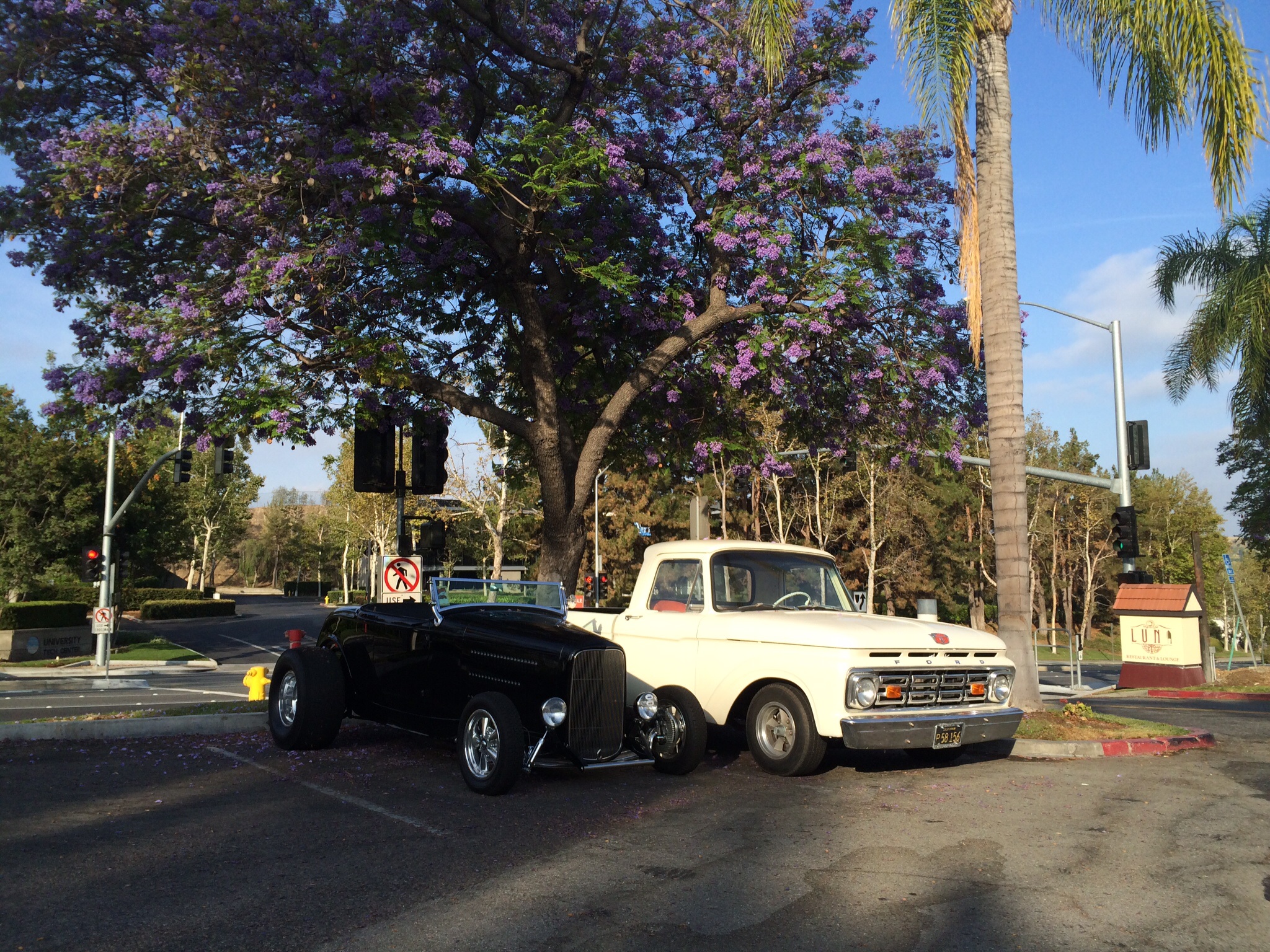

    That truck has prob been clipped. But you can get an F100 fairly low w/ a dropped axle and dearched springs.
    Here is my '64.

    Moonpie doesn't have air ride... the baby blue one behind it does... but I think Moonpie has a MII frontend.

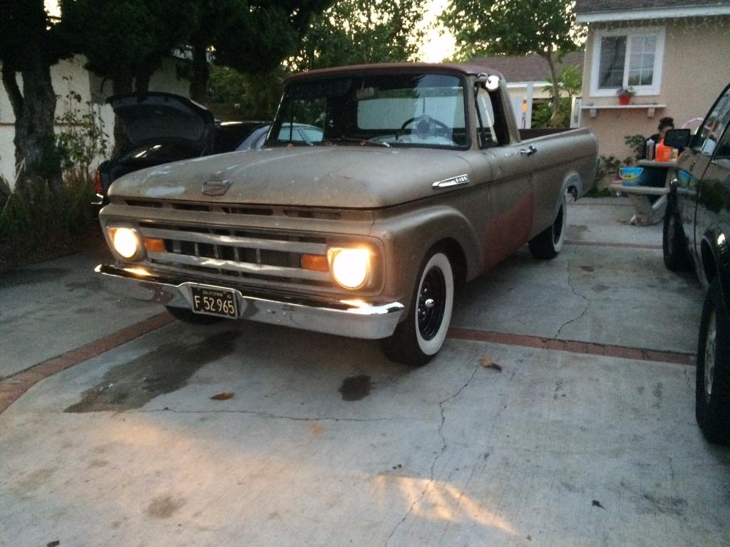

    I took two out on mine and it's fine. I have a 302 with an aod in it right now, idk how much my 223 with the three speed weighed but when I did the swap it still sat the same. ImageUploadedByH.A.M.B.1409347950.901669.jpg this is how it looks with two taken out .Now with a three inch drop axle you can expect it to look lower. You get the idea.

    Don't really remember but this is a shot I took today of underneath ImageUploadedByH.A.M.B.1409696590.910498.jpg

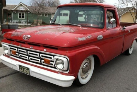

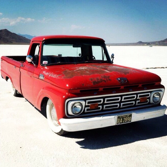

    Here's my '64. Sid's 3" drop axle, lost 2 leaves and dearched front. Lost 4 leaves in the back and dearched. I still have an inch of travel and no steering arm issues or bumpsteer. I also used Sid's drop ties. ImageUploadedByH.A.M.B.1409897887.345397.jpg

    Can see the stance better here. *** still needs to come down... ImageUploadedByH.A.M.B.1409898171.845338.jpg
