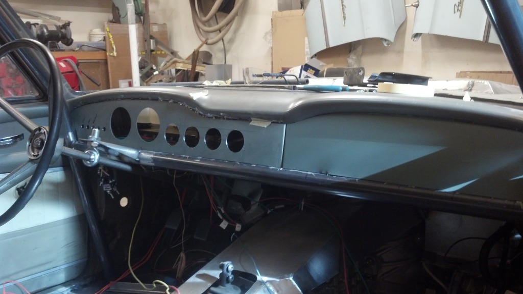

    I had cut the dashboard out and had planned to make a simple flat dash with a flat instrument panel. But the orginal dash had such a distictive shape I decided to cut it in half lengthwise and weld it back in. I then made and instrument panel and a filler panel for the p***enger side.

    Hey Tom the dash looks cool , autometer phantom gauges ? Tintop

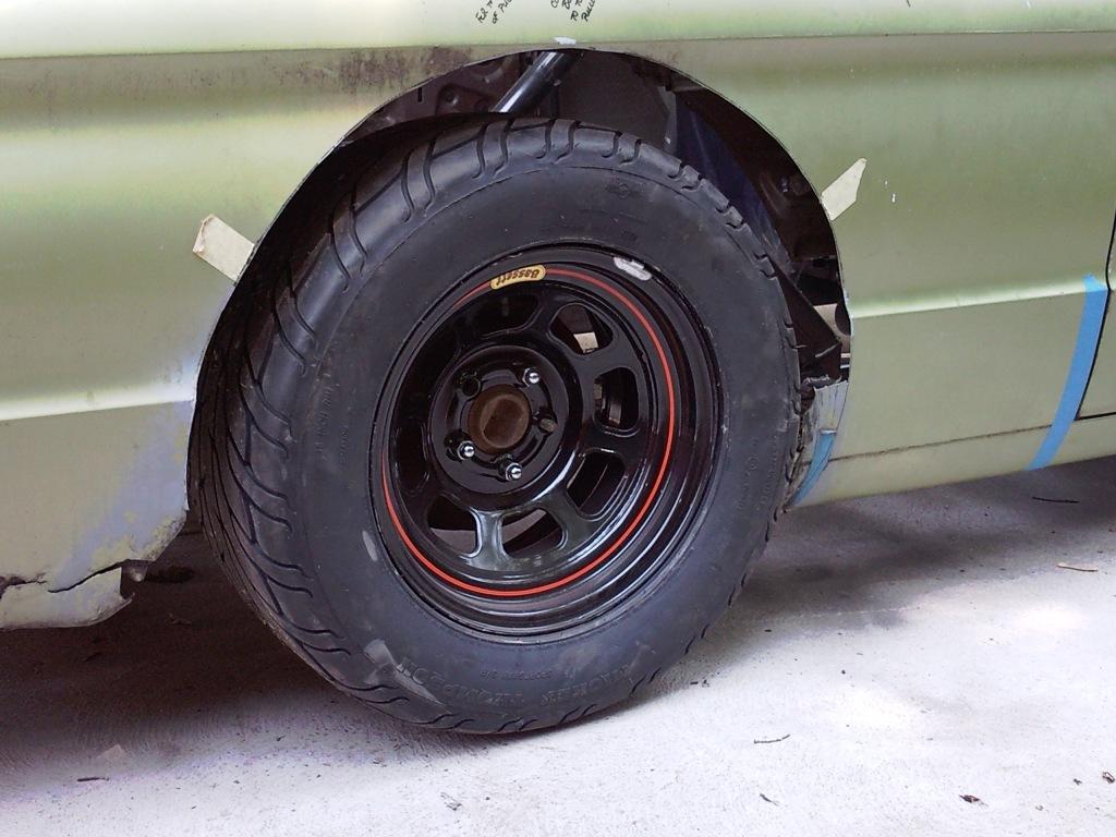

    If you are thinking steel wheels ? Do it , paint em black with Wood Brothers red and white. , Friggin Kool look !!!!!!

    That's right - Speedo, tach, oil pressure, water temp, volt, fuel level.

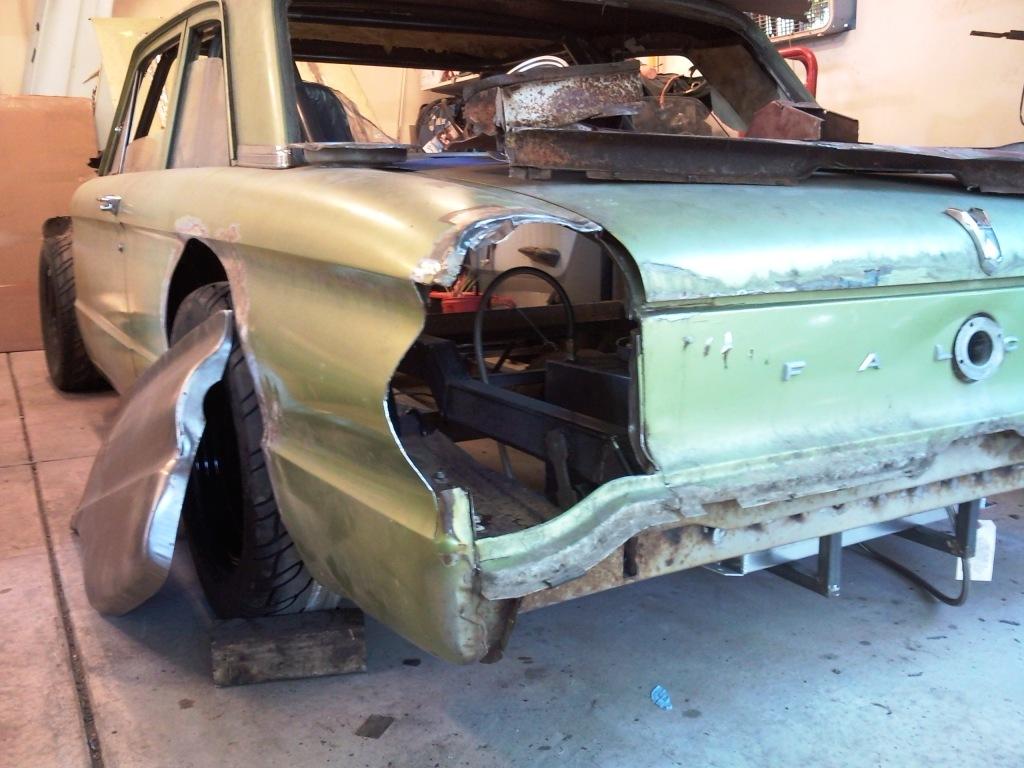

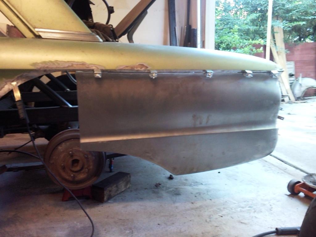

    Aside from the rust, the only real damage to the car was the left rear quarter. I decided to just cut it all out and replace with an after market quarter and a taillight section from the bone yard.

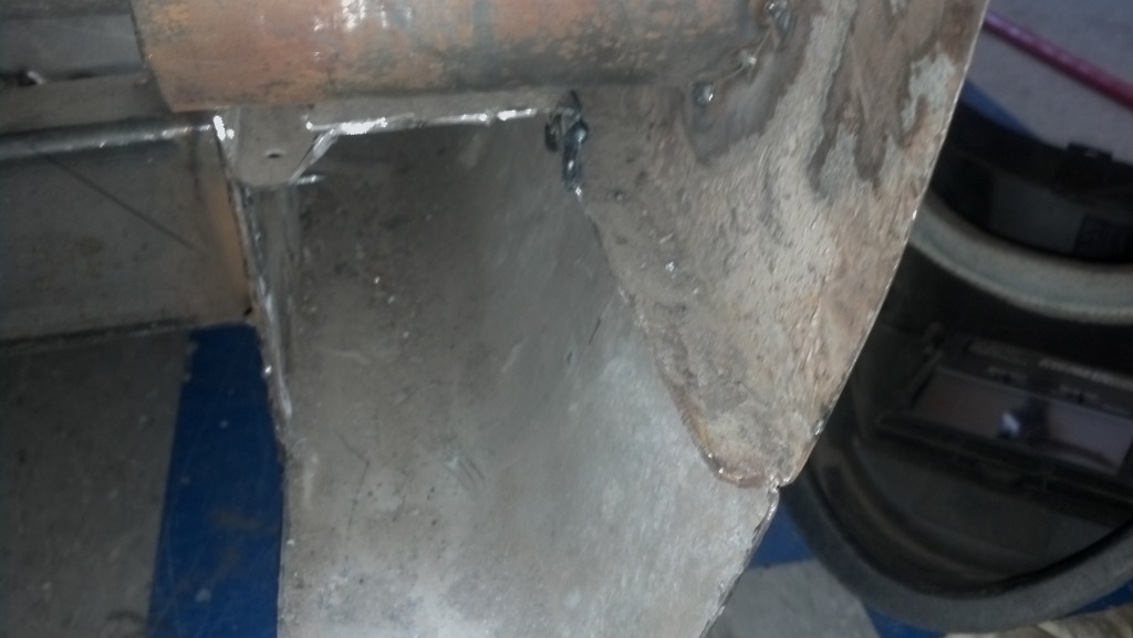

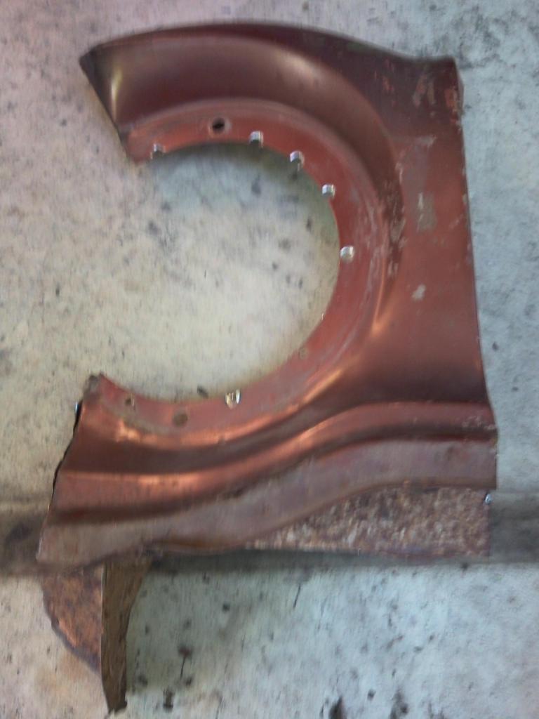

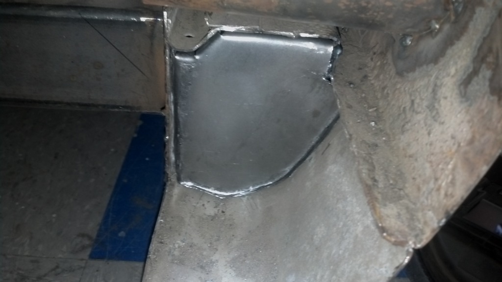

    Body modifications were limited to the fenders and the hood. Once I had the radius I liked, 3/16 inch round stock was welded to the opening for a more finished look. Then "fillers" were made for where the coves of the body are. Removing the inner rear fender wells opened up the rocker panels from front to back so "plugs" for both sides had to be made and welded in.
    The body was lowered so far that I had to raise the middle of hood to clear the engine. This was an unwelcome surprise and I really don't like the result. But I have another hood laying around I may try something else on.

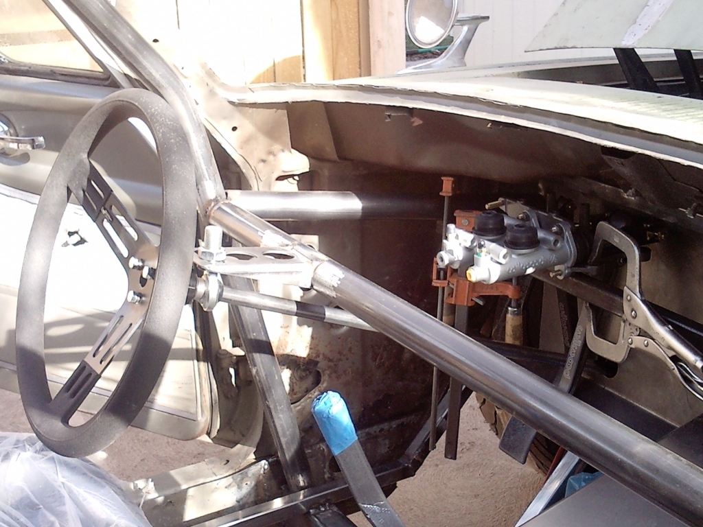

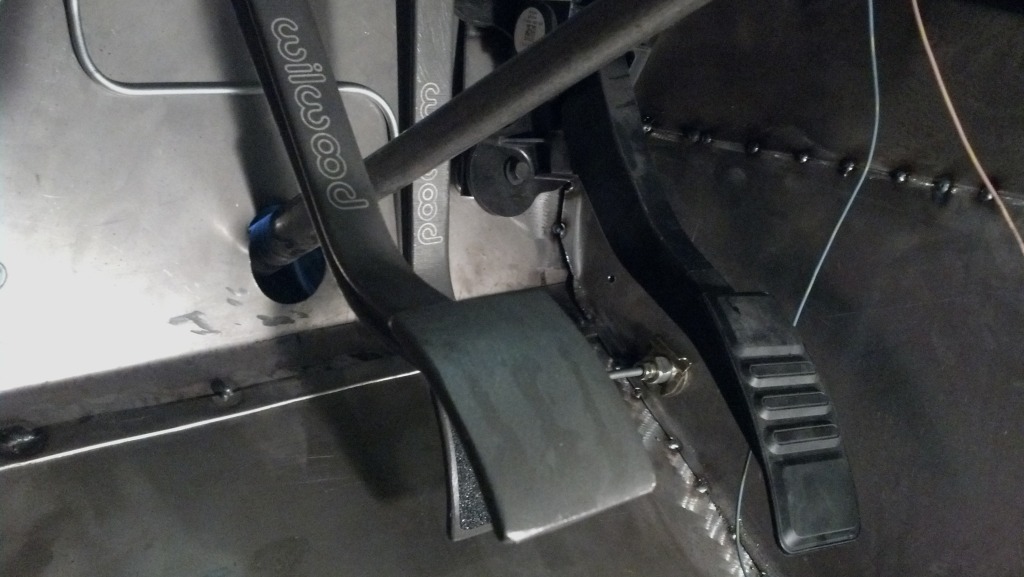

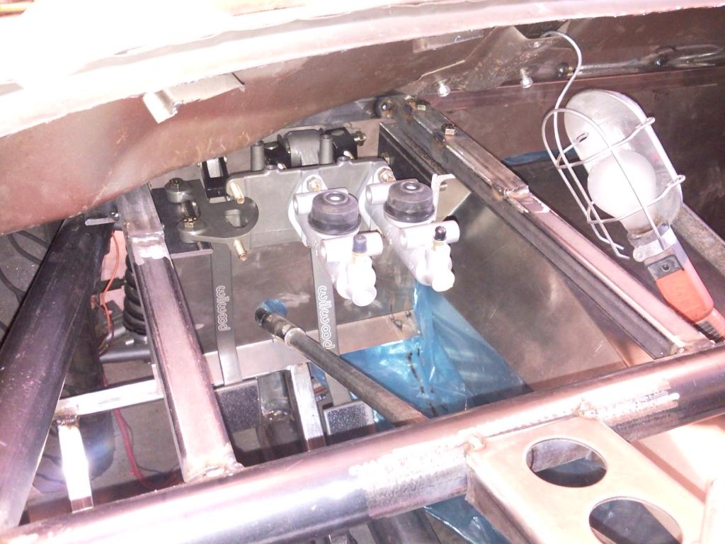

    Because of the width of the engine there was no room for the brake and clutch master cylinders on the firewall. Therefore I had to go with the Wilwood reverse mount pedals. The reservoirs are also under the dash and are accessible via an access panel in the top of the dash.

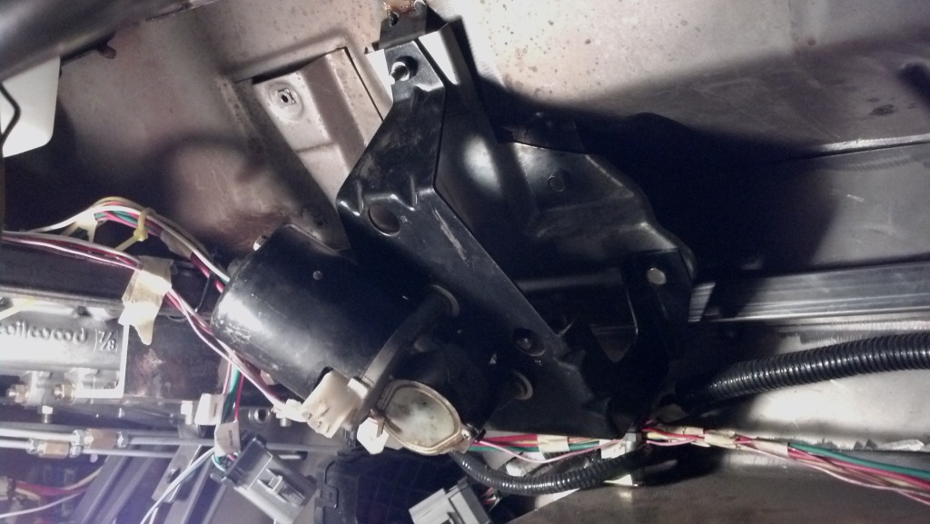

    One thing leads to another. My pedal box got in the way of the windshield wiper motor which I had to relocate to the right about 3 and a half inches.

    The relocated wiper motor interfered with the hydraulic clutch line I had installed months earlier so it had be relocated from the top of the transmission tunnel to the side.

    hey Tom -sounds like you must run into the same issues I had, I had to relocate wiper motor to p***. side, ended up being the worst 3 weeks of the whole build,I like the pedal setup you have, trick stuff , nicely done tintop:cool::cool:

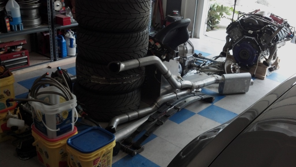

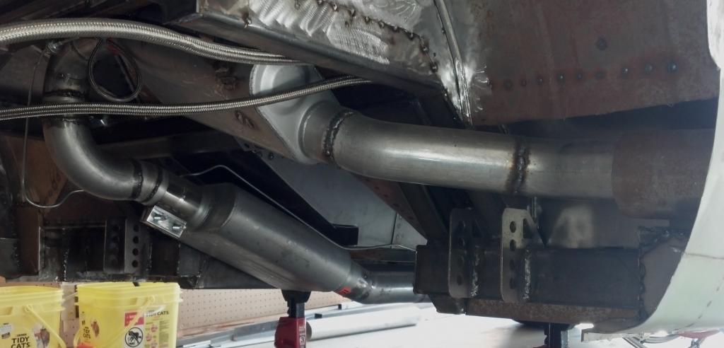

    Hey , wondering if you have any pics of the floater rear end , thanks tintop

    Here you go. I actually just took it out today. I also included another pic of the exhaust.

    tom -that is one very creative exhaust system you built, I like very..... much ,thanks:D:D:D
