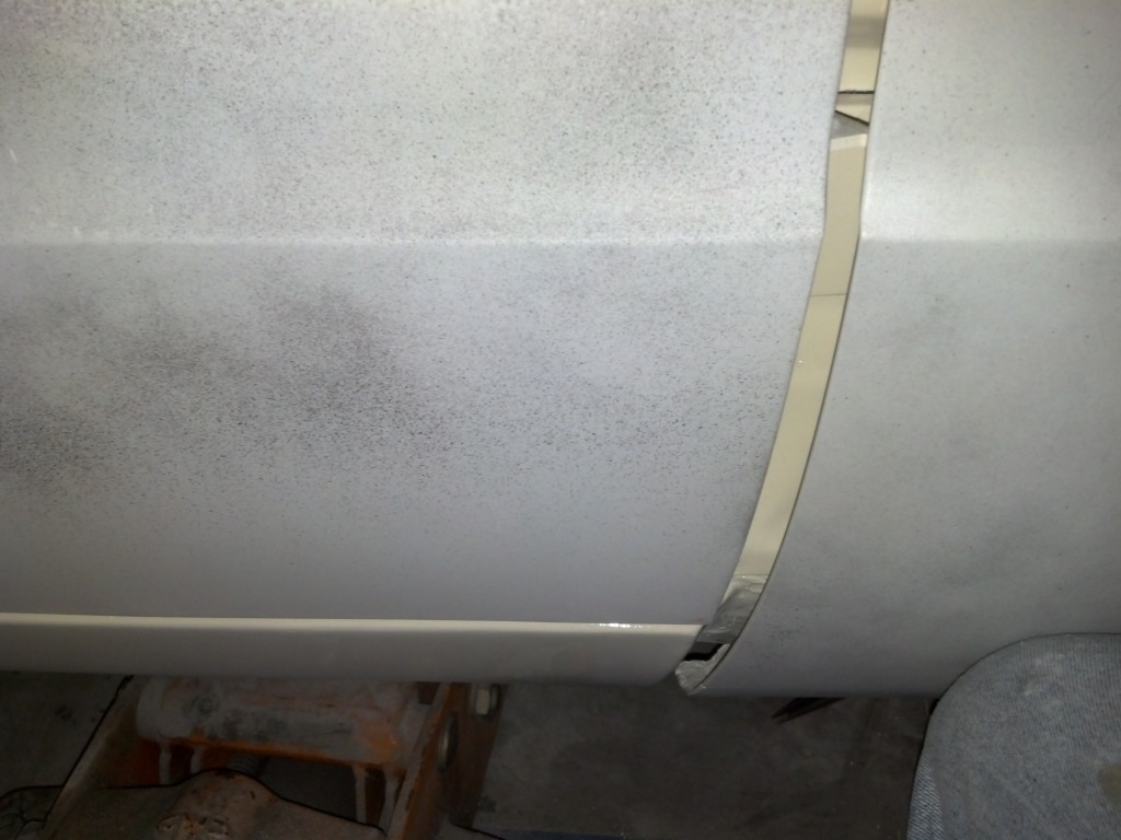

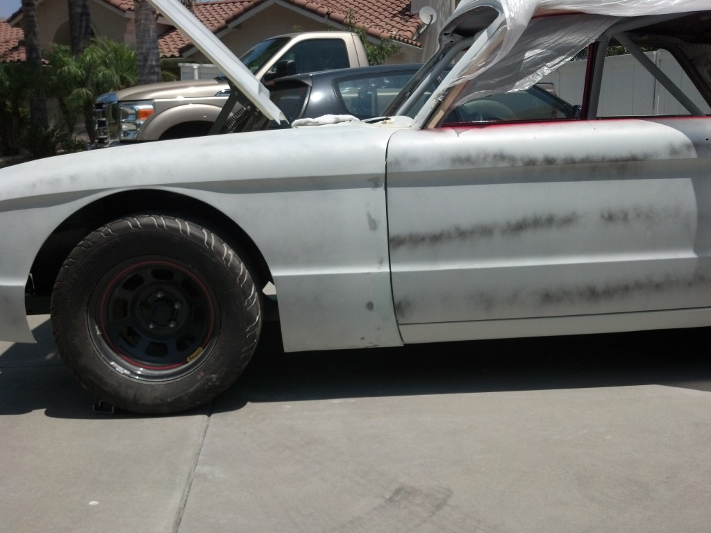

    These big gaps are a big problem. When I was welding up the frame I had the front fenders attached at only a few points. I thought that was good enough to make sure the frame was such that the panel gaps would be good. I was wrong. The gaps were fine at the top but way too wide at the bottom. The only good news was I had the same problem on both sides which gives me a little comfort that the frame is at least straight. Even with this alignment problem, the body line still looks okay.
  11. nash510
    Joined: Mar 2, 2008
    Posts: 140
    nash510
    from Vista, CA
    So...I cut the rear edge of each fender from the bottom all the way up to the top body line. I'm now in the process of filling in the gap. Not pretty but I think the gap will look a lot better.

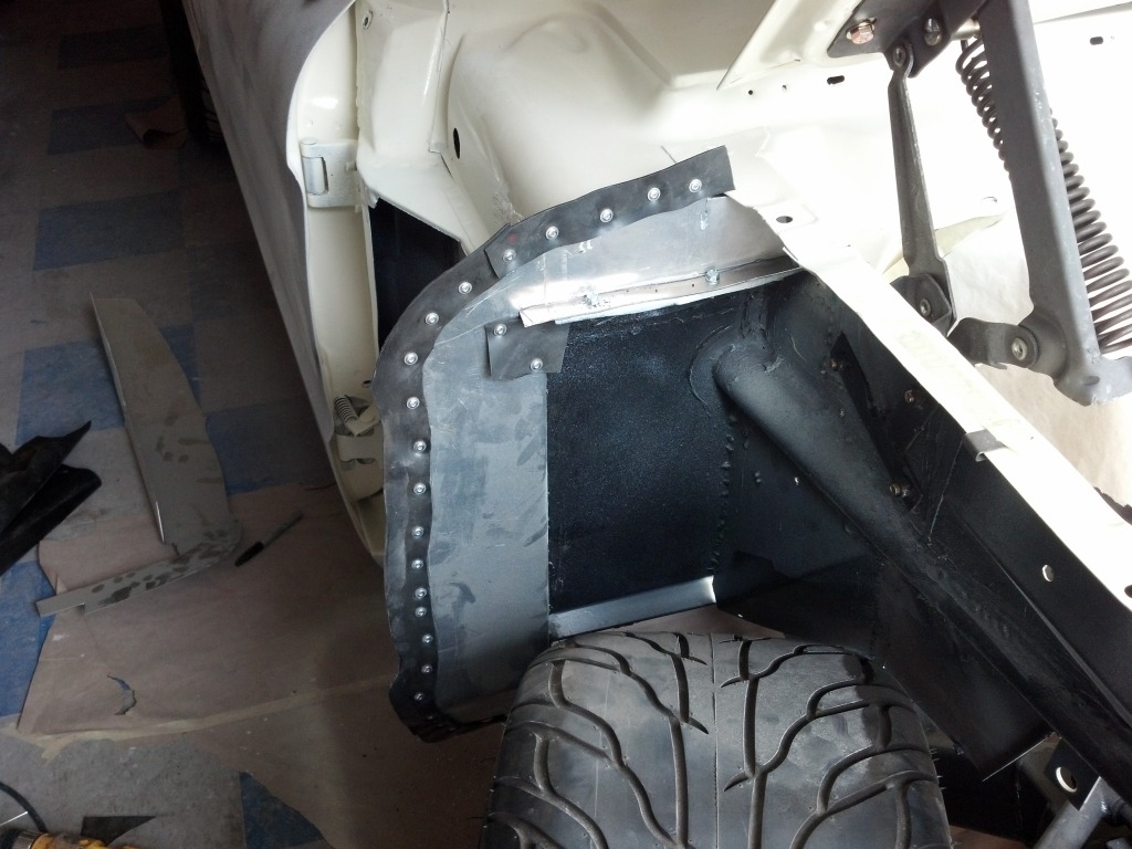

  12. nash510
    Joined: Mar 2, 2008
    Posts: 140
    nash510
    from Vista, CA
    I also had to make new splash shields since the old ones wouldn't work after I pushed the firewall back.

  18. nash510
    Joined: Mar 2, 2008
    Posts: 140
    nash510
    from Vista, CA
    Before and after. Still some adjusting to do but I think it will look okay.
