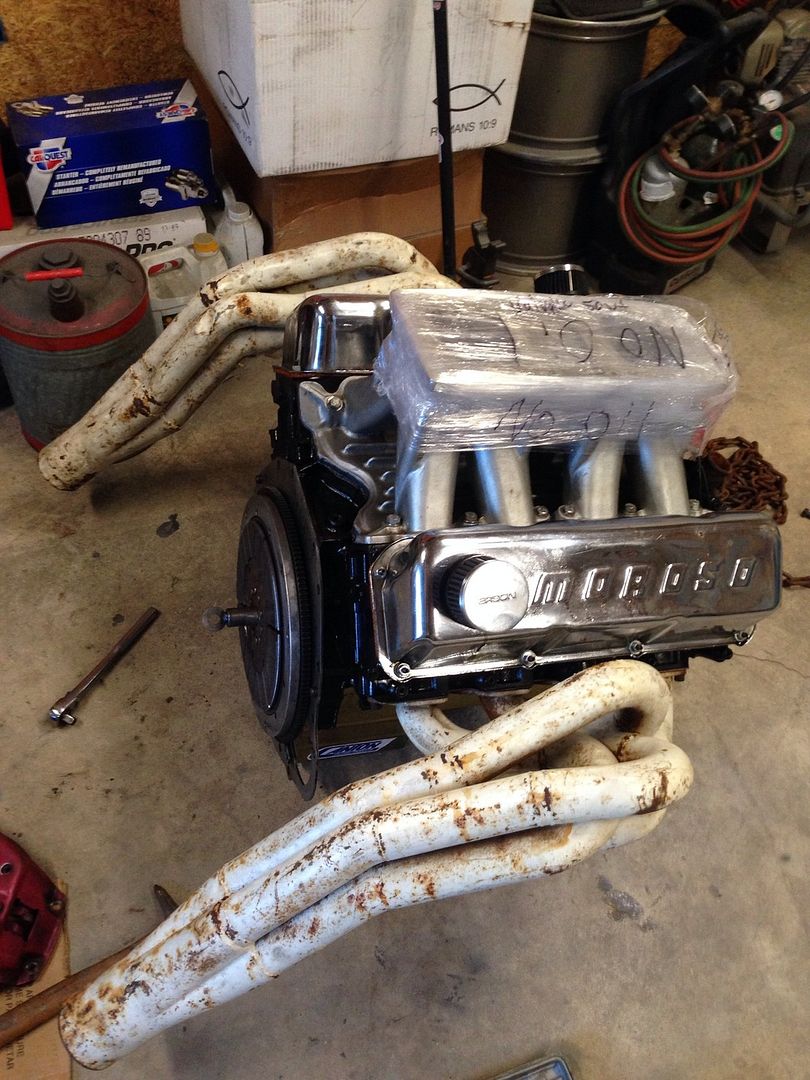

    headed home
    pulling the windsor

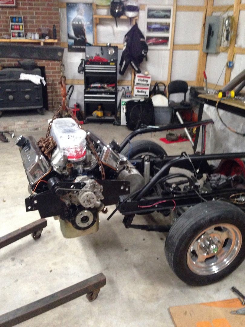

    waiting on new motor
    valve covers were just temporary until i could get my set painted
    ready to go in

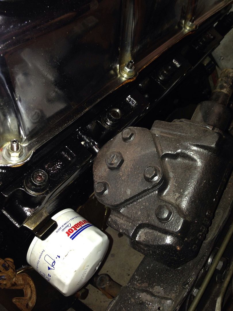

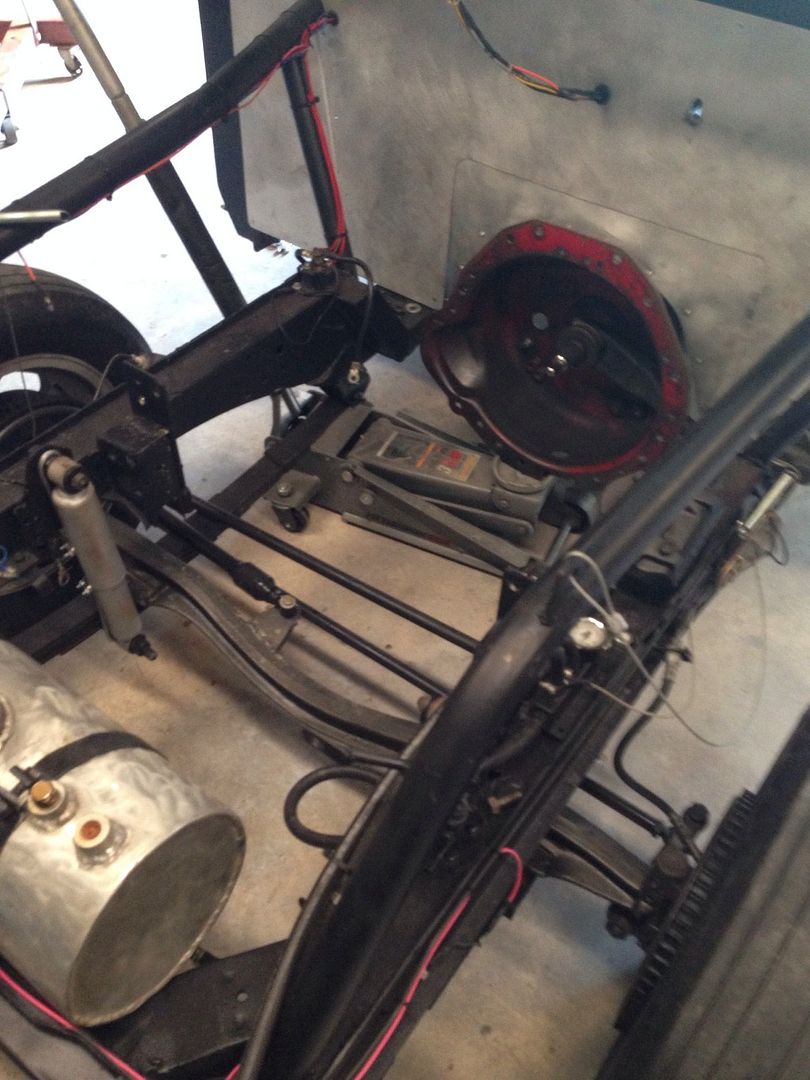

    Pretty close on the passenger frame rail where it was scabbed but could've been made to work with a little work and a tight fitting set of headers.
    no way this will work in its current location. I could move the steering box in front of the engine but this was just a test engine so i could figure out what i wanted to build. The front frame rails would really need to be cut off and start over as well if i planned to run cleveland, and considering its gonna cost about the same to go with either engine, a windsor just makes more sense as its a direct bolt in since thats what i built the car around
    another angle so you can see just how close it is to the exhaust port

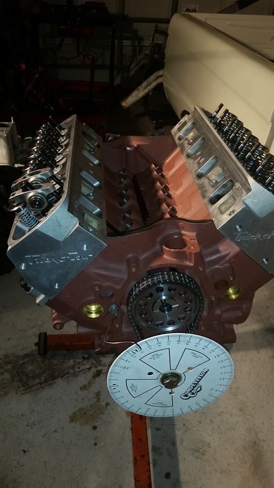

    Mjlangley, I just purchased a dart 4.125 bore block, stroker crank and rods, either going with a set of afr 220 or trick flow high ports from TEA. Hoping to have it in the car by meltdowns

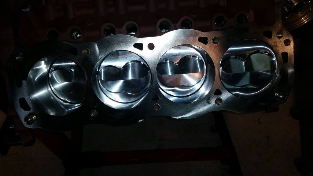

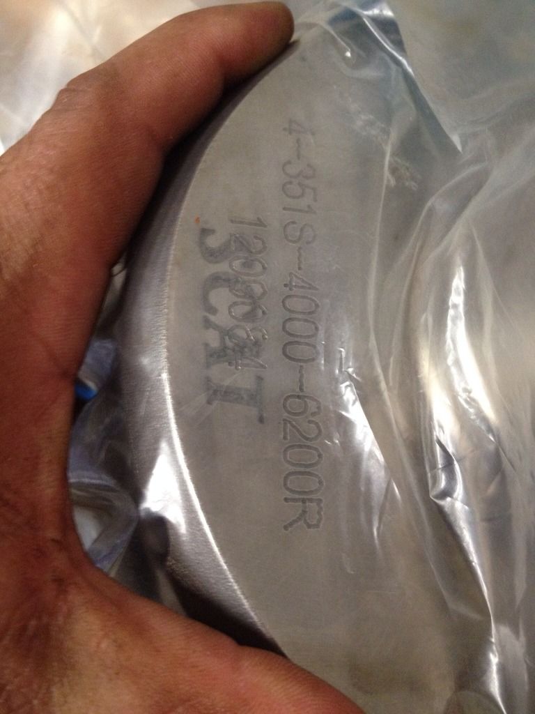

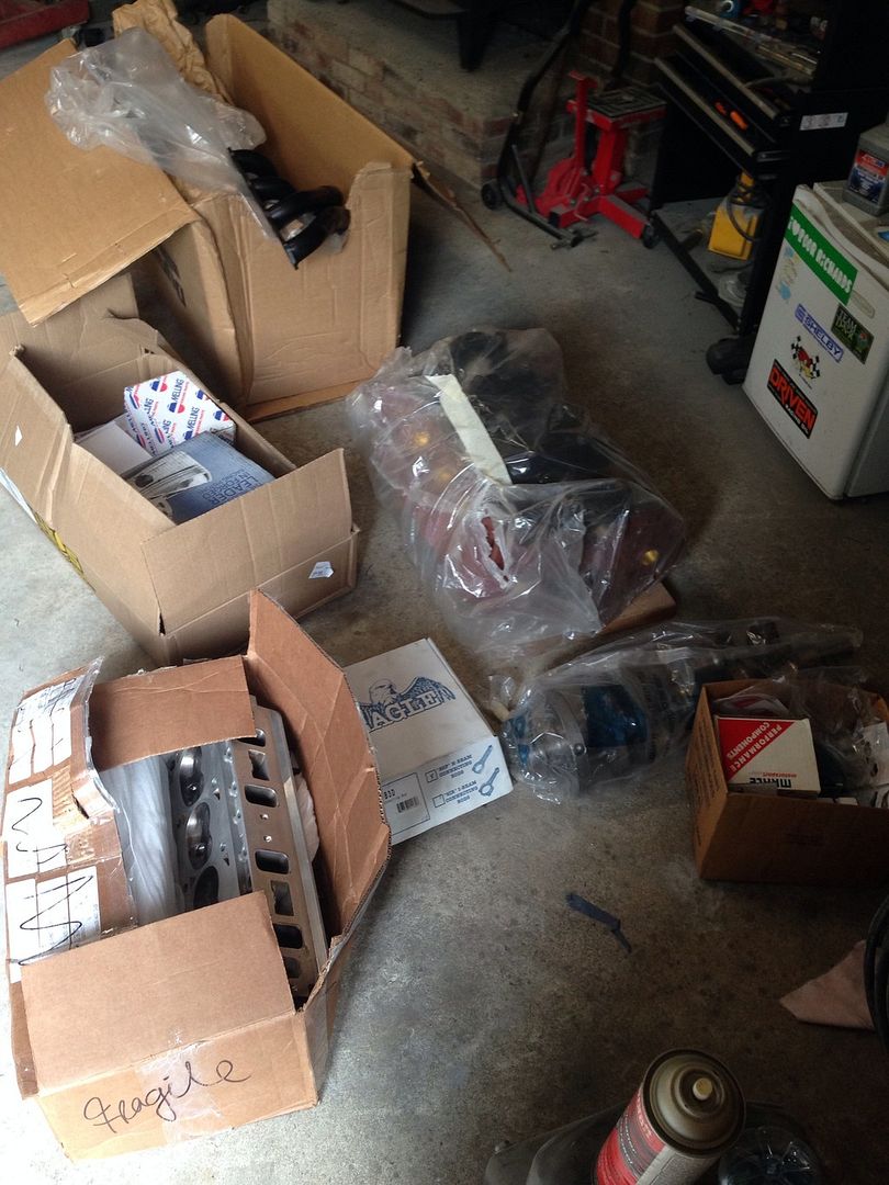

    4" stroke crank
    Pretty pistons!
    Trick flow high ports
    Goody box

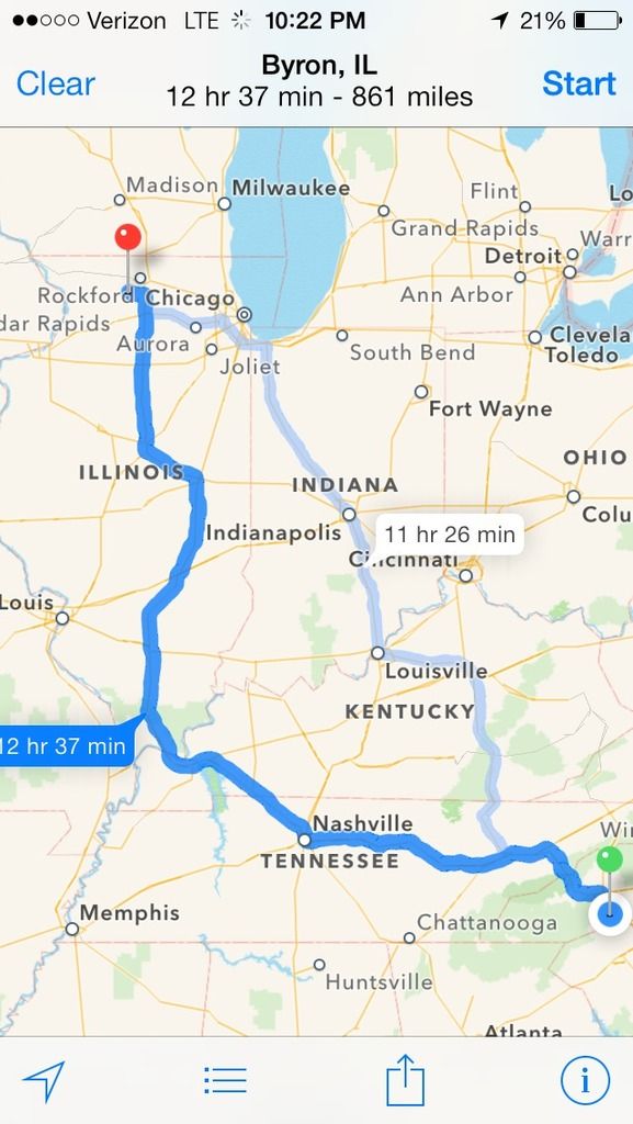

    Here is the route I'm planning on taking Tony
    All the parts piled in the floor

  22. That's the same route I took last year, 'cept I did N. GA to Nashville from here, made it great. Good easy route, sure wanna skip Chicago.
    Man, the delivery fellas have been busy!! Looks like a plan comin' together...

    That is for sure. As it is, you'll drive nearly the full length of Illinois. It's a long and boring drive.
    Coming from the South, I would work my way over to I39, which goes directly North to Rockford area. It passes West of Chicago and that traffic mess. Byron will be a short drive directly West of I39.

    Finn that looks like what he's doin. 57 north to 74@ Champaign, then west on 74 to Blm/Nml(my location) north on 39. And you are right it's awful boring. At least there's a dragstrip at the end of that haul

    There's a lot of construction on I65 around Louisville and Lafayette so that route may actually be quicker.

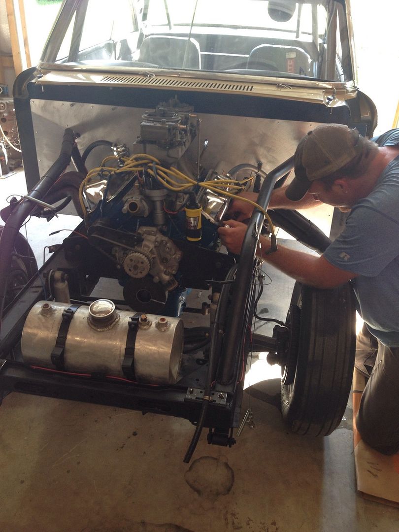

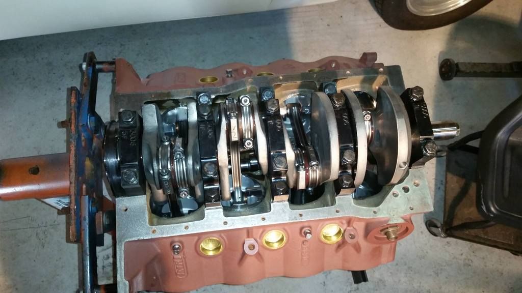

    Jimmy Huff has got my engine started going together, and it looks great!

    What's the story on that intake? Obviously not designed for a 351W...
    Also, nice short box F-100.
