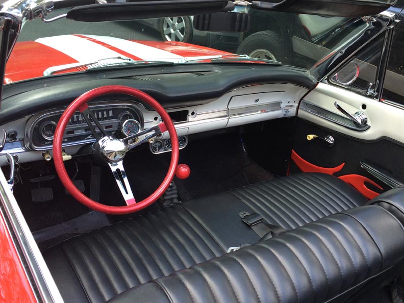

    If you use the Mustang T5, you'll have to cut out the arched brace under your floor between the seats. Of course, you could compensate by fabricating a replacement, but that seems like a lot of work. Here's a pic of the location. Yes, I've been down 222 quite a few times.
  14. Fisher400
    Joined: Jan 27, 2020
    Posts: 181
    Fisher400
    Okay, great to see it in the car. That position would work for me. I don’t want to get into cutting out the brace and fabricating something. Going more for a bolt on swap with the least amount of cutting as possible. Thanks!

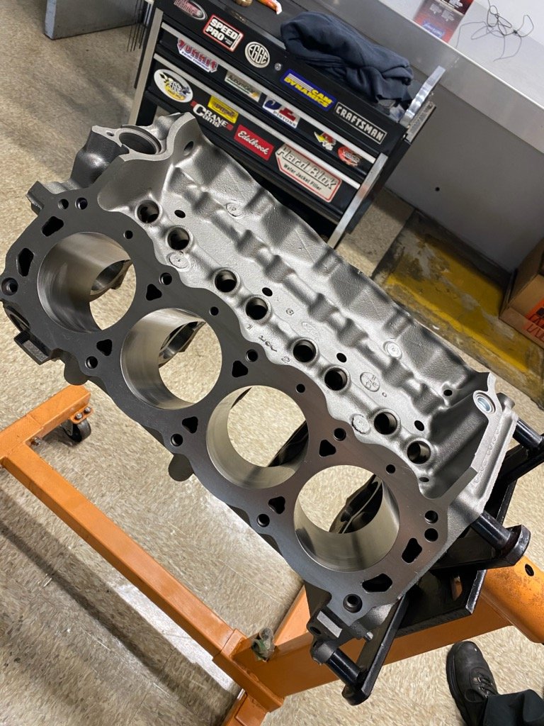

    It’s been awhile but wanted to provide a quick update to this project. Have all of my parts for the t5 conversion. Got distracted with other items on the car but Went with a 93 mustang gt wc trans. Keeping the stang tail and modifying a 64 mustang shifter for an org. appearance. Because I have the buckets/console there is no issue being set back. Modified the bucket seat rails so they are back 2” too (I am tall). The engine bay was redone, new break lines, rebuilding the 260. Stock specs. Re painted the red dash/doors and the interior will be a mix of old and some repo interior parts. The car was in a barn since 1989-2019. Not a show car but doesn’t look too bad! Should have the engine back soon and I will be ready for installing the t5. Hopefully get a maiden voyage in before it snows!
    41rodderz likes this.

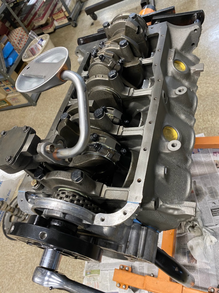

    Thanks, I am planning to see how the stock gears are and then go from there. If I remember correctly, the rears is 3.25 as this was the 2 speed automatic model originally. Pictures of the freshly painted engine too: IMG_1094.JPG IMG_1092.JPG IMG_1093.JPG

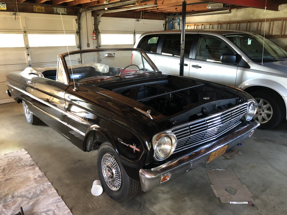

    IMG_1163.JPG IMG_1164.JPG 62656757739__0DFBE725-79F8-4E5D-961F-2EF744A4C3FD.JPG 62656760205__46CA76D6-7D87-46B9-84C4-0C1EF151C3BC.JPG In today. MDL set up is the way to go. Everything they provided was top quality. Put the engine and trans in one shot. Next is to start making the transmission connection.

    Thanks, longer than planned process. Lots of , “ while I am in here” things that were done but will make the car a fun and reliable driver.

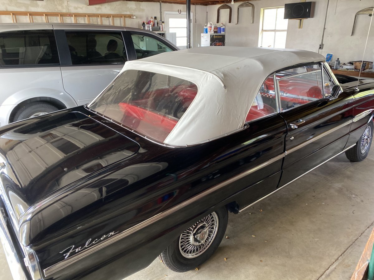

    IMG_1266.JPG Doors and hood back on. Thanks to MikeMerc for suggesting to get all the weight back on the car before measuring the driveshaft for final length. Putting the sheet metal back on lowered the front end considerably and will affect the final length of the driveshaft. Engine is pretty much there... one question on the distributor if anyone knows... so I have a 63 date code distributor and a 1964 2100 carburetor. I ***ume the distributor is original. The carb is 64 Fairlane/mustang according to the code. Probably donated during the trans swap in the 1970’s. The vacuum advance is the threaded type and barely holds a vacuum. Drops down rather quick using my vacuum pump... also has a bunch of washers stacked inside lol. Not a good sign. I cannot find the correct replacement anywhere. It appears 1965 onwards are easy to find and are adjustable but nothing for 63-64 2v 260. From what I read the advances are rather specific...any experience on an early Fairlane or 64.5 mustang vacuum advance?
