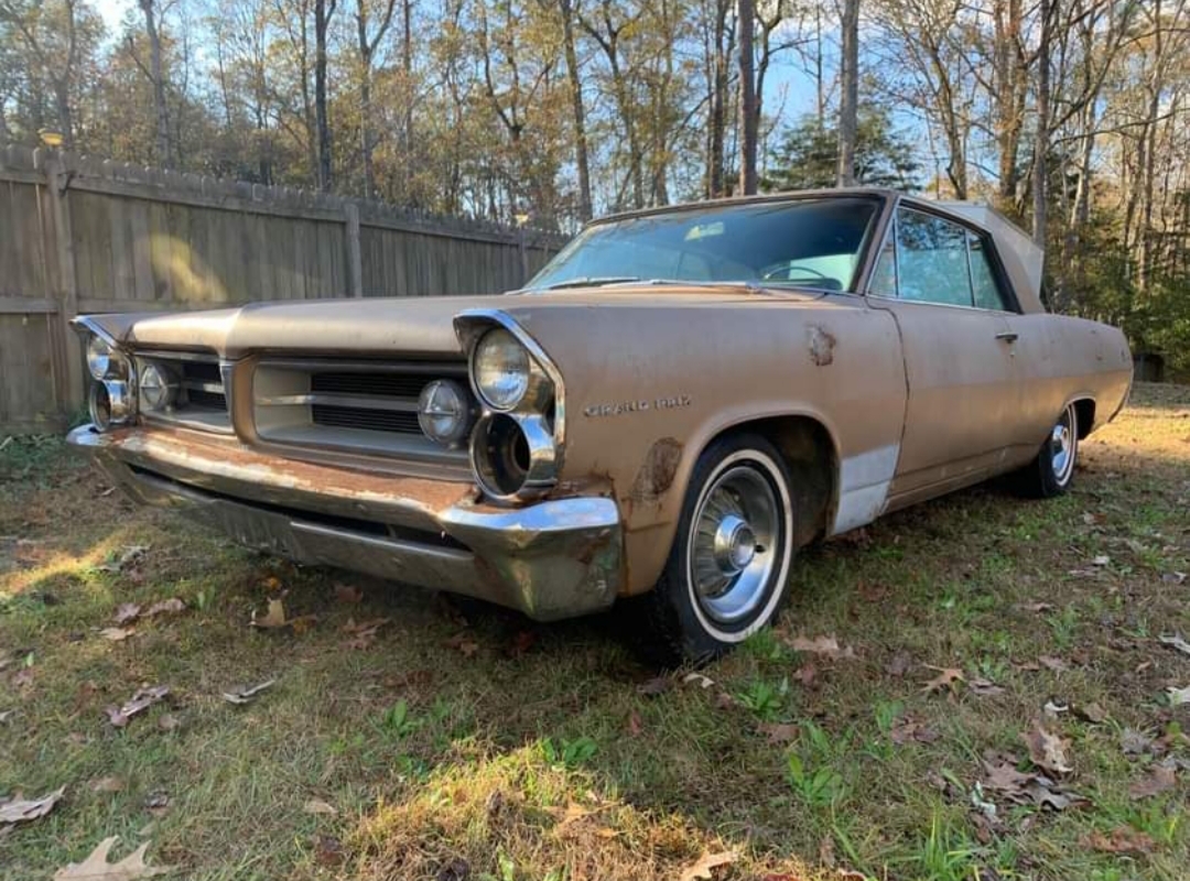

    Picked up a 63 Grand Prix. The "slim Jim" trans leaks bad and engine could at minimum use a refresh. Thinking I will swap a 200r4 into it because of size and gaining a overdrive. So being a 63 it will require a expensive adapter kit to swap a different trans in it. Should I just look for a newer pontiac engine? I'd like to keep it pontiac powered. Or should I just freshen up the original 389, buy the adapter kit and swap a normal trans in it.
