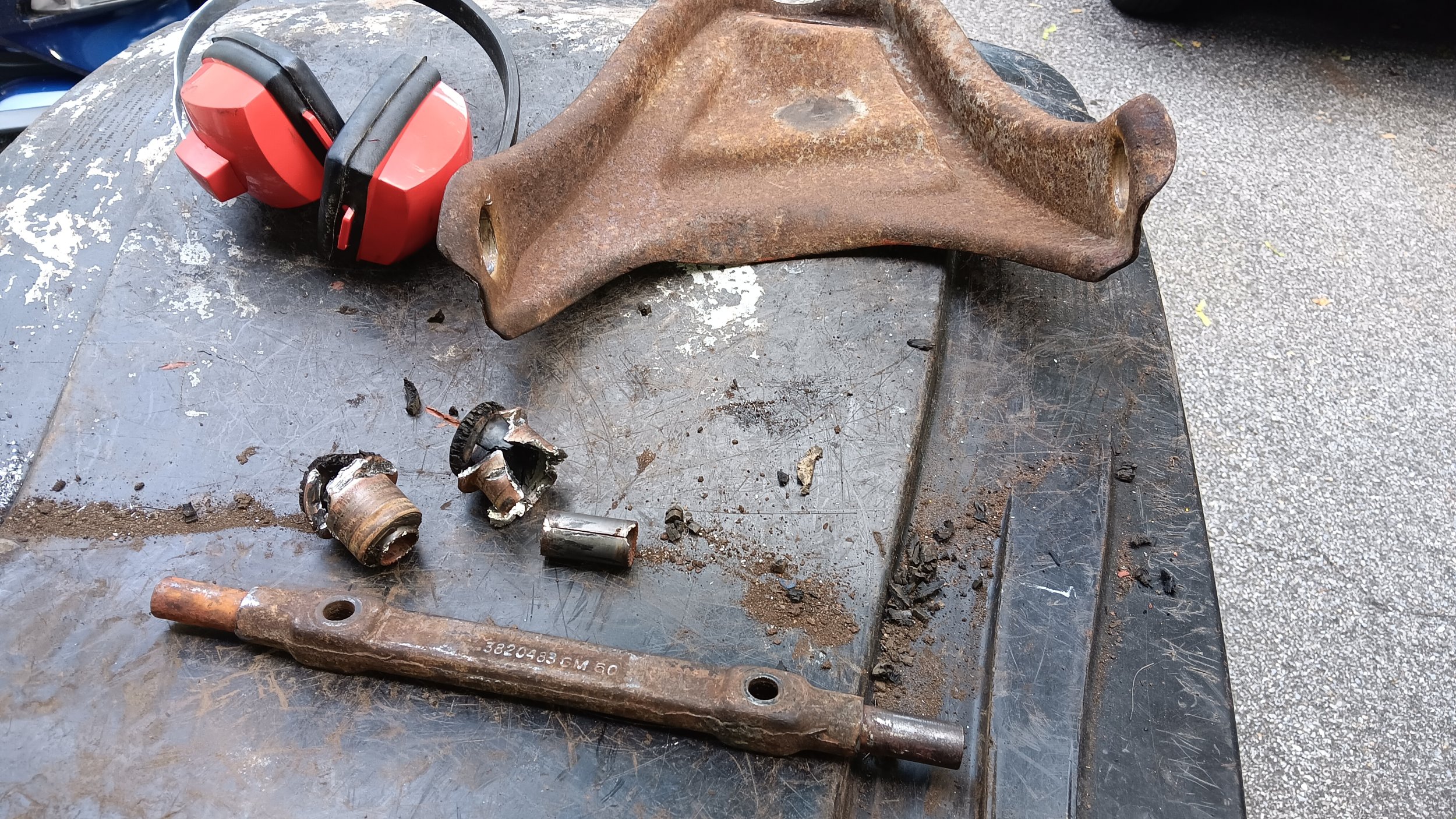

    This was a year back on my Belair. The old ones were the usual battle coming out. I was working outside on top of my big garbage bins, a great height for a bad back.
    Once apart, get everything clean. I used never seize for re***embly. Which I did in my big bench vise. I keep some old beat up sockets to hammer them in.

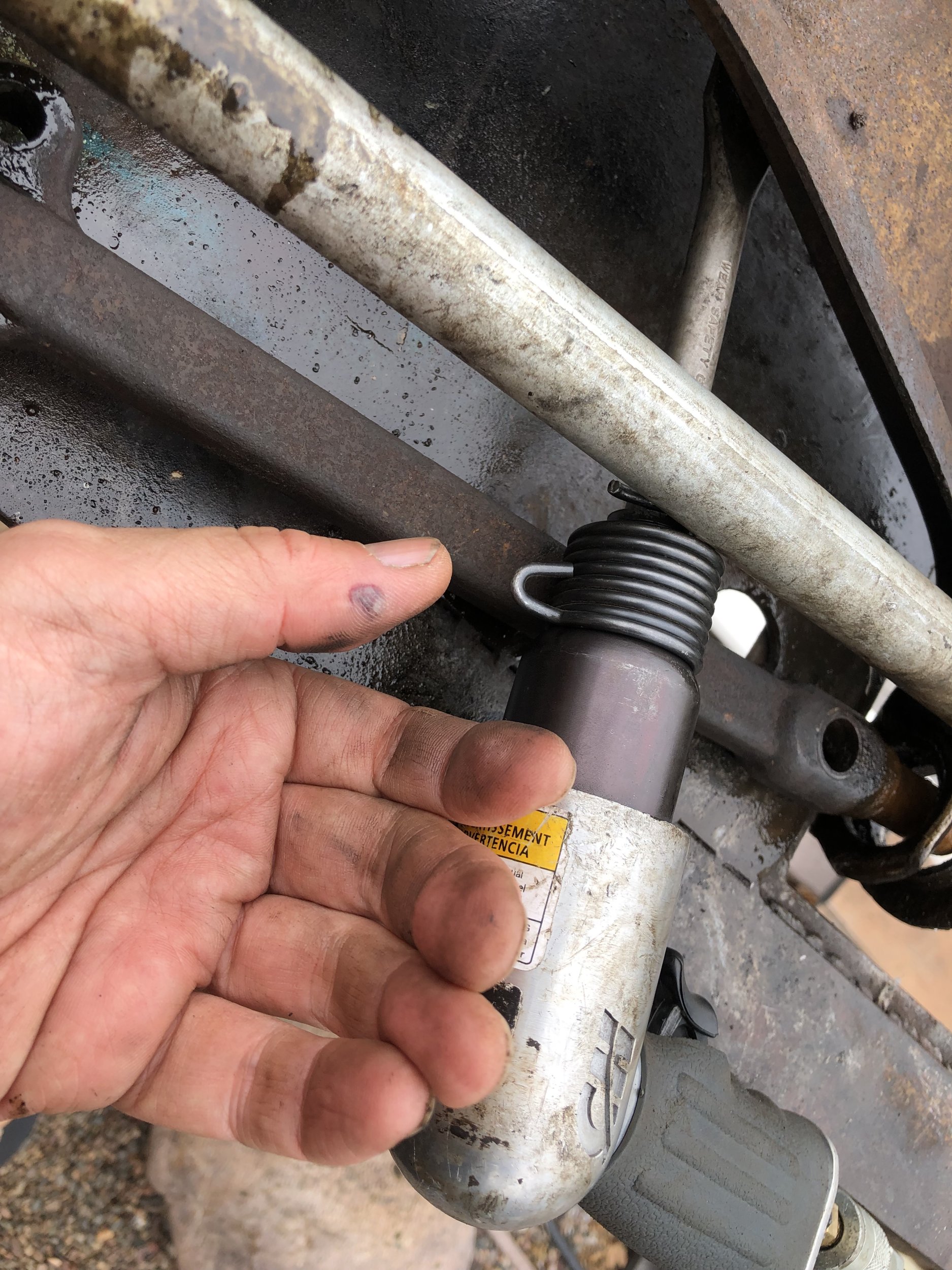

    Owwww MOTHER ****ER! OWWW OWW ****KKKK
