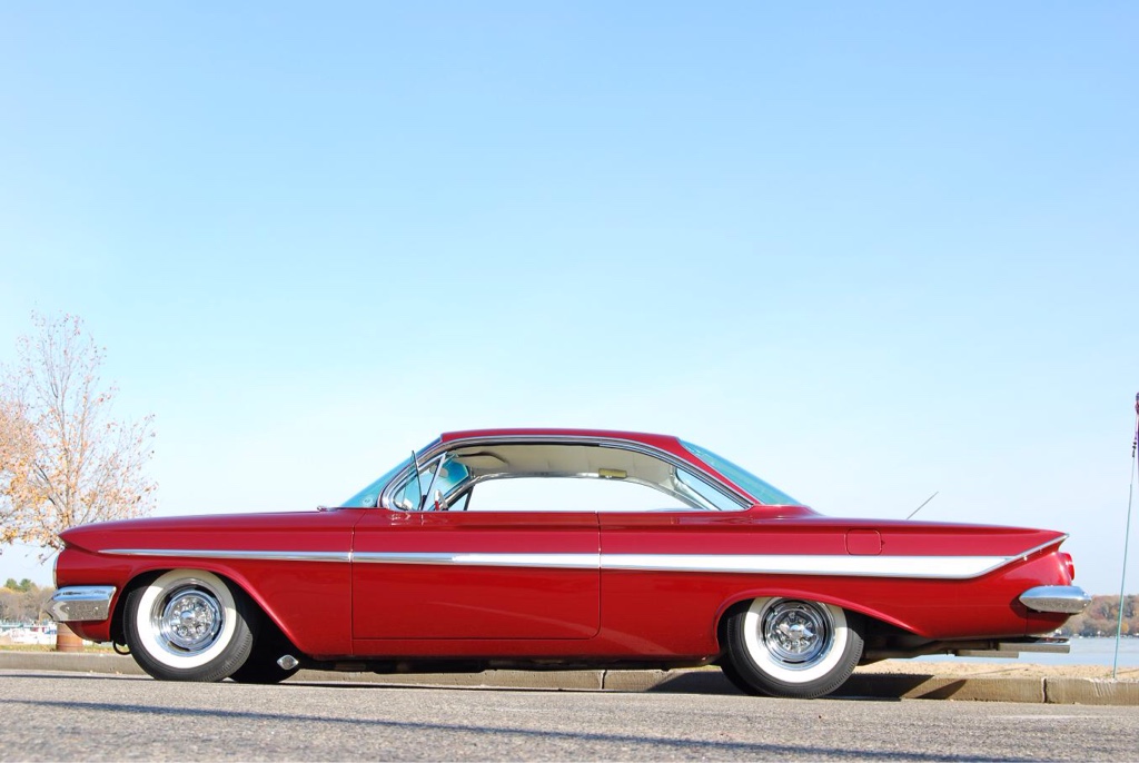

    I lowered a '61 Bisquickie w/S-10 front springs front and rear. Lowered it about 4 inches up front and 4.5 out back. And, they are cheap!! Yards will practically give em to ya!

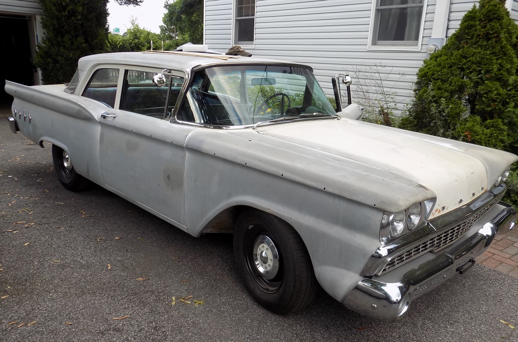

  4. Second attemt yeilded this:
    1-1/2 turns cut from each[all4] coil will let ya still clear a speed bump....barely:D .......First time-I tried two full turns and was on the snubbers with no ride left.

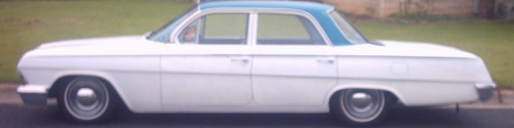

  6. JimC
    Joined: Dec 13, 2002
    Posts: 2,242
    JimC
    from W.C.,Mo.
    I agree with Choprods.
    On my 62, I cut two coils on the front. It was too low, so I had to add a one inch spacer set to each side.
    On the rear, I did not have to drop,
    62's set low in the rear from factory.
    Also, I started with new springs thd stiffest rate I could buy. Older springs which have lost some of the spring rate will yield more drop per coil of cut.
    You also increase spring rate when you cut coils, which gives you a stiffer ride.
    Not to mention the speed bumps Kenny talks of.
    Accompanying photos show car with 16 inch wheels and with 15 inchers.
    Jim

    so many things to think about. how low do you want to go? how do you want it to ride? all cars are different but i would start out with 1 and a half first. depending on how low you want. remember, it is alot easier to take it back apart and cut more than finding other coils. my 2 cents.

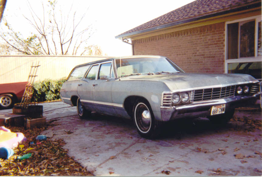

  11. 67Imp.Wagon
    Joined: Jun 16, 2001
    Posts: 1,191
    67Imp.Wagon
    I cut 1 1/2 on the front of My 67 and only 1 in the back. It rides really good still. I would have liked to take 1 3/4 out of the front but I'm to lazy to redo it now. 2 would have been to much on my car.
    before and after photos on the ride height.

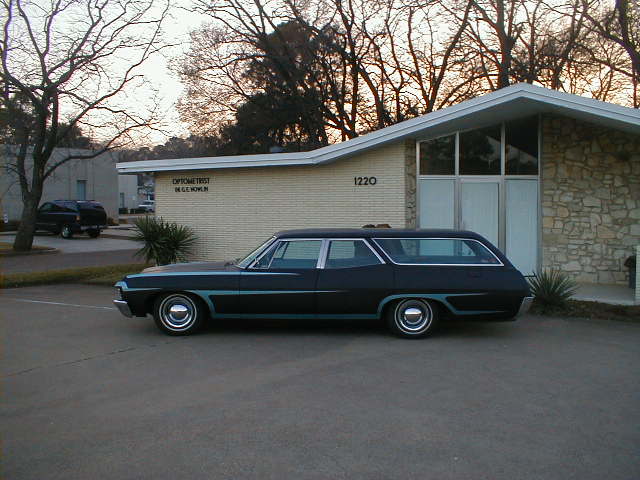

  13. 2 coils all the way around (new moog coils).

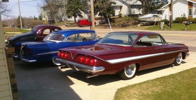

    2 rounds in the front and 1 1/2 in the back. Trimmed the snubbers and set the alignment, been this way for 50000 miles. Rides good and doesn't wear tires[​IMG][​IMG][​IMG][​IMG]

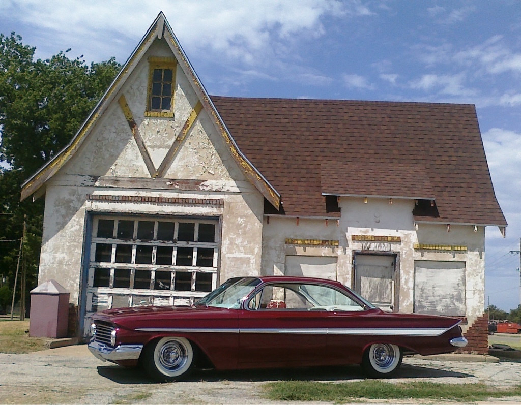

  24. I used 2 " dropped spindles and cut 1 1/2 coils off my front springs. I got the ideal ride height but ruined the ride. I should have cut only one coil but I got greedy.

  26. On my '65 Belair (with a 327), I bought new Moog big block front springs and cut 2 full coils out of them and it rode nice. I forget what the ends are like, but you may have an orientation between the bottom coil end and the top coil end. The Ford springs are ground flat on the top end.

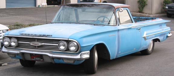

  28. belair_54
    Joined: Aug 17, 2010
    Posts: 85
    belair_54
    from australia
    This thread has so many variables I just bought a 60 El camino and will be cutting the coils but its hit and miss. I had a completely stock 66 Nova with its original 50 year old springs at the front I cut only half coil off and you would swear it had drop spindles. The car was already a little low from the springs sagging after such along period
