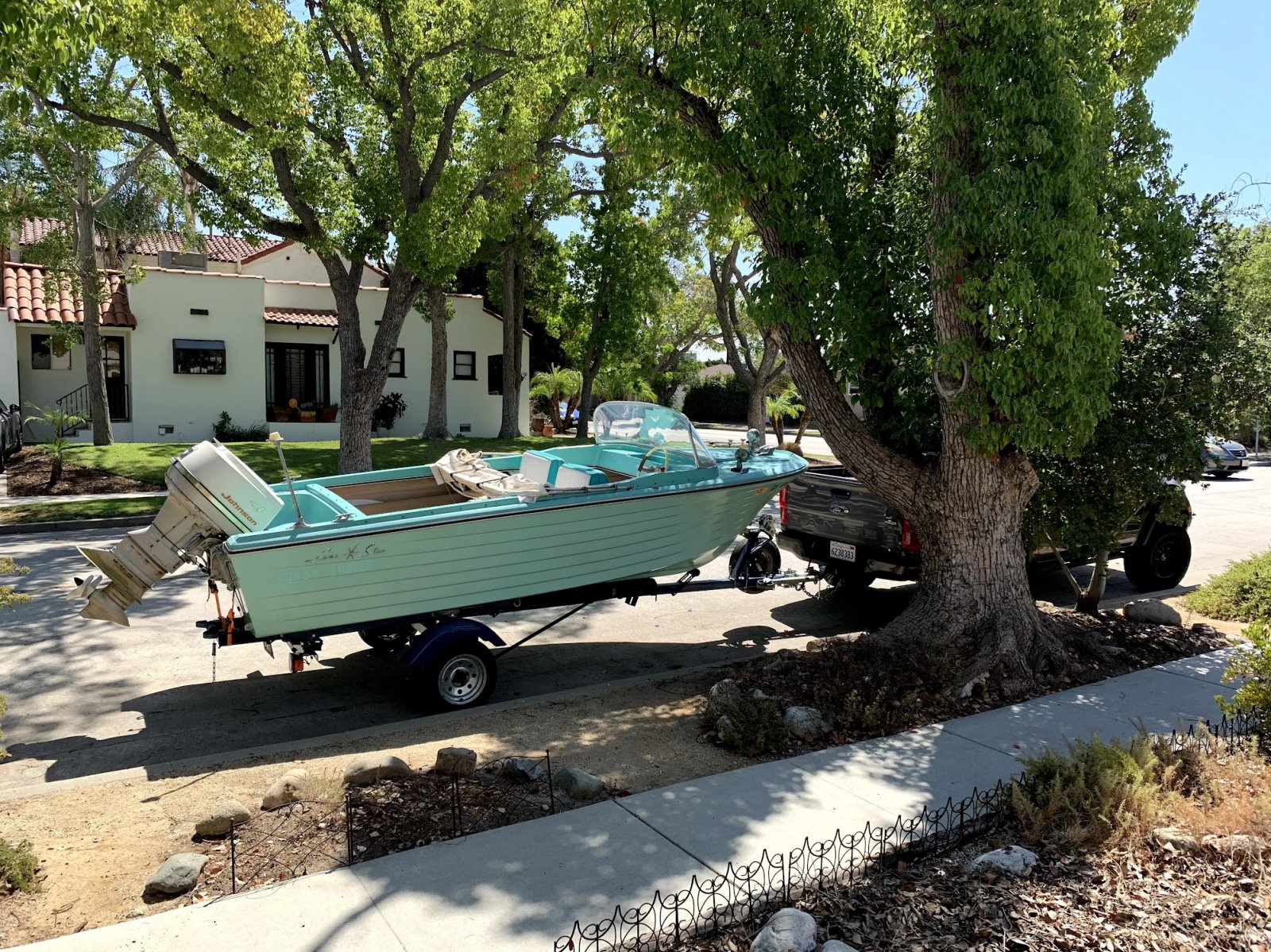

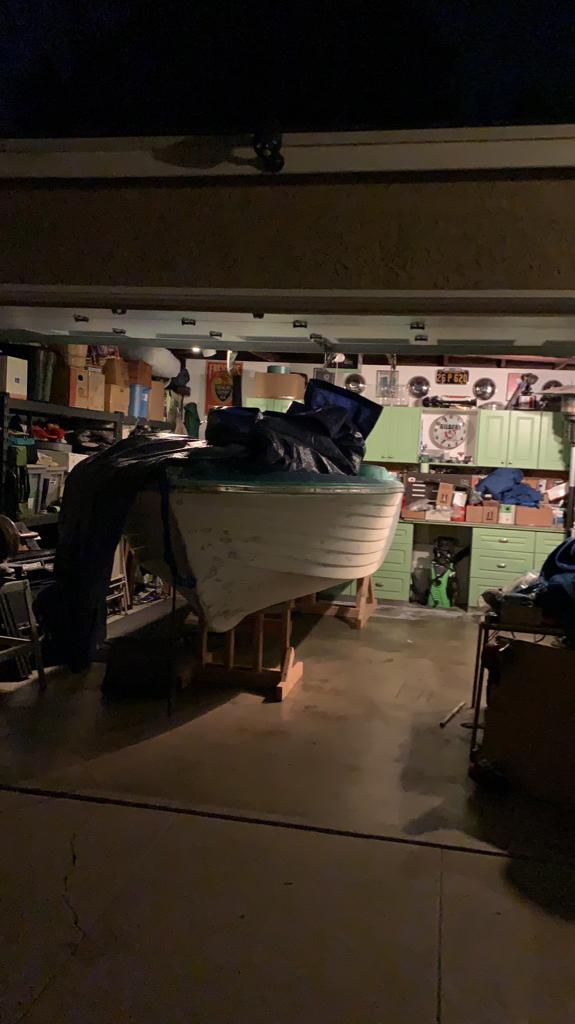

    Picked this up a few months ago and hope to have it back on the water by spring time. 16’ with a 72 Johnson 100 V4. Kicked the 41 out of the garage so my neighbor doesn’t have to hear me working on this day in and day out. [​IMG]

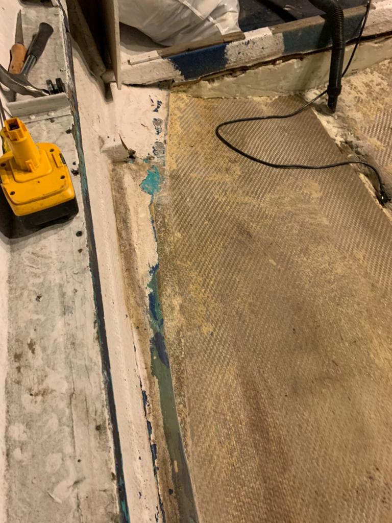

    The seller gave it a **** paint job and the hull paint nearly peeled of from just being on the water. Used a couple of s****ers and a power washer to remove 95% of the paint and the rest with a 5” sander. [​IMG]
    [​IMG][​IMG]

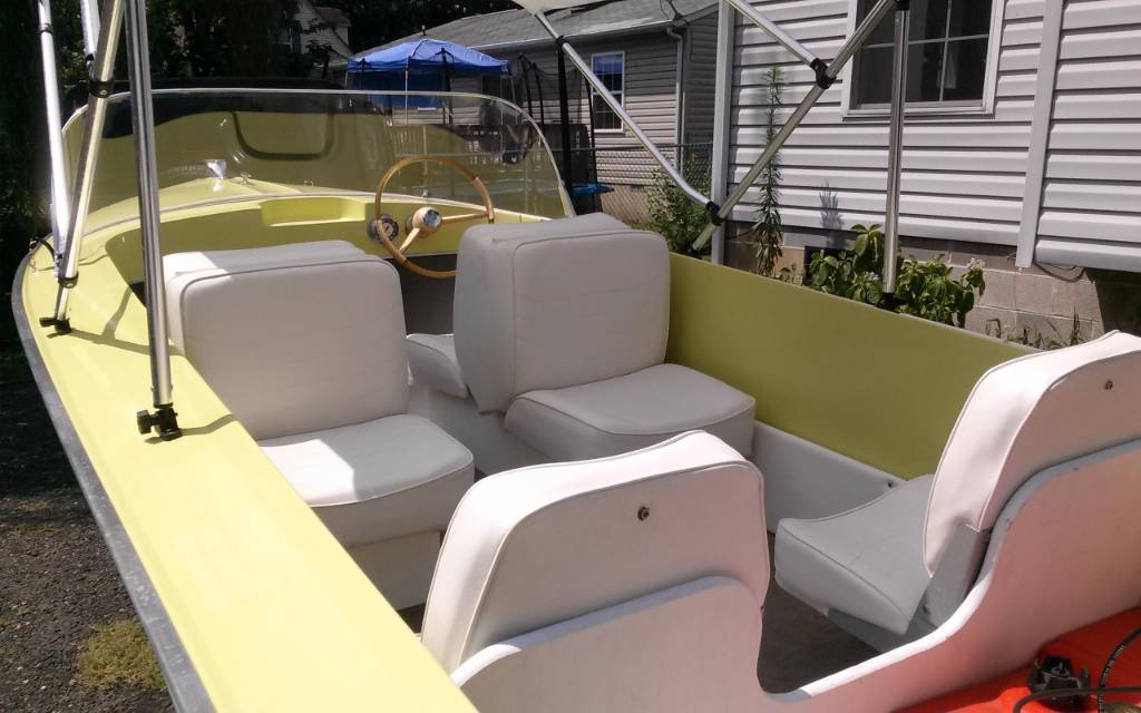

    I restored a boat that my dad won in a sales contest in 1961... Feel free to ask any questions. 0720130817a.jpeg KIMG0089.jpeg 0726131656.jpeg

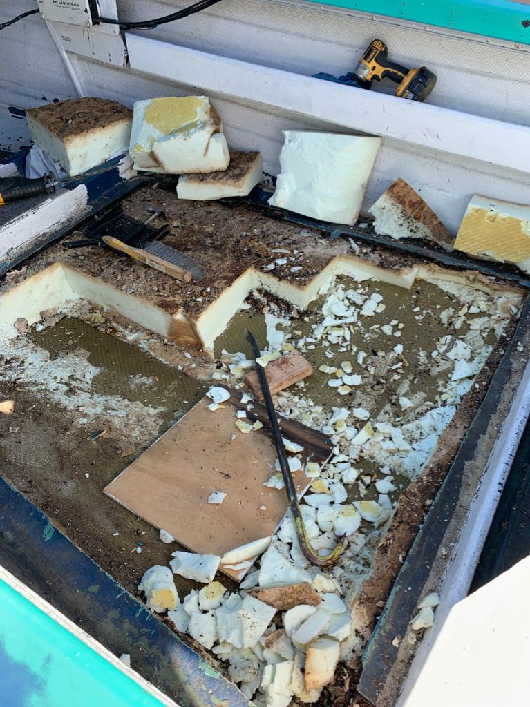

  10. LBCD
    Joined: Oct 28, 2009
    Posts: 1,059
    LBCD
    Just finishing removing the old soaked foam. The original owner put a band aid on the floor by just adding another layer of plywood.

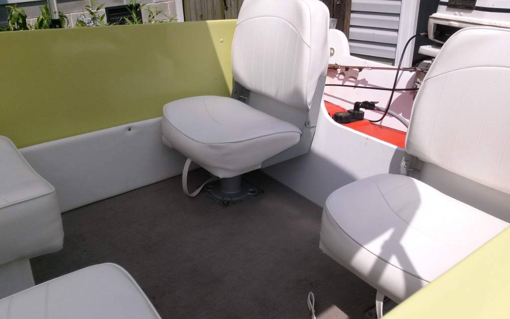

  11. rustydusty
    Joined: Apr 19, 2010
    Posts: 2,522
    rustydusty

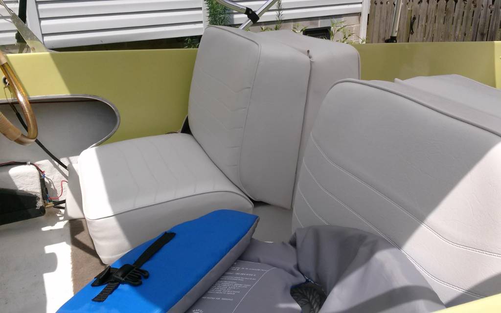

    Just found some pics of the interior. I installed the seat mounting bolts through the plywood before installing it. After installation, covered in with marine carpet... 977692920.jpeg 1896357552.jpeg 80587763.jpeg 1897432354.jpeg 2074730875.jpeg

  12. LBCD
    Posts: 1,059
    LBCD
    Wow! That is nice...did you beef up the floor for the rear seats?
  13. rustydusty
    Posts: 2,522
    rustydusty
    The floor is 5/8" marine plywood with several coats of epoxy on both sides and edges. The stainless seat bolts and fender washers were threaded up through the ply from underneath, acting like studs for mounting the seats. Then the ply was installed with copious amounts of 3m 5200 marine adhesive and stainless screws into the sub floor. All in all, very strong... you can see the studs coming up through the ply, in one of the earlier pics I sent. I installed the carpet with indoor/outdoor carpet adhesive, and a notched trowel.

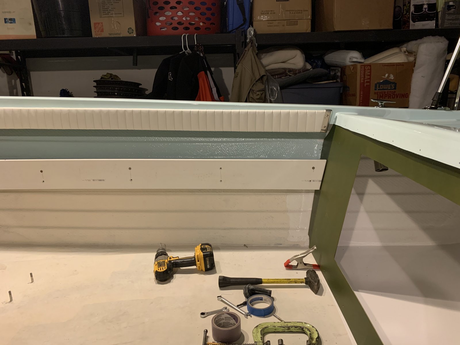

  19. LBCD
    Posts: 1,059
    LBCD

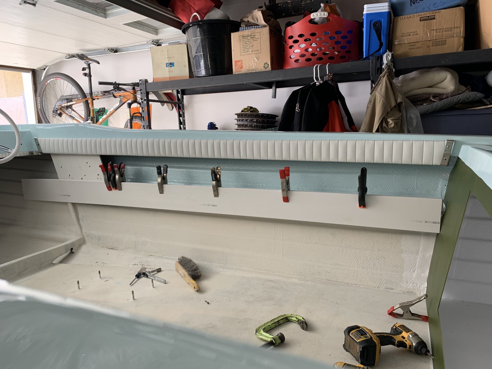

    60E5114D-7E1B-4520-A49C-F991155A86AA.jpeg F89C28FB-918E-4F07-8BB6-55C6D944D667.jpeg 6B02304C-71A3-47D6-BBD7-DEC24B83E4F0.jpeg EBC1C47E-B48F-4ECC-939F-7E67BEC5CE58.jpeg 92D923E0-2F6D-42AE-BF95-31C39C59B9E5.jpeg E96E9C9F-E051-4F6A-9E48-F537D900CC6E.jpeg 8AB3E154-F07F-41C9-8B54-36F5AF54E22B.jpeg 285CDD43-7D8E-44DE-BD93-4F9429518234.jpeg
    Been busy but have gotten a few things done. Starting on the top side paint today.

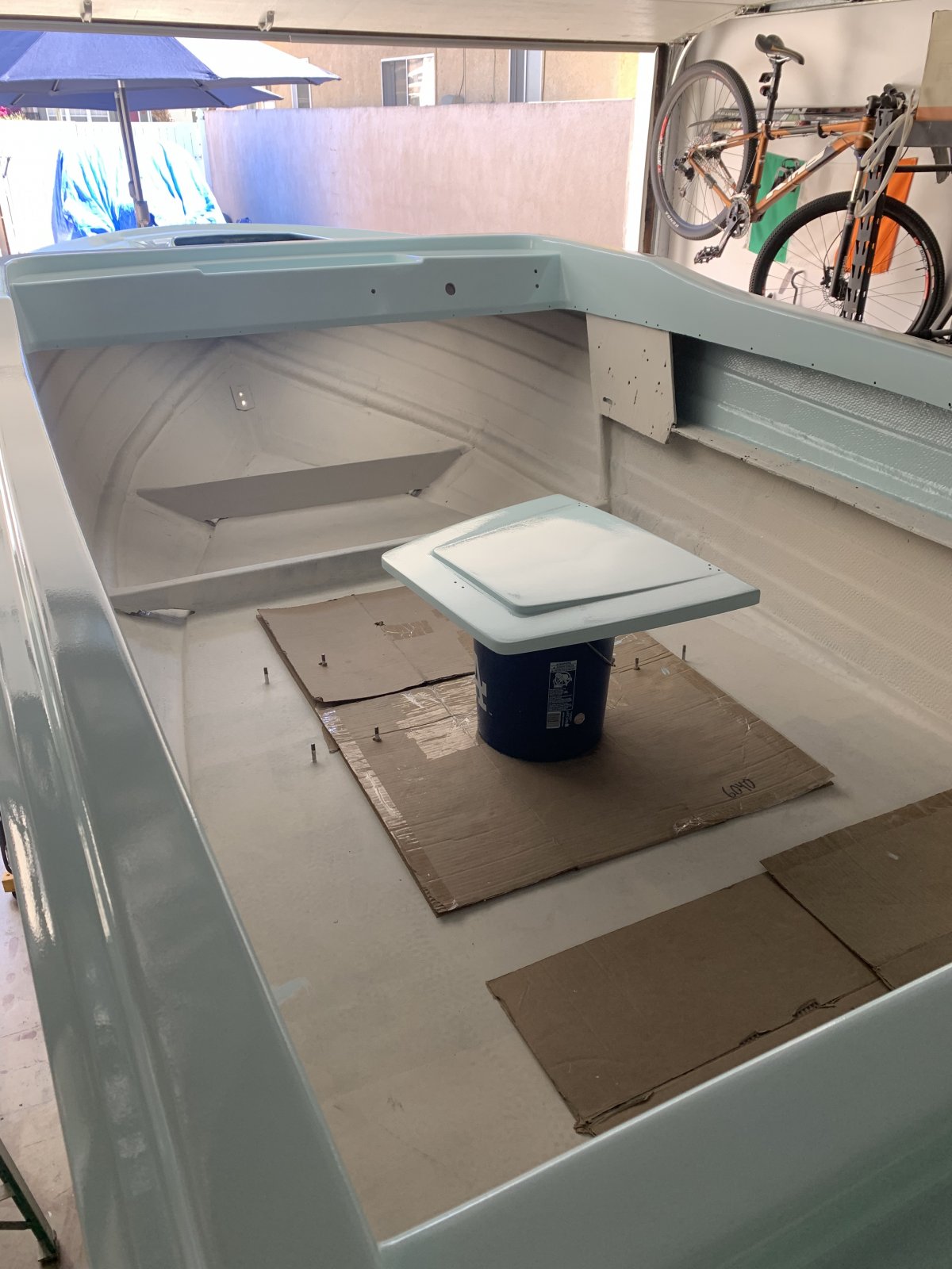

  20. LBCD
    Posts: 1,059
    LBCD

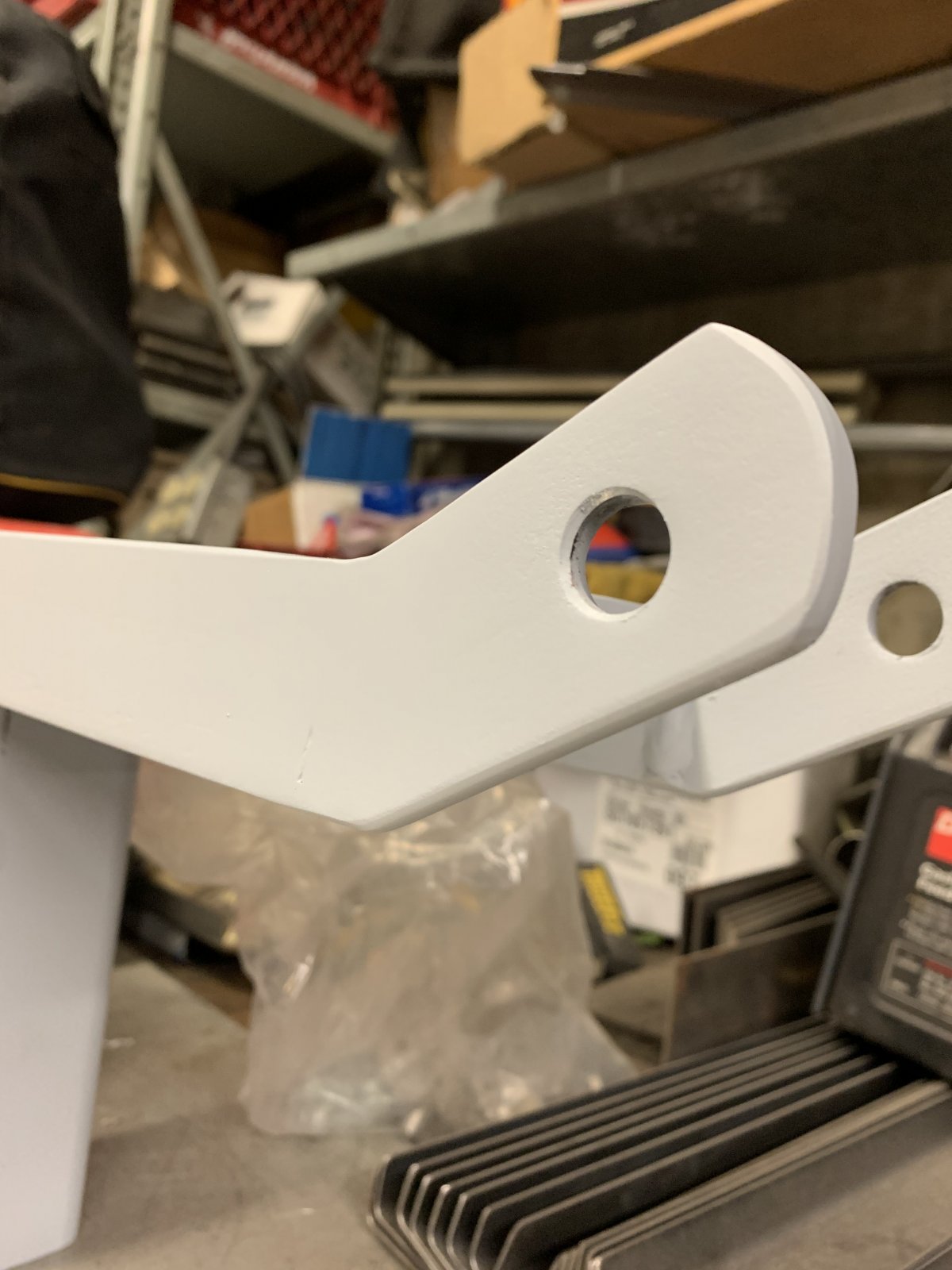

    062BCB8C-6189-4511-8BB3-90038406889F.jpeg 009D543F-8B0C-4B0E-AF5C-AFBC9A516AC5.jpeg 5A3DFF50-F8A2-4E88-A38E-015E039A923C.jpeg C5F50358-97E5-433A-9E2A-7CDE23A696EF.jpeg D0C4CF25-0E52-4351-90AB-BCE17404C23F.jpeg A8923F45-F73F-4EEB-A8C8-3087C0B0956E.jpeg 7F492C13-EF92-4390-8EB6-F0F8FB34DE6E.jpeg Starting to take shape

  21. LBCD
    Posts: 1,059
    LBCD

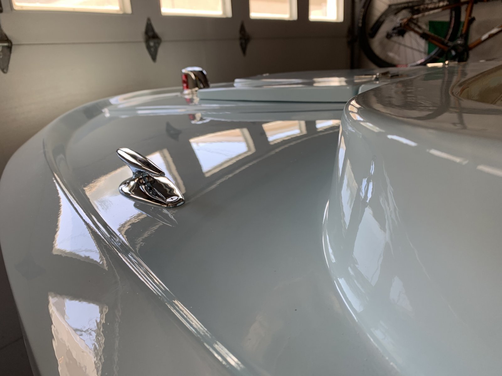

    This past 15th of Sept was the one year anniversary of buying this boat, been a lot work but it’s finally on the home stretch.
    7084CFED-8BD9-45D3-B593-4B6C6FCFF7B4.jpeg 152FB0E3-E533-45EC-9A71-4D88E506EE19.jpeg 9513C835-890A-4ECE-AC27-A1B609194351.jpeg 7C4058CB-4A45-41C0-9A5F-DD447D4852D2.jpeg
