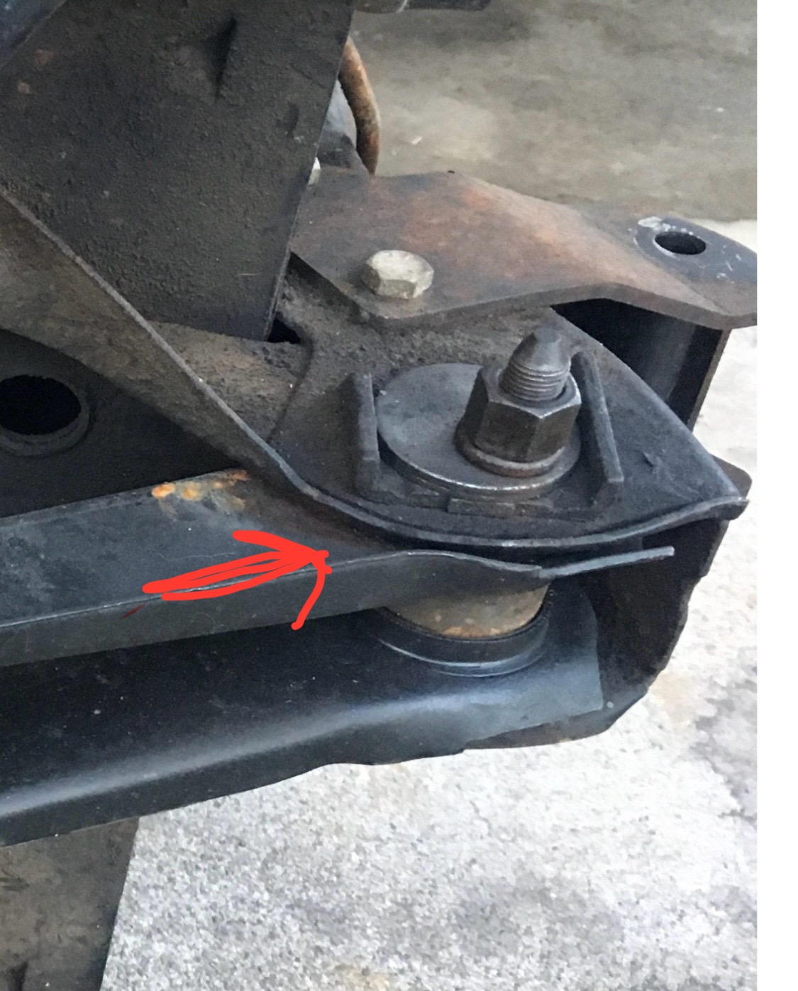

    Did you reinstall the barbed spacer that goes between the control arm bushing and the pocket for the control arm? If not, lower arm will walk in and out. IMG_4113.jpeg

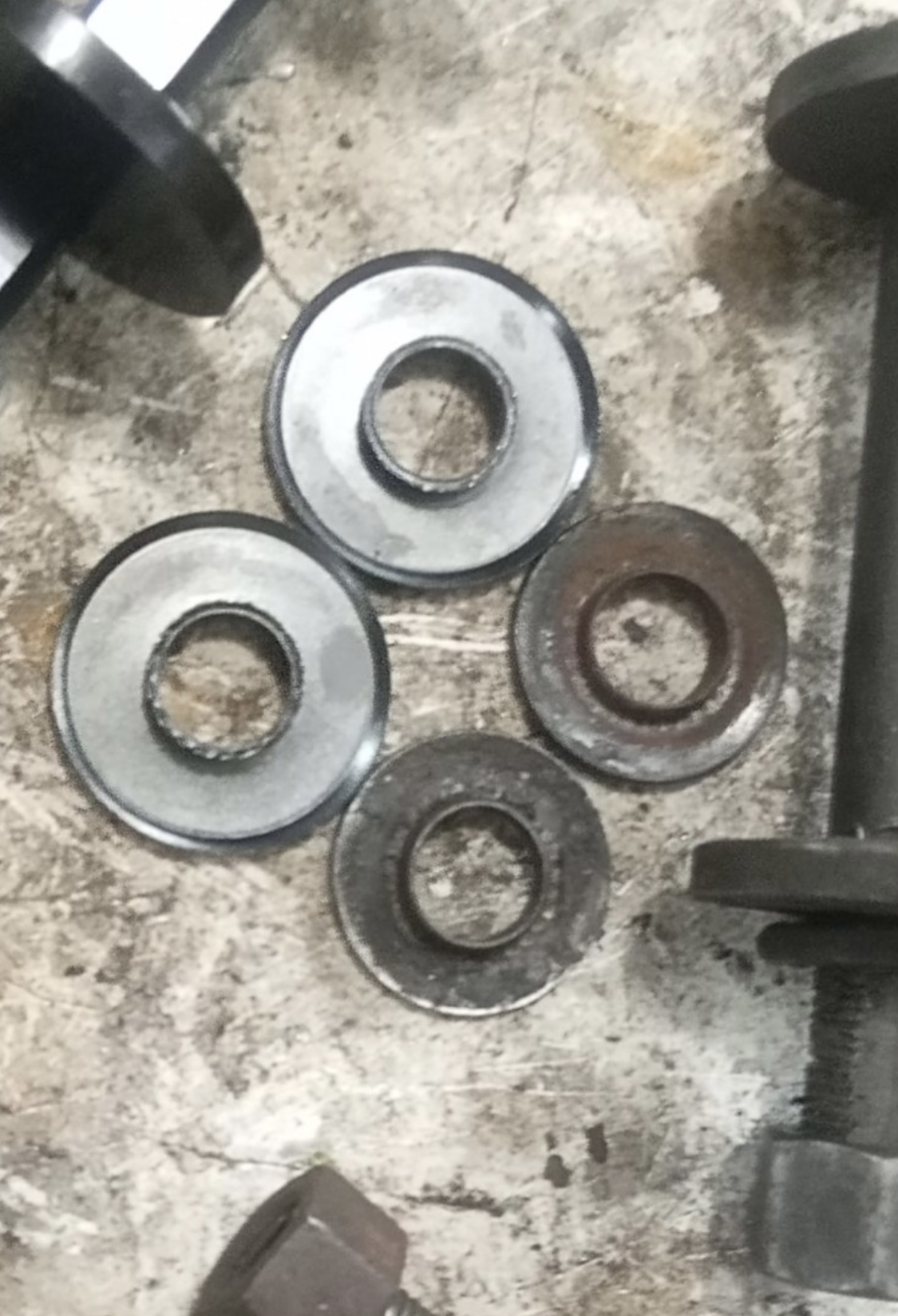

    ok so I tore it apart. I used regular washers on lower control arm. I found the original ones. They looked flat and wore out so I put regular washers in.
    I ordered new camber bolts and washers . Hopefully that's all it is.
    Thanks for the education. I am used to dual a arm with spring in between.
  12. Johnny Gee
    Joined: Dec 3, 2009
    Posts: 14,470
    Johnny Gee
    from Downey, Ca
    It’s been a great many years since doing one. That said I did some looking and found out the the after make these t-bushings but they are smooth. No good. This is how I remember how the factory spacers looked.
    How it works is the inner steel sleeve of the control arm bushing bites against the inner side of the space and the outer side of the spacer bites against the pocket the control arm fits into. These also keep the control arm pocket perfectly parallel making for good even clamping force. IMG_4117.jpeg IMG_4114.jpeg IMG_4115.jpeg
    AHotRod, RodStRace and bobss396 like this.

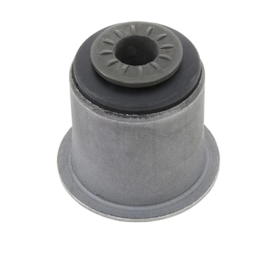

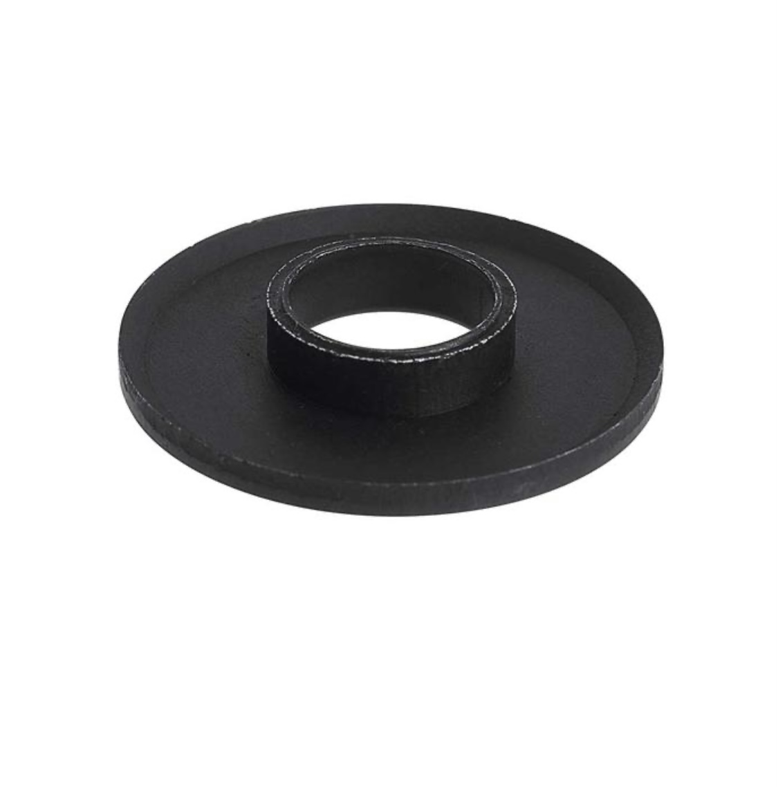

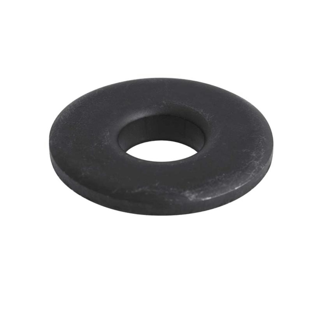

  13. Johnny Gee
    Joined: Dec 3, 2009
    Posts: 14,470
    Johnny Gee
    from Downey, Ca
    Here’s what the aftermarket t-bushing/spacers look in comparison. IMG_4119.jpeg IMG_4118.jpeg
