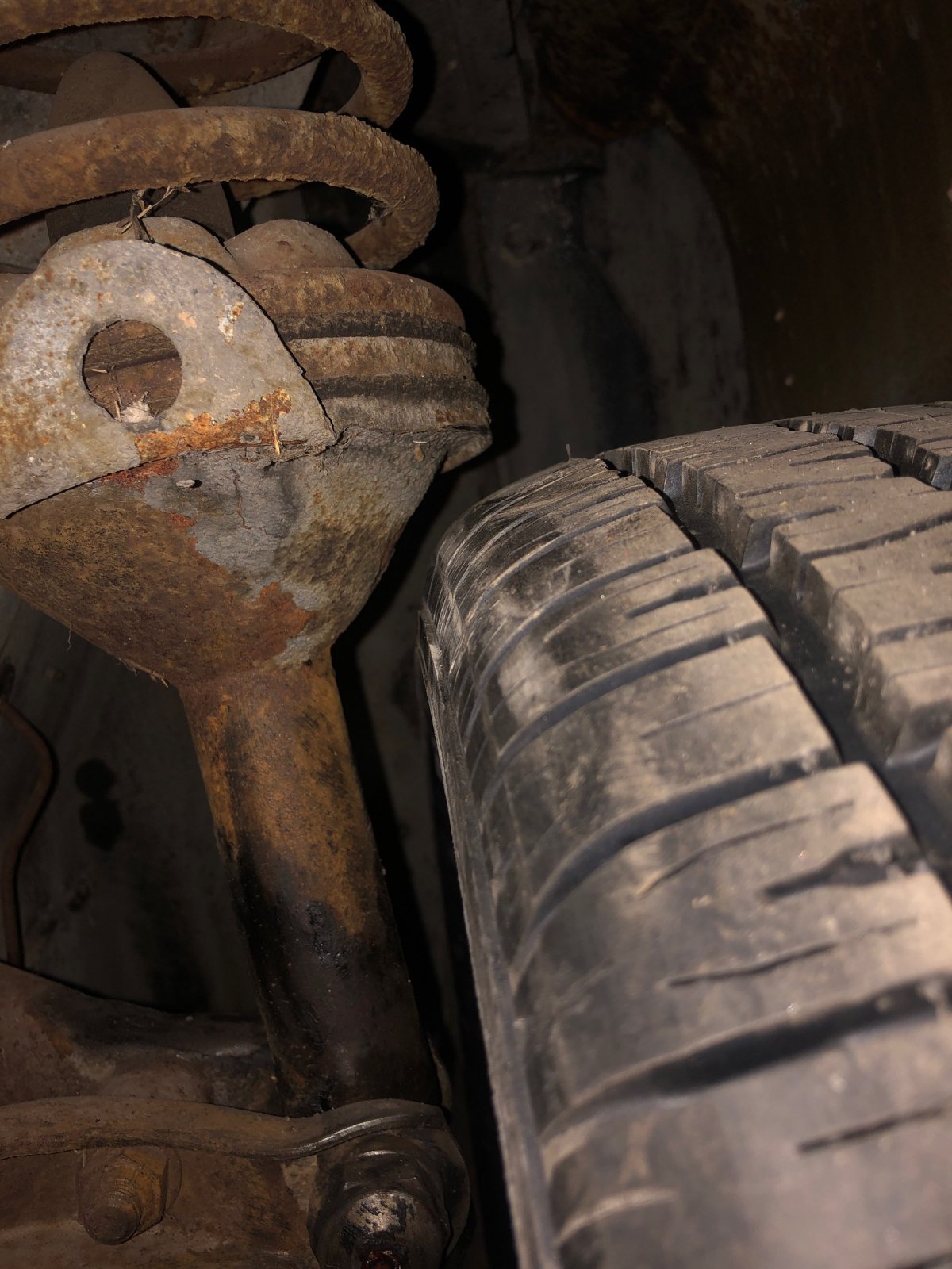

    Tires Tires Tires got the new tires mounted on the front wheels. Dad put it on the car and took the pictures. IMG_2316.jpg 661222202.jpg

    Those cars had a unibody construction. Be sure to carefully inspect the rocker panels and anywhere a suspension/steering components mount for rust. They had a wishy washy suspension and good stiff sway bars and shocks are a must. I used to have to deal with these when they were new. My father built the first American with an overhead valve engine, which the factory said would not fit. Blueprinted, fitted with an overdrive transmission and 4.11 gears and other things I can't remember and some factory changes to the parts books to make it legal, it won the first stock production road race for compact domestic cars at Castle Rock, CO in 1960. Got to the race a lap down and won by a half lap on borrowed wheels and tires. That was the advent of the Falcon, the Corvair, etc. Winning that, it was off to Daytona. It timed in at 138 MPH but a sand pocket in a cylinder wall let loose and put it out of action. Very disappointing.

    If you read the whole thread you would see how solid the car is and what has been done to it.

    We did patch the only serious rust that we know of earlier on.

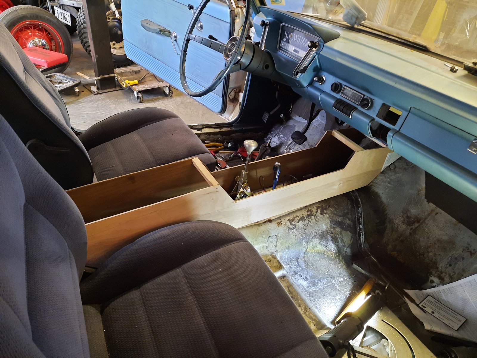

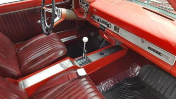

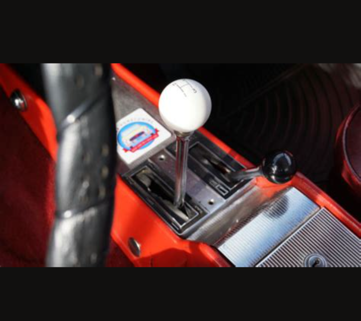

    I've been having in hard time trying to find a sheet of decorative metal to use for the center console. The original center consoles had a lined chrome sheet going down the length of the console. I'd like to match it as close to original as possible but am totally willing to use something different if it looks cool.
    wanted to put this out there in case someone had some old metal laying around they don't need. 20210511_191054.jpg Screenshot_2020-11-26-11-01-05-1.png Screenshot_2020-11-17-23-04-52-1.png

    I would look to buy a piece of stainless steel and engine turn it, that gives a good look!

    Got a s****yard close by? Find a stainless refrigerator door. It will just be a thin layer piece of stainless over a molded plastic door. Many different finishes possible, brushed, polished, engine turned.

    Pet screen,< what is used for screen doors to keep[ pets from braking through screen. Is often in patterns of a number of shapes that could look good on top of a smooth sheet

    My Dad suggested that awhile back when we were first working on the console. I like the idea and that's most likely what it's going to be. Just wanted to see if anything else was out there before committing to something

    We have a car s****yard that's pretty picked through but I'll take another look somewhere there's no snow.
    There's also a metal s****yard/recycling place but I'm sure they wouldn't let me in for safety reasons.
    I'll probably just do engine turned stainless.

    "Be sure to carefully inspect the rocker panels and anywhere a suspension/steering components mount for rust. They had a wishy washy suspension and good stiff sway bars and shocks are a must."
    The suspension is just a pre-ball joint design. It came out in 50 on the Nash Rambler, 52 on the big Nash cars -- ball joints came out on Fords in 54, not sure when the others switched but all but Studebaker and AMC did in the mid 50s. Ball joints are so ubiquitous now that if it doesn't have them it's odd! Works well, much better than king pins! AMC put what little engineering money they had into other, more important things. The trunnion suspension worked well if maintained (greased!).
    The issue with body roll is more readily resolved with stiffer springs. Up until the late 50s there weren't many good high speed roads. Most roads were a bit rougher than expected today. As a result the cars had to be spring softer to soak up bumps on those rougher roads and ride good. That and the fact that they had stiffer bias ply tires. Run softer sidewall radials and the car gets REALLY soft! The high mounted spring suspension is actually pretty roll resistant, but the soft springs will make you wonder how! Get new springs at least 10% stiffer than stock, though 12% stiffer seems to be the sweet spot with radial tires. With 10% you'll notice a reduction in roll but hardly any difference in ride, with 12% you can tell it's stiffer, but not too much so. Factory HD springs were intended for hauling heavy loads and are 15-18% stiffer than stock. They ride like an old HD pickup -- VERY hard!! www,coilsprings.com will make them however you want.
