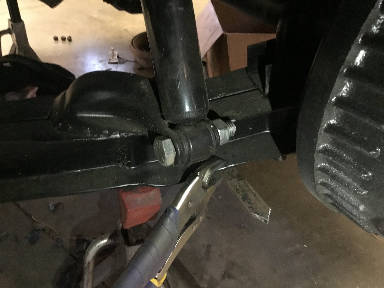

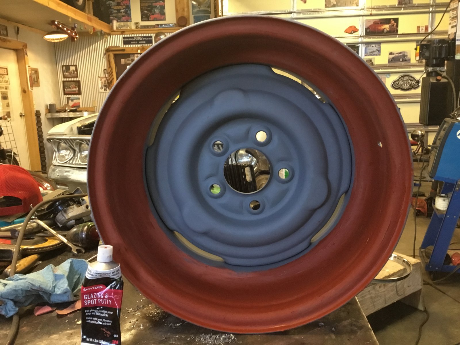

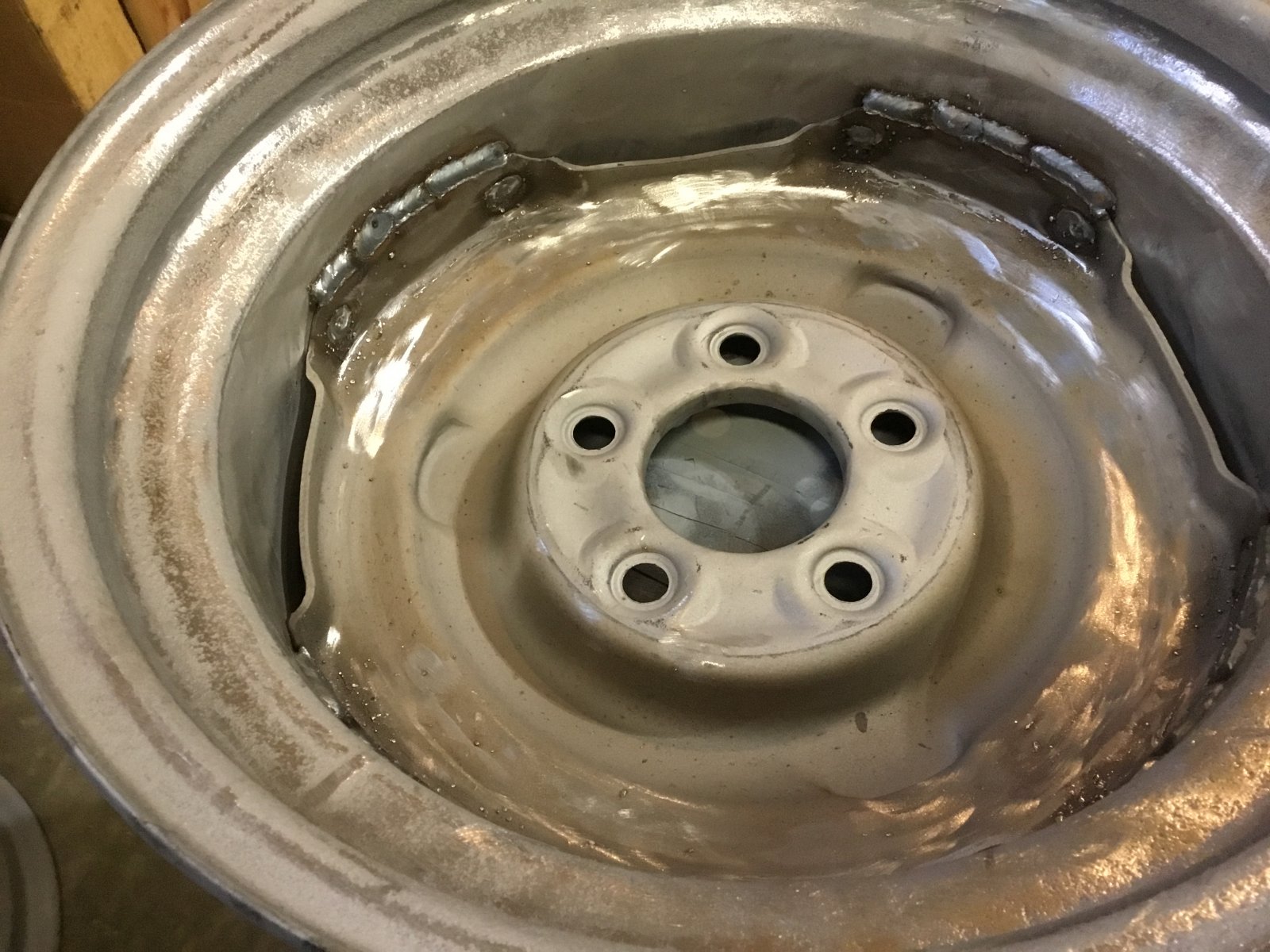

    I feel bad not working on Brooks car the last month plus. We have our local indoor winter car show in a month and we need to get busy so we can at least roll it in so the Rapid City crowd can see what a 20 year old kid ( and dad) has been doing. We finally got his rear tires ordered so it was time to get busy building his rear wheels. We took the center out of the rambler wheel and used a salvage yard white spoke wheel for the hoop. This will result in a stock appearing wheel but be 8” wide. DD7C2543-488F-4D6E-B22B-B5D64A58474E.jpeg I figured out our backspace and then used this little pointer that I clamped solid to the trailing arm. I then rotated the rim until it just touched the hoop all the way around. 7E2066B5-04FA-4C8C-8CCF-0A869DD75E33.jpeg I then tacked the wheel together thru the old rivet holes checking multiple times during the welding process that the wheel was still running tru. 84CE815D-F124-4943-B353-DB3BFFE0A309.jpeg The white spoke hoops had some minor rust pitting so it got a coat of glaze and some high build primer.

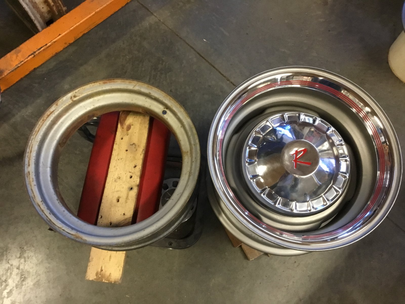

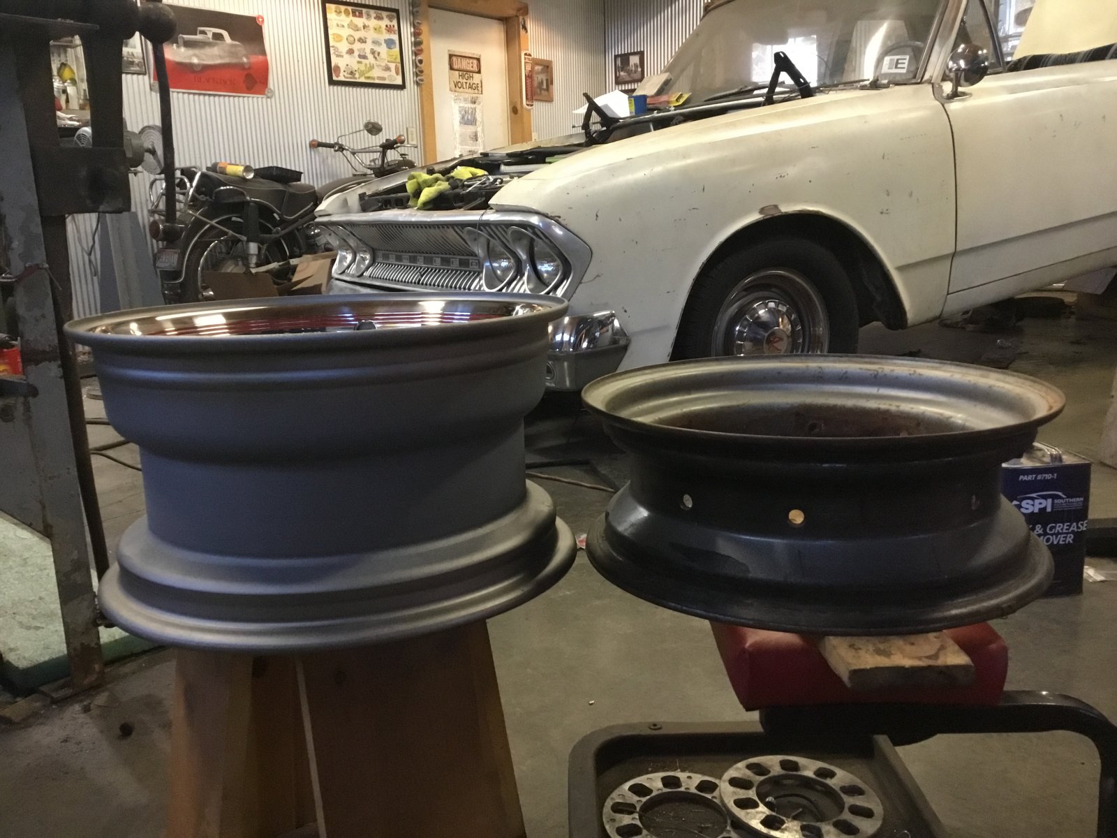

    I had the day off so I got Brooks rear wheels ready for tires on Monday. CA5D3E43-487B-48D7-94ED-8B88FAA51B94.jpeg The hoop on the left was the stock rambler wheel that we took the center out off to make the new wheels. 752FA82B-5D1E-4DF3-8C38-E5CAE34C64B9.jpeg Here’s the difference in width. It’s a huge difference but will still be pretty subtle. DD9AC0FA-FF1E-4D25-9A90-34EFD6AB3B2A.jpeg

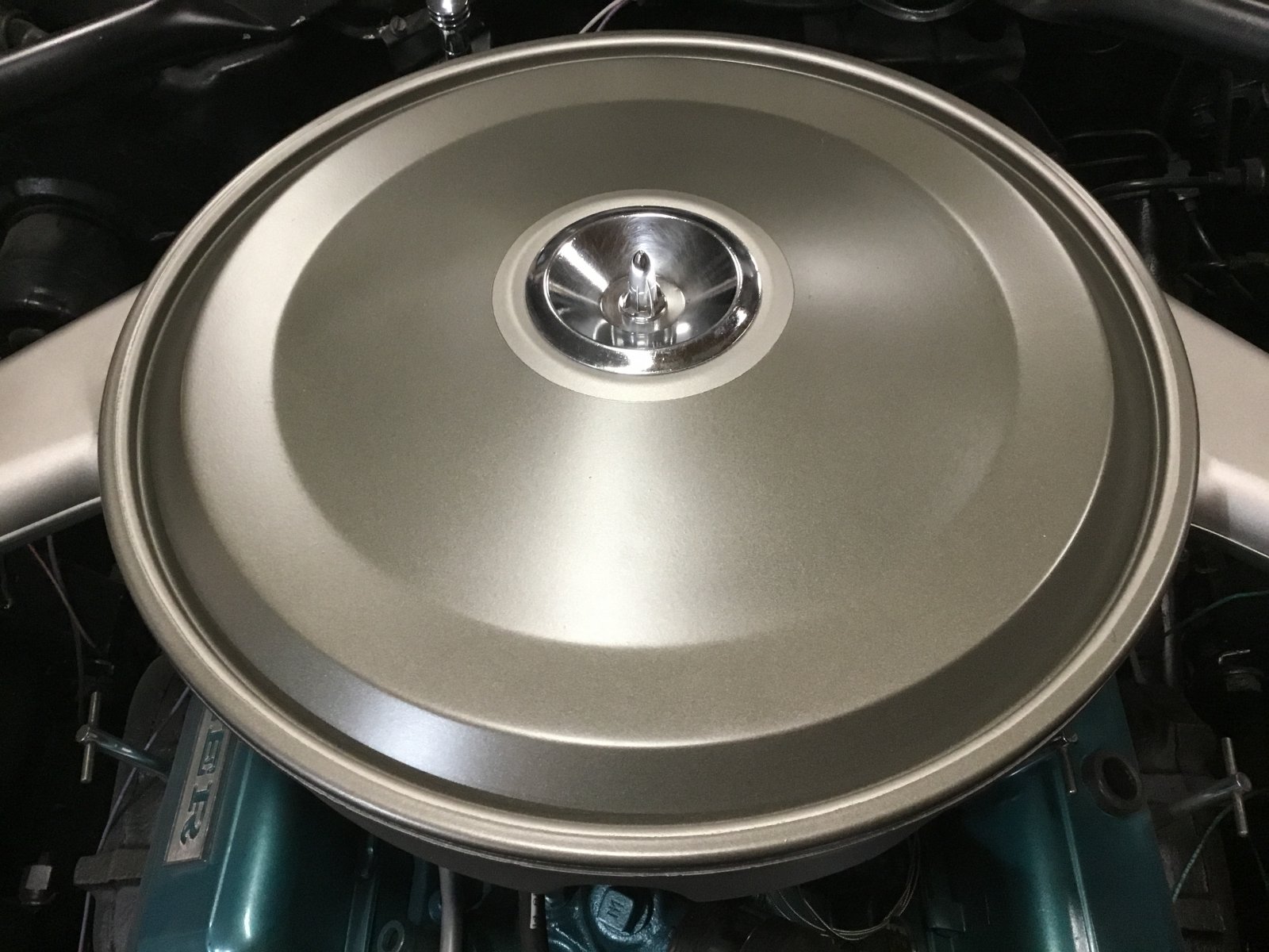

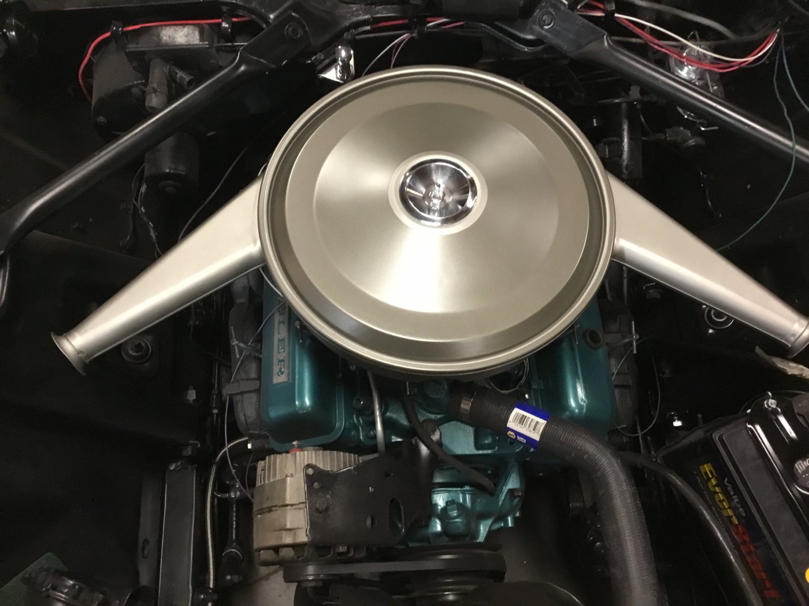

    We had quite the time painting the aircleaner lid. Blasted it clean, primed it and then pained it the same stainless steel color that we used on the wheels. We sprayed it and it came out blotchy from the metallic in the paint. Gave it a light buff sprayed it again and it came out the same way. So today I masked it and gave it a two tone to cover the blotchy parts. I think it looks even better than if the first job would have come out right. It adds just a little but is still really subtle. 02FB35BB-12C1-4A04-A27F-1665F62F25CA.jpeg E3BB6005-0264-4C23-8642-4CBC4684EC4C.jpeg

    Is that an original air cleaner ?
    loudbang and Stogy like this.
  20. Greenblade
    Joined: Sep 28, 2020
    Posts: 587
    Greenblade
    It's a 1967 oldsmobile Toronado air cleaner

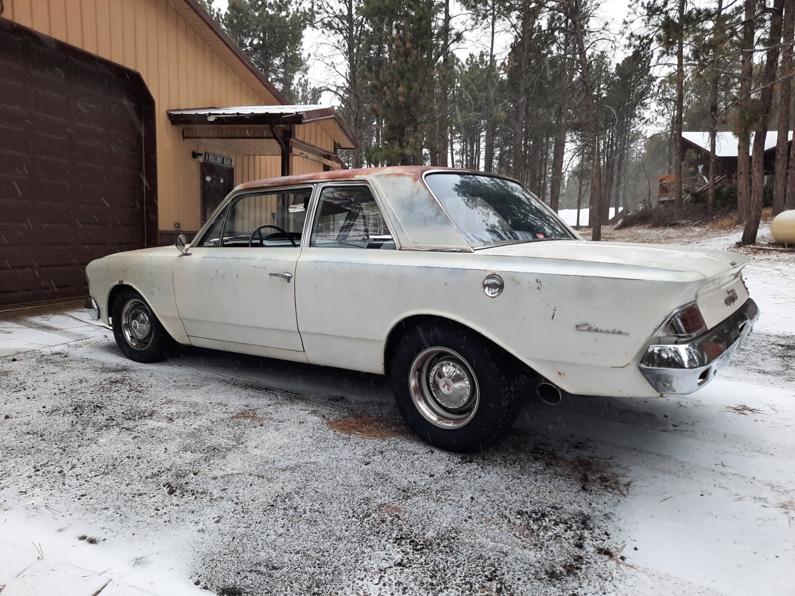

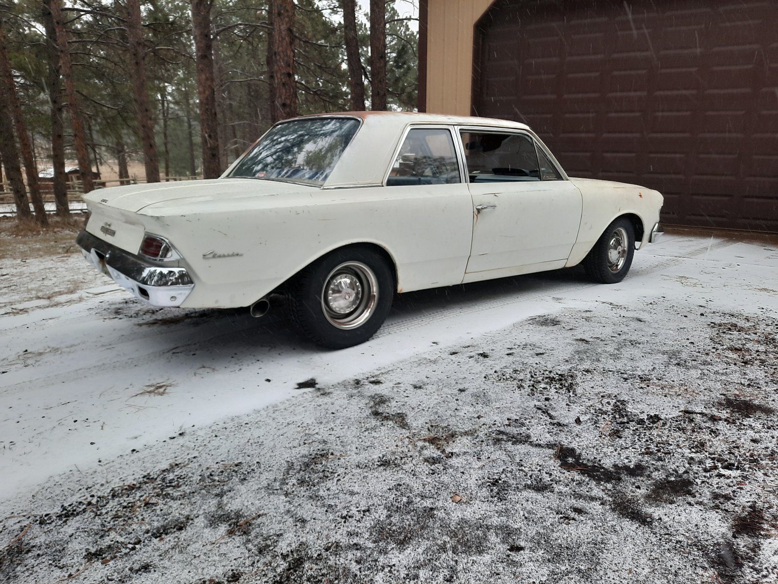

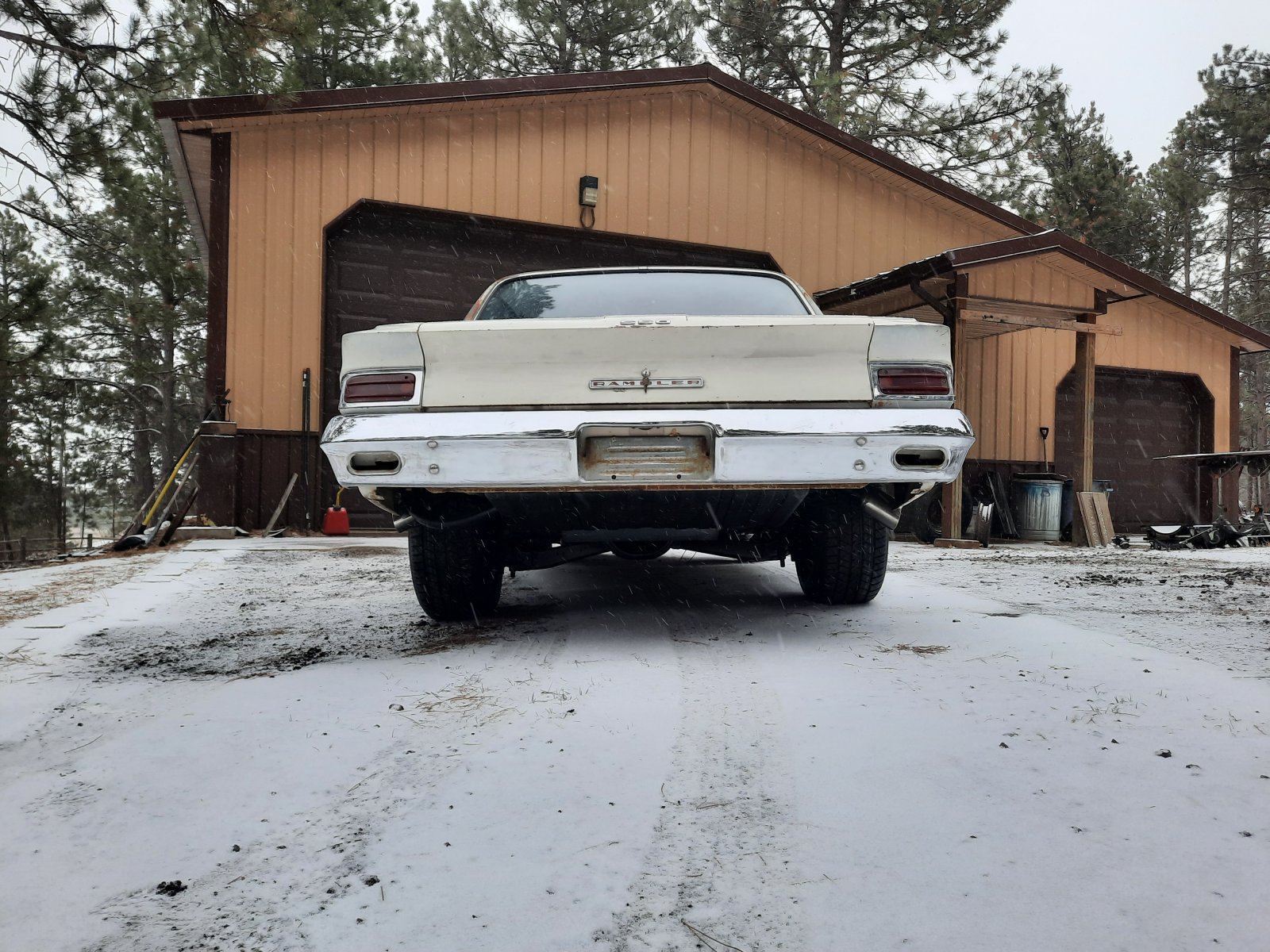

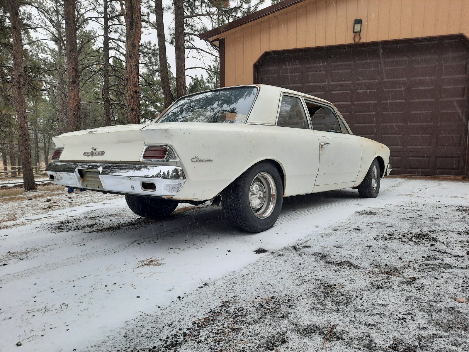

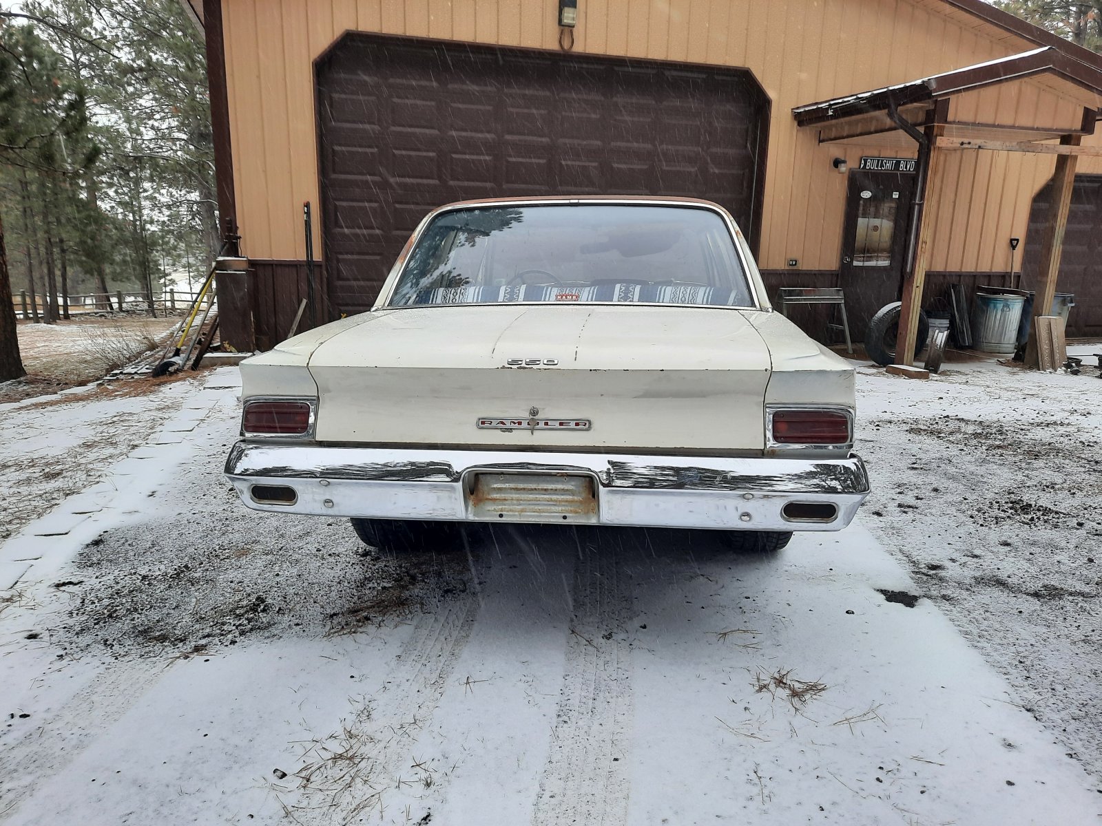

    Rear tires mounted and hood back on! Had to roll it outside despite snowfall..
    Feels great to see it like this. Makes it all worth it!
    20220124_104033.jpg 20220124_122645.jpg 20220124_122607.jpg 20220124_122618.jpg 20220124_122629.jpg 20220124_122703.jpg 20220124_122706.jpg 20220124_122715.jpg 20220124_122719.jpg 20220124_122724.jpg 20220124_122746.jpg 20220124_122759.jpg 20220124_122806.jpg 20220124_122824.jpg had to have the Hamb on my Rambler. Y'all have helped me so much during the progress of this build. Your input has been helpful and motivating. 20220124_122449.jpg 20220124_122457.jpg and thank you again, Dad, you've been the most helpful during this build. I can't say it enough, I would not be where I'm at now without your help.
    Looking forward to it's first car show!
