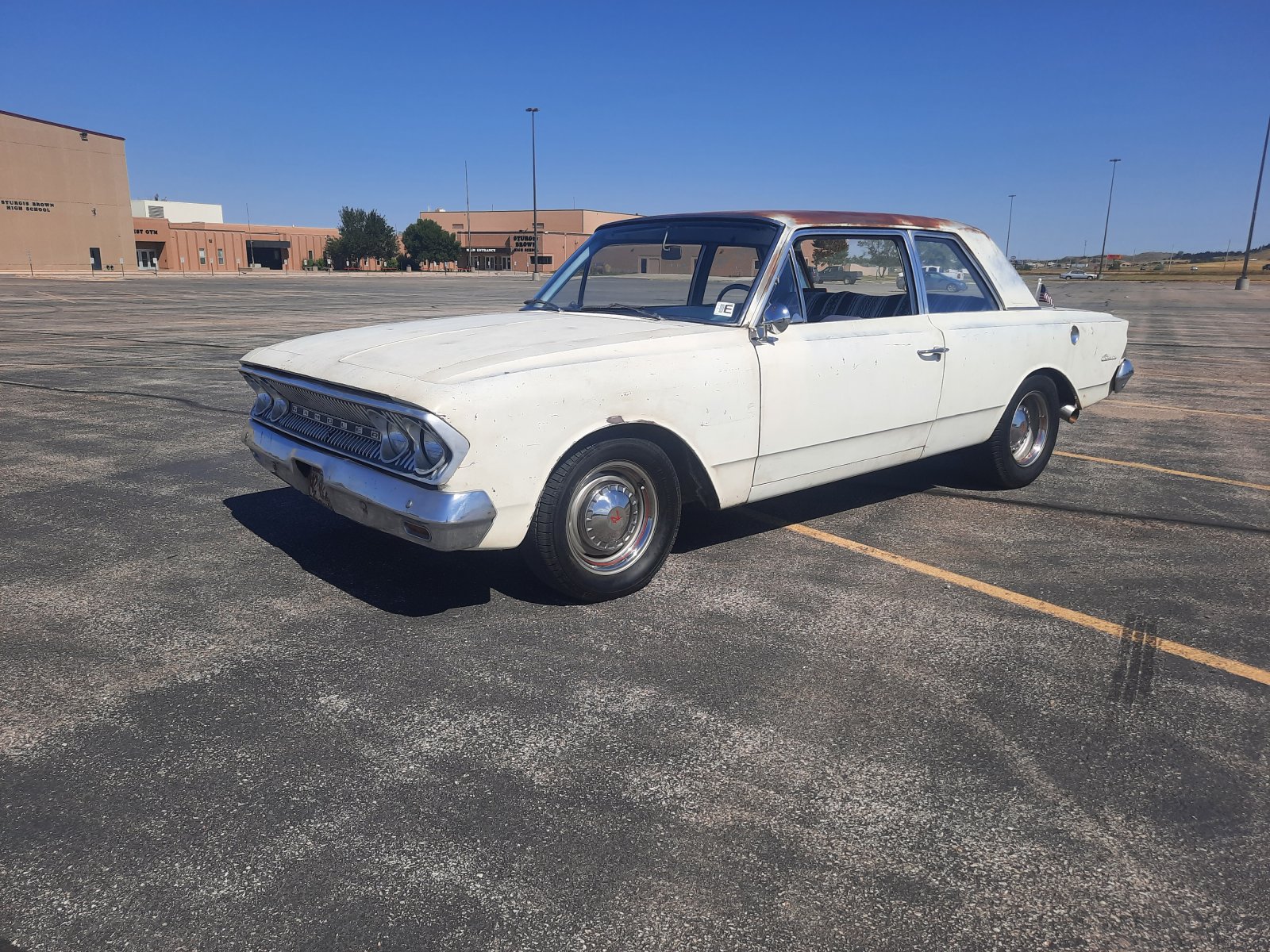

    Some Recent Rambler pictures; 20220904_144416.jpg 20220904_144133.jpg 20220904_144103.jpg 20220904_144320.jpg 20220819_134323.jpg 20220819_134258.jpg 20220904_142302.jpg 20220904_142505.jpg 20220904_142457.jpg 20220904_142349.jpg 20220904_142343.jpg 20220904_142335.jpg 20220904_142321.jpg 20220904_142310.jpg 20220904_142219.jpg 20220904_142620.jpg

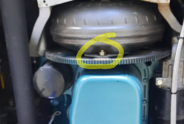

    Saw this in one of your pics a couple of pages back. Could that bolt be bottoming out on the torque converter?
    Did you ever check the flex-plate for cracks?
    Tman and Greenblade like this.
  8. Greenblade
    Joined: Sep 28, 2020
    Posts: 659
    Greenblade
    I can't say that I have checked for cracks. But this is the second time I heard someone say something about the flex plate. I'll get it on a lift as soon as I can

    Way back in 2005, @squirrel stated . . .
    https://www.jalopyjournal.com/forum...converter-flex-plate-bolts.56892/#post-709916
    3/8"-16 x 5/8" bolts should do the trick. Real GM bolts with the flanged head wouldn't be the worse idea, unless you have to order a larger package quan***y.
    If you get the converter unbolted, try pushing it back toward the trans just to make sure things haven't gotten into a bind somehow. There should be somewhere around a 1/4" or so of clearance with the converter pushed all the way back.
