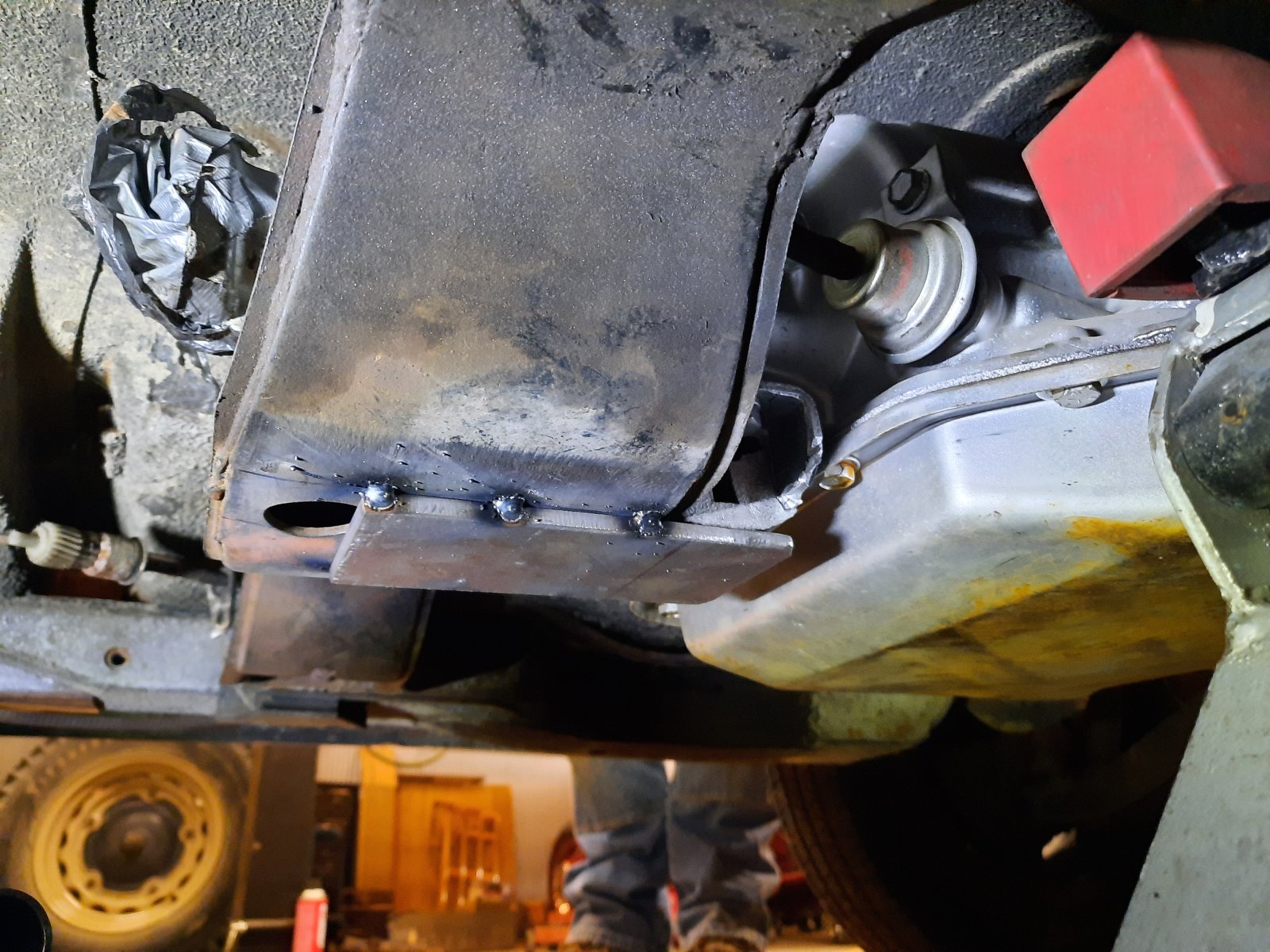

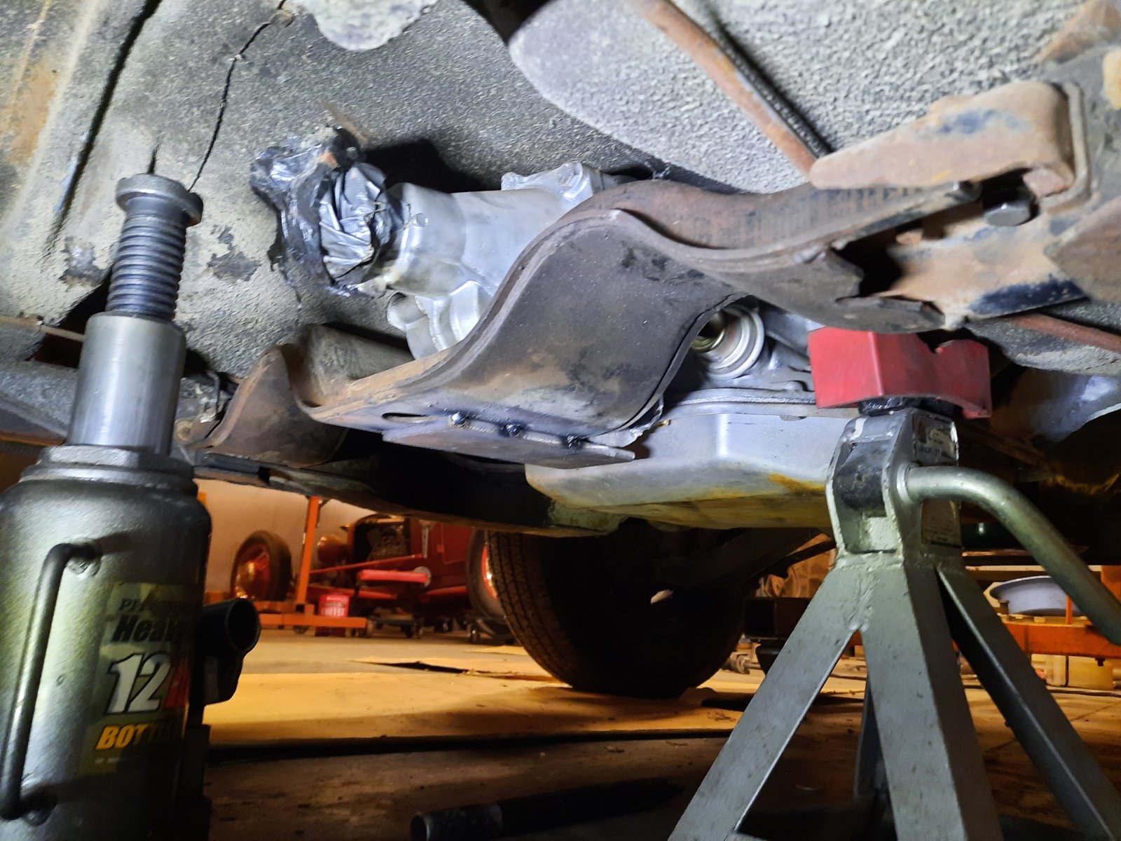

  15. Greenblade
    Joined: Sep 28, 2020
    Posts: 659
    Greenblade
    Stock 63 rambler with a metal plate extension welded on. Here's some pics of it tacked in 20210105_174852.jpg 20210105_174859.jpg

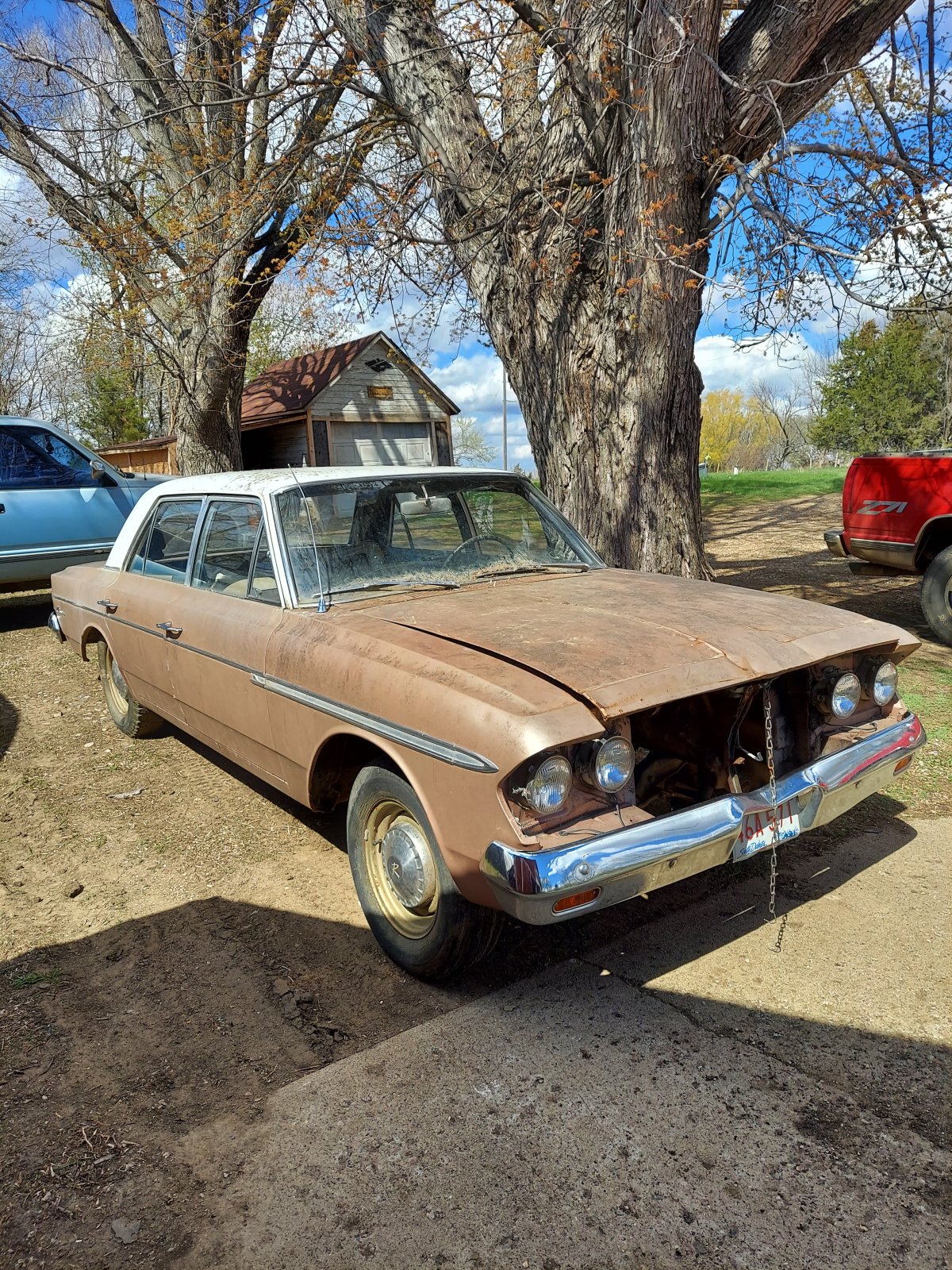

  17. Rctinker
    Joined: Apr 11, 2023
    Posts: 25
    Rctinker
    Greenblade, bobss396 and 41 GMC K-18 like this.

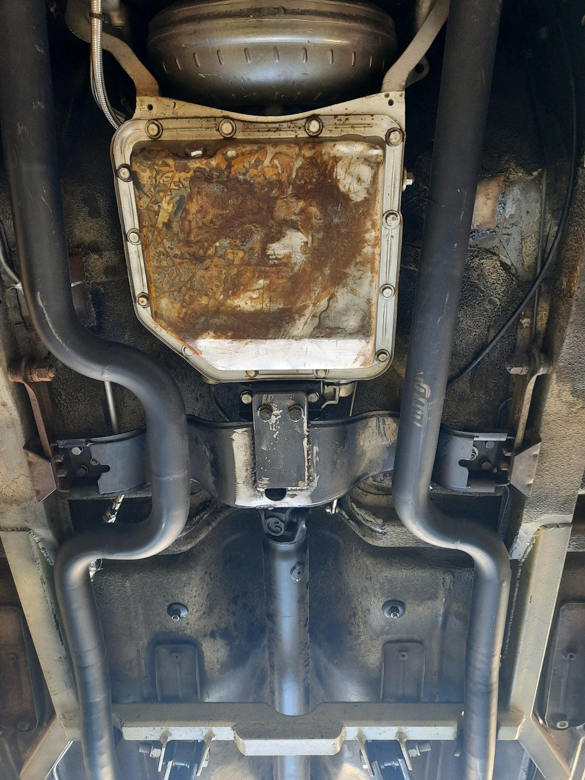

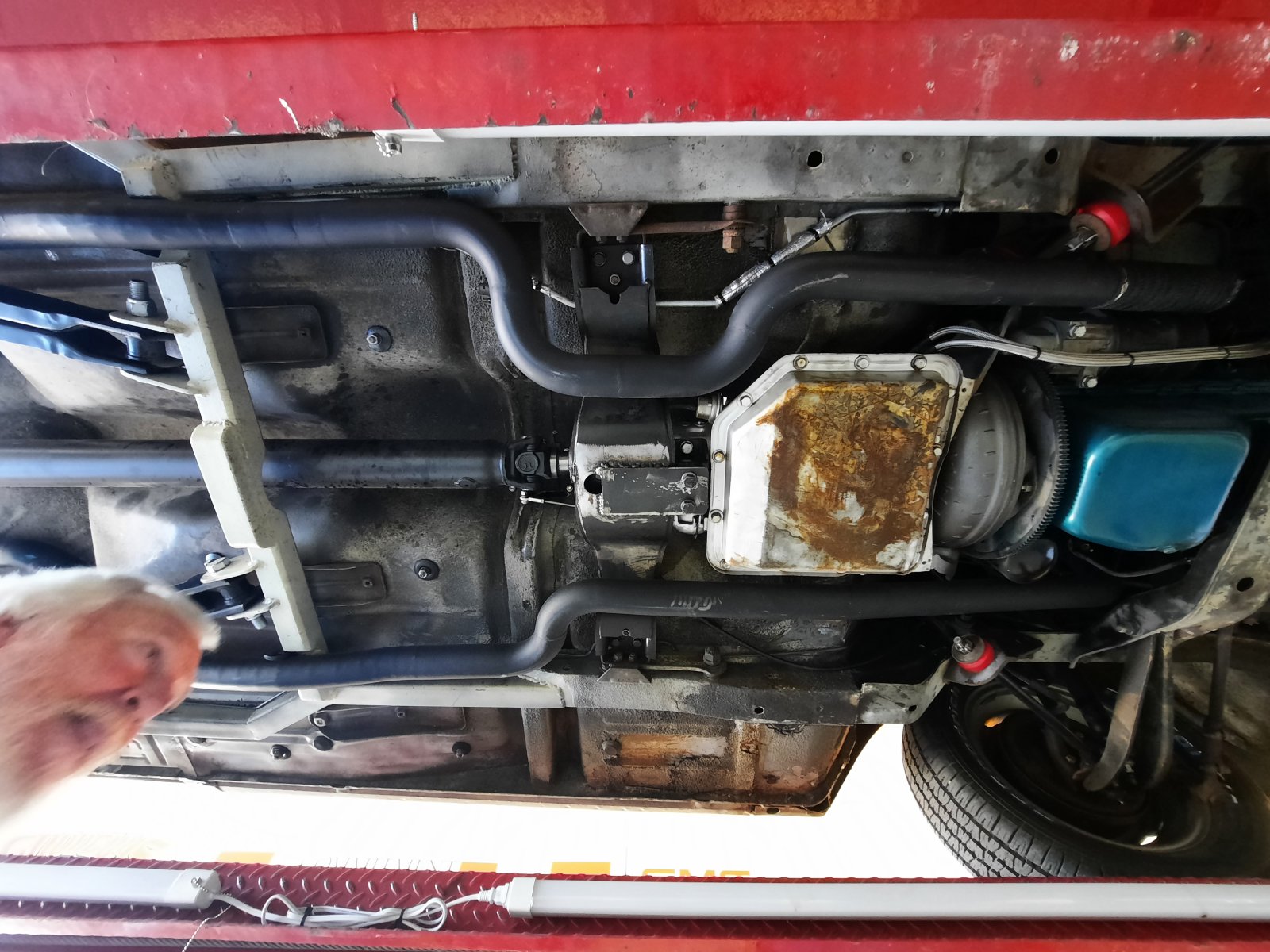

  25. Greenblade
    Posts: 659
    Greenblade
    Been taking advantage of the nice weather lately.
    I just ordered a 3.40 gear and pinion. Will have to get that swapped here soon, or wait until next winter. Save up some money to have a pro do it.
    I still have that REALLY REALLY F'IN ANNOYING knocking noise whenever I let of the gas. The sound mostly goes away in neutral but is still there. Thinking I'm going to have to have the trans rebuilt.
    Here's some pics from the last few days 20230508_175856.jpg 20230508_155922.jpg 20230507_161136.jpg 20230507_161148.jpg 20230507_160144.jpg

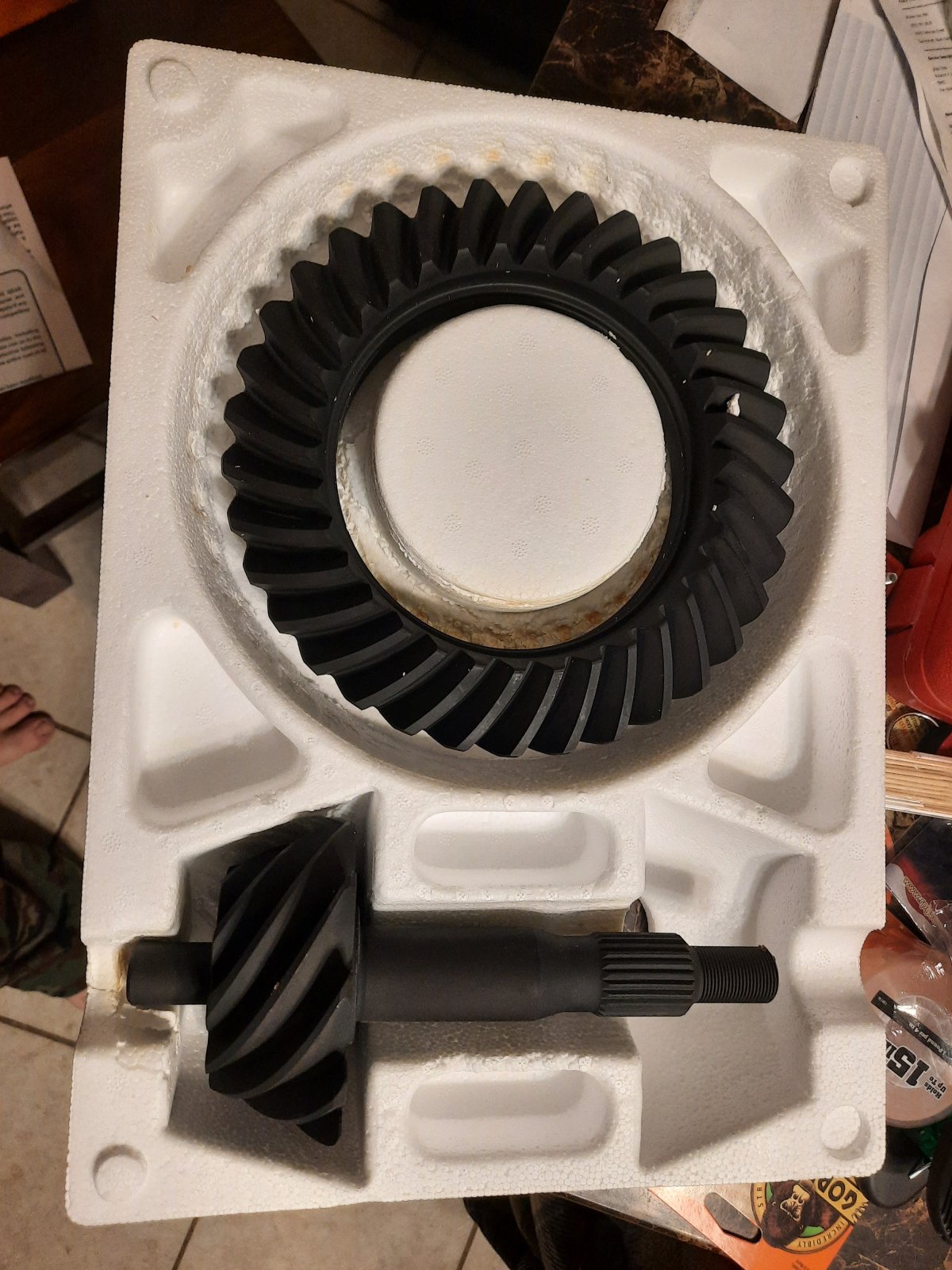

  26. Greenblade
    Posts: 659
    Greenblade
    Gear and pinion arrived. Not sure when I'll have it installed, I was turned off from doing right away when told it'd be over $1200 in labor. But I am excited for the day I get to run 'em. No more sluggish feeling Rambler 20230511_225815.jpg
