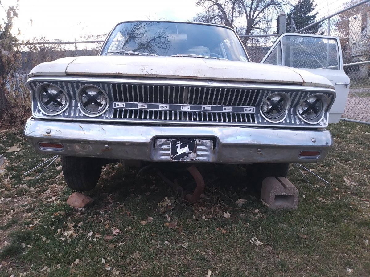

    So my Papa came up with an idea for the rambler the other day, inspired by the Ford Thunderbolt he thought we could replace the inner headlights with direct to carb air flow ports, or ram air I think its called. At first I was apprehensive about the idea, but the more I think about it, the more I love it. The only concern I have about doing this is having proper air filtration. I don't want bugs, dirt, and other random road **** in my carb. I'm sure ill figure it out eventually. Let me know what y'all think. -BVP p.s. its gonna be called RAMBOLT! Screenshot_2020-10-26-20-54-55-1.png 1028201408.jpg 1004201525.jpg Screenshot_2020-11-02-20-48-58-1.png

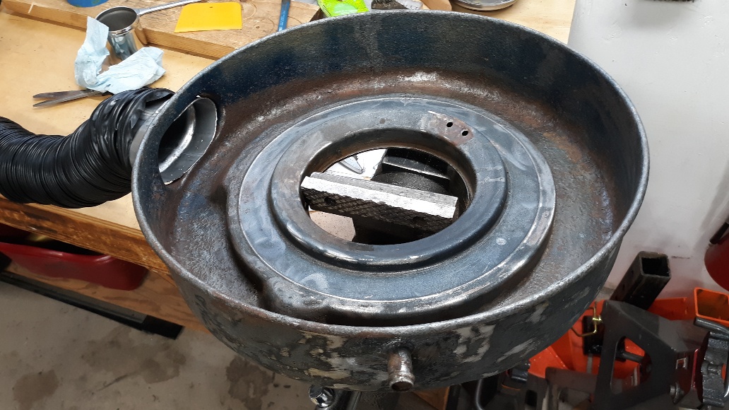

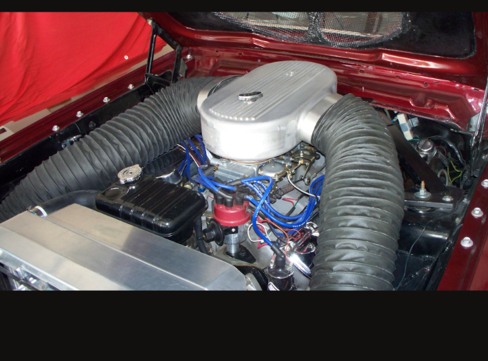

    Greenblade, the filter is in the air cleaner box on top of the carburetor. That 2 carburetor setup looks like it requires a high dollar air cleaner ***embly.
    1/4 inch hardware cloth at the inlet (where the head light bulbs were) will keep out the mice and rocks.
    There are a couple of drawbacks to using this type of cold air intake on the street.
    1. Carburetor icing - In cold damp weather, ice forms on the throttle blade(s). In September, I drove a cold, rainy run thru the Texas panhandle, engine started running like **** - Disconnected the cold air hose from the carb, the warmer air under the hood solved the carb icing problem.
    2. The cold air intake can take in water. Saw a bent connecting rod in a Toyota pickup. The owner was running through big water puddles, sending water everywhere. Including into the stock Toyota air intake - water does not compress...
    Consider building your own air cleaner. The following pictures are something I built for my 4 cylinder.

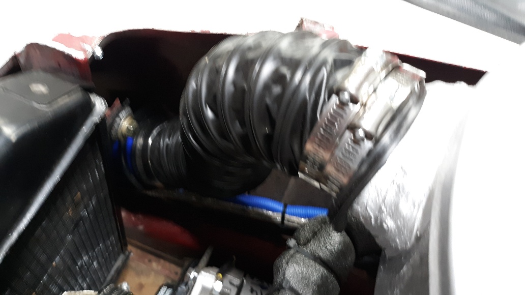

    Air cleaner from the s**** pile at a friends welding shop. No idea what car (or truck) it came from, takes an air filter for late 1950' - 1960's Dodge, lots of Jeeps, etc. Cut off the snorkel, leaving enough material to pop-rivet on a hose adapter.
    Crude, but, effective. The air cleaner ***embly was free, air filter was available in the shelf at Autozone, hose adapters are on the shelf at Home Depot / Lowe's. I spent more time cleaning decades of grime and rust than I spent on fabrication.
    Russ

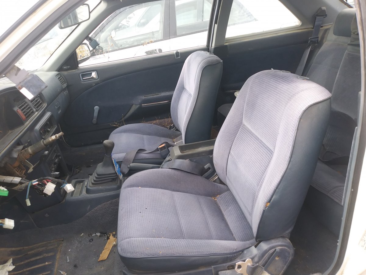

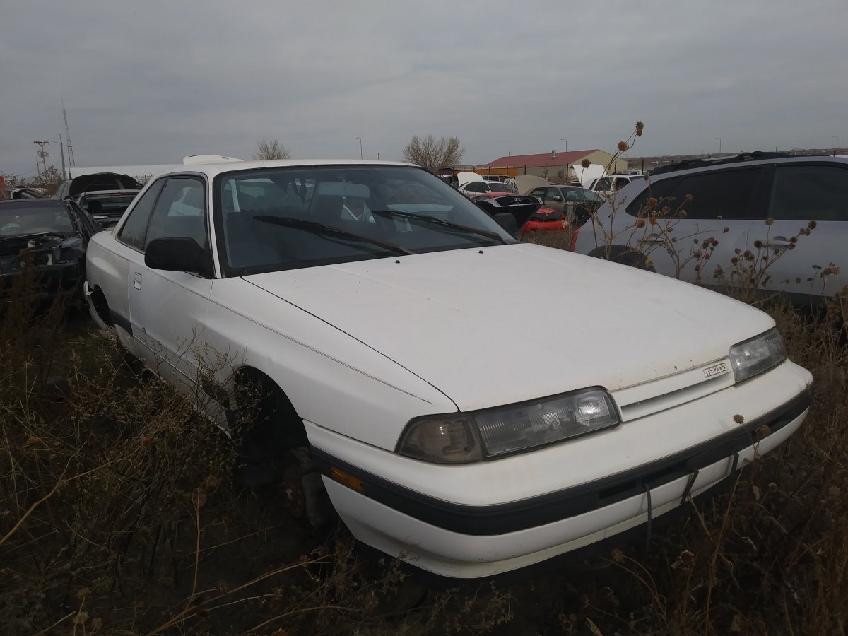

  11. Greenblade
    Joined: Sep 28, 2020
    Posts: 662
    Greenblade
    1106201535.jpg 1106201535a.jpg 1106201534.jpg 1106201206.jpg 1106201206b.jpg

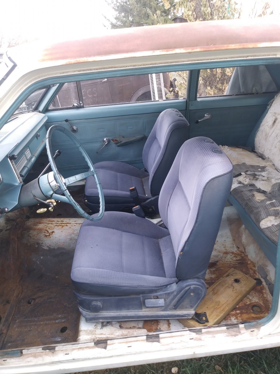

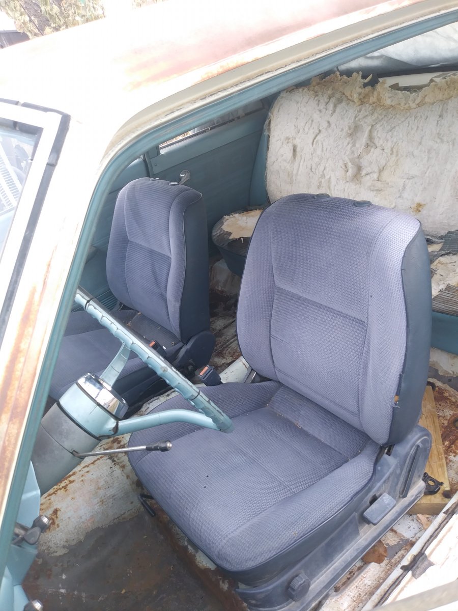

    Got some buckets for the Rambler today. They came out of a '90 Mazda MX-6. They fit pretty well, just need to be set a little higher.
    pivir123, scott27, 48fordnut and 5 others like this.

  13. ken bogren
    Joined: Jul 6, 2010
    Posts: 1,057
    ken bogren
    Those seats look like a nice fit.
    loudbang and Greenblade like this.

    Hate to sound like a turd but.............I would put the head rests back on the new buckets. One rear end from a "distracted" driver and you are ruined for life. Head rests help prevent whiplash.

    Have the headrest in the trunk just in case. However I think being hit anywhere in this vehicle will result in some sort of injury or death, but hey, that's a risk im willing to take driving a cl***ic.

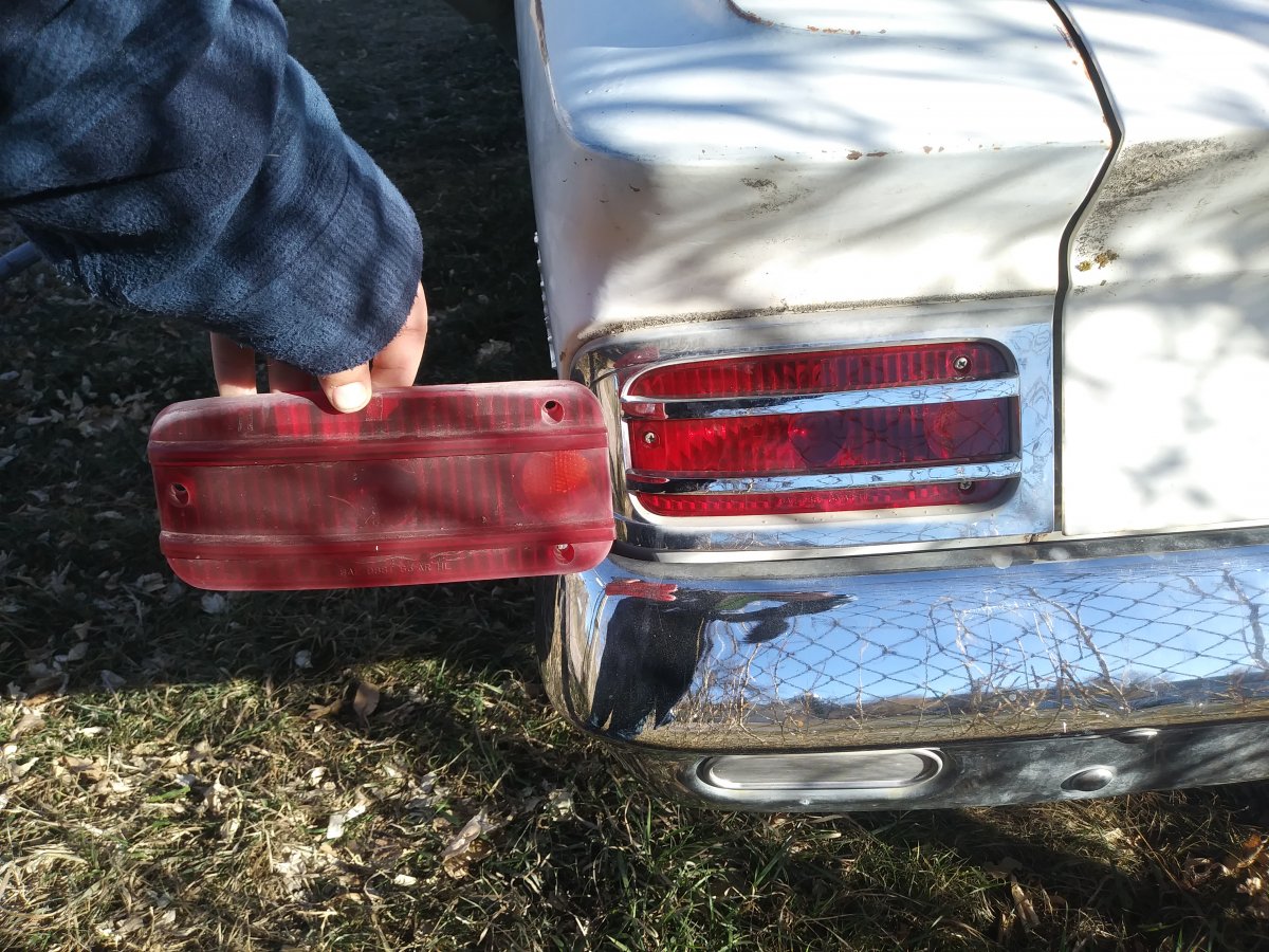

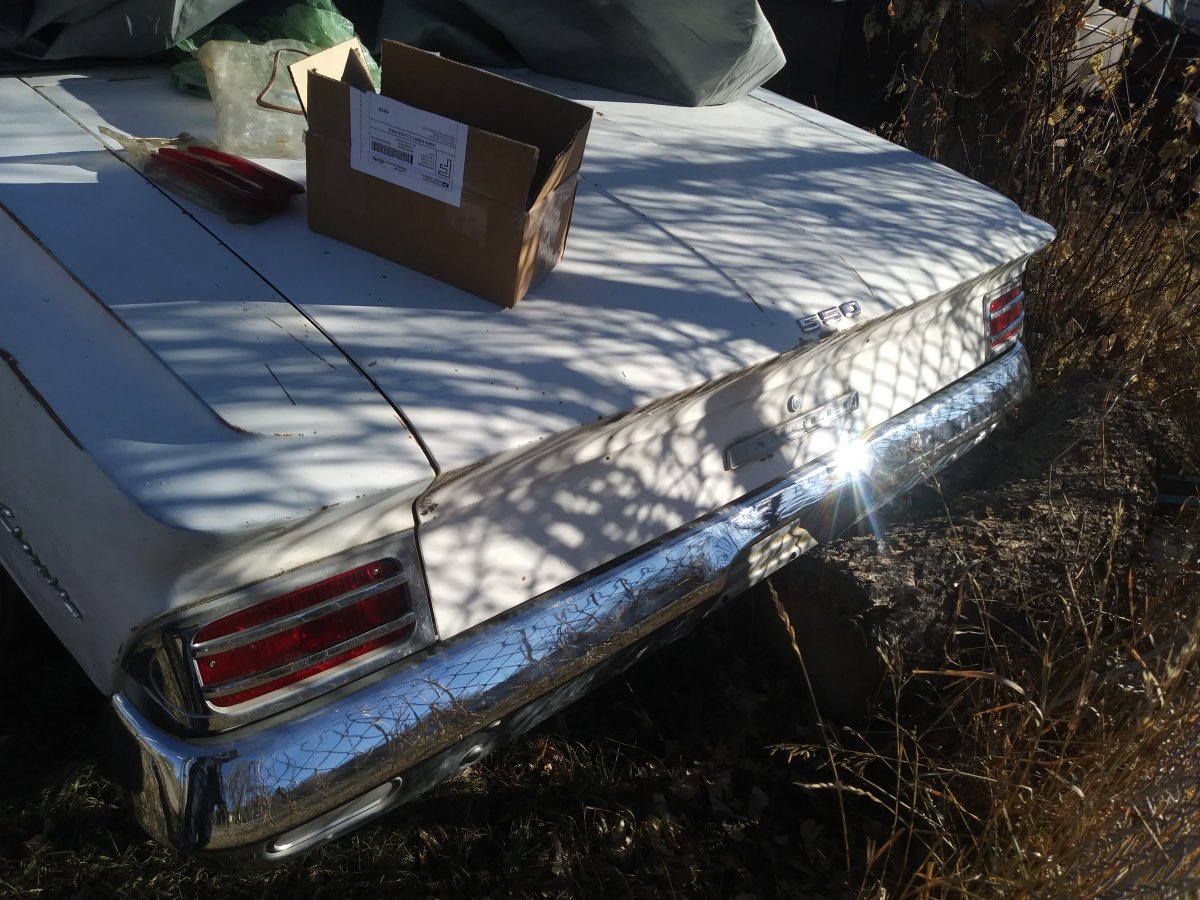

    1130201146.jpg 1130201140a.jpg 1130201146a.jpg I finally got the NOS amb***ador taillights I've been wanting so badly. I think they look beautiful and add a lot more character to the car.

    Don't throw away the old ones as they can be polished back up and look good. It's nice to have spares.

    Definitely. Im actually keeping the old ones on until the things running.

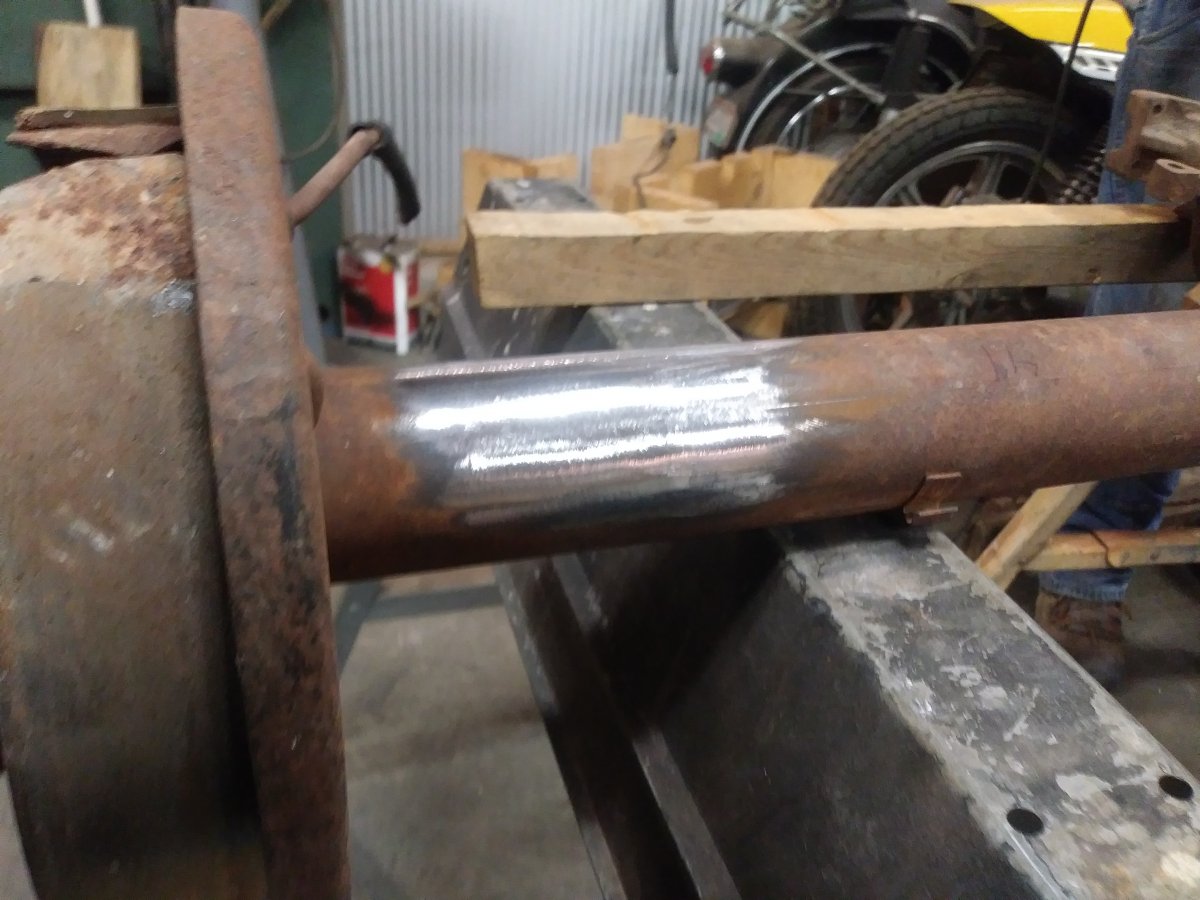

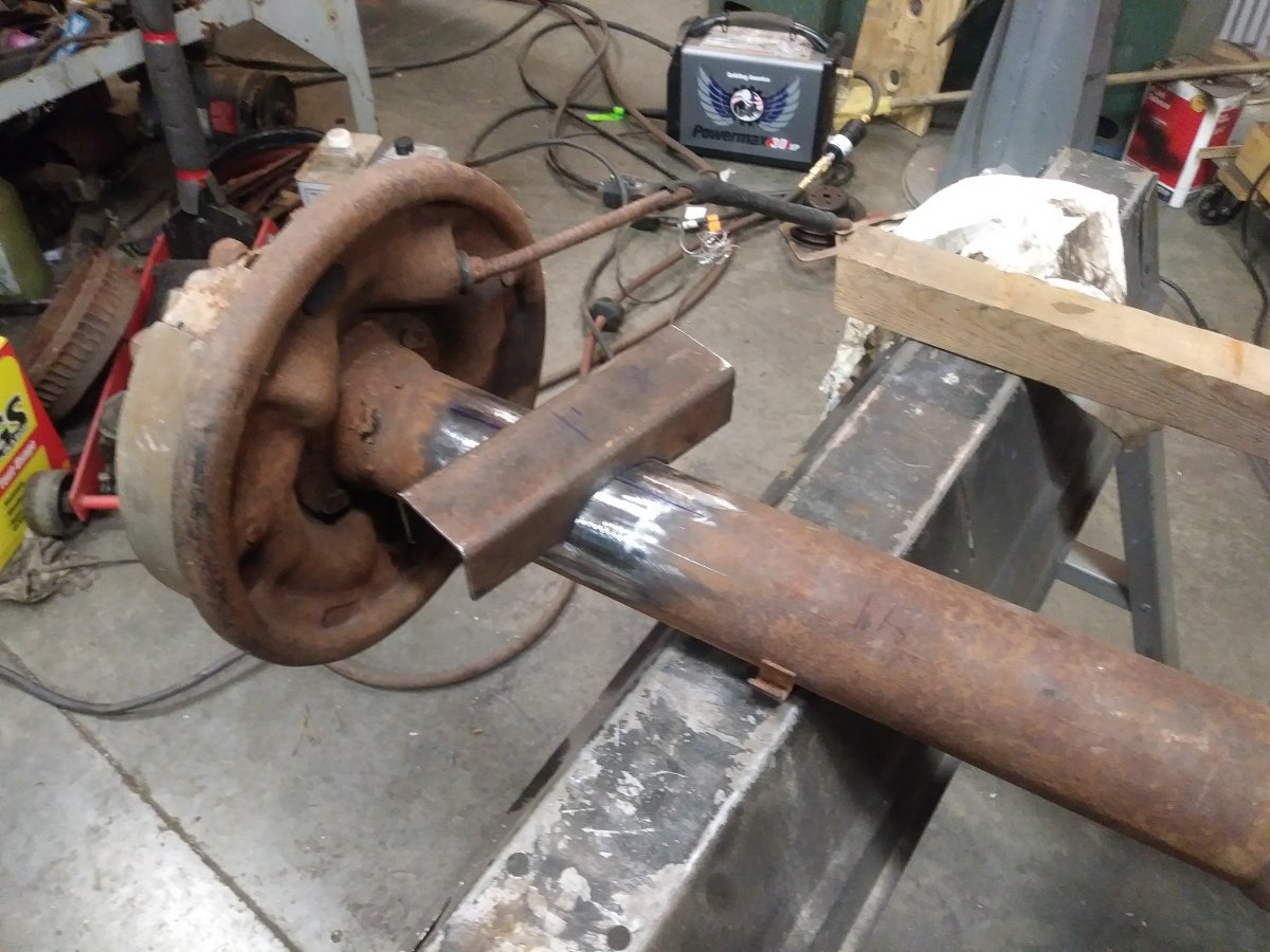

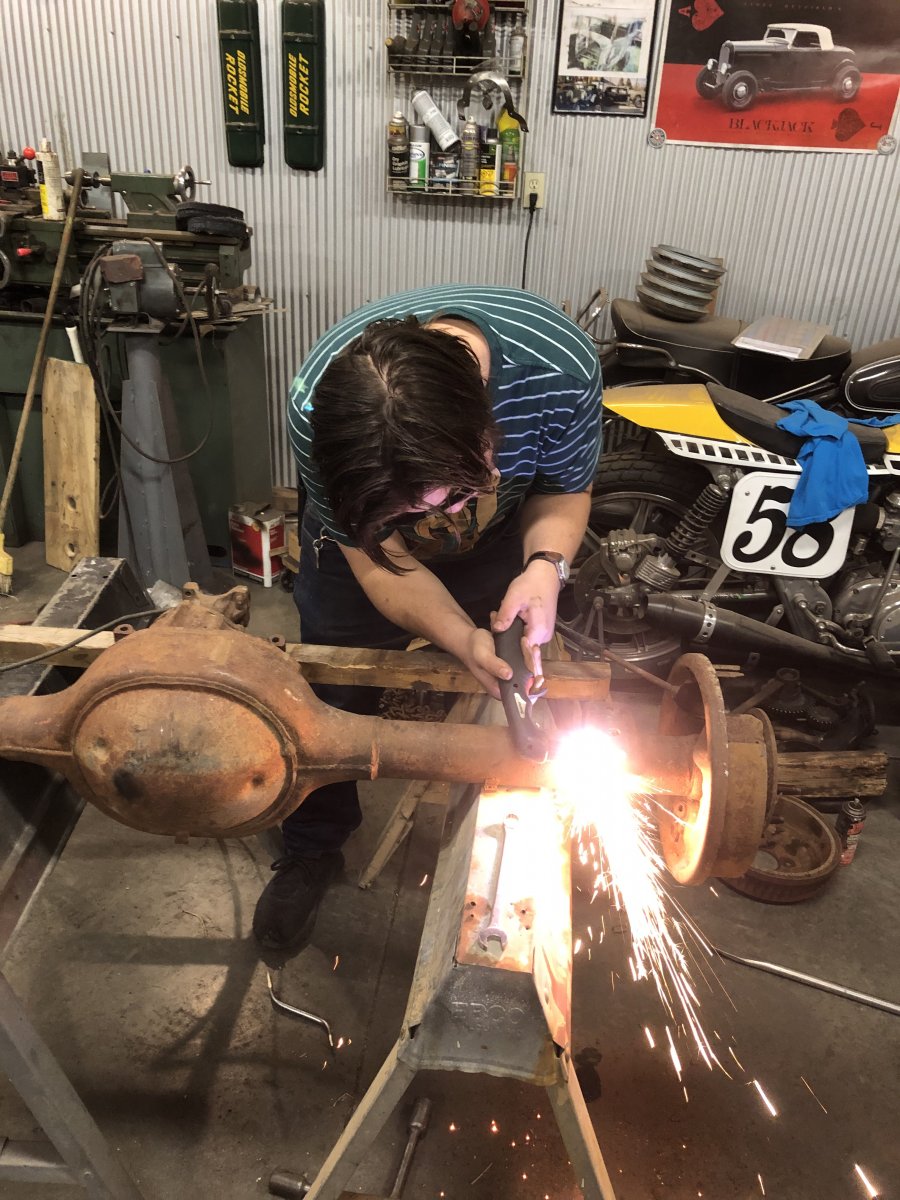

    1208201923.jpg 1208201923e.jpg 1208201925.jpg 1208201938.jpg 1208201938a.jpg 1208202045.jpg 1208202045a.jpg Dad and I started working on the ford rear end. We removed the old ford mounts and made new mounts for the chevy truck arms. We also put the 327 up on a stand but unfortunately the cracks in the block look too serious to fix, so we're tracking down a local 327 to donate it's block to the almighty Rambolt. 1208201740.jpg 1208201740a.jpg 1208201816.jpg hard to see in the picture but theres like 3, maybe 4, cracks in this side. More on the other side too.
    While that was a bit of a downer, I was still very excited about making progress on the build. Thanks for all the help Dad!
  30. TrailerTrashToo
    Joined: Jun 20, 2018
    Posts: 1,526
    TrailerTrashToo
    I am going to save this picture for the next time I get told : "That will buff out"
