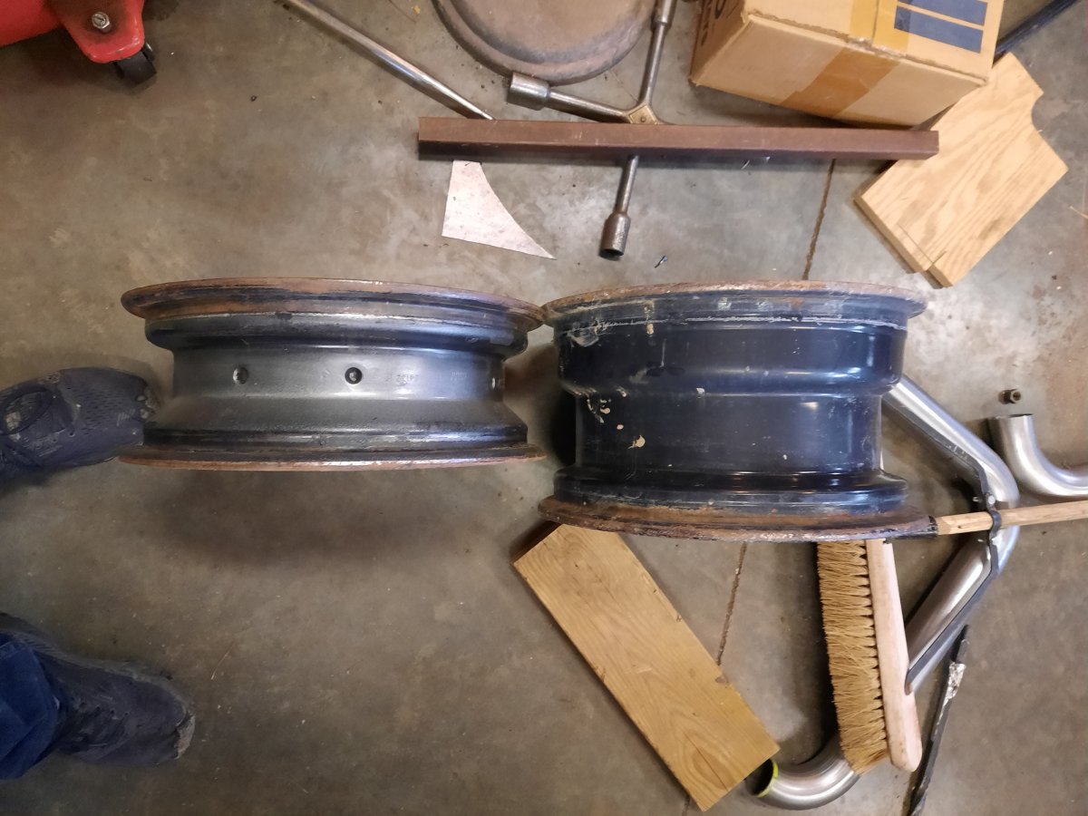

    We plan on keeping the original 5.5 sized front wheels the same. Its just the rear we want bigger. 20201228_183803.jpg 20201228_183811.jpg like this. The first picture is the stock rear wheel (driver side) the second picture is just a thicker wheel my dad had laying around that we are using for an example (p***enger side.)
    Front width will be untouched but I do want to lower the fronts ride hight a little bit.

    rusty rocket
    We have an 8” ford rear end from a Granada transplanted in It and it’s actually over an inch narrower than the rambler rear. Brooks needs to get a rim dismounted so we can really see What we need to do for a rear wheel. We spent hours at the salvage yard trying to find a 15”hoop we could transplant a rambler center in with no luck. I’m thinking maybe we should go back and look at 16”. This thing really needs some rubber out back.

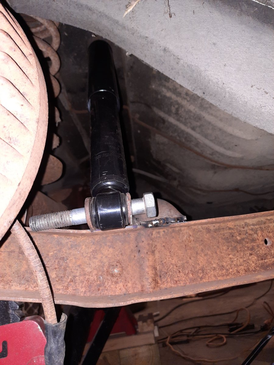

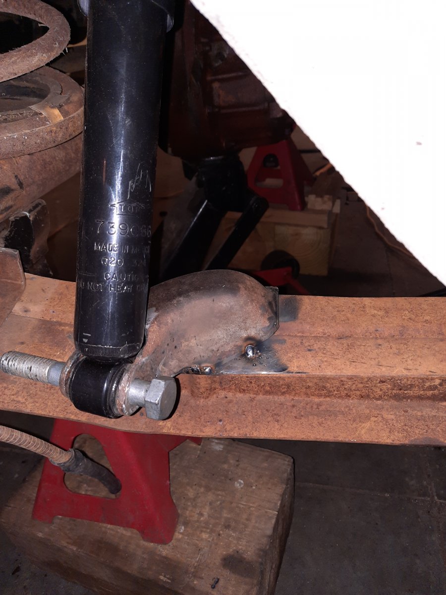

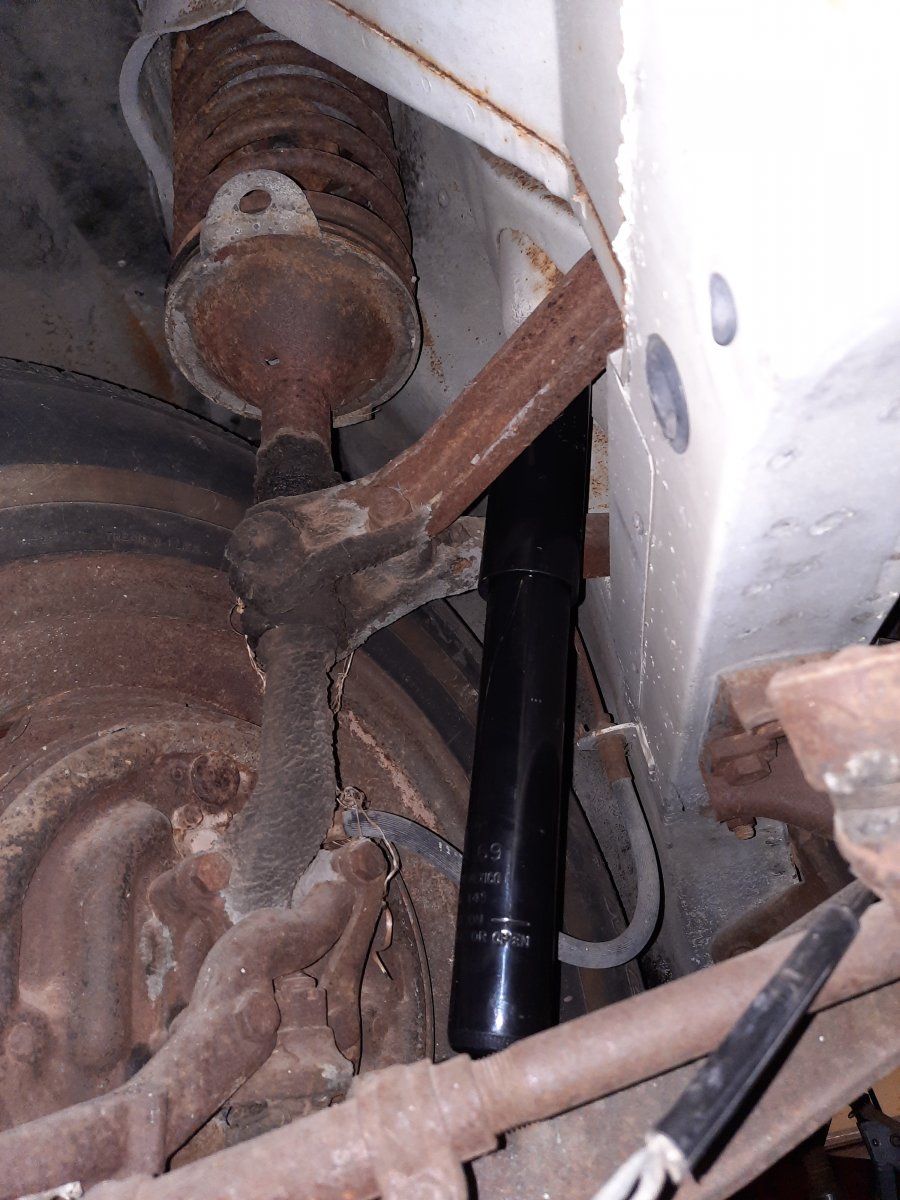

    Got 3 of the 4 new shocks put in tonight. The front ones were easy but the back ones were a pain in the ***. Especially the driver's side one. 20210206_180204.jpg 20210206_180212.jpg 20210206_180220.jpg Dad got most of the floor patch fully welded in and its looking pretty nice. It'll all be covered up by the rubber floor mat though. 20210206_180243.jpg 20210206_180310.jpg I took the voltage regulator off since we aren't going to need it. But I just had to share how pristine it was on the inside. It looks like I am probably the first person to open it since it left the factory. 20210206_174622.jpg 20210206_174636.jpg 20210206_174643.jpg 20210206_174651.jpg the rest of these pictures are for things I am looking for.

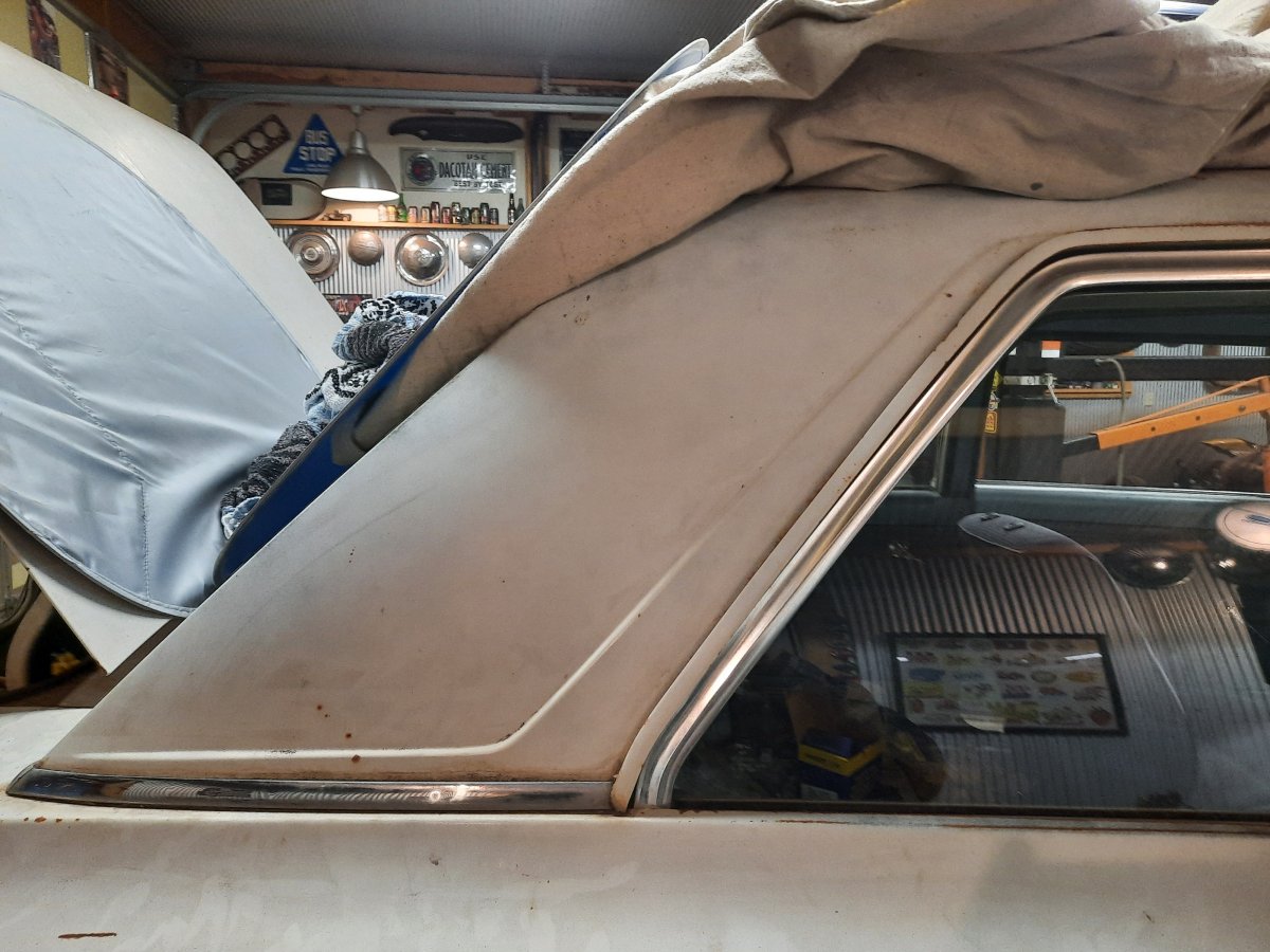

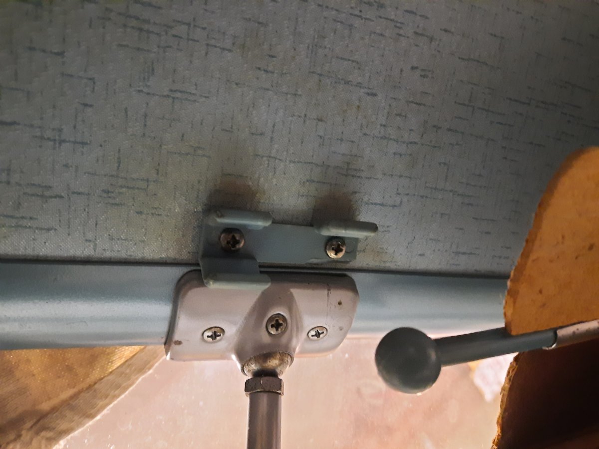

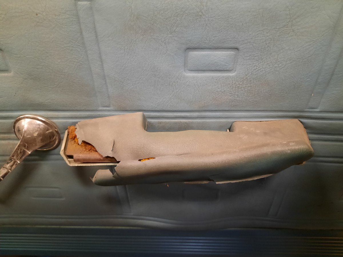

    first off, I'm looking for the C pillar trim that would've been on an amb***ador. Not the 2 little lines, but the large chrome L. 20210206_195023.png I am also looking for a dome light cover. 20210206_172554.jpg and I'm looking for a fully intact sun visor clip. 20210206_172614.jpg both of the interior arm rest need to be re-done. 20210206_172739.jpg and to finish off the dash, I'm looking for a clock. 20210206_172757.jpg

    Brooks didn’t explain the rear shock mounts in the post above. When we transplanted the 8”under it we hung it off of a pair of c-10 truck arms. We mounted the c-10 shock mount (after generous t*******) on top of the truck arm. It just so happened the mount lands right where the coil spring resided on the c-10 pickup so it should be plenty sturdy. 6A2627A4-C656-4400-B076-E4391E5193A0.jpeg

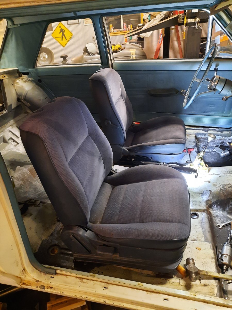

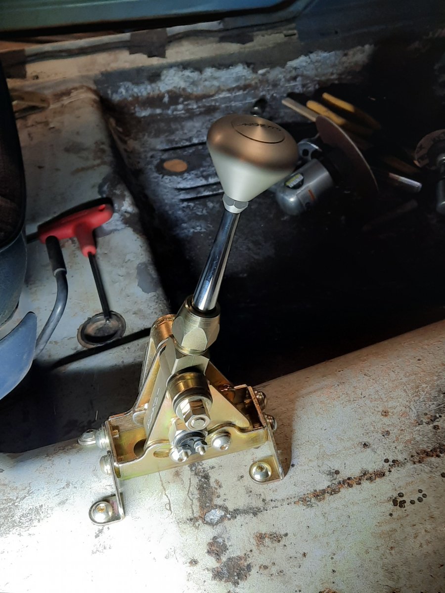

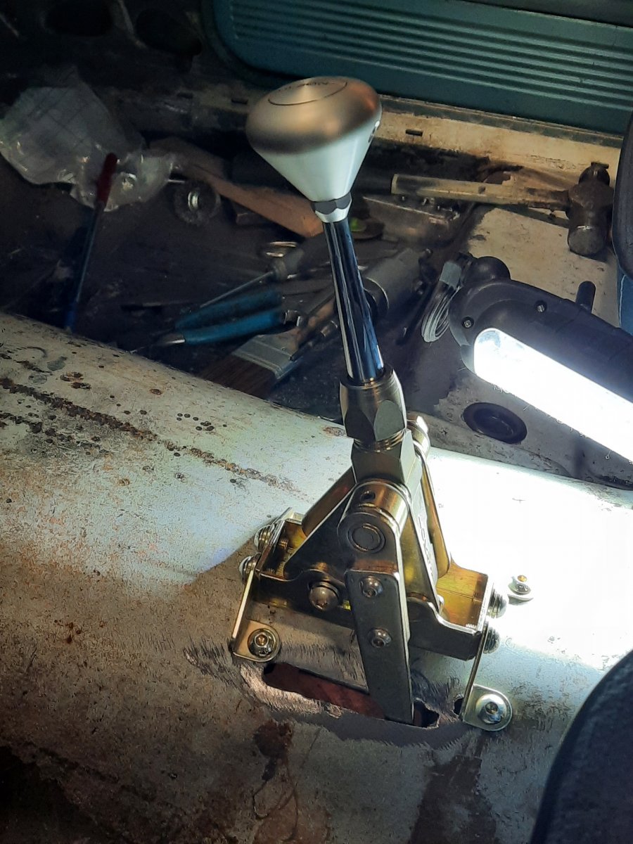

    Dad and I got the shifter mounted and attached to the trans. With a little more tweaking it'll be perfect! 20210224_181858.jpg 20210224_181926.jpg I also forgot to take pictures, but last time we got the second seat mounted.. that one was a major pain in the ****. 20210224_182001.jpg Dad also managed to patch up the floorboard piece that was really hard to do. 20210224_182020.jpg Dad also patched up the holes in between the subframe connectors and the floorboard. 20210224_182036.jpg 20210224_182101.jpg The cherry bomb mufflers didn't seem to fit right, so I'm going to return those. Now we're back on the hunt for a muffler that'll work for what we need.

    Sure is a nice looking handle on the Lokar.

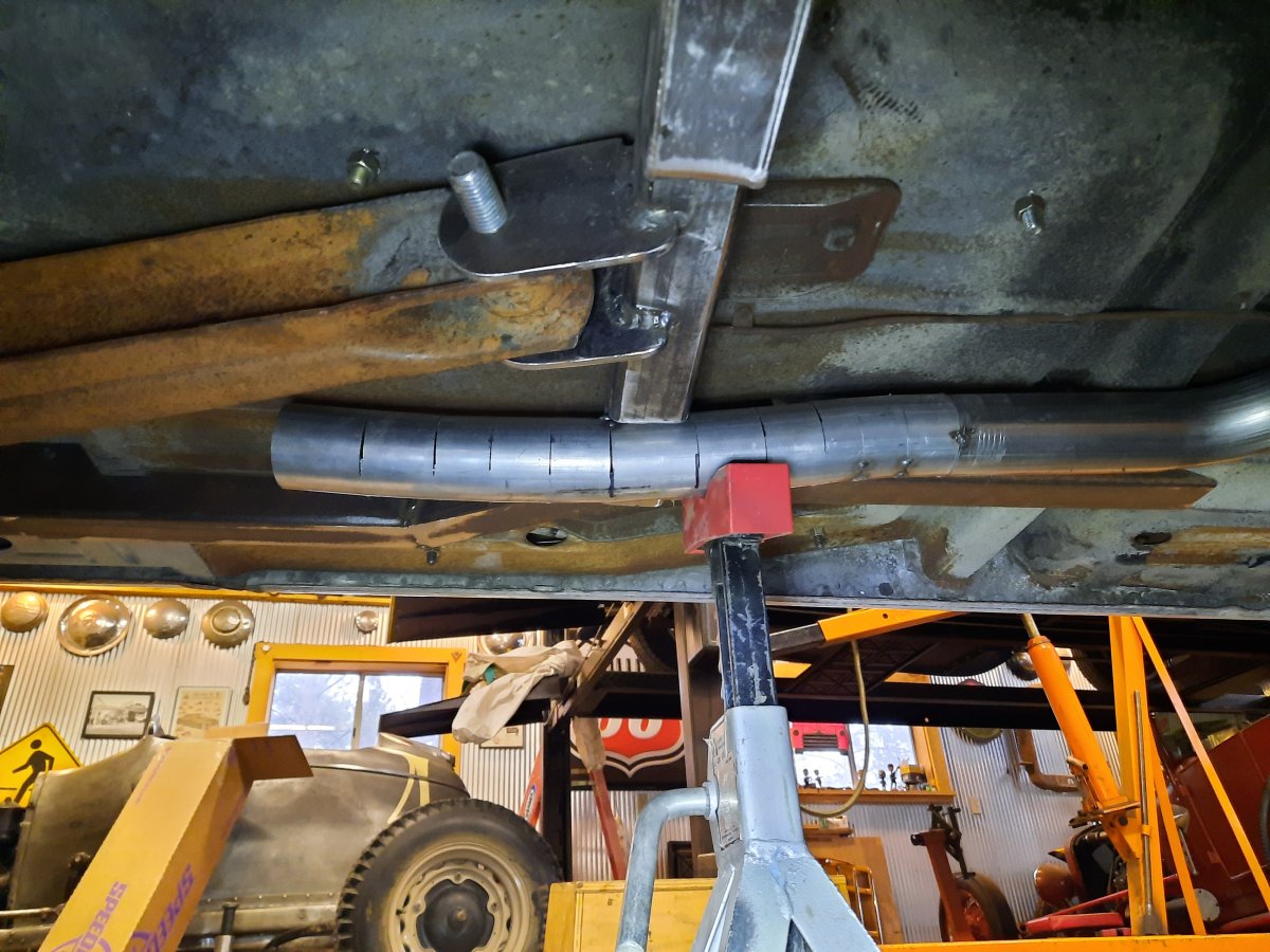

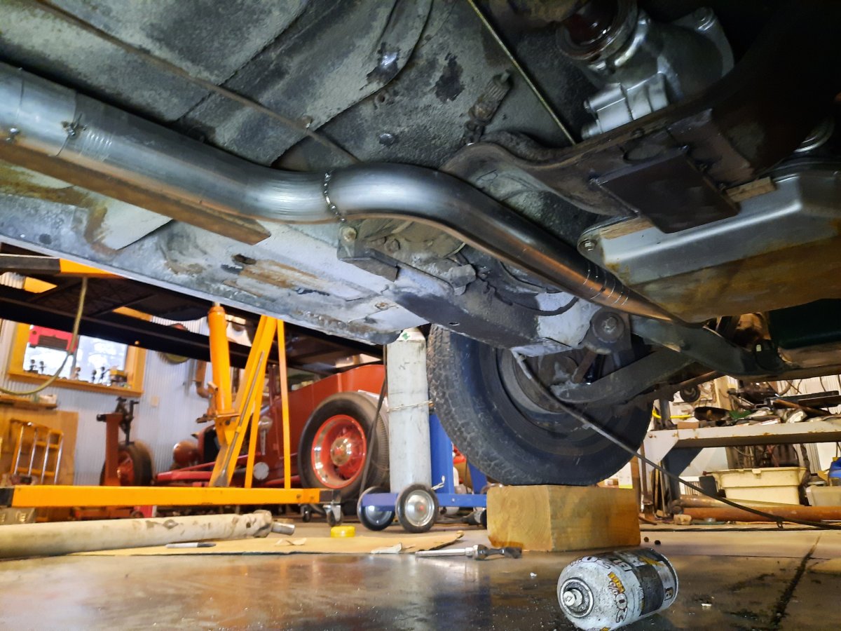

    Since the set of turbo cherry bombs weren't going to fit, we decided to get a 2 in 2 out camaro muffler. And if this one doesn't fit, we'll make it fit. 20210310_212108.jpg

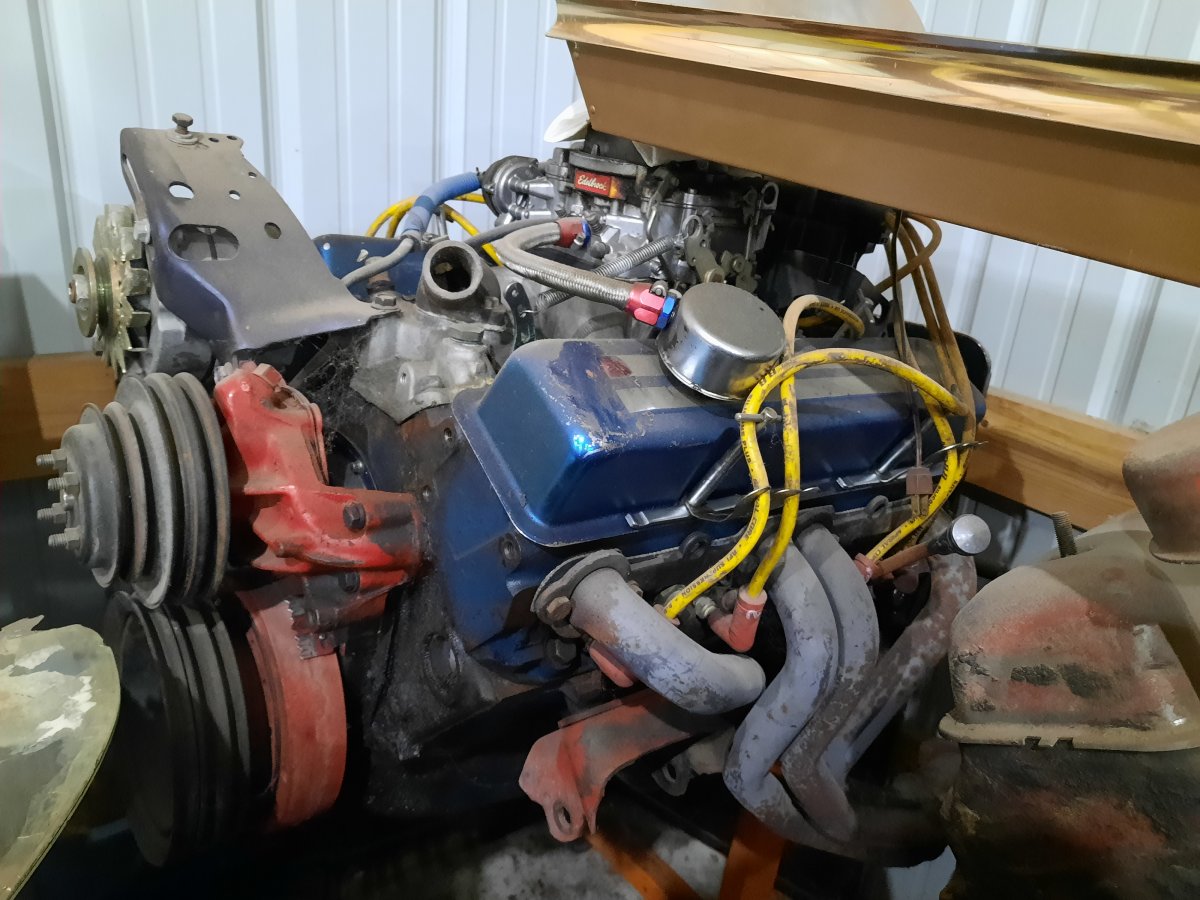

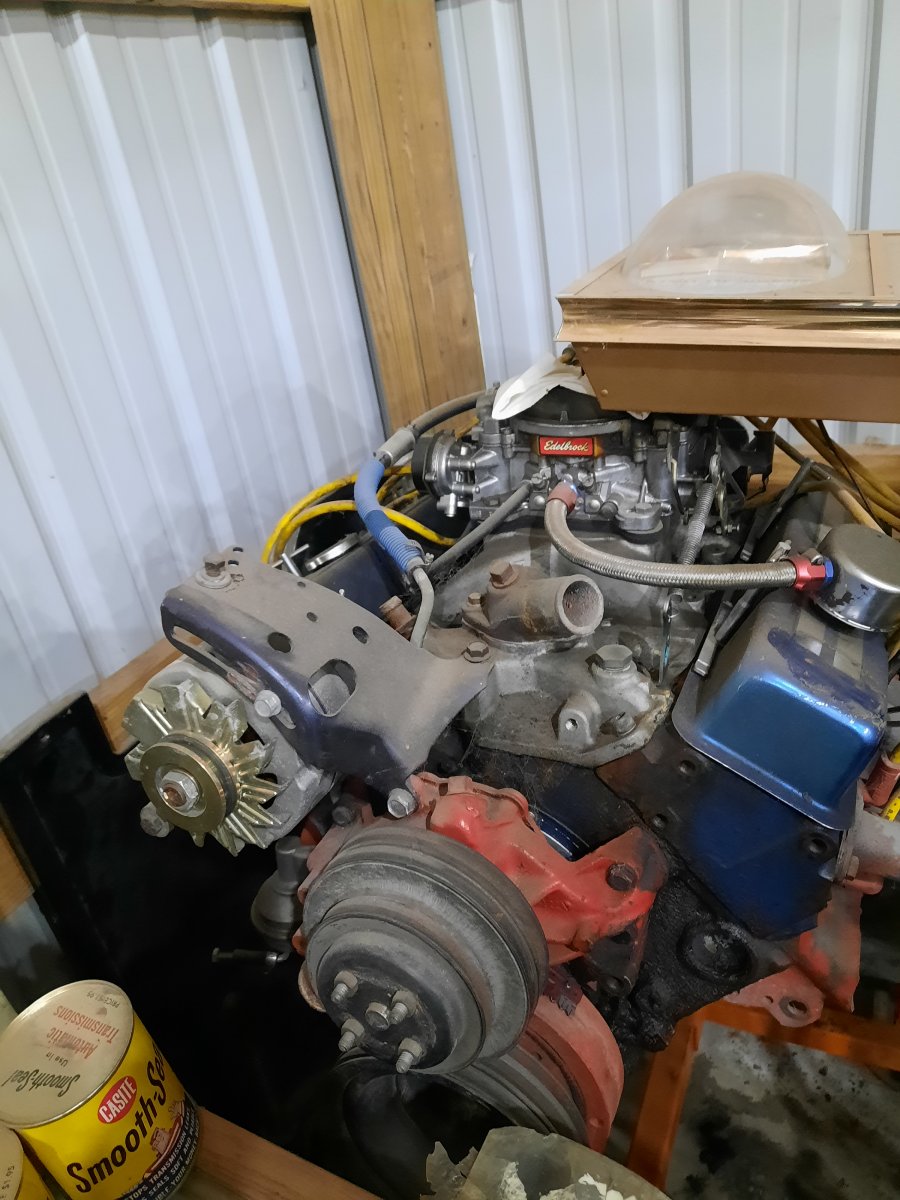

    Well we bought a new engine, a 350. Its got pretty much, if not, everything we need. And we're told it runs. 20210323_160753.jpg 20210323_160744.jpg i also scored some reverse lights from a rambler American at our local junkyard. 20210323_135041.jpg 20210323_135035.jpg we also picked up a pair of wheels. Hoping to put the centers of the rambler wheels in these. If it fits, they'll be wicked cool. 20210323_165006.jpg 20210323_165027.jpg and we also picked up the windshield sprayer thingy off the american. 20210323_192030.jpg my grandpa gave me this American motors windshield fluid bag. 20210309_102520.jpg and here is the exhaust work so far. My dad has been helping alot on it while I'm away. 20210323_171711.jpg 20210323_171707.jpg that's everything for now I think.

    The motor Brooks acquired came out of a suburban that was in a rollover accident, after it was pulled it was put on a stand and started by the friend we bought it from. I’m hoping he will be well ahead time and money wise with this motor other than using the cracked block 327 that we are using for the mock up. All the accessories on this new motor were well worth what he paid for it.

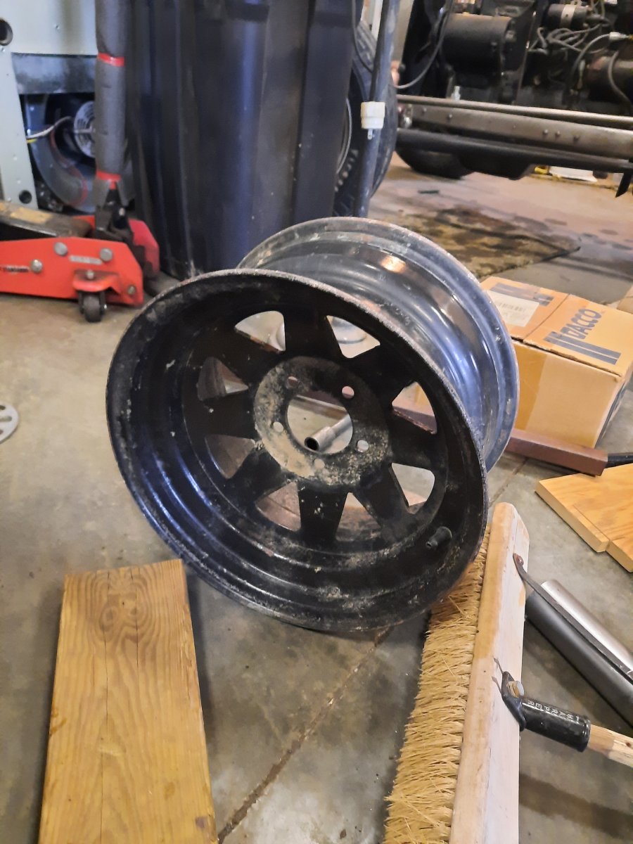

    IMG_1875.jpg my dad has been working on a wheel while I've been away. The rambler wheel center is going to fit nice in the bigger rim, though it is pretty tight right now.
