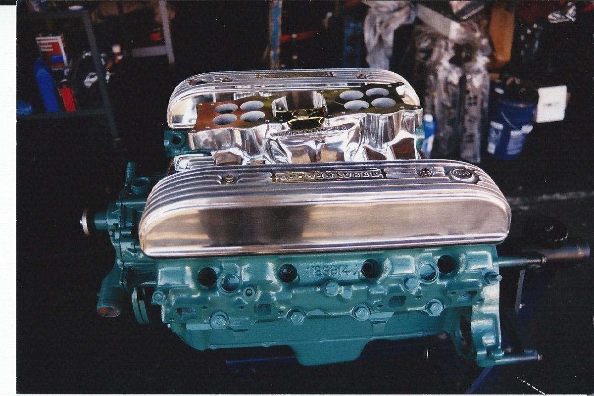

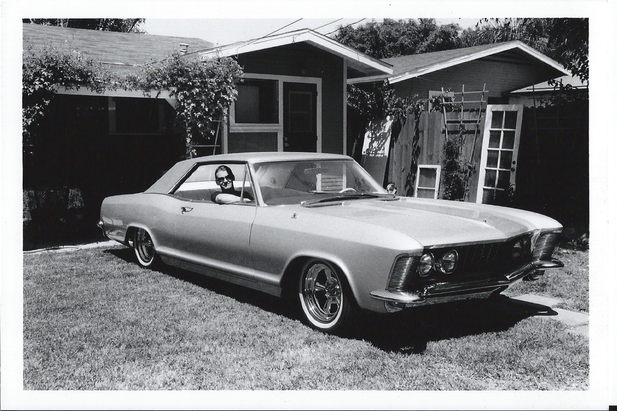

  18. DAMN i miss those Riviera days.
    8 years on this one

    Nice! Those Radir wheels look great on the car.
