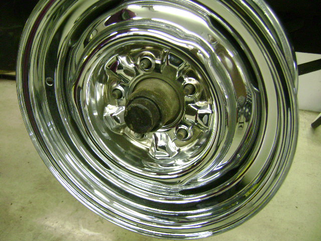

  1. I bought these 4 yrs ago thinking I'd run em on my next 60 Pontiac. So, I was gonna put em on my Rivi instead. The wheels won't fit over the hubs (frnt) or axle flange (rear). Which may tell me they'd never fit the 60 Pontiac or maybe anything else with 5 on 5 bolt pattern

    I used Astros with 1/4" spacers behind them
    I think it looks good along with the 3" drop.
    Lumpy
  3. OK, that makes sense (the spacers) since my chrome whls have the same 3 1/8" hole as Supremes.......and I see Supremes on LOTS of Rivis. THX

    Buick hubs are about the biggest there is. If you can find the right guy with a big lathe, have him cut the centers to fit your hubs. Spacers plus longer studs equals $$$'s and then you lose the hubcentric thing...

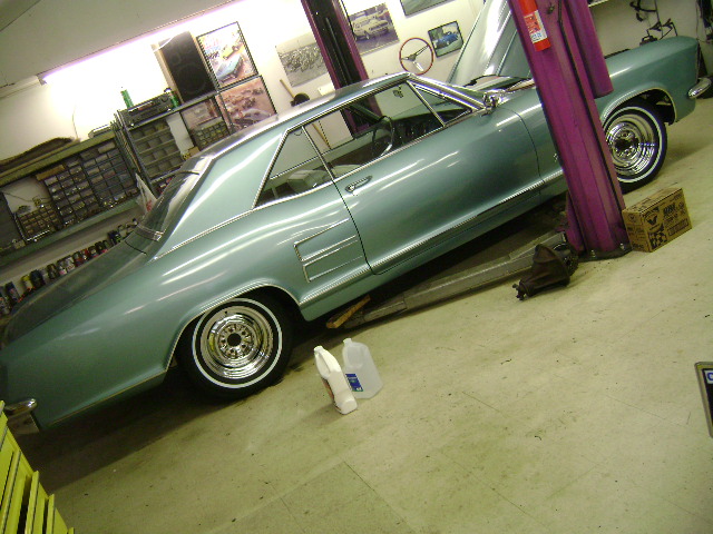

  13. 1/4" spacers DSC07817.JPG

  16. I had those wheels on the shelf for something like 4 yrs. I figure if they don't get used now it's just dead money up there. I'll get bullet caps/lugs at the next swap and lower it 2" next week

  19. I HAD the spacers, and YES to all the rest. Why, hard to believe?

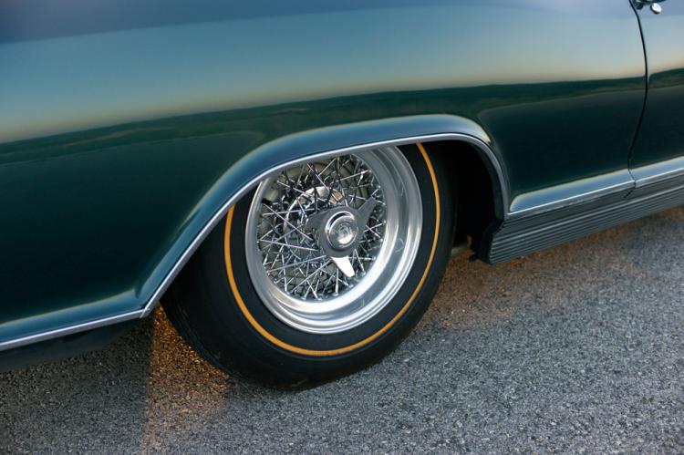

    i would love a set of these wires for my buick. PM me and lets talk
  26. Well then put some chocolate on my asada. "like" 512831-1397513449-c675c41ca6e839b802f9cf449a773cc4.jpg

    Skylarks on a Riv or Nomad is so sixties it hurts. The Borranis, not sixties, but its killer as all get out, traditional or not. And those gold stripes, HELL YEA. And no, I'm not kissing up to Ryan, I dont kiss up to anyone. It just plain ROCKS.
