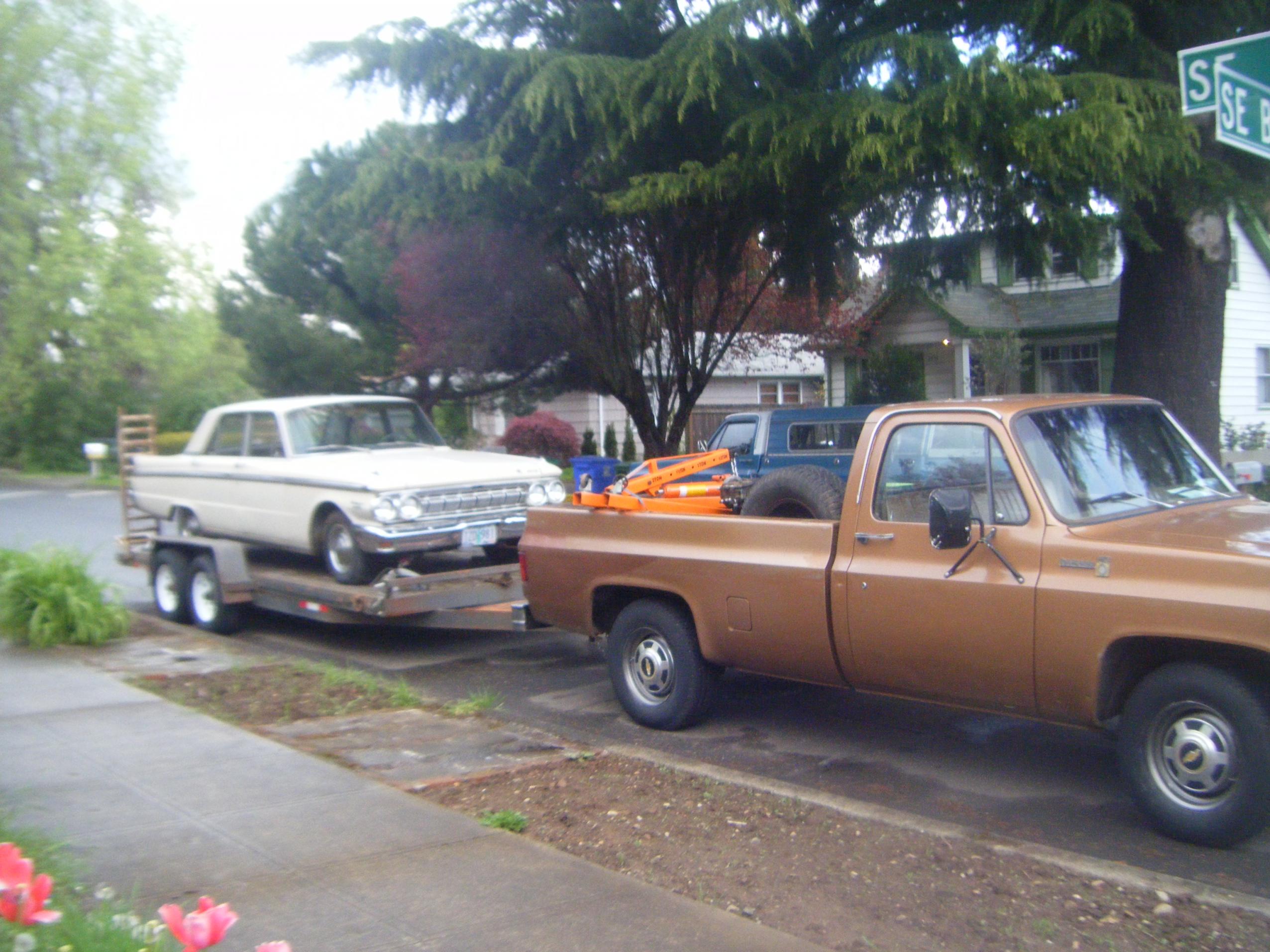

    [​IMG][/url][/IMG][​IMG][/url][/IMG]We want to thank The monster and his family for the oppertunity to bring this car back to life. They are Great people! This is the first and hopefully not the last time that I have seen such a generous offer thrown out to the car community. This car will bring many hours of quality time spent out in the garage to our family. We will post pics as we move along with the project. Thanks also to every one that has commented and offered support for the build.

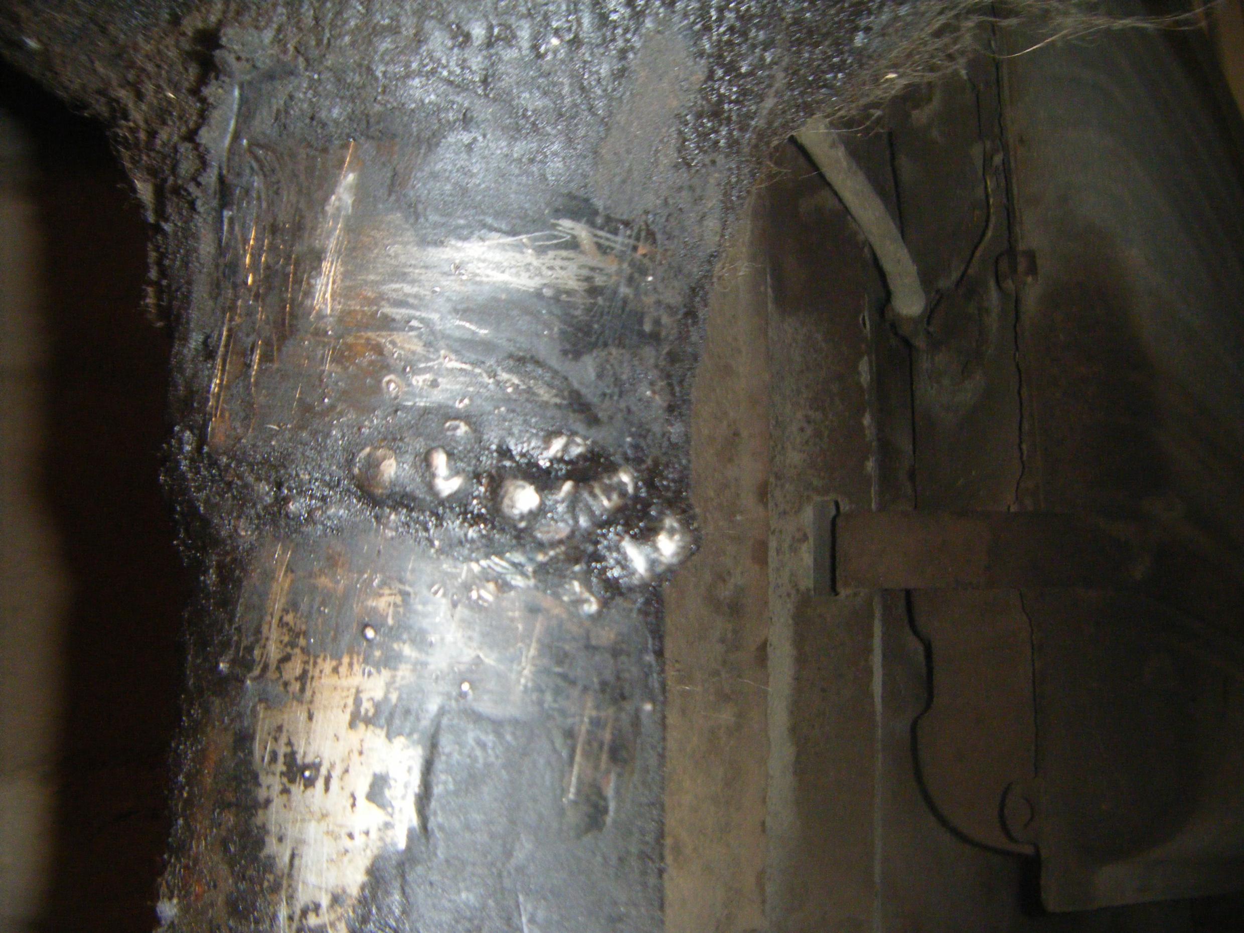

    Up date: Today we got into the brakes. Removed the master cylinder, flexable lines, and drums. Making a shopping list of parts that we will need. Have all of the front bearings ready to clean, the drums ready to have re surfaced. Got to the rear, and found out why there has been a spot of gear lube on the floor. The passenger axle tube has been welded at the center section, and that is where the leak is. Thinking of just finding another complete rear end. Found a couple of possibilities on craigs list, just waiting to hear back.

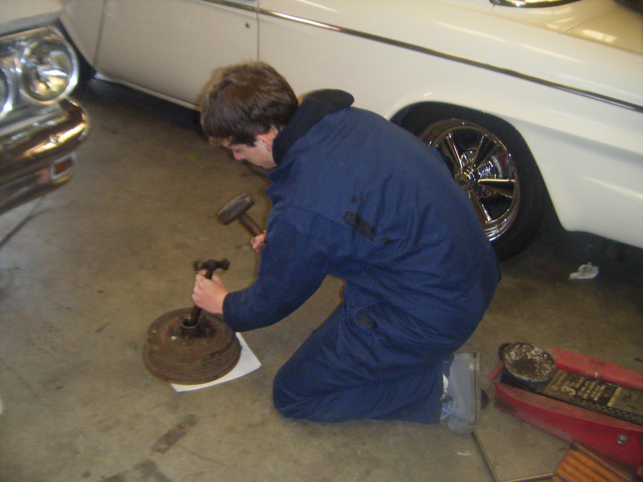

    We didn't get too much done this week end, but we got the rear end out and pressure washed, got the brake drums cleaned and painted, ready to be re surfaced, dis mounted the tires and began the clean up on the original wheels, spent some time just looking under the car planning the tear down.

    thanks for the advice monster. Our saftey glasses were too far gone to use. We do have a new pair now. drums are now surfaced, parts list from napa with part numbers is done, just shopping around a bit for the best deals.

    Looks like some great progress. I was suprised to see the rear axle issue. I wonder what the story with that was. What can cause a rear axle to break like that??? Puzzling.

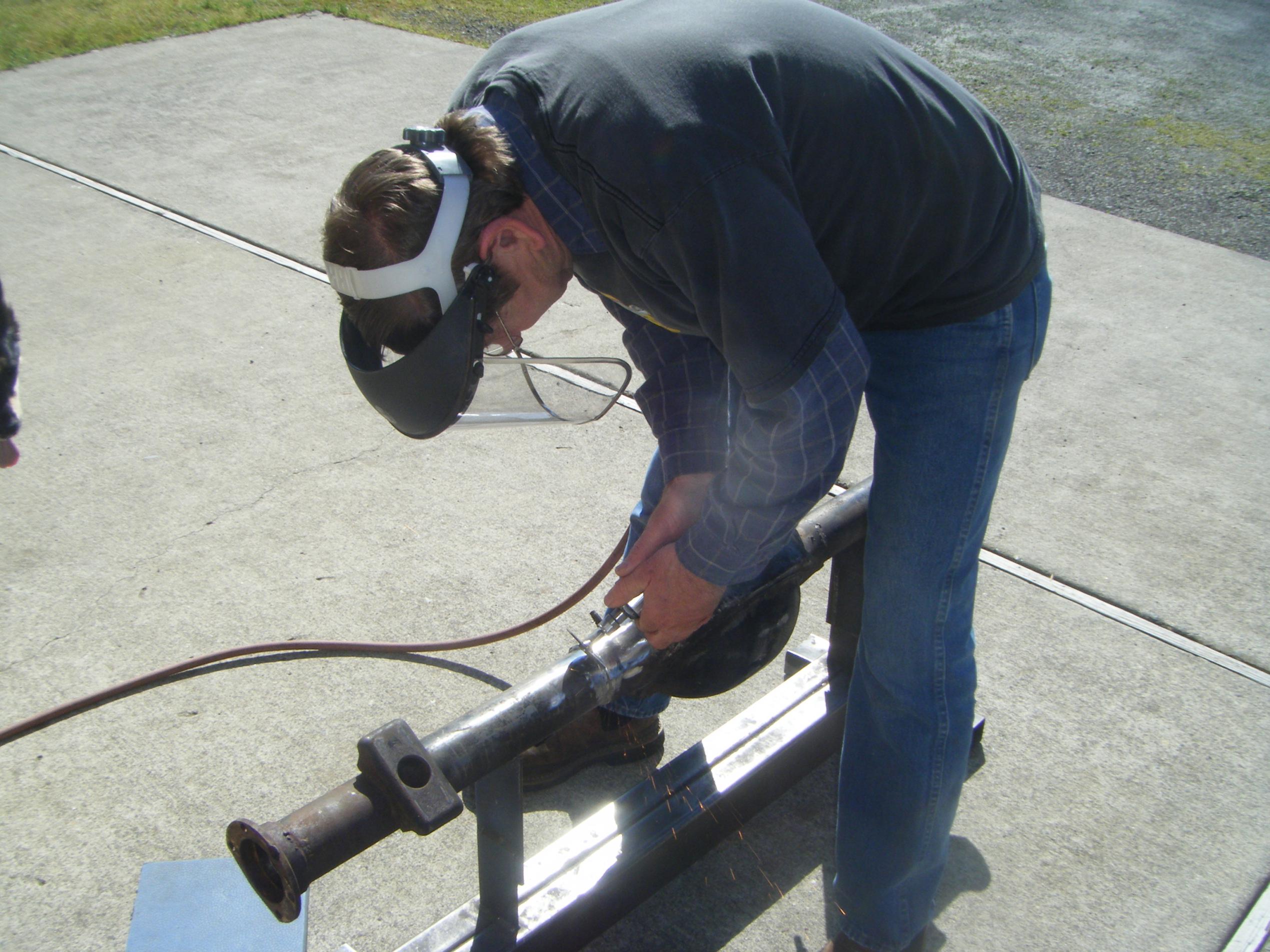

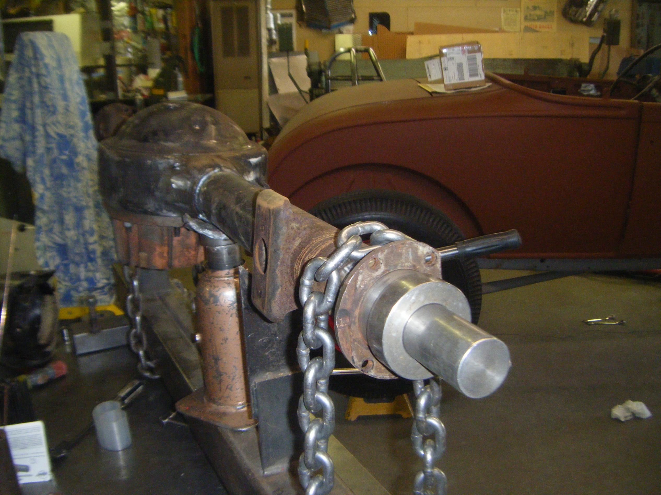

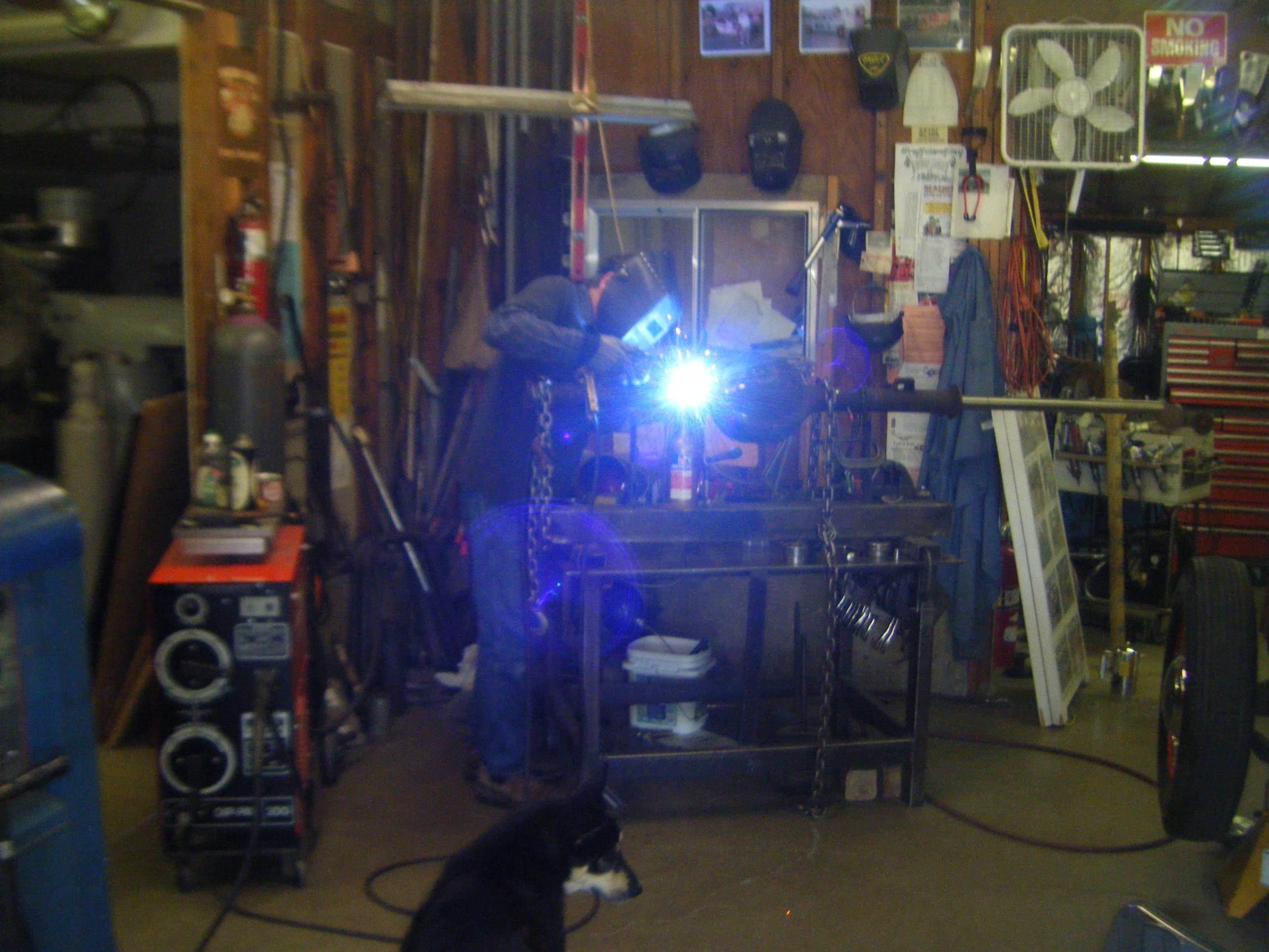

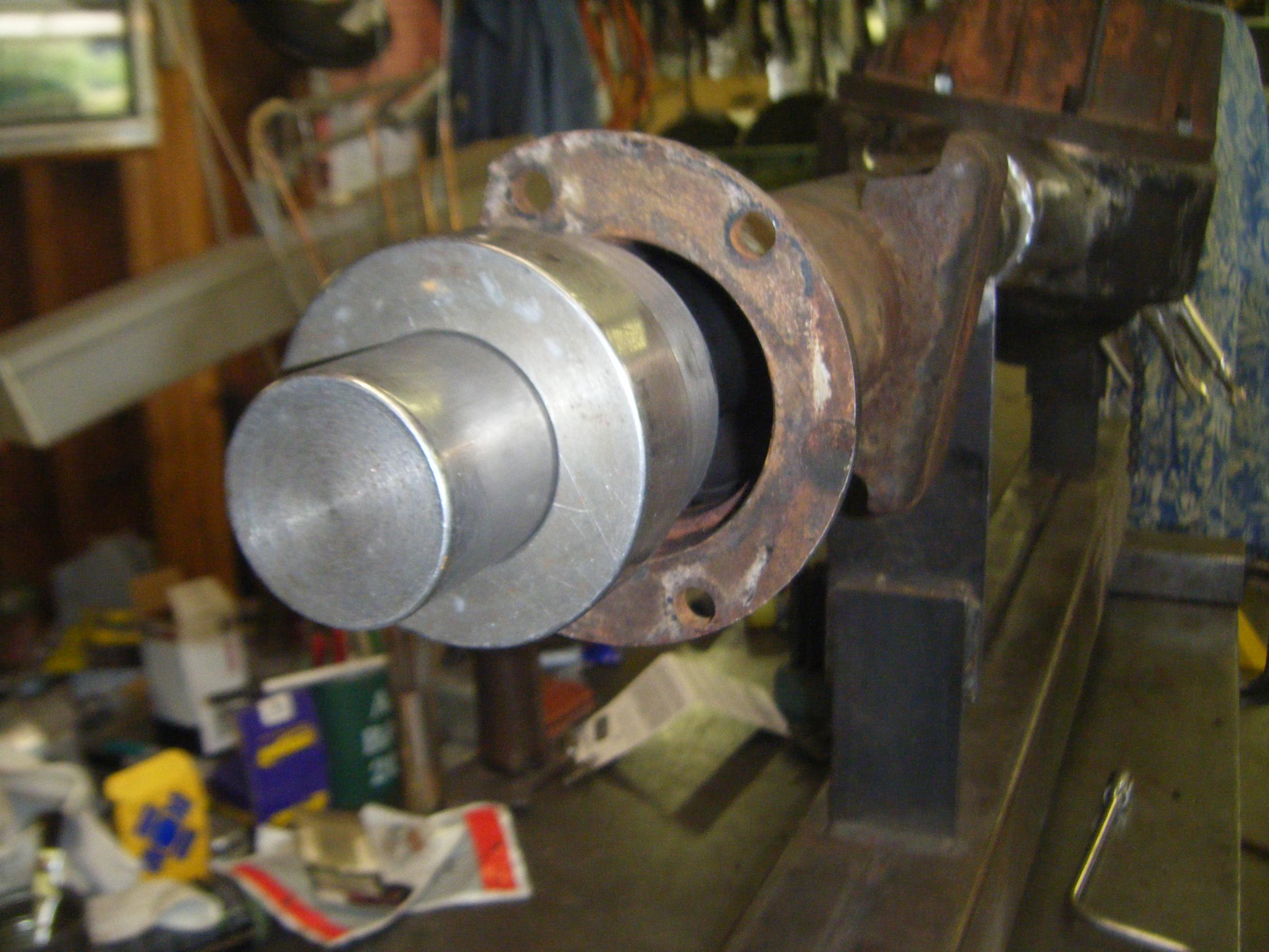

    Made a bit of progress today. Thanks to Friend and fellow Hamber Marty Strode, the rear axle housing is now ready to put back into the Merc. Marty was VERY generous in helping out 63RAT. He donated his time to this project. Thanks again Marty!!
    While joe was in school, I took the clean bare housing over to Marty's shop. He prepped the housing, put it in his jig, jacked it straight, and re-welded the tube to the center section. The affected axle tube was quite a ways off from being straight and true. Marty was able to bring it back to where it needed to be. He has a pretty cool set up for doing this. He has a jig, a dummy center section, a straight bar, a jack, and some machined cups and is able to true up a housing in short order.
    Now it just needs to be painted and re assembled.
