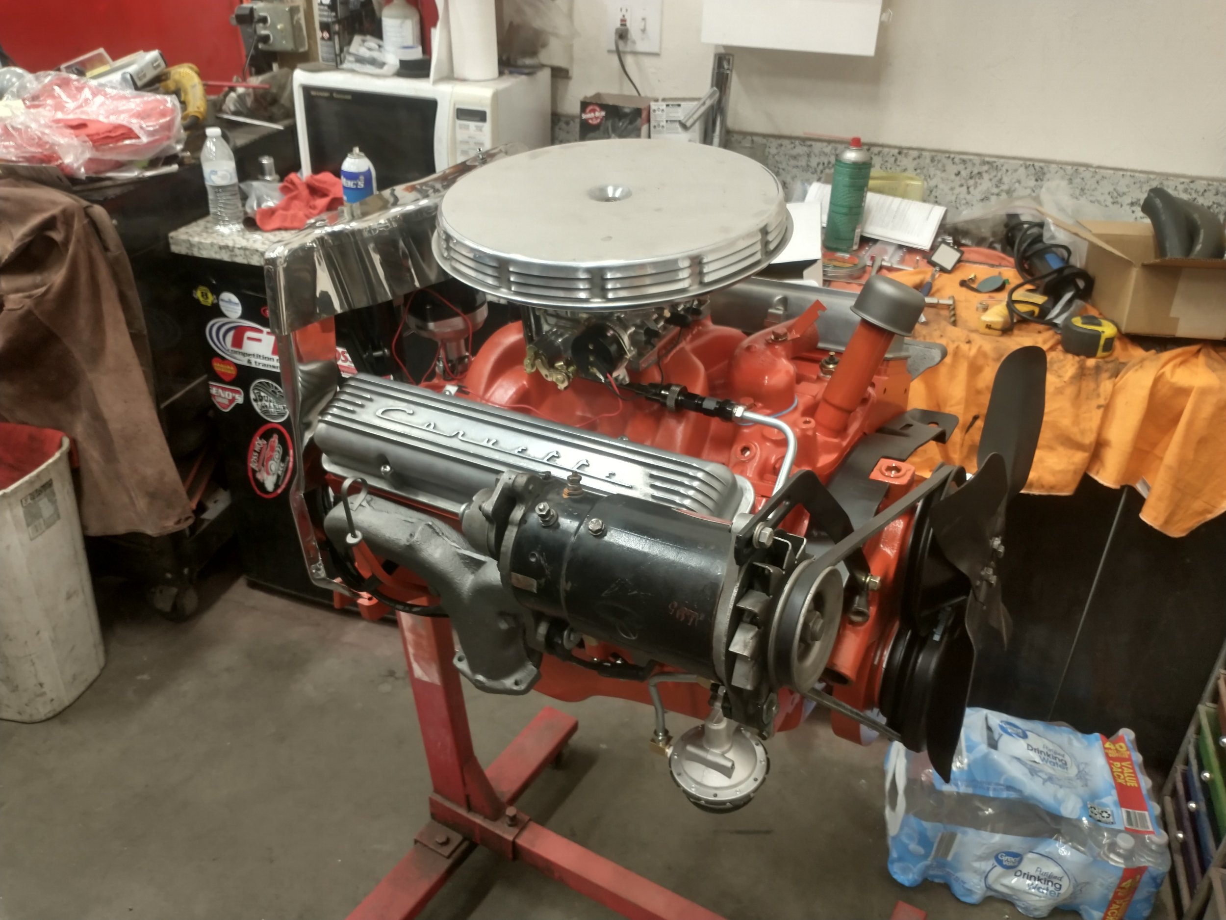

    This is a Blueprint 430hp 383.
    My point is, with some creativity anything can be made to look old/nostalgic. With a car as heavy as a 64 Impala a decently built flatop 350 with a decent cam and decent heads will give you what you are looking for. Hell my dad replaced the 327 in his 64 Impala SS with a 350 in 1973! Retire that little 283, that has served so well to under the bench till you can build a fun little 30s coupe or roadster around it. My .02
    Ps edit: that Vette ran and stopped like nobody's business when we were done with it and and at first glance it looked completely stock.
