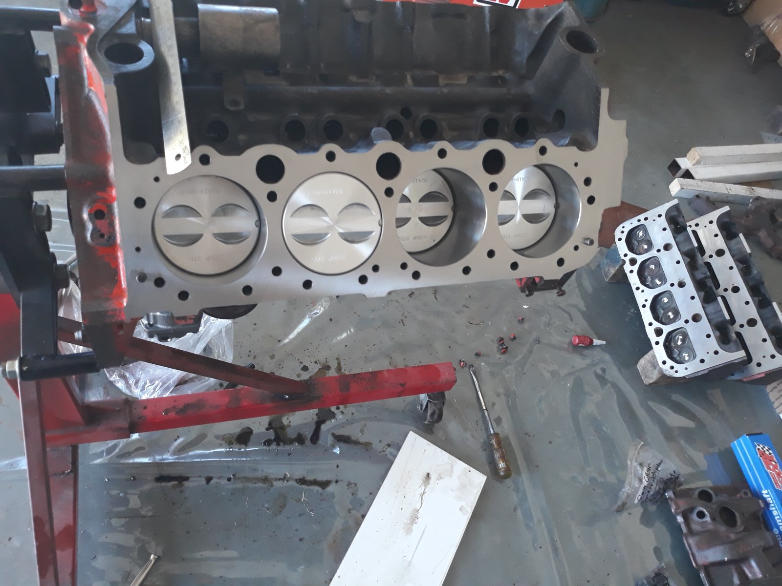

    I had the shop do my short block ***embly, money well spent and freed me up to do other things. I gave him my flywheel (I reversed the ring gear first) and clutch plate. I don't recall if the damper came into play.
    Refurbishing heads can run into some coin. I went with a Dart top-end kit that came with everything but the intake bolts. Another instance where money was well spent. I opted for 7/16" rocker studs.

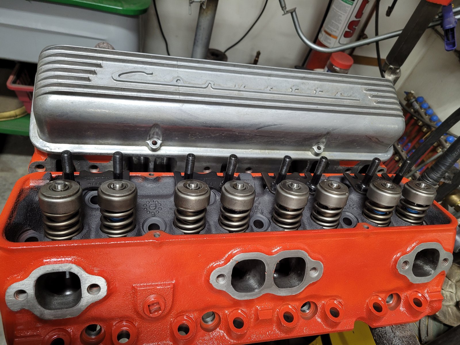

    I just had these done. New valves, springs, screw in studs, guide plates,, valve guides, seals etc.. I asked about hardened seats but was advised against doing them as the machine shop said they've hit water p***ages too often. I did a bit of mild porting and bowl work to open them up a bit.
    The total cost is getting close to a set of Chinesium aluminum cast heads...but what fun is that?
    I wish I had Anthony's one man machine shop guy nearby. $300-400 to freshen a set of heads would be a dream come true! 20240222_112938.jpg 20240222_113030.jpg

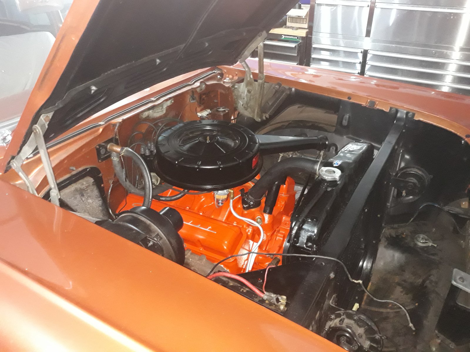

  12. 05snopro440
    Joined: Mar 15, 2011
    Posts: 3,497
    05snopro440
    Looks and sounds awesome!
    Sharpone likes this.

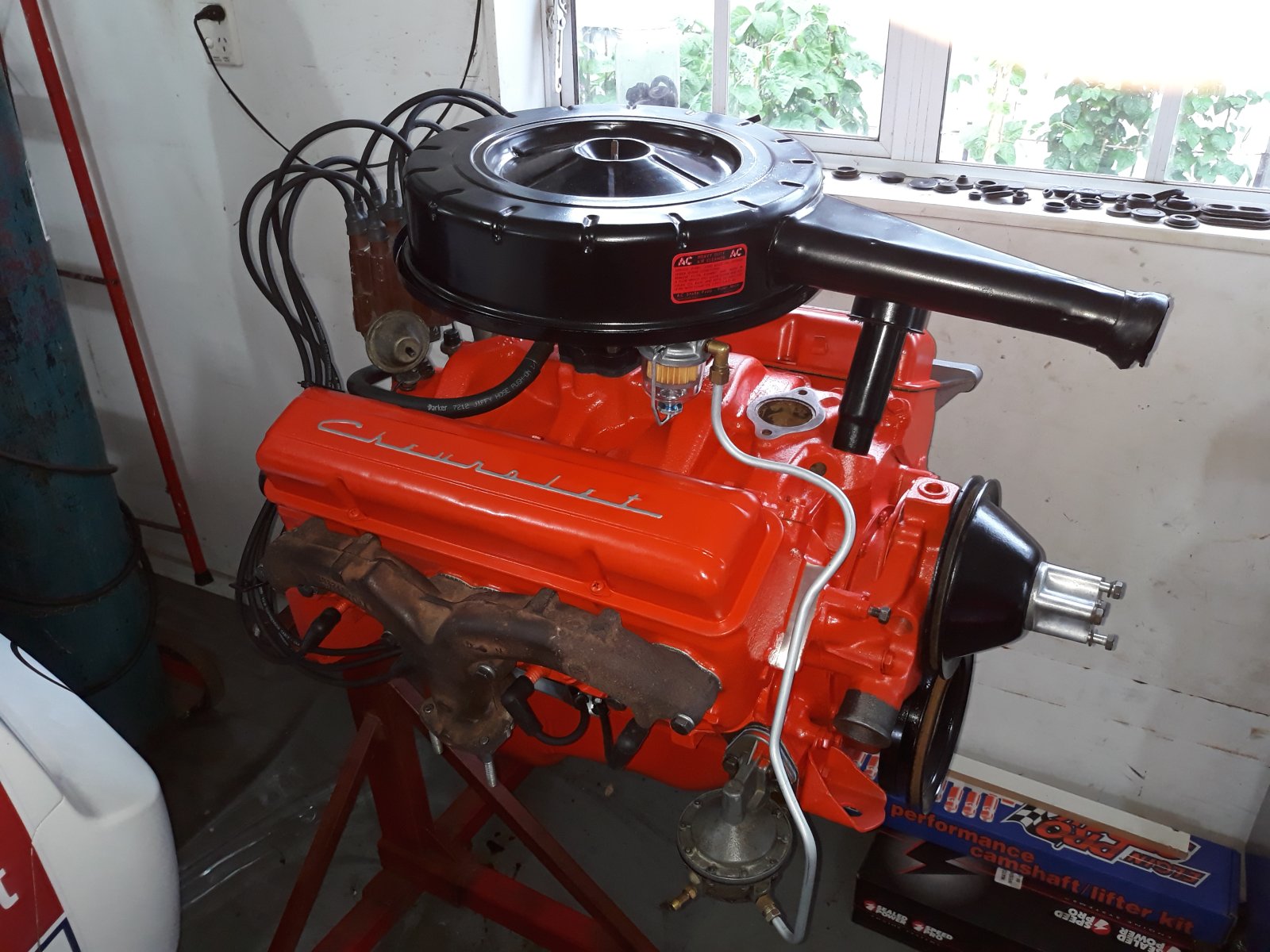

    Bryan, I went through the same process as you are planning on my/our 283 [I needed to keep the stock front mount 283 for our 57]
    I used a complete kit from Northern Auto Parts with a cam / valve spring option + I needed the early Rear Main seal, and early oil pick-up [55-57]
    I ditched the rope seal for a neoprene seal.
    This was all shipped to New Zealand and was still economical.
    One issue was, they sent the wrong cam bearings but they rectified it immediately [shipping at their expense]
    Also rebuilder pistons are further down the hole than OEM pistons , so I needed to deck the block.
    Machine work was a full clean out of all galleries, bore, decking, milling the head surfaces, and facing the valves and seats, valve guides, install cam bearings ,and freeze plugs [I lucked out on the crank]
    I upped the compression by decking to zero, and used a drop-in Melling cam [204° duration and 0.428" lift]
    Then I kept it 2 barrel so the engine had "diesel engine like manners"
    It is very responsive "off the throttle" as far as a 283 goes.
