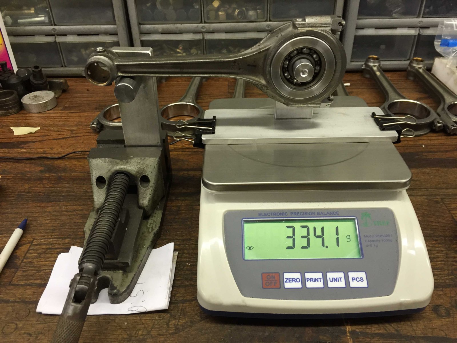

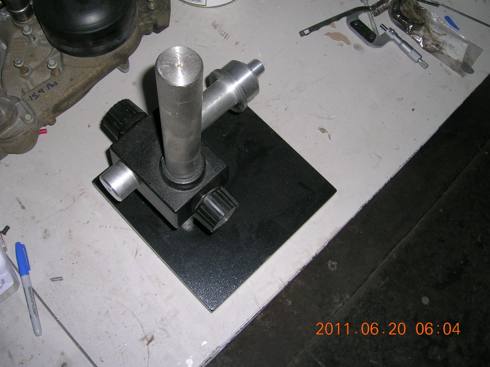

    It doesn't have to be fancy. I had this stuff left over from something and decided it could be easily converted to what I wanted. Get a cheap digital scale. Weigh pistons and wrist pins as well as the rods.

  15. Just an FYI, you'll find that unless you have a roller-bearing in the fixture when doing the big-end (to take out any drag at the pivot), you'll not get repeatable weights when weighing the ends of the rod (especially when the fixture is reversed and you're weighing the small end).
    I tried multiple types of fixed pivots (for the big end) and then took a set of rods on/off them multiple times and the grams of the small end kept changing. Then I made a roller-bearing based pivot - problem solved. Also, having the pivots fit the rod bores very closely ensures that the weight is always distributed the same - rod to rod. I make new pivots for different types of rods.
    Also, make sure your scale has enough resolution to get down to tenths of grams.
    Also, you have to balance each end of the rod - both ends need to match across the rod set. And then the totals should match as well.
    Here is what I ended up with for my setup:

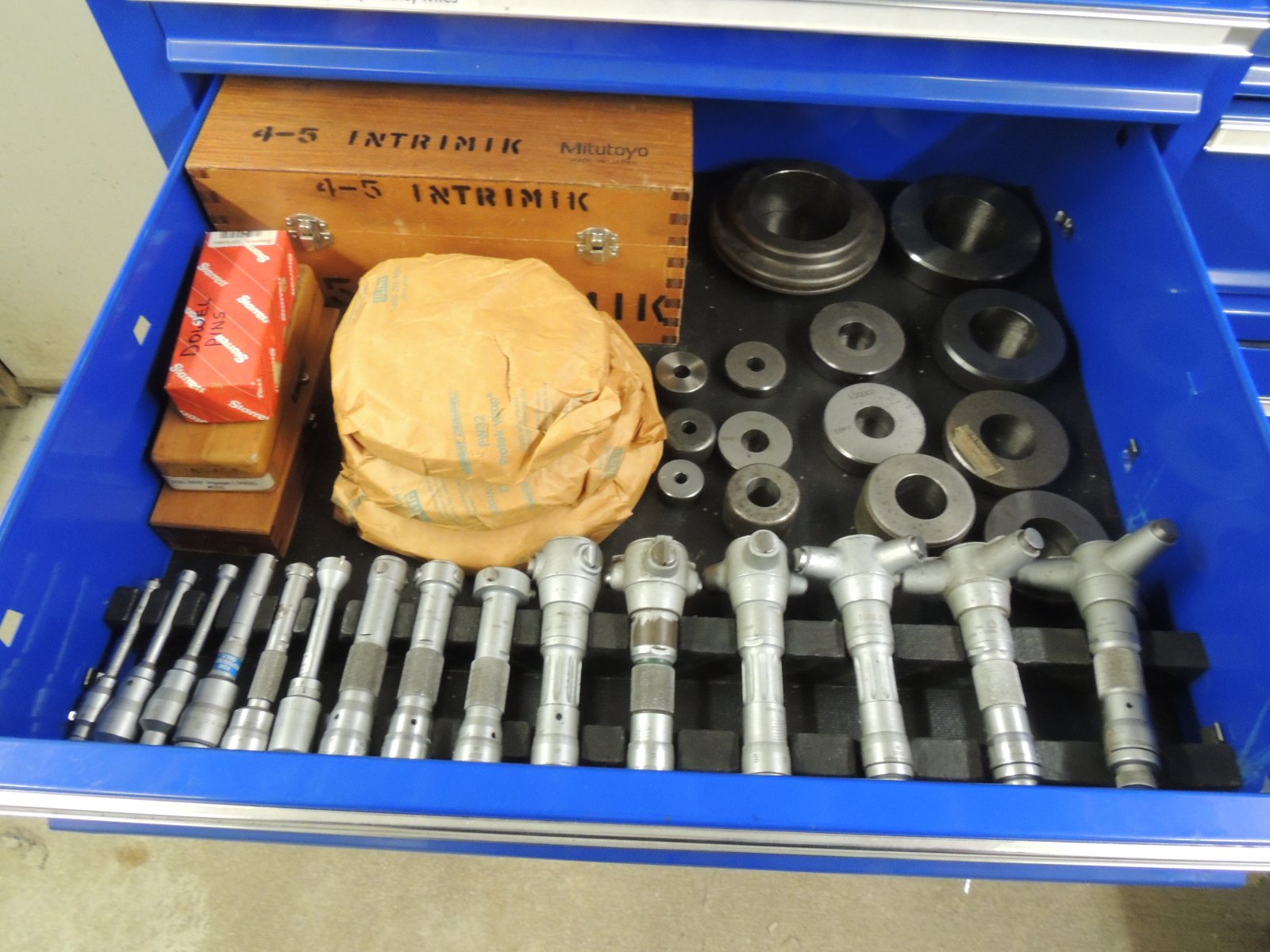

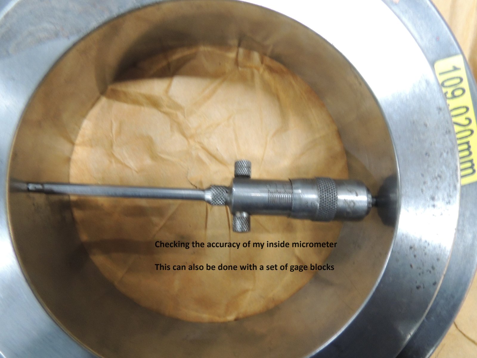

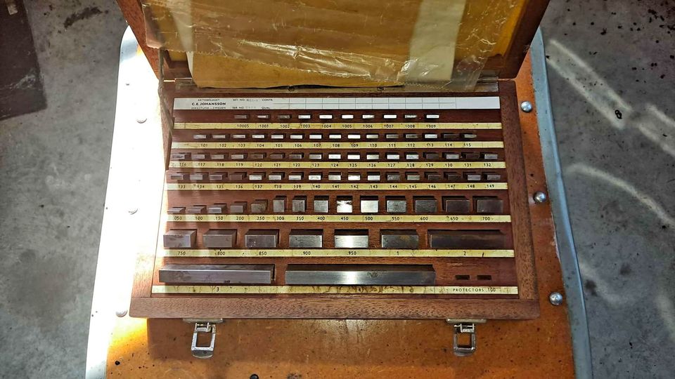

    This is one thing that I think you should reconsider. The reason I say that is because balancing the components is a time consuming task to get it just right. There is a lot of pride to be felt in knowing that you did it and you know its right.Not sure how much machine shops charge per hour, but I doubt that most truly get the best balance. They get you a good balance, but time is money. Its a simple task,......but it takes time. Your Choice though.
    Since you plan to build more engines in the future, let me suggest that you keep your eyes open for some "intrimics" and a set of "Jo Blocks" also called gage blocks. Get a large set of gage blocks if you buy some. They ask some high prices for them, but if you watch you will also see some for about $100-$125.
    I just checked the local Facebook and there were quite a few available for $125 or less, and some as high as $1k. This set was CHEAP at $50. These blocks are extremely precise and you can stack them to get an actual dimension. They are good for checking both your micrometers and your micing skill. They WILL be correct and never change size (although big companies recheck them anyway). You can also use them to set some dial bore guages for checking bores. Simply stack the blocks to equal bore size and put the long bars in the box on each end. Then set the dial bore gage to that dimension and compare it to the bore you have.

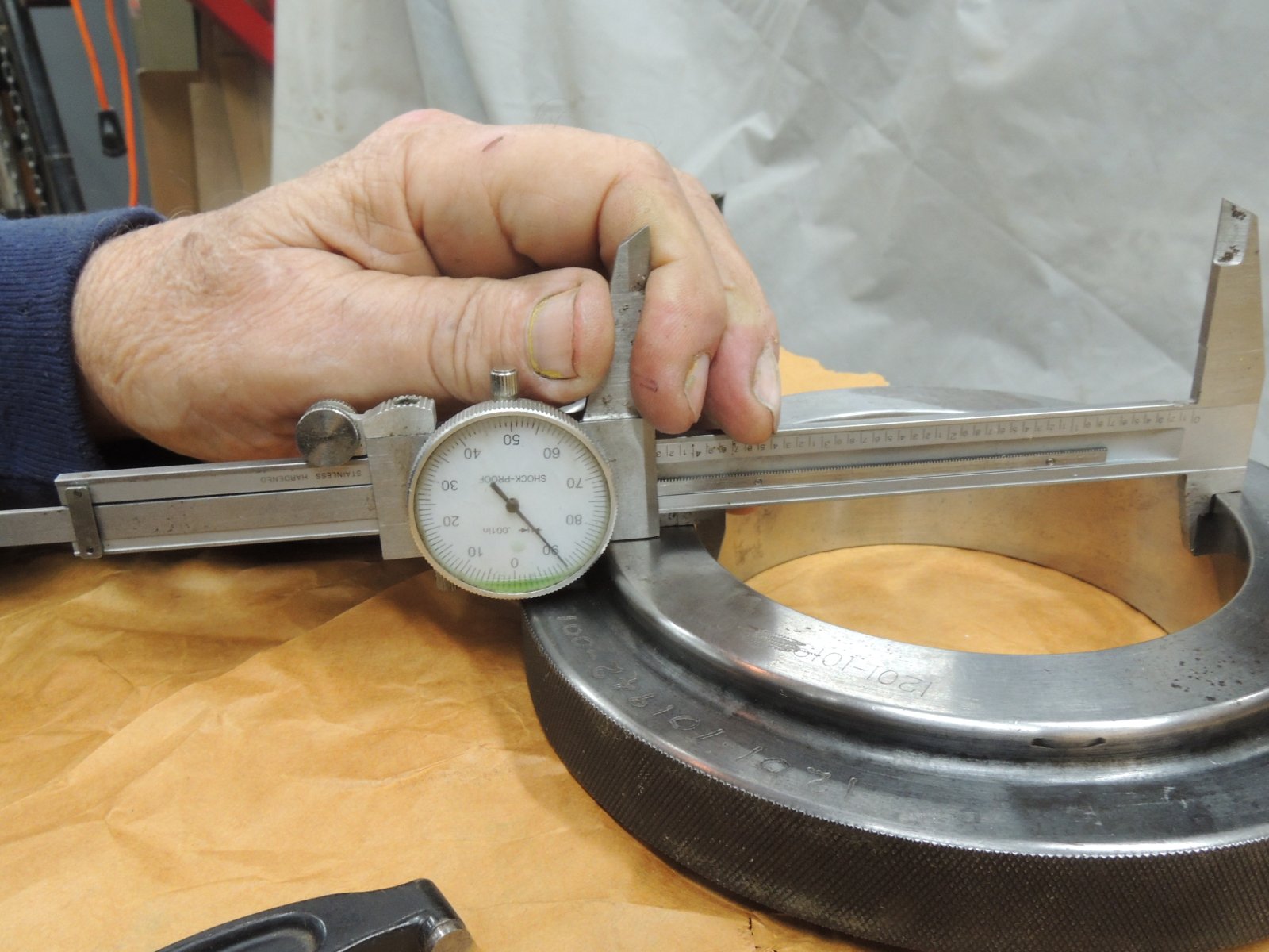

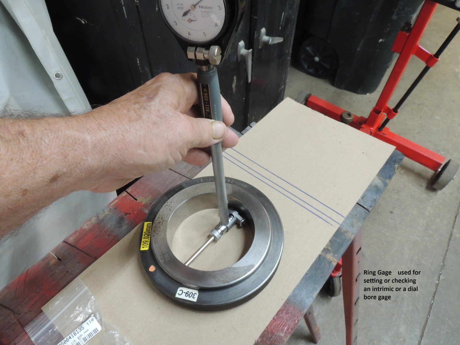

    I like having intrimics for checking bores. These are a little harder to find good prices on, but again watching for them on Ebay will eventually yield some reasonable prices. $100-$200. You should also look for a "ring gage" for each mic. It will probably be some oddball size, but thats fine. You insert the intrimic in the ring and check its size. If your intrimic reads the ring size correctly, it should read anything you check correctly. The thing to realize here is that these type tools will always hold their value. They have depreciated to a point where you can get good buys if you watch for them. I have an intrimic for checking the 4.300 bore diameter of Cadillac engines. Easy to use quickly and very accurate. Of course being a "tool-a-holic" , I couldn't stop with just one.:)
    You don't need all of these, but I make lots of things other than just measuring engine dimensions, so I bought these over about a year or so. Good luck with your project.;)

  25. It is not all that easy (unless you're very experienced) to measure a bore or bearing ID accurately with just a 2-point mic. A snap-gauge is better - in that you take it back out and use a mic to get the dimension, but a 3-point mic or 3-point dial bore gauge is what you really want.
    The only problem with 3-point dial-bore gauges is they are very expensive! ;)
