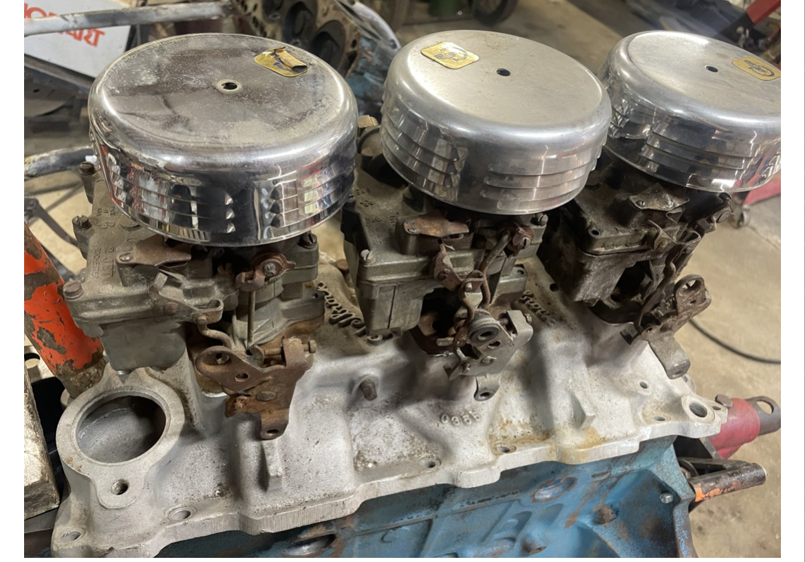

    Check this out..how would this do on a 283?

    How hard are triple or dual carbs to dial in?..with a vac gauge im ***uming?
  14. Sure. Plenty of 283/327 ran that with old cam grinds like the Dontov 30/30 or the 151 (350hp) cam
    Sharpone and bryan boswell like this.
  15. I only used the vac gage tuning multi carbs that were not progressive. Like motorcycles and British cars.
    The 2x4s I’ve been around had a primary and secondary carb.
    The 3x2s used the center as the primary. The end carbs were secondary carbs. No chokes, no air metering. The ****erflys would seal up and jet sizes reduced. All they did was dump fuel.
    I’ve been around those just enough to be dangerous. The 3x2 set up on my friends 348 works great. I’ll convert 2 of my regular carbs into secondary carbs like his.
    I’ll have to remember how we tuned the British rides when I set up these dual 1 bbl
    Carters
    Sharpone likes this.
