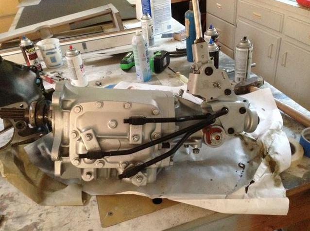

    Bought this bone stock 64 from a guy at work many years ago, pretty tired 250hp 327 with three speed on the column.
    I'd had my share of higher powered cars so figured it would be fine for a while just for a Summer cruiser, but a grandma column shifter didn't cut it, had it about a week and started collecting pieces for a Muncie four speed swap, the plan was to use a Hurst shifter but I stumbled onto a mostly complete original 64 shifter, it was missing the 3-4 lever and rod but got them at the Portland Swap Meet, the real score was the the mint original four speed shift boot that the guy had left in the car, said I could have it if I came and took it out, I did not hesitate as he lived only fifteen miles from me.
    I planned on just removing the shift handle from the column but got real lucky when a guy in Boise Idaho advertised an original floor shift steering column for sale in the Nickle Ads, I was going to leave it black but found some matching fine textured turquoise paint for it, it came out real nice, a lot of people thought it was an original four speed car.

  6. DDDenny
    Posts: 23,416
    It really was a fun car to drive, give me a clutch pedal and a Muncie and I'm good to go.

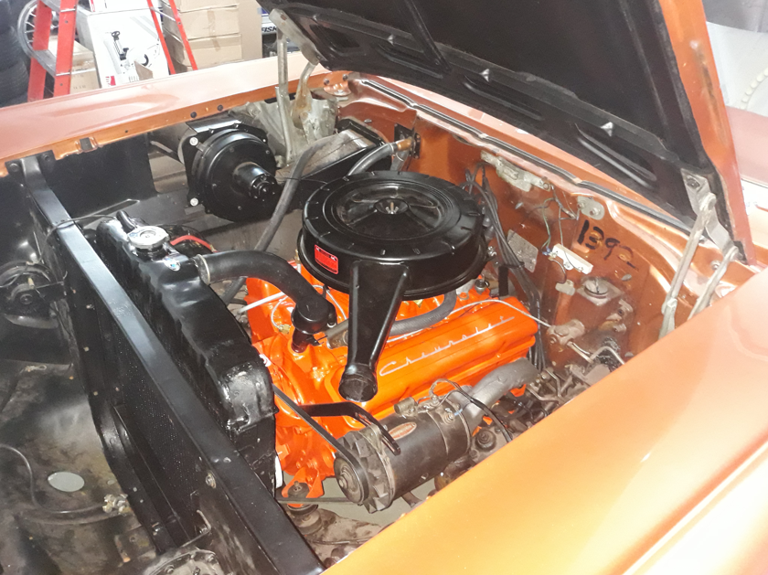

    Now confession time [with my 283] I like diesel like manners with street engines. This was also a lesson I learned from my friends 383 stealth engine.
    With the 283 engine in my 57 Chevy , I went the opposite direction to conventional thinking.
    The cylinder heads and intake on this engine are from a 56 Chevy 265 [ I've kept the original 283 heads in storage]
    Casting number is 3725306. and the chamber volume is 56cc. and the intake ports are tiny requiring a matching 265 intake [283 and newer intakes and gaskets cannot be used]
    I kept the baby 1.72 valves but we back cut them and did a 3 angle seat job on them.
    The block was zero decked and I installed a 205° duration cam
    Compression was slightly over 10:1 [10.05:1]
    The goals were ,was High RPM behaviour at Low RPM so we targeted high port/manifold velocity and got the air flowing when the valves were "just off the seat"
    The engine pulled like a tractor which was great with "3 on the tree" [non-syncro 1st gear]
    Cruising around town at 30mph in 3rd is only 1400 rpm and it is extremely docile.
    The engine still retains the original staggered bolt rocker covers but I did switch to a '58 paper element air cleaner.
    One mod I am seriously considering is a Camaro T5 with an S10 Tail housing / shifter.
