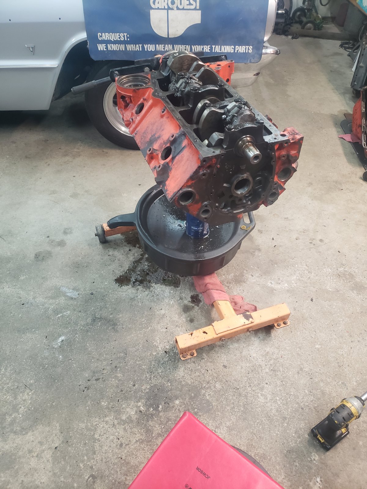

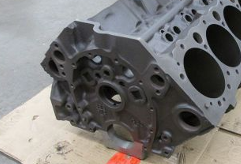

    I've been trying to get these plugs out and havnt been able to. And I dont see were these are on other sbc's I've seen. Zoom in and they are the two 3/4" plugs on each side of the came bore. 20240331_011627.jpg
  5. Kerrynzl
    Joined: Jun 20, 2010
    Posts: 3,634
    Kerrynzl
    Lifter gallery plugs
    Get you machinist to remove them when he cleans the block and re-install new ones.
    There are a couple of others at the rear [oil pump feed ] that are below the deck.
    hrm2k and GlassThamesDoug like this.

    Ur talking about the three little plugs or "soft plug" type ones ? I got all those out i think there were a total of 8 if I remember right and I was ganna tap them for regular npt plugs. I mean those big plugs with a 3/4 size square drive in them..unless that is what you ment?
  7. bryan boswell
    Joined: Mar 20, 2024
    Posts: 96
    bryan boswell
    from Ontario ny
    There about the same size as the regular soft plugs
  8. Kerrynzl
    Posts: 3,634
    Kerrynzl
    You mean these ??
    You leave them alone!!!
    It is now part of the casting
    Here is a 68 327 Block # 3914678
    Now would be a good time to measure the bore on your block!
    It had a transmission conversion ! so who knows ? maybe a 327 conversion as well
    327 = 4" 283 = 3.875" [3-7/8"]

    Yes it had a 4 spd from power glide. Whats the purpose of them? It is a 283 bored .030. And cranks been ground 10/10. Have not checked rear end yet no..

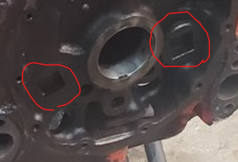

    Any one know what those two plugs are for?
    What would a 350 stroker be?
  14. Vic Walter
    Joined: Jan 21, 2018
    Posts: 172
    Vic Walter
    Those big pipe plugged holes on either side of the cam were to allow the sand casing core (water jacket space) to float within the sand casting mold of the block. After steel was cast into the mold those holes allow for access to the water jacket space to aid cleaning out of the sand core. During machining, those holes were tapped and the plugs installed to keep coolant contained in the water jacket. If memory serves there are also similar holes on the rear. Modern mold making does not require them.
    In any case, do not remove them unless you have evidence they have been leaking coolant into the oil pan.

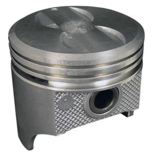

    You need a 3.625" stroker crank , Chevy 400 Rods, and 30 over Chevy 250 pistons / Chevy 307 "Rebuild" pistons.
    The 3.625 stroker crank is large journal , so you have a choice of grinding the main bearing journals [and rear oil slinger] Or tunnel boring the mains in the block.[and rear oil slinger on the crank]
    The 400 SBC rods are 5.565" long and the same 2.1" large journals as the crank.
    The pistons needed are Silvolite Cast Pistons for a 250 Chevy 6 cylinder ,but you would need to buy 2 sets to get 8 pistons [or 1 set and 2 spare pistons]
    These pistons have a compression height of 1.640" which would have a deck clearance of 0.0075" [7.5 thou]
    They also have a "D" shaped 7cc Dish so it would net a 10.18:1 compression
    These pistons are cheap
    https://www.summitracing.com/search...atch&SortOrder=Ascending&keyword=1446C-.030K1
    Northern Auto Parts also sell these pistons individually at $18.25 ea
    https://northernautoparts.com/piston-chevy-250ci-4-1l-l6-1446-030/
    You probably will need to cut valve notches in these for a higher lift cam [but easy to do DIY with the right cutter and a cordless drill]

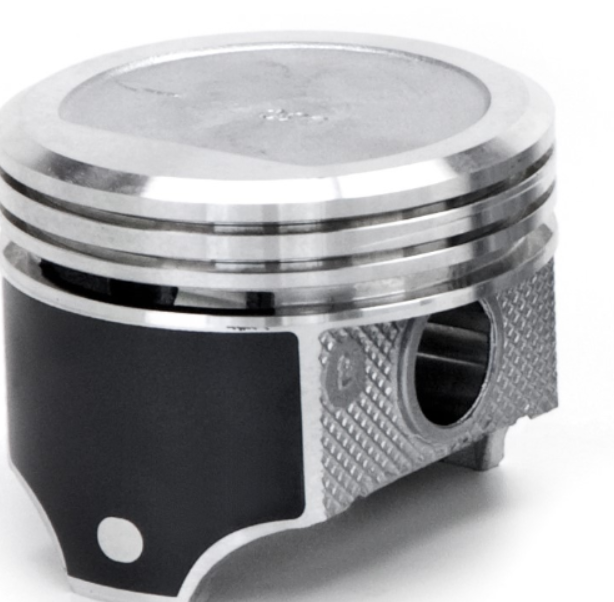

    Another [maybe better] alternative is "rebuilder" 307 Chevy pistons
    Standard Chevy 307 pistons are 1.675" compression height but Rebuilder Hypereutectic Pistons are usually 0.020" further down the hole [with a 1.655" compression height]
    The whole combo in a standard deck height 283 block will have the pistons 0.0075" [7.5 thou] out of the hole
    From there you have a choice depending on your heads.
    If you use low compression heads just leave the pistons as is ,and use 0.041" compressed thickness head gaskets.
    This leaves 0.033" quench.
    If you're running power packs , I recommend increasing the intake valves to either 1.84" to 1.94" and de-shroud the chambers around the valves near the bore. [this should add a couple of cc to the chambers]
    Then you cut 7.5 thou [0.0075"] off the piston crowns to zero deck
    This would net a 10.6:1 compression ratio
    If you cut 17.5 thou off the piston crowns [for 10 thou deck clearance] it would net approx 10.2:1 compression
    I have safely cut 35 thou off pistons in a Road Racing engines
    Silvolite hypereutectic pistons have a bevelled crown, so cutting the crown does not compromise the top ring land [and they are 1.655" comp height]
    These pistons are Silvolite Piston Set 1438.030
    https://www.heavydutypros.com/silvolite-piston-set-1438-030.aspx
    so you need to weigh up whether buying 2 sets of 250 pistons is cheaper than the cost of machining the crown on 307 pistons [there is 2 choices]
    The crankshaft is cheap at $745 made by Eagle from Forged 4340 which is overkill

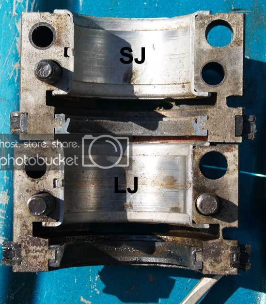

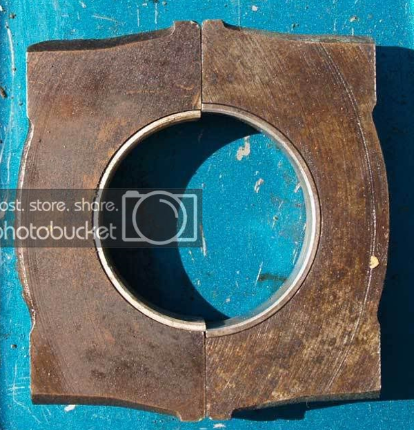

    Here is an early small and later large journal bearing cap for comparison [they are the same except the machine work]
    There would be no strength issues should the block be tunnel bored
    The oil slinger groove on the large journal is deeper , so the easiest method is to cut down the slinger on the crank.
    And you can get the main journals ground down while you're at it [and leave the block alone]
    The crank would be no weaker than if it was originally a small journal crank [and Forged 4340 is overkill anyway]

    If you decide to tap any of the holes you removed plugs from and install threaded plugs to replace them, take a close look to insure that there are not p***ageways inside that might be blocked with a longer threaded plug. Plugs also come in different lengths. I did that on a Cad engine I'm building and there was an oil p***age just inside the hole. If I used a slightly longer plug, as it screwed in, it would have reduced or possibly cut off flow thru the p***age. I had to get a shorter plug to insure that it didn't restrict the flow. Don't know if the Chevy may have that problem or not.
    bryan boswell and Sharpone like this.

  29. Kerrynzl
    Posts: 3,634
    Kerrynzl
    Also be careful of the rear cam bore plug on a 283 .
    The depth is very important , so measure and keep records before you knock it out.
    The best way is to use a hammer and a block of wood and hit the old camshaft through knocking it out.
    [then it can be reused if you cant find a replacement]
    The early ones are very shallow and an oddball size [2-1/64"]
    Later ones are 2-7/64" and a lot deeper ,and these always come in universal 283-350 freeze plug kits.
    So try and save it [and definitely measure it]
