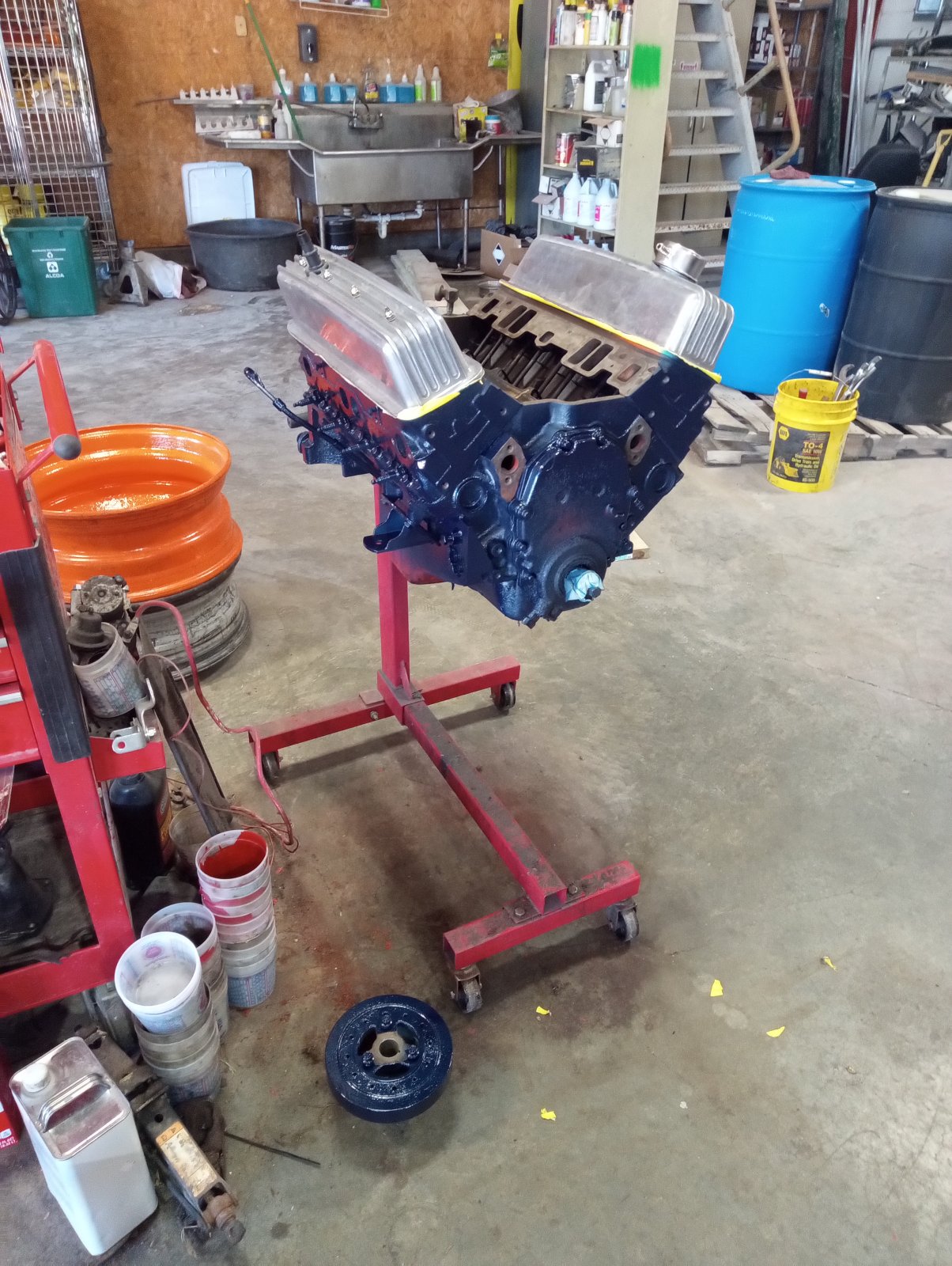

  15. The right valve covers will ungoofylook a vortec head a bit. Lol IMG_20240614_173220072.jpg
