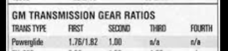

    Keep in mind a vehicle with a Muncie 4 speed manual will roll out much quicker than a PowerGlide will. IMG_3597.jpeg IMG_3598.jpeg
