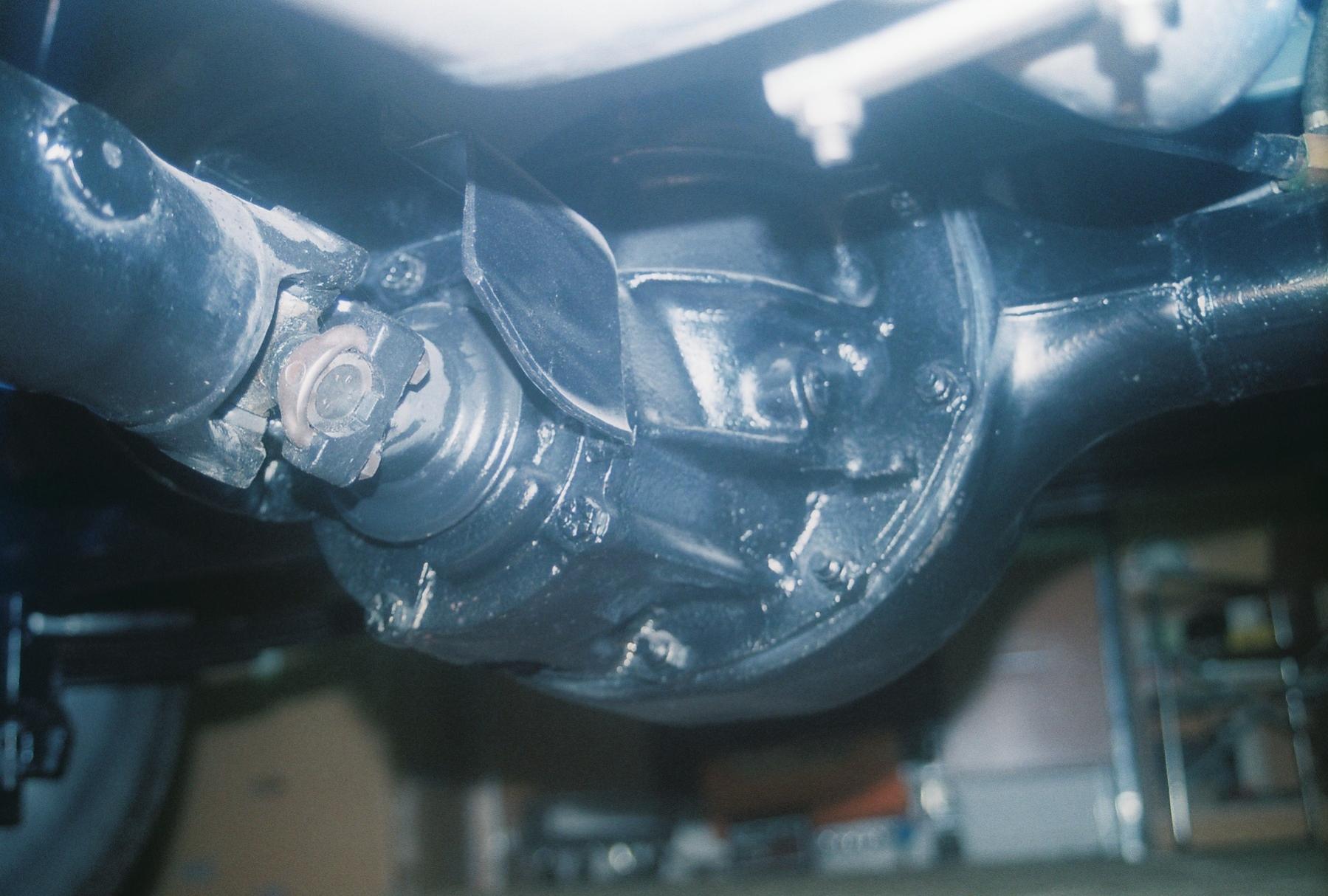

    I think a point about the Mopar S/S springs that is being overlooked is that they were designed to be used with a pinion snubber. Thats what really made them work. The a-symetrical springs are stacked heavy on the front third (front spring eye to center bolt) making them almost solid like a traction bar. But the back two thirds (center bolt to rear spring eye) are stacked soft and "wind up" in an "S" under hard acceleration. This allows the pinion/U-joint angle to get so extreme it can break the U-joint (probably what happened to AFXDave). Mopar even made an adjustable pinion snubber for the 8 3/4 that could be moved up or down to maintain 1/4 to 3/4 inch clearance between the snubber and pad. Some guys even ran them dead tight or with 1/4 inch preload. Back in the early 60s when NHRA would only let Stockers run "bolt on" traction devises, Lakewoods & a pinion snubber was the hot setup on most anything non-Mopar.

    Pinion snubber?
  5. MD1320guy
    Joined: Dec 18, 2010
    Posts: 231
    MD1320guy
    Yes...They made pinion snubbers for 9 inch & Dana 60s also.

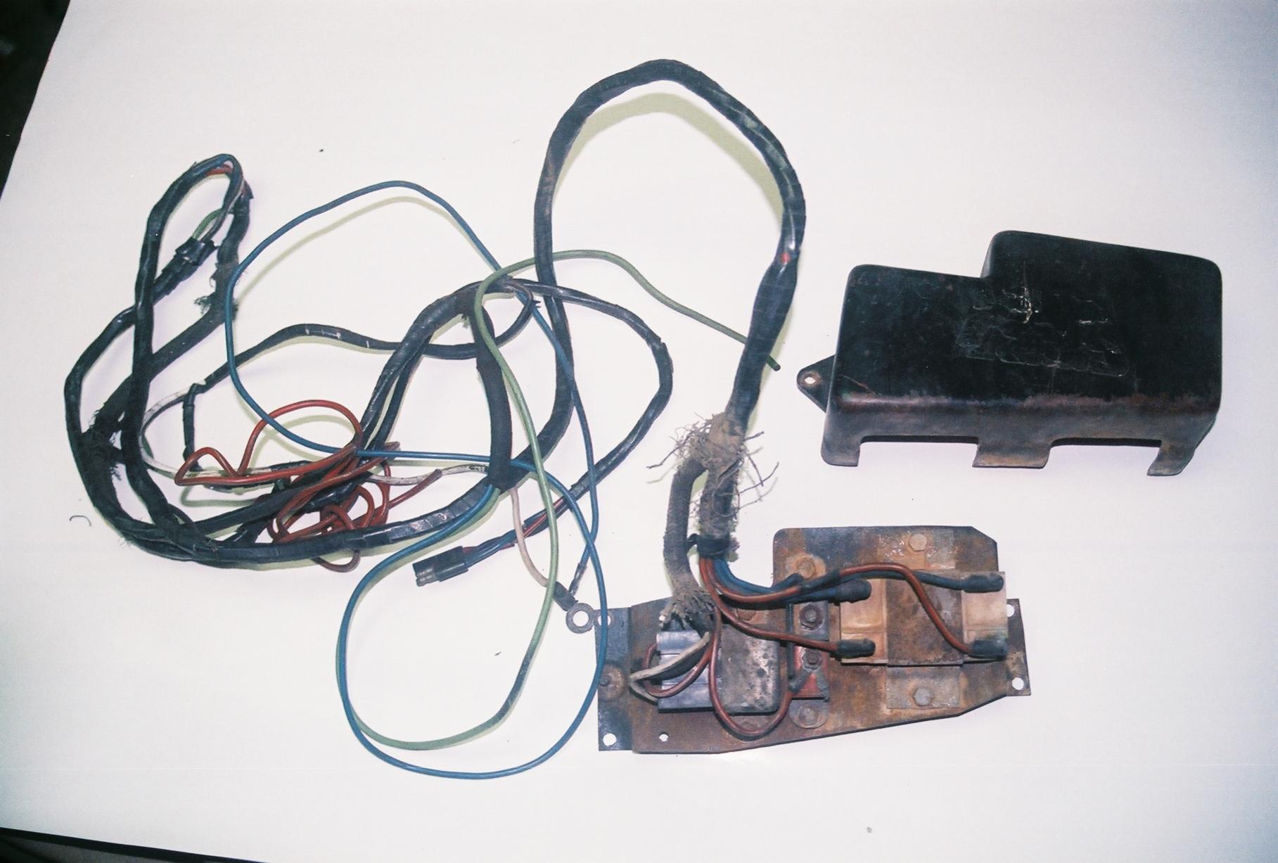

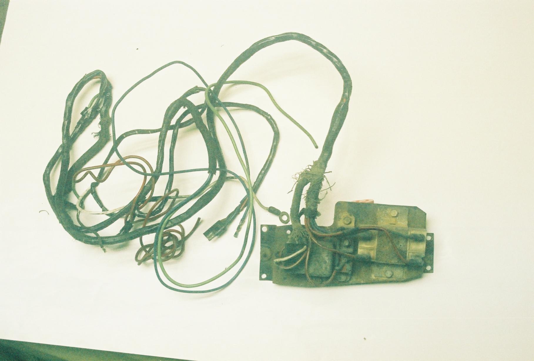

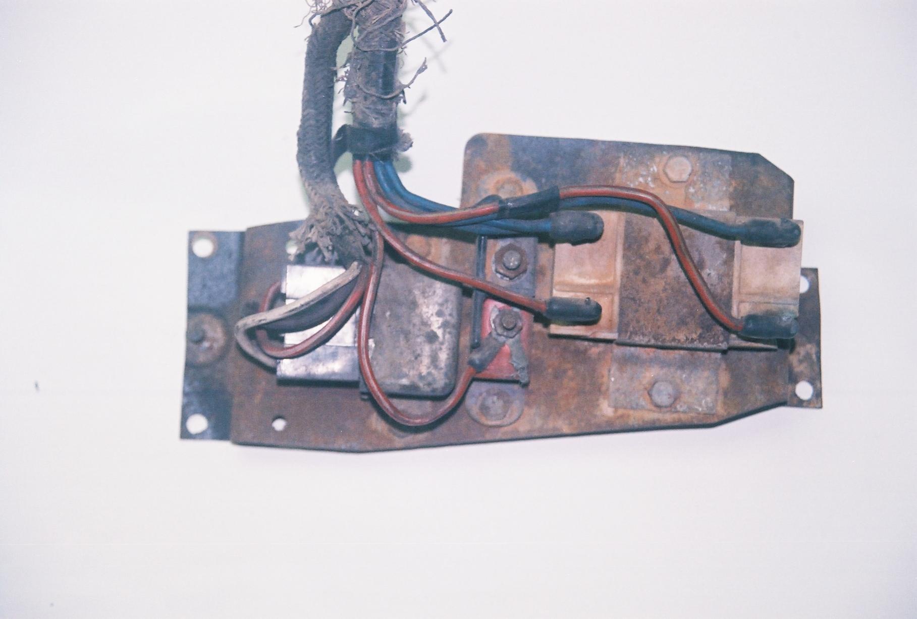

    O.K. you guys...it's time to play "Name That Part".Attached are four pictures of the same part.The fact that it is on this thread should give you a clue.AFX Dave and Dennis K. can't play cause you two guys know what it is.And it is not bigger than a bread box.

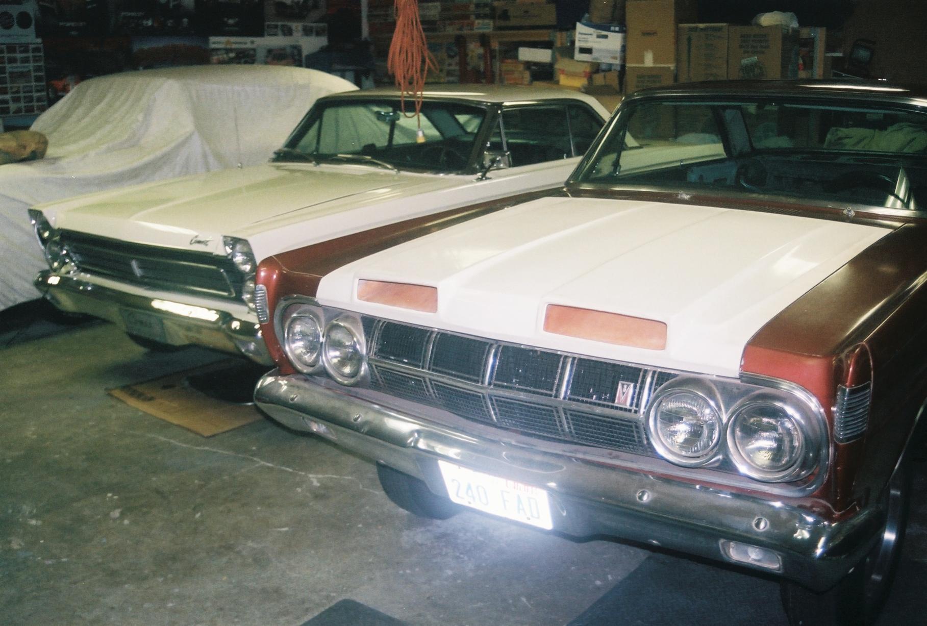

    I haven't posted any recent pictures of the 64 Hawaiian Hi-Po Cyclone since bringing it to Utah with me.Here are some pictures taken this year in my friends garage parked next to his 65 Cyclone. The 65 is completely restored by my friend and is a work of art.The 64 is a work in progress.The only things left to do are the interior and exterior.At this time the old custom black diamond tuck and roll,carpet,sound deadener and seats are completely ripped out.The interior is going to be completely redone.Then comes the body work and paint.Probably some new wheels and tires too.I'll try and do a better job of keeping this up to date.Just a note; the mystery part that I posted earlier came off of the 64.

    Both great looking Comets! The mystery part has me stumped but I keep looking at it and the connectors for a clue. Brian

    Transistorized ignition box.

    Winner Winner,Chicken Dinner!

    Steve;the black box gave it away!!! I had never seen the insides before!!!!"Sometimes even a blind squirrel finds a nut"!!!!! I'll take a season without breakage as my winnings!!! Larry;your reaction times are too slow,need to break out the practice tree! ROY.

    Future plans on the Hawaiian Hi-Po do include a original 64 B/FX front bumper and Crites front fenders.The Cyclone is factory Vintage Burgundy,but that might change also.The engine,trans and drivetrain have all been rebuilt as well as all the front and rear suspension.I have factory lift bars for it,but not sure if we are going to use them.I would like to,but my friend isn't so sure.The picture of the 9 inch pinion snubber posted earlier is from the 64 Cyclone 9 inch rear.And yes,the 9 inch has 31 spline axles with a factory 4.71 locker.

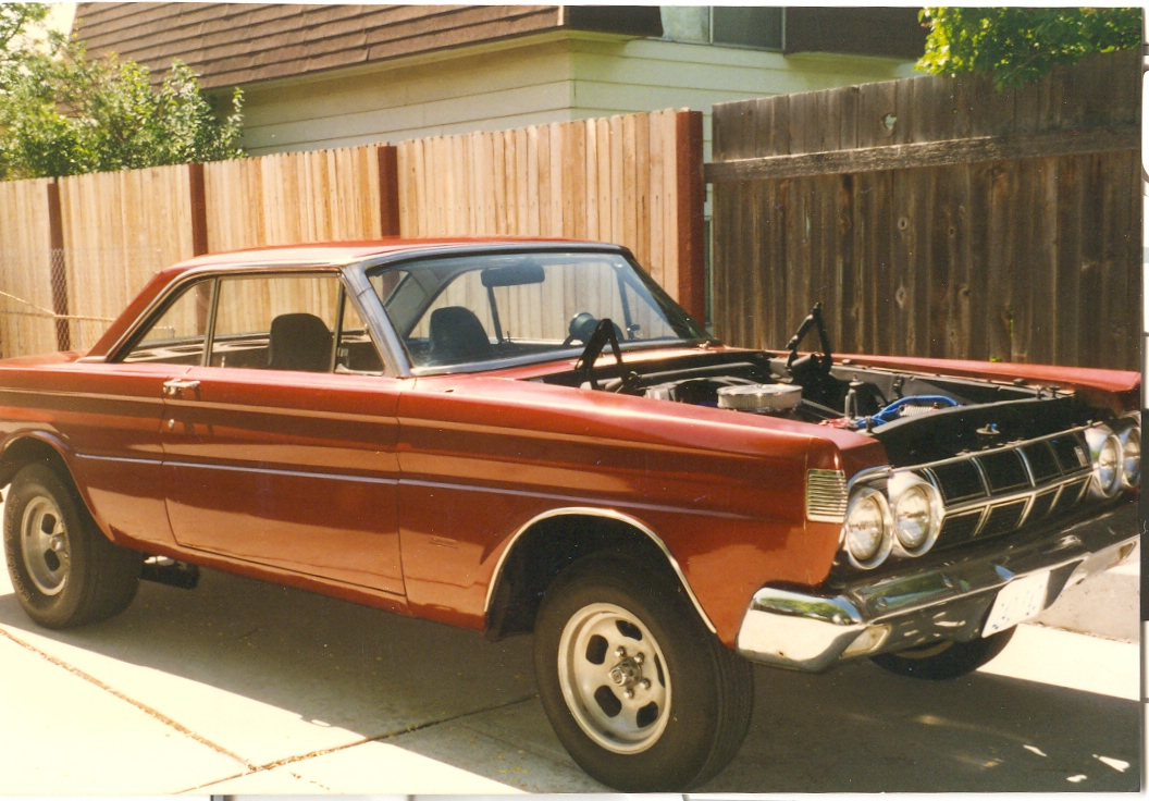

    Some pictures of the Hawaiian Hi-Po with the new suspension and new stance.
