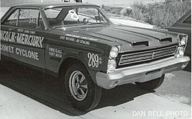

    Dale, Your 289 will get you in the 11's but like Roy said you will need a bit more cam and some compression would not hurt either. Just getting your rear end settled down should help the 60' times?
    In the 80's when I first was getting my car going I had a radiator shop put in a rear pickup on my stock tank. I mounted a Holley black electric fuel pump right at the rear and ran 1/2" aluminum line up to a regulator under the hood. That was temporary. 30 years later it is still there. I like Dave's idea on a car like yours to hide a fuel cell. Brian

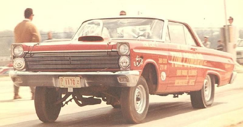

    Good Job on the pics, Is this the Thompson Comet. Looks like it was for sale, I couldnt imagine strolling through the pits today and debating if you should buy it or not. Probably came with a Trailer Also.

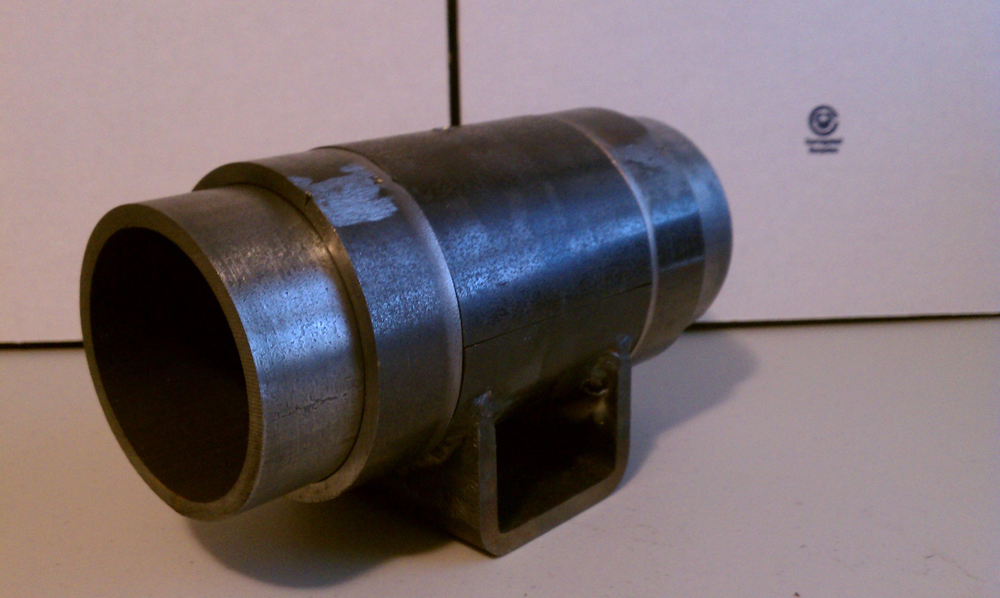

    I agree with 65Comet, if you are going to use any type of solid mount traction bar, a housing floater is the way to go. If the pivot point of the traction bar is not identical to the forward spring eye mount spring bind will increase the further apart those two points become. I built these floatersfor my Falcon project for under $30. A pair of mail order spring perches & 1 foot of 3 inch schedule 40 pipe (3.062 ID x 3.500 OD). After cutting & grinding the rings square, the saddle rings were cut in half with one half then welded to the spring perch. The mating surfaces were surface ground and then the saddles were honed to 3.015 ID on a connecting rod machine. The the top saddle was drilled & tapped for a zerk fitting. The stop rings were made by simply cutting a notch, clamping it tight around the axle tube and welding it back together to shrink it down to 3.000 ID. Of course I was working with a housing that did not have ends on it yet. With an assembled rear you can just cut the stop rings in half to install. Hope this helps.
    Mike

    I used a floater set on the rear axle housing of my 66 Comet 427 FE SS car and they work great with the adjustable ladder bars, with that setup you don't have to have the location for pivot on car to ladder bar to a certain point. With leave springs the pivot point is NOT at the eye of the front of the spring like most people think. There is a Math Formula that is used by Chassis Designers so he can get the Correct possion, then he uses that new center point to determined the pinion angle for the driveshaft angle. Now that center point is the front pivot point of the traction bar, with the rear bar that is welded to the axle housing. That how it was designed at Hollowell Engineering in Dearborn Mi. when they did 64 Comets and T-Bolts. ~~~~~~~~AFX DAVE~~~~~~~~

    Thats alot to digest with the floaters. You guys kinda shot down my thoughts on these missile bars, eh?? I need to map this stuff out in my head when we get back from camping.I got a look at a set of Crites set-up on Todd's comet, and it seems to be a rigid set-up??
