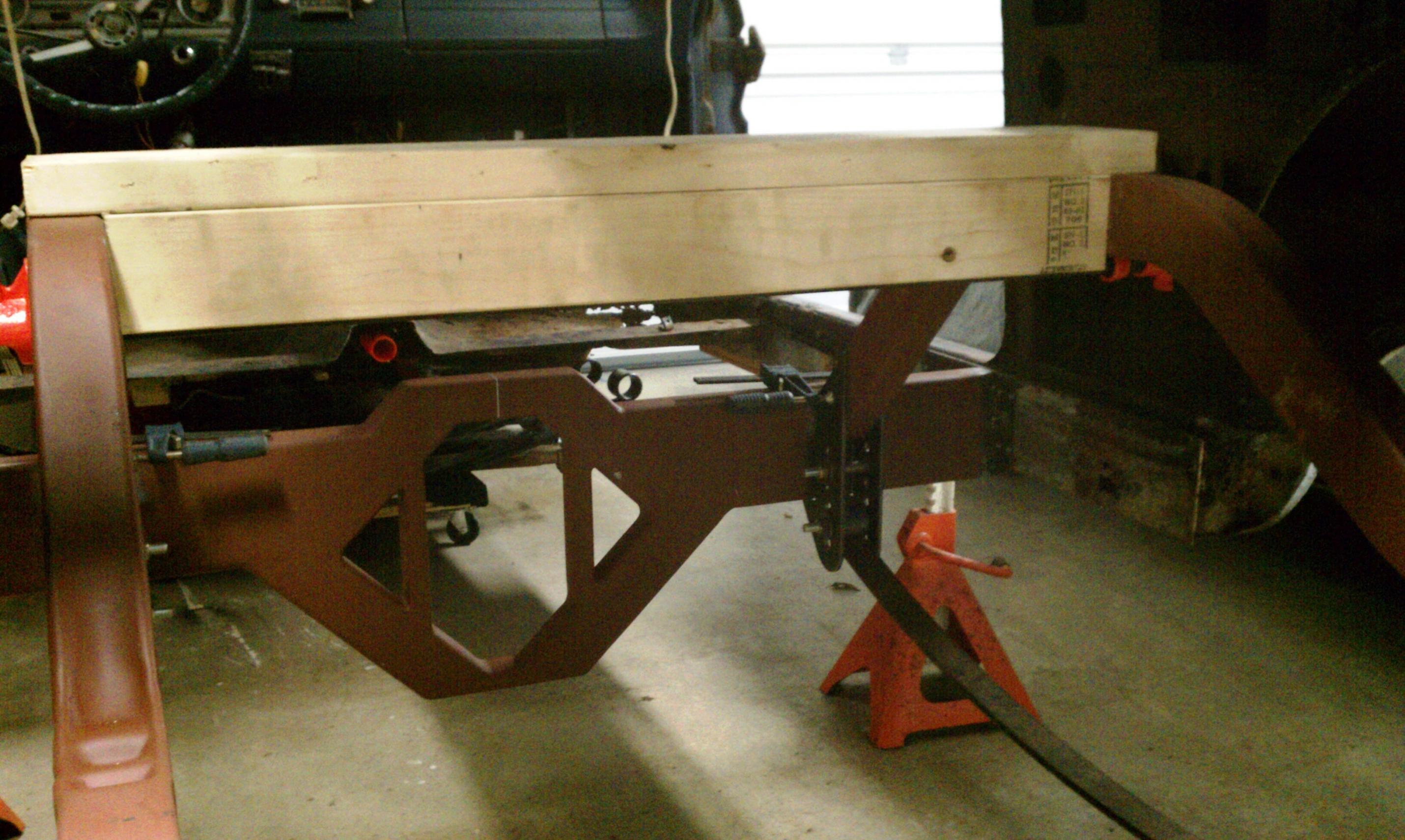

    Question
    The center tube that has the spring pad looks to narrow for the U bolts to land on.

    296 V8
    I only used a 2" wide leaf spring so it would fit inside brackets welded to the sides of my 2" frame rails. Therefore I only had to make the saddles 3.25" wide for the U-bolts to fit. I found 4x4 3.5" U-bolts that were 9/16" dia. If your springs are wider (2.25" - 3.00") just add 1.25" - 1.50" for the U-bolts to the spring width. You are more than welcome to use the idea. It wasn't mine. I picked it up back in the late 60's running Super Stockers.

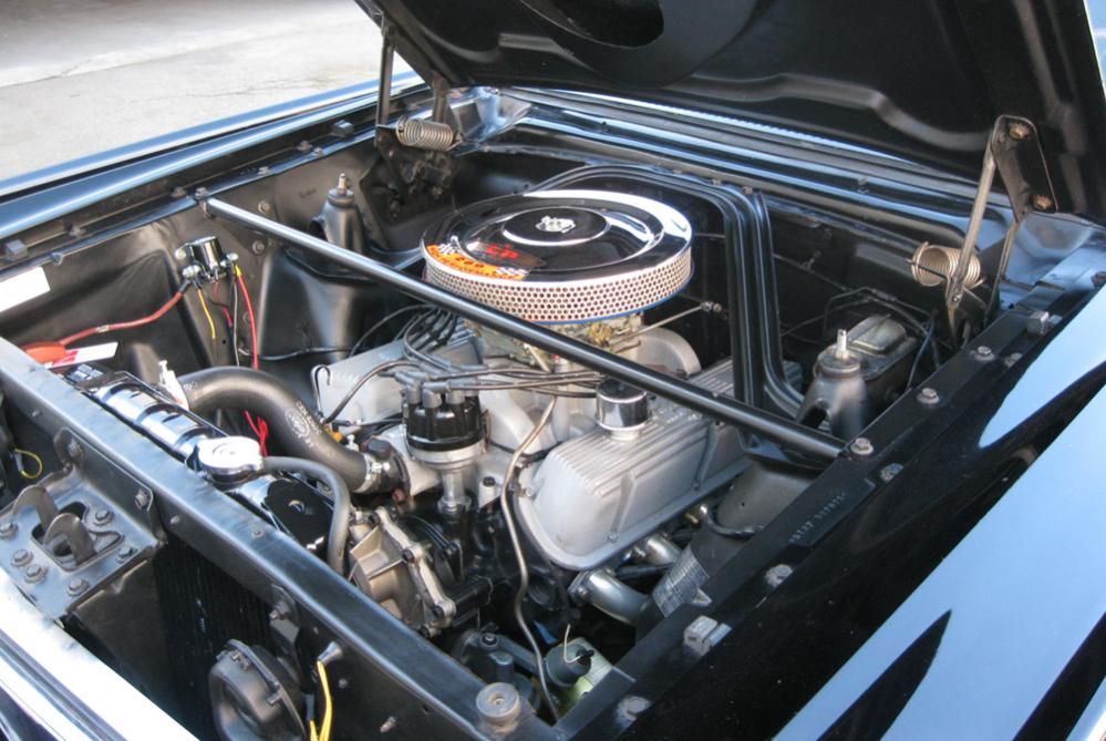

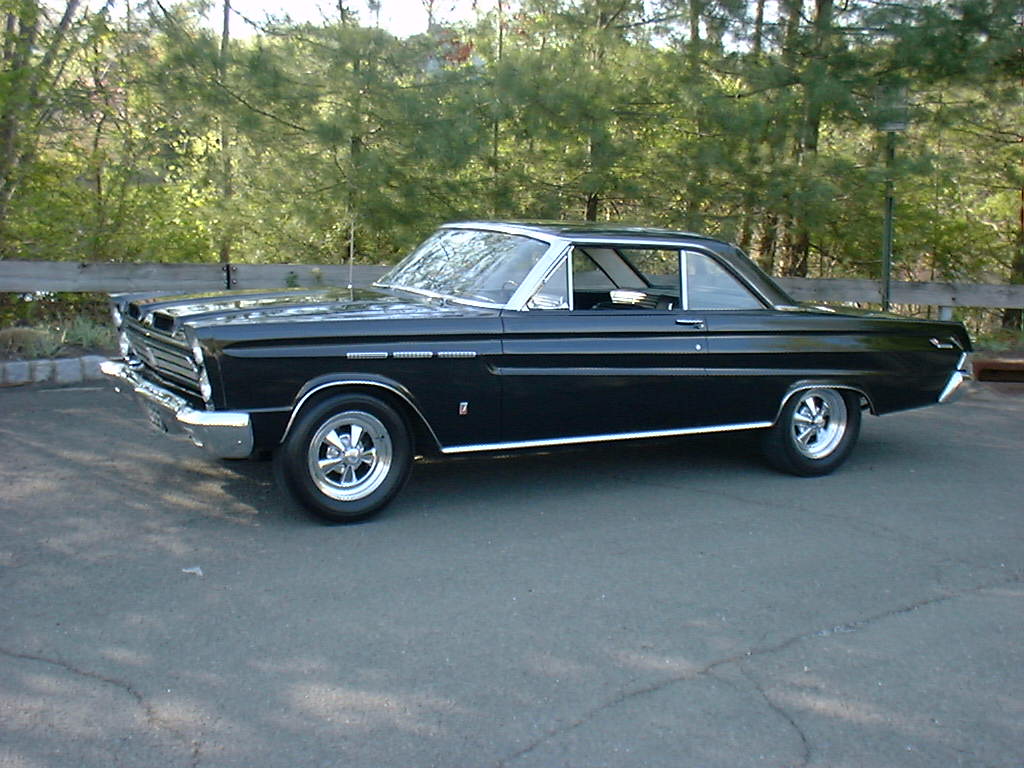

    Here are some pictures of my Hipo Cyclone.....

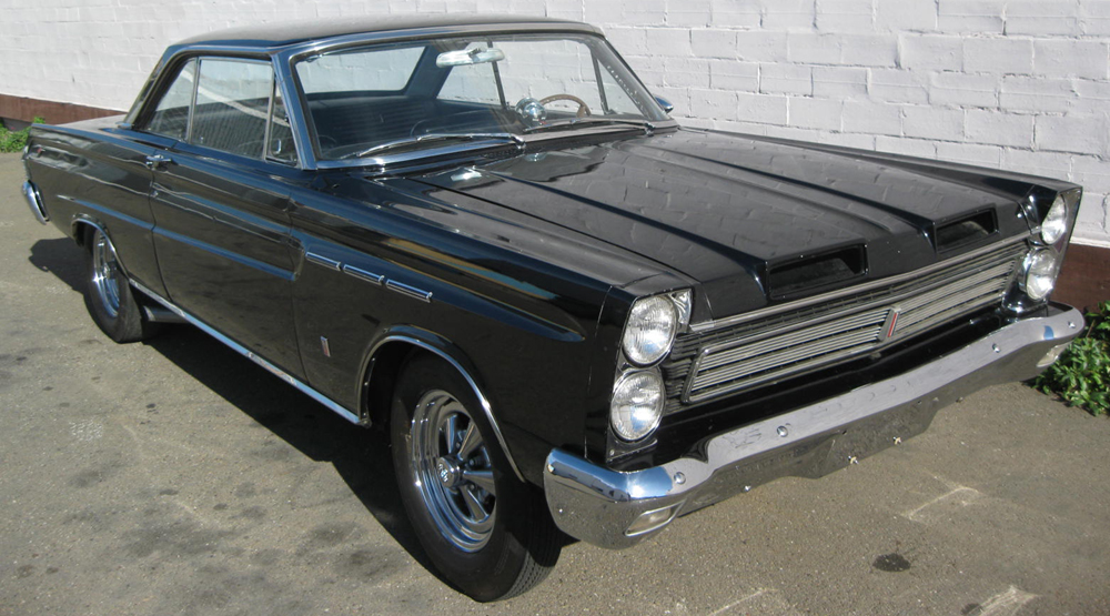

    Some more pictures......The guy I got it back from installed the side exhaust....I just ran a set of small header mufflers....in 1994 I installed that master cylinder while I was having the original re-built and never re-installed....I have it on my to-do list...

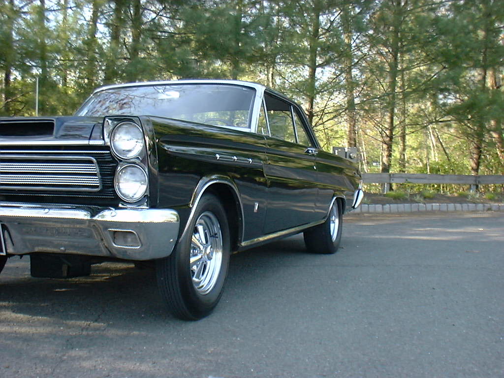

    Here is a wheel combo that I ran for a while.....and I also ran a 8000 RPM rally pac in it for a while in place of the original 8000 rpm Rotunda Tac.....

    Dale
    Looks like that should work fine. Sort of a modified "Cal-Trac" style set up. I suggest you use multiple mounting holes at the rear as well. The more distance below the axle the more leverage from the traction bar.

    Thats one choice comet .... mine will be black one day

    How much movement to these have? Im putting these on mine and just wondering if im doing this right. Should there be any movement?

    Mark your car looks awesome with those wheel and tire combo. Ryan

    65 comet
    The "old school' style floater like I made only allows the axle housing to rotate so the spring doesn't wind up. I believe the more modern Comp Eng set up, like 64 a/fx used, is also a slider which allows the housing to move front to rear.

    almost correct, the floating housing allows the spring to move rearward in bump but the housing stays in the same place held by the ladder bars. it will travel up and down, but no rearward as the spring increases in length for a bump.
    so far working great and no problems. I did add a piece of teflon to make it just a little smoother.
