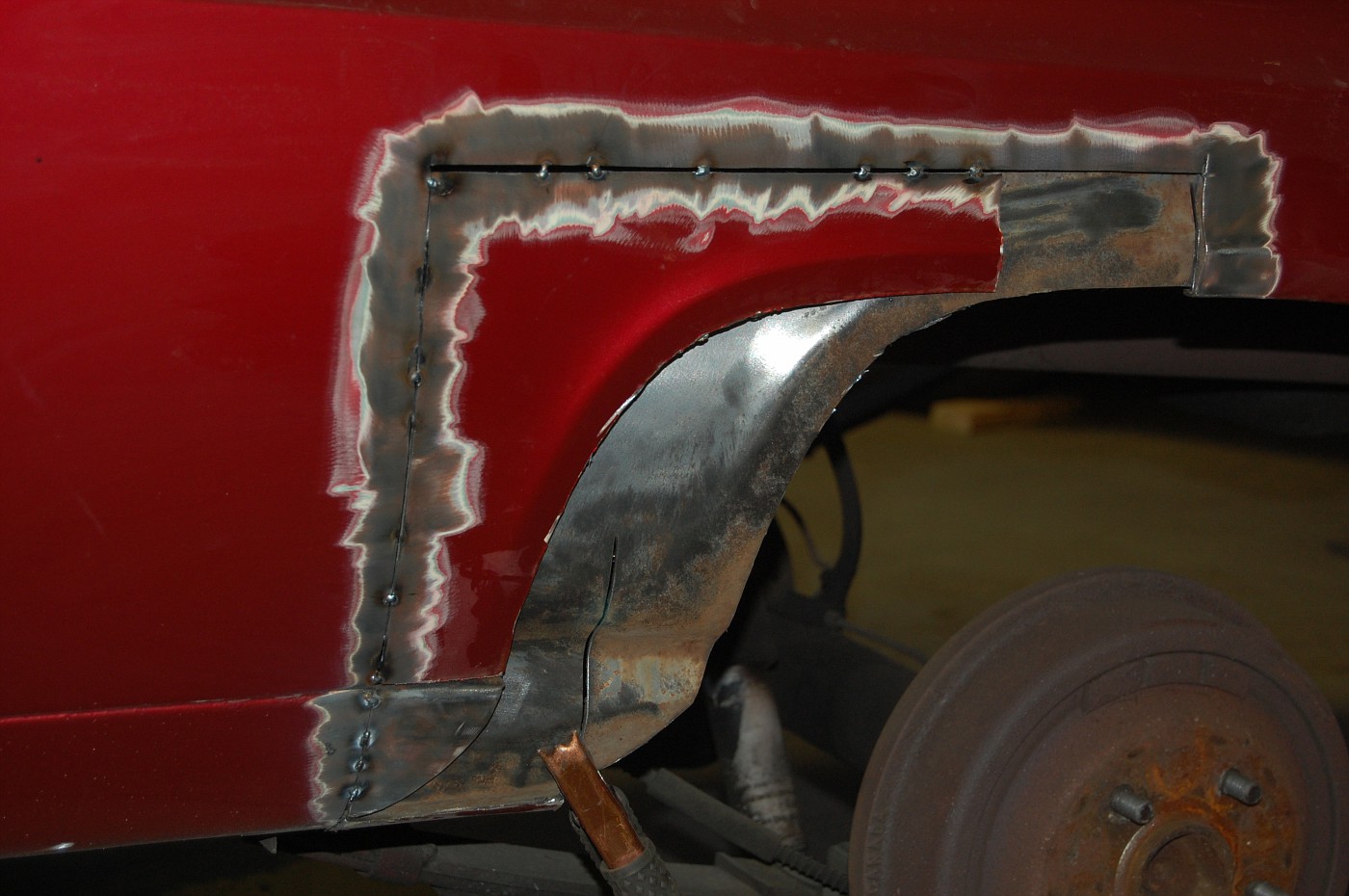

    This is how it should sit when its all said and done::
    I tried a little trick. I did not move the wheelhouses forward with this build, as I found an abundance of unused space in the forward portion of the wheelhouse, behind the quarter, to the tune of about six inches!! So, I just re-positioned the axle centerline about four and half inches forward, and with the use of the shorter front style Chrysler springs, when you look underneath, it matches up to the original Ford perches. Deceptive, but most will be able to easily tell its been altered.
