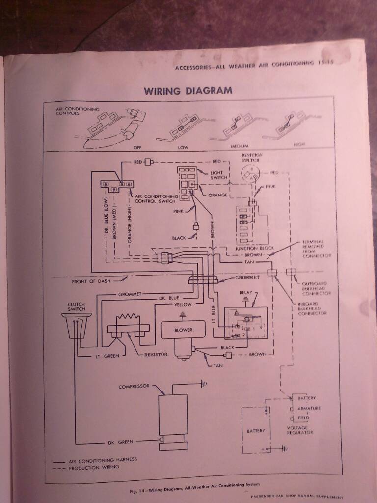

    Ordered the wiring diagram off eBay the a/c diagram doesn't match. Chiltons didn't have it either does anyone have an idea where to look google is a run around

    Don't know if this will help you it's for a 60 Chev all - weather air conditioning system.....[​IMG]
