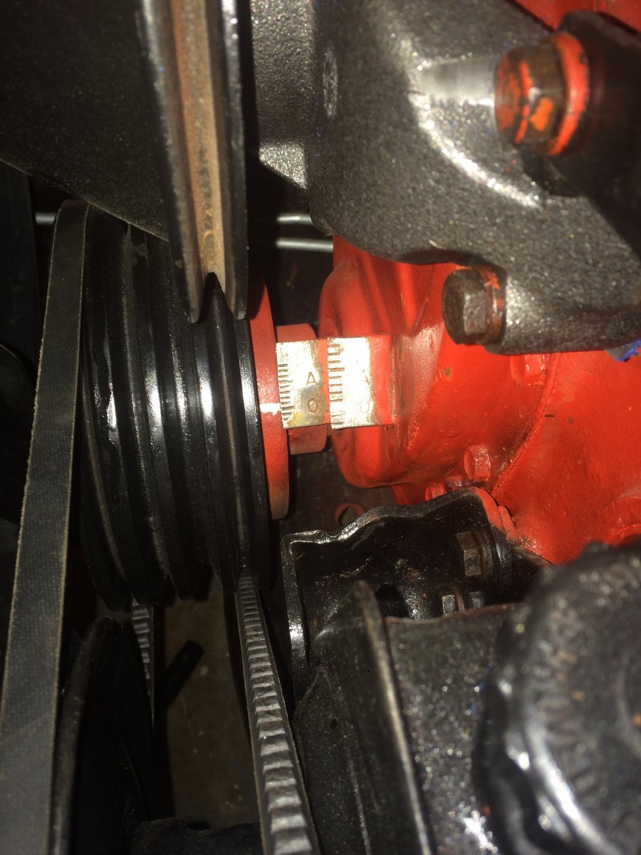

    Got a question regarding setting my timing on my 283, maybe someone can help me out. I have always set my timing by pushing a piece of rag/towel into the number 1 plug hole and turned the engine over until it popped out. Then I would make sure that the balancer is at 0 and the number 1 piston is up as close as cane be to TDC and then I would stab the distributor with the rotor pointing to number 1.
    Someone has told me to set it to 6 - 8 BTDC to set my timing (statically)? Then stab distributor to number 1. They also said not to try to turn on the engine, just to turn the key to the on position connect a self powered timiming light and rotate the distributor until the timing light lights up, then turn key off and tighten down there and I should be right on the money?
    Which brings me to if this is correct and my timing tab does not have any numbers on it just A and O. For those of you that don't know its an early (64) block with the dampner, not the usual balancer with degree marks just a groove notched into it. How in the hell will I be able to determine if it's 6 or 8 degrees BTDC? I've also read that not all aftermarket timing tabs are interchangable and I would need to be careful which one I select to bolt on to my timing cover if I want the number degrees. I think one tab is correct at 12 and the other at roughly 2 to determine TDC.
    What I am wondering if I do this won't the rotor not be pointing at number 1 anymore? It will be p***ed it right?

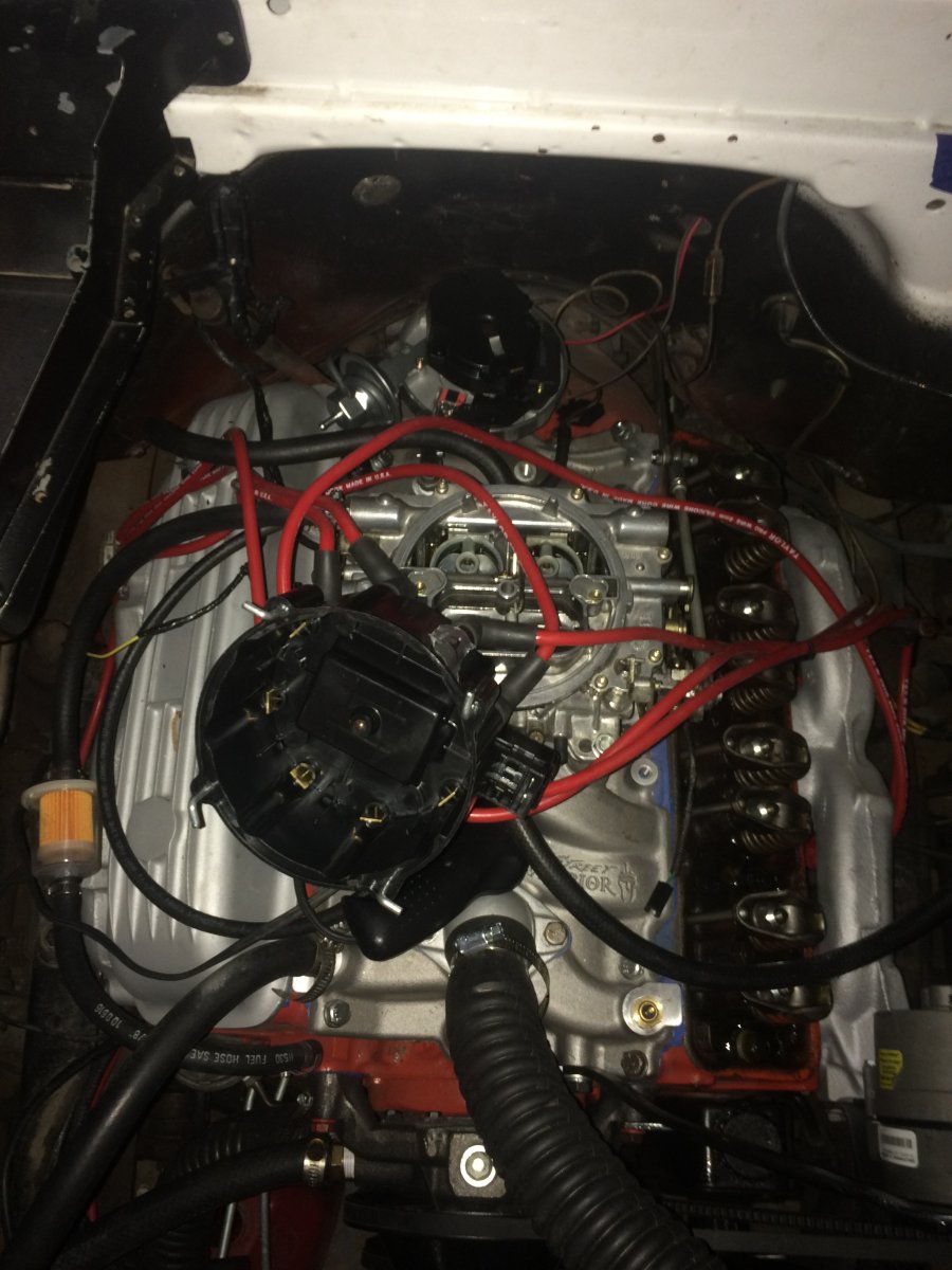

    Spark plug tester reveals spark so I know my coil is firing. I have an HEI distributor that is connected to the fuse block at the Ignition Unused connection so it should be receiving 12 volts. Engine is just turning over and won't fire up even with advancing or de-advancing the distributor. Didn't have near as much trouble as this with my SBC 350 in my 74 Nova when it jumped time and I had to intsall a new timing chain....

    Did a little work today on my truck before actually going to my real job. Anyway pulled the driver's side valve cover, bumped the engine until the intake valve was closed and trun the last few degrees by hand to get it at TDC. Got lucky and managed to drop the distributor/rotor pointing to number 1. I was off 180° - So it's all ****oned back up and ready to fire. In the middle of 10 days on with no days off until this Friday so I probably wont be able to fire it up until Sunday. Hope she fires up, then its off to get the exhaust done.
  15. 327Eric
    Joined: May 9, 2008
    Posts: 2,203
    327Eric
    Did you add the HEI, or was it in when you got the truck? Where do you source your power? Do you have 12 volts in the run position? What about the crank position. If you are not running the byp*** wire from the starter solenoid I post, you will not get power while cranking. Only in the run position, at the ignition switch. Unless the wiring has been modified

    When I bought the truck, it was the front clip was basically off, motor was drppoed in and not mounted down. It came with a about 4 - 5 boxes of parts and in one of them was an old HEI distributor. Since the engine did not have one I ***umed it had been converted. I bought a new HEI from Jegs, ran the 10-12 gauge wire to the ign unused junction on the fuse block. Haven't hooked up the ammeter because from what I was told this is a 12 volt source.
    Spark plug tester reveals spark so hopefully my connection is correct. I have read that I could make a connection at the ignition switch.
    I don't know diddley about wiring, if I ran it this way will it damage anything. I did notice one time that once when my son left the key on I seen a little smoke coming from the harness. The key had been on for like 10 minutes before it made that little bit of smoke.
    I did buy and add a new wiring harness that connected at the firewall bulkhead. Here are the connection points.

    The yellow 20y wire is the byp*** wire that provides the 12 volts to the coil, byp***ing the resistor for the stock points ignition while cranking. Its been 15 years or more since my last c10, so i an a bit fuzzy.

    That 20Y yellow wire is not connected my c10, since the diagram indicated it went from the + on the coil to the starter I just left it unconnected. I think someone told me on the C10 site that it could be discarded/not connected?
    The positive junction that says BAT on my HEI distributor is where I ran my 10 - 12 gauge wire from to under the dash into the fuse junction block (ign unused). The only other wire is a brown wire which should be ran into the cab to connect to my Tach once I add it.

    All right guys, when it comes to setting my timing on a SBC I don't normally feel overwhelmed but this 283 is killing me. I tried the old long screwdriver and lining up the shaft on the oil pump trick nothing doing. Won't fall in on the mark either before or a little after but not dead on.
    Tried bumping the engine to get it close to TDC and then meshing the cam/dropping in distributor with the rotor pointing to number one. Then making sure it's not fully seated and then bumping the engine until it drops completely in.
    No luck best I could get it to do was run a second or two. But it wouldn't stay on. Just would more or less sputter. Spent hours hunched over on the engine bay and I'm about to take a ball peen hammer to it! Any help would be greatly appreciated!

    Mark you have to hold your mouth right.
    I takes two or a remote starter. Trying to do this manually ...getting it all to line up is like trying to push a chain.
    Do this
    Put the distributor in postion with the pointer where you want it. Hold it there. Have an ***istant crank/turn over/bump the starter while you are holding it in position. It should line up and fall into place. It will not fall in by itself you have to hold it with a little downward pressure. It takes a feel and maybe a few tries.

    Try to anticipate the gear and key slack. Think about that rotation and how much you'll have to hold the pointer off so it will mesh drop down in the right spot when the engine is turned.
    I don"t like to do this but any of the 8 in the clock can be made to be #1. Just move the wires.....It will drive the next mechanic nuts.

    If you still need to see a stock balancer and pulley system for a 65' C10, 283 ci. if it will help you at all.
    I have one in the shop right now, out of the truck and on a cart that I can take pictures of for you, tomorrow.
    Let me know. X

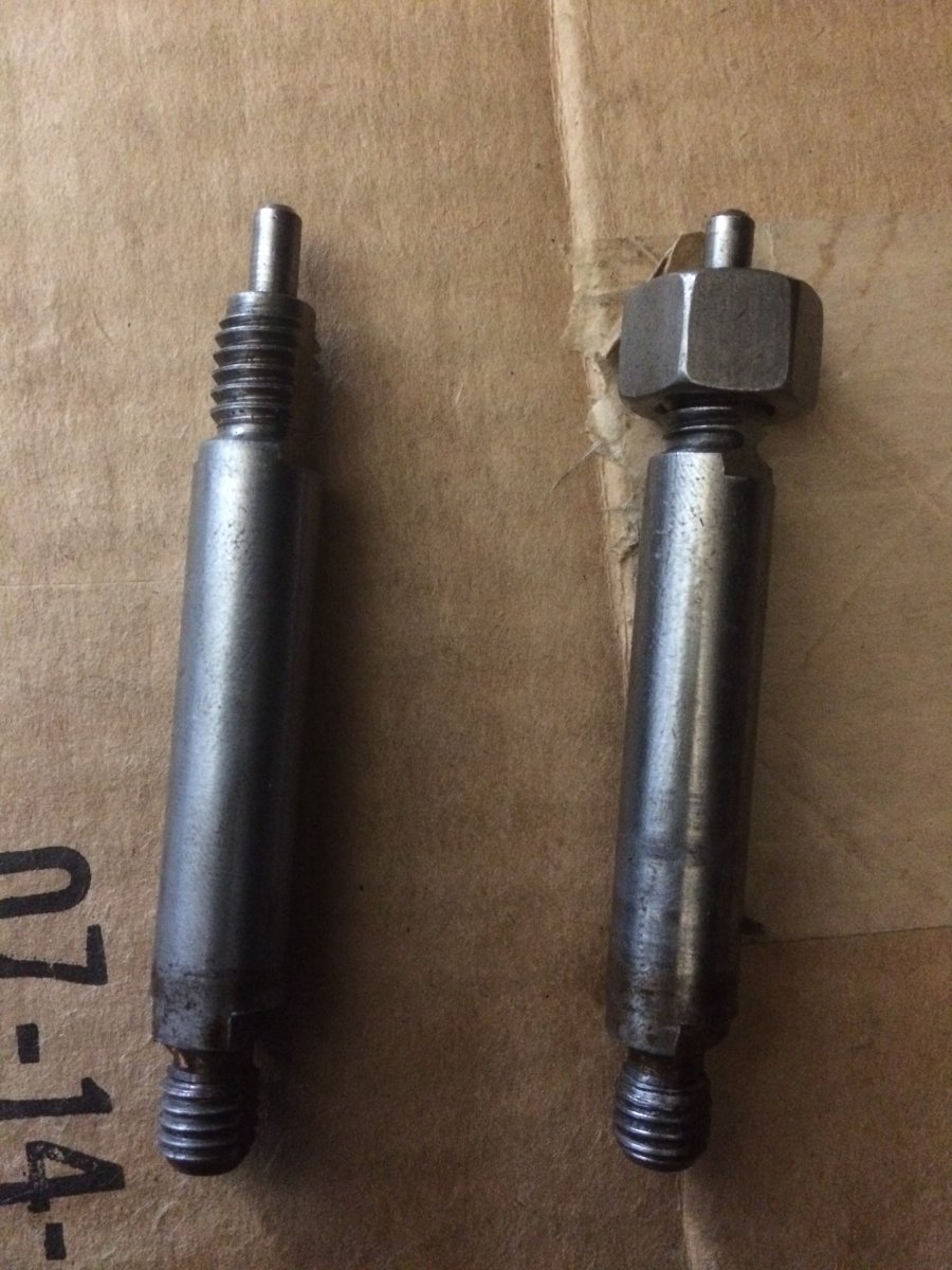

    Got a quick question regarding rocker arm adjustment, probably gonna bore you guys with this but I finally got my 283 running this past Friday. Been a lot of work, mostly by myself but I got it. Anyway I could hear some clattering going on so I pulled both valve covers. I did not ***emble the heads on this build. I was told the engine had been rebuilt and was ready to go. Needless to say I have learned the hard way that wasn't exactly true. About 4 of the rocker arms were really loose.
    So getting back to the rocker arm adjustment, from what I have found on the net has been a little contradicting and confusing for a hydraulic lift cam. From the sound of the engine when it's running, it did not appear to have a radical cam. Maybe a size above stock. There isn't any exhaust on it right now so it is a little loud when running.
    First to be sure how can I do ensure that I have hydraulic lift and not a solid lift. Is there any way to tell without removing anything like the intake manifold to look at the lifters?
    Secondly lets say for arguments sake it is a hydraulic lift, I have heard with the engine warm and off to tighten the rocker arms until they won't spin freely and then back off a 1/2 turn? Other info I have found is to tighten an additional 1/4 or 1/2 turn after they won't spin?
    Another option I have heard is to run the engine and back off the tightening nut until I hear the clatter and then re-tighten the rocker arm nut until the sound goes away. I really don't care which way it is done, I would just like it to be as close as possible/right to avoid any serious issues. As with everything on this build I feel it would be better for me to go through it just to be sure, I have ran into too many issues taking the PO word.
    -Mark
