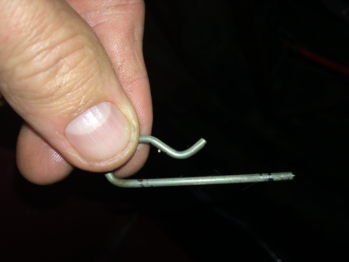

    Got the torque converter bolted up and finally hit an accurate reading on the trans fluid level. Had it idiling and found that the two trans lines weren't smug at the radiator so I tightened them up and they stopped leaking. The third and final leak was coming from the kickdown cable, tried tightening the bolt still leaked.
    So I decided to unloosing and see if there was an o ring or something missing? Turns out the end of it is broke off in the case. Frighing sucks!! It seems a little too long anyway. From the mounting hole for the bolt to pass through on the actual cable to end is 45 inches. That is not extended either. The actual black plastic cable between both mounting parts is only 30 1/2 inches.
    So for one going to see if I can dig out the broken shaft piece without dropping the pan. Second anyone know what length should it be. Is there only 2 sizes for our trucks short & long?
    And lastly can I get from auto parts? Or should I go to a trans shop or order online?

    I dropped the pan and ended up disconnecting this lever and from there tapped it up and out. Forgot how much the crossmember bolts, in particular the last two are a PITA to slide in. Just gonna drill out the holes a little to get that extra 1/8 th of clearance.
    I will let you guys know if a kickdown and if the transmission engages after that. Hope to take it for a small spin around the block if it does.

    Got my kickdown installed and no leaks. Jacked up the rear and went through all the gears, transmission engaged. Managed to back it out of the driveway and drive it up and down the block by putting it in drive and reversing it.
