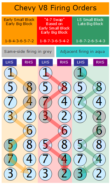

  1. Check the plug wires you might have some in the wrong position. Make certain the dist cap isn't cracked. Having to jack around moving the dist retarded to start and moving it advanced after starting sounds like the vacuum and mechanical advances aren't working. Could also be a loose timing chain.
  2. MUNCIE
    Joined: Jan 24, 2006
    Posts: 2,423
    MUNCIE
    from Houston
    Thanks, new cap but I will make sure no hairline cracks. I need to go through the plug wires again, have you ever heard of swapping the 7 and 4 wire in the firing order? Im pretty sure I'm running the 1 8 4 3 6 5 7 2 order.
