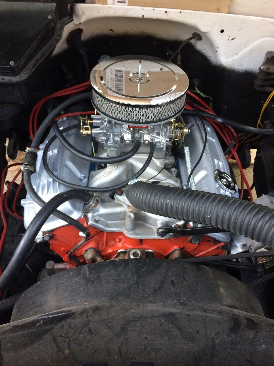

    Well cleaned up some of the grime under the hood. Got the 500 CFM carburetor installed. Pulled my plugs and all of them were covered in black soot, sure sign of the engine running too rich. Gapped my new plugs and set them in. I forgot my heads are from a 307 and had to make another trip to Auto parts store. Oh well needed more brake & carb cleaner.
    I leaned my carb as much as possible according to Edelbrock’s instructions.Also set the floats according to Edelbrock‘s specs, seems to be idling fine. I doubled checked for leaks again before replacing the 600 CFM and found nothing. Something was making the engine idle up, my RPM’s would shoot up to around 1500 when it was in park and neutral. But once in drive it drop back down to around 600 RPM which is were I set it. Not sure what it was on the old carb but it’s not doing it anymore.
    Got a rebuild kit and when I get bored I will try and rebuild the old 600. Need to drive it tomorrow a little and then pull a plug or two and see where I’m at. Think I will go buy me a timing light and try to learn how to read this old style dampener with the A & O. Maybe then I can dial the carb more in. Any suggestions out there for a kick down bracket? Still haven’t installed one yet. Not trying to go the Lokar route.

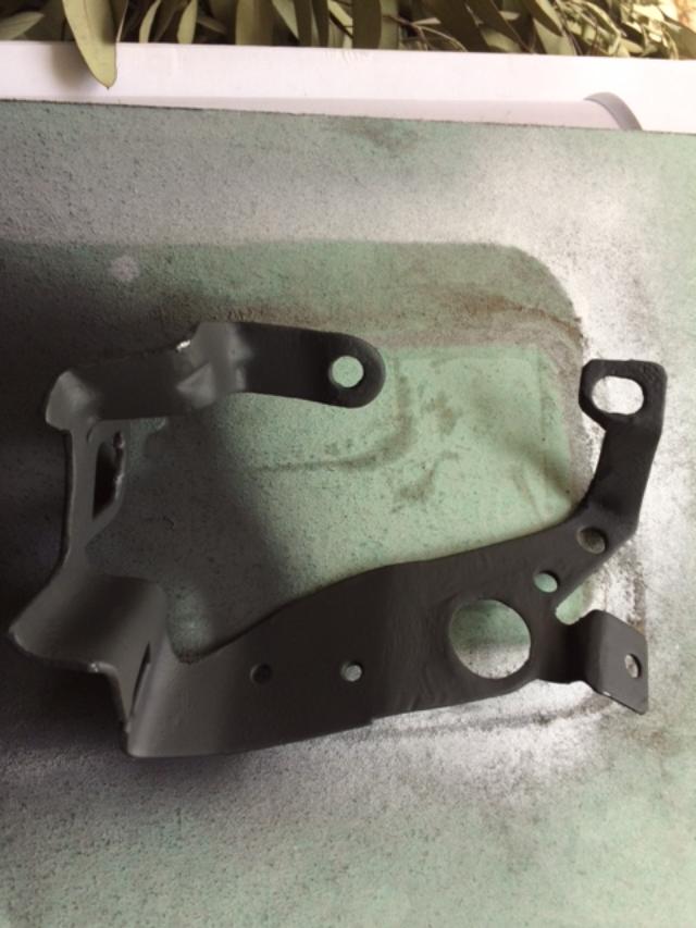

    I dug around and remembered I had sanded and prepped this bracket a while back, so after some cutting and t******* it looks like it will work. Primered and painted once again and got it installed, have no clue as to what it came off of?
    As it stands now the end from the TV cable wouldn't connect/fit over the ball on the carb. I got another one coming from Summit hope it's the correct size and then I can adjust and hook up the kick down cable.

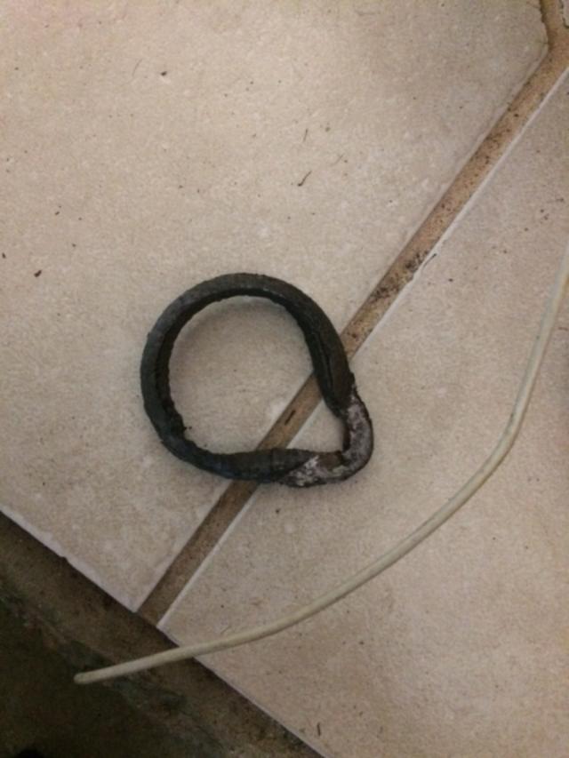

    Well originally there was an exhaust leak just not as big when I replaced the donut seal the first time, took it back to the muffler shop this past Monday. Owner lets me use his lift, I took the exhaust loose and replaced the exhaust donut with a better fitting one. The other donut seal that was on there was a little small, anyway also added some exhaust gasket cement as a precaution and bolted everything back together. With the engine running I no longer can feel any hot exhaust fumes coming from the exhaust port on the manifold like before so I'm ***uming this area is sealed.
    Exhaust manifold bolts are snug so that's not it.Maybe I might have a hair line crack some where on the backside of the manifold but the engine runs strong. No decrease in power and it's the only mode of transportation I got so I've been driving it to and from work that's it. One thing I noticed today on my way to work was I started to smell oil burning.
    Never has happened before and when I turned my truck off in the parking lot I decided to fire it up just to see if I could smell it again, the problem was a cloud of smoke came out from the exhaust. I noticed it after the fact so I'm not sure what side (R or L) of the exhaust it came out of or if it was both sides.I'm ***uming it was from the p***enger side since that is where the noise is coming from? I work nights so I have to drive it home. I will get someone to fire it up on my lunch break and I will stand in the back to see which side the smoke is coming from. Oil is probably leaking down into the cylinder now if it smokes when turning it on and then probably burning off. I hope it's not a ring now, a snowball effect is something I don't need.

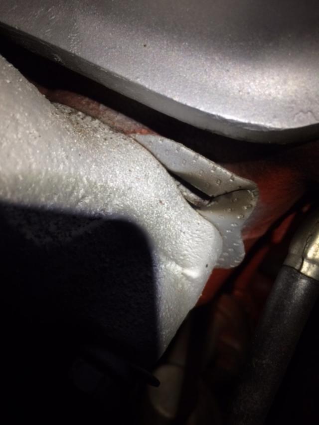

    Looky looky - look what I found. Went out for lunch and just started to closely look at everything thing around the area (No.2 Cylinder) that I thought the sound was coming from and I noticed this exhaust manifold gasket. It appears to be burnt and squished out as well. Not sure how it happened probably a bolt backed out. I tightened them up pretty good.
    When the leak started to get bad after the donut exhaust gasket got blown out of shape I wanted to fix it asap. Changed my used $60 carb to a new one out the box.Adjusted it according to Edelbrock's recommendations, it made for a lot quieter running engine, that's when I began to notice the ticking. Before that it was too loud in the engine bay. I know I got it sealed on the exhaust exit end, so I ran to O'Riley's on my lunch break and picked up another exhaust manifold set. I will install tomorrow before work and hope that resolves the ticking sound.
    Bad thing is when I went out to start my truck I checked to see where the smoke was now coming from, it's on the driver's side so I will need to move onto that next, guessing a bad valve guide or rather hoping for that. Hoping it's not a ring, guess I will start pulling plugs on the left bank and see if any of them are fouled or wet....

    Ticking gone! Replaced the one exhaust manifold gasket, only took about 10 minutes. Geez what a mess it would have been if I started to tear it down looking for a bad lifter. Got lucky on that one, appreciate all the advice guys. Just drove it about 5 miles to be sure.
    Now what puzzles me is that it didn’t smoke on start up today? Got to go to work but I will check each time to see if it does it again.
