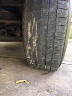

    Just was wondering if anyone knows of a alignment shop that knows how to work on the older style suspensions here in Houston? I'm in the NW part of the city, tires have very bad inner wear and are getting worse. Thanks in advance.
  19. Try the oldest truck shop in town, those guys are usually excellent on pickups. I had worked at a truck alignment shop for a while, saw some interesting stuff come in. I now borrow a rack at a friend's shop when I have to do an alignment for my own cars. Try to avoid getting sucked into a shop with the 4-wheel systems, some won't let the car/truck off the rack unless all the green lights go on. They would be lost on an old car or truck.
    Inner tire wear indicates low camber. Look at the upper control arm bushings and see how many shims you have to play with, take a picture of both upper arms and report back.

  20. MUNCIE
    Joined: Jan 24, 2006
    Posts: 2,423
    MUNCIE
    from Houston
    Yes sir will do. Been raining out here so I will try and get a picture later this evening.Work nights so I will have to wait for my lunch break. I definitely think it probably needs a shim adjustment. Upper/lower ball joints have been replaced. As well as inner & outer tie rods along with the sleeves. Originally I just wanted to get it on the road and drive it for some time and see how it went.

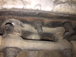

    Sun came out for a little while today so I was able to get some pics. Looks like only 2 shims on each bolt for a total of 4 per shaft..?

  23. You have to see which way the arm moves. Do you add of remove shims to get the camber more positive? Just look at it and you'll see what I mean. The problem lies when you have to remove shims are there aren't any. Look at all of your a-arm bushings.

    From what I can tell it’s got ne
    Roger that, definitely looks like a negative camber right now. Need to double check a-arm bushings as well.
    Thanks,
    Mark
  27. If you can find a nice level spot, try to get something you can lay across the wheel (up and down) and see what the angle is, just approximately will give you an indication of how far negative it is. Those cheap protractors HF carries work pretty well. My brother uses his iPhone with a level app. We used that to set my engine in my car.

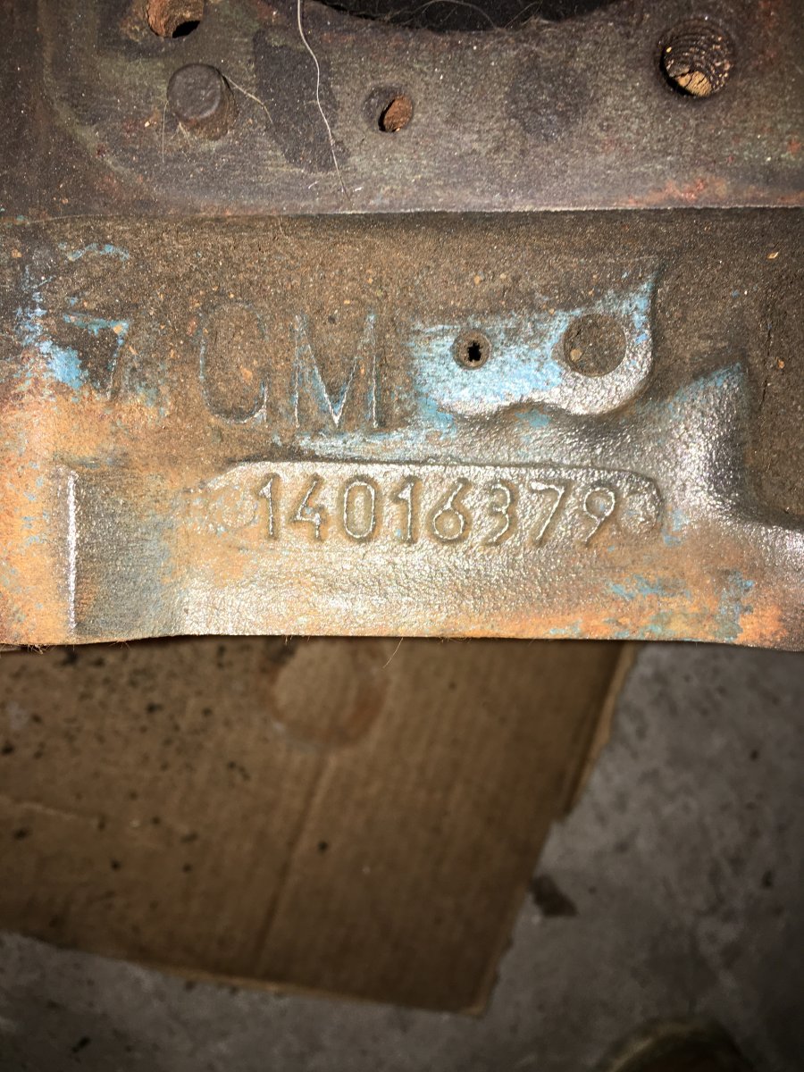

    Picked up this 350 - 4 bolt main today...really would like to get SB 400 but this came up so I got it.
