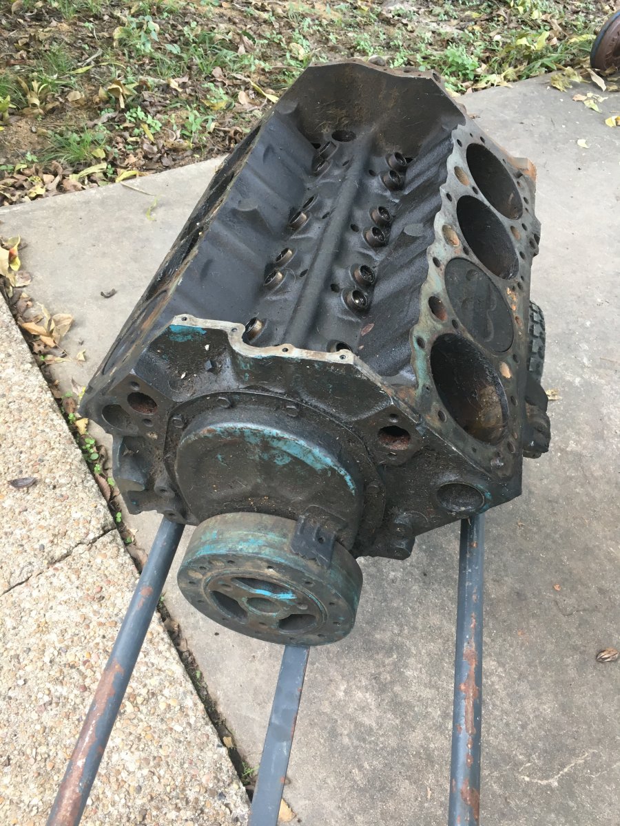

  13. MUNCIE
    Joined: Jan 24, 2006
    Posts: 2,423
    MUNCIE
    from Houston
    A before shot of the block. Cleaned it up afterwards and found that the pistons have a 30 stamped on the top so it looks like it’s a 355.
    Cylinders look pretty good, I’m hoping a dingle berry honing will be all that it needs. Then align & deck along with a good cleaning and mag and hopefully it should be good to go.
  14. KJSR
    Joined: Mar 7, 2008
    Posts: 2,497
    KJSR
    from Utah
    I thought you had to be .060 over to get to a 355. With .030 over you may have a 352.5............

  16. bobss396
    Joined: Aug 27, 2008
    Posts: 18,752
    bobss396
    With a 3.48" stroke .030 over on a 350 gets you a 355.
  17. bobss396
    Posts: 18,752
    bobss396
    You need to have a proper honing done with a good cross-hatch so the new rings will seat. Go with a standard shop rebuild, the align hone/bore (if needed) and a decking are cafeteria menu add-ons. The crank needs to be looked at too, the .010-under on mine ran me $175 alone.

  19. MUNCIE
    Posts: 2,423
    MUNCIE
    from Houston
    If they hone it correctly will it stay the same or will I have to go up to .040 over? Cylinder walls were heavy coated with grease when the engine was stored so they do not have any pitting. Definitely going to have them look at the crank to see if I can use the same one. If not I might purchase the one that Northern Auto recommends to go with the package.
    Truckdoctor Andy likes this.
  20. DDDenny
    Posts: 22,549
    The hone job should only remove a very minimal amount, you're only trying to refresh the cross hatch pattern to seat new piston rings, ***uming that is all that is needed.
    By the way, +.040 gives you 357 cubic inches, I had a 355 in my race car in the 70's and currently have a 357 in my 66 Suburban.
    MUNCIE and Truckdoctor Andy like this.

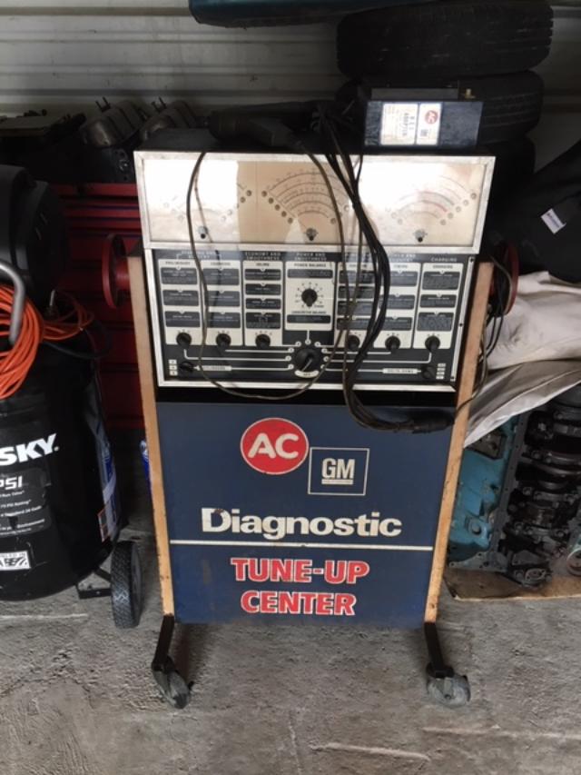

  22. MUNCIE
    Posts: 2,423
    MUNCIE
    from Houston

  23. Woogeroo
    Joined: Dec 29, 2005
    Posts: 1,283
    Woogeroo
    from USA
    start looking for a serial number/model tag... it is probably a piece of metal, riveted on somewhere. Might be stamped into the body in a odd place.
    Then start searching online for manuals. There are a lot of scanned manuals out on the net for older machines...
    MUNCIE likes this.
  24. MUNCIE
    Posts: 2,423
    MUNCIE
    from Houston
    I almost forgot he gave me the manual too. I'm ***uming when connected to an engine it gets it's power....?
  25. bobss396
    Posts: 18,752
    bobss396
    Probably has an AC cord on it somewhere.

  26. Woogeroo
    Posts: 1,283
    Woogeroo
    from USA
    I've never used one myself, just recall seeing them or their variations at garages in the 1980s.
