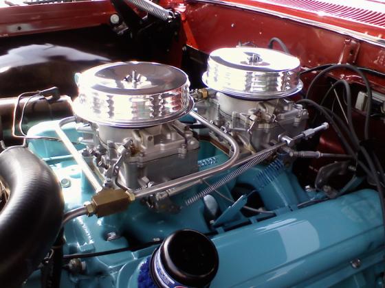

    Hey Trbomax,that was a Cool Catalina,I like the 8 lug wheel, I had a set put away thought about using them on this car,but 3 out of 4 liners were cracked,I been looking for the small louvered air cleaners like the ones on yours,I think there the same as what came on early dual quad vettes but haven't found anyone that repops them yet.

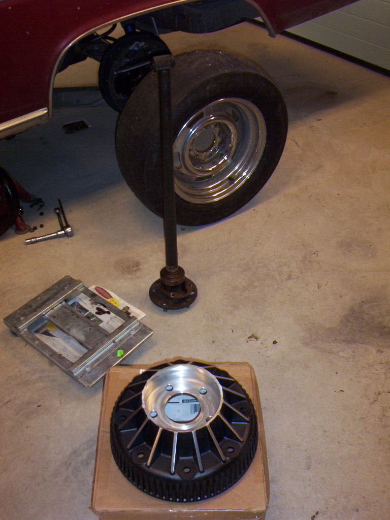

    59-64 was the only time a gm rearend could hold the abuse from a heavy car with traction.and 500hp engine
    this what happend me i think this was result of older abuse when i broke a axle.
    ken

    Ive been wanting a new set too. Ive got a friend with a sd tribute car that wants some,they are impossible to find and no repops. Ive fixed him up with some stuff,but no air cleaners.

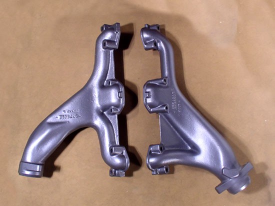

    Hey swe64,I'm going to run a set of repo longbranch manifolds from ram air restoration,they fit real nice and don't have to deal blowing header gaskets.I've got an old Hurst indy matic shifter that I'm planning on running.I have been looking for an his and hers but haven't come across one yet.

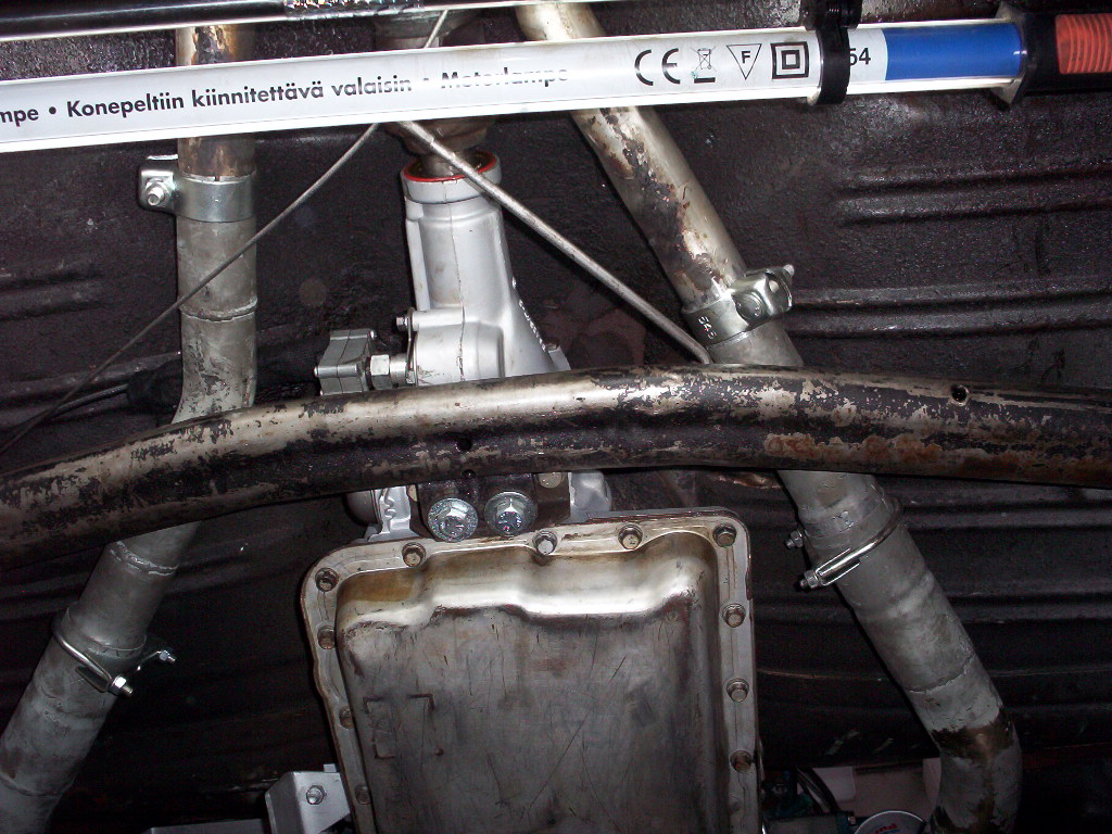

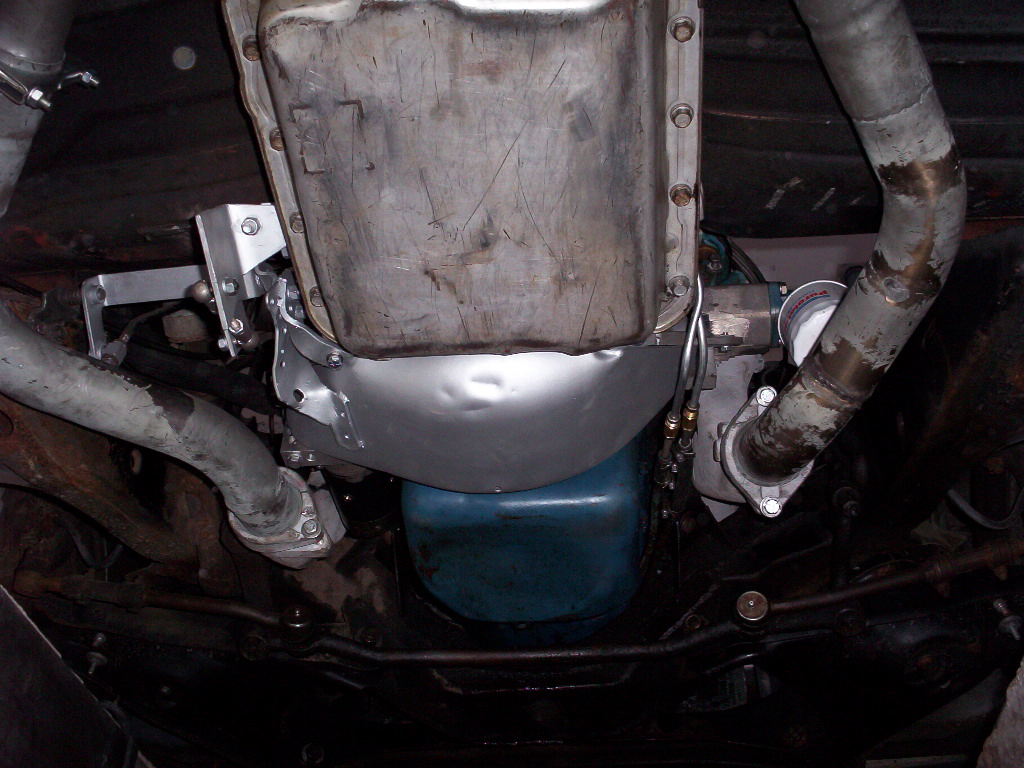

    here is mine 62 cat with th 700 and berdsen adaptor i had to turn solenoid down even with a mini start,had a org starter before so it was tight had to grind off material off one pole.from fatory solenoid was down with long branch heders.

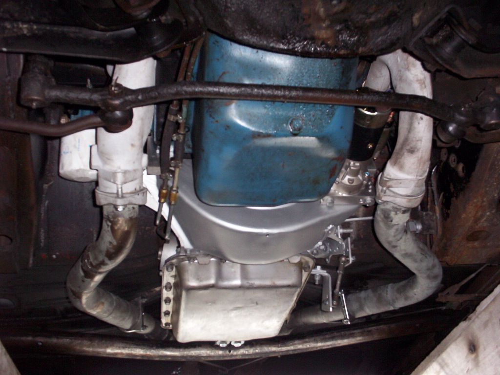

    Hey swe64,did you have any clearance issue with trans and tunnel,my car had a slimjim in it from factory,I've been told that I'll have to modify tunnel to put a 400 turbo in it,going to bolt trans to a block I have and test fit hopefully this weekend.just wondering. jratz

    when i got car i had a 4speed hydramatic 1962.and body was modified for clerence allready and berdsen adaptor moved 700 trans backwards so this made it easy i only took a pice of wood and a hammer and made clerence on p*** side of car.i could see some clerence problem on top of tunnel they hade made before.no welding or cutting was made.i will put x-pipe and a better trans mount this winter.

    Hey Jeff K,Guys I've talk to that are running the ram air manifold really like them,one guy claims he ran his motor on a dyno with and with headers and there only like 5hp difference.I had a set of aluminum SD manifolds but figured they were to valuable to run. I guess I have an auto stick also,I called an Indy matic but looks just like yours.My tunnel looks pretty close to yours so I'm hoping I dont have to do much to it.

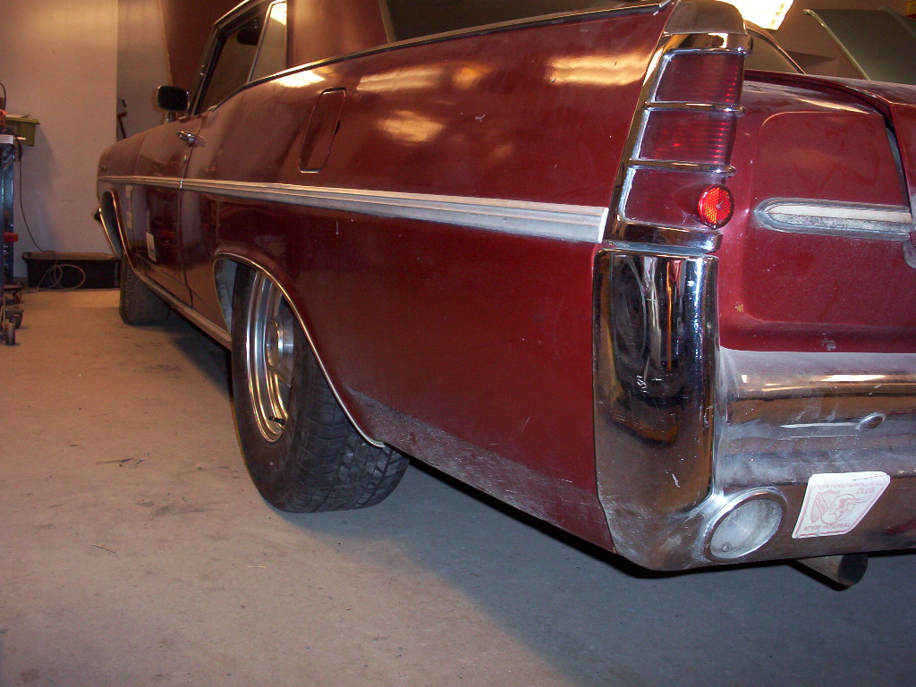

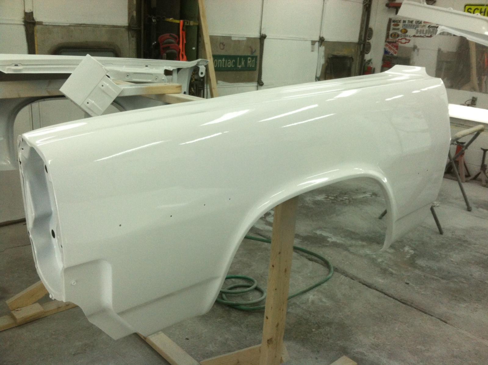

    Hey Guys,It's been a couple of weeks getting closer on the body,I worked out a deal with a buddy to do paint work on Catalina,so far he has the front clip done and in color,also did deck lid.I decided to go with pure white nothing in paint except white and binder,parts look good.I removed the front and rear emblems on the hood and deak lid,wanted a clean cheep look.I'm also leaving body side molding off car,still have over seventy holes to weld up.I'm taking him the body and doors this weekend.should have car in color by Christmas,that away I can start putting it back together,I'm shooting to have it together for the ba*****t of the Detroit Autorama in March,still have alot of work ahead tho.

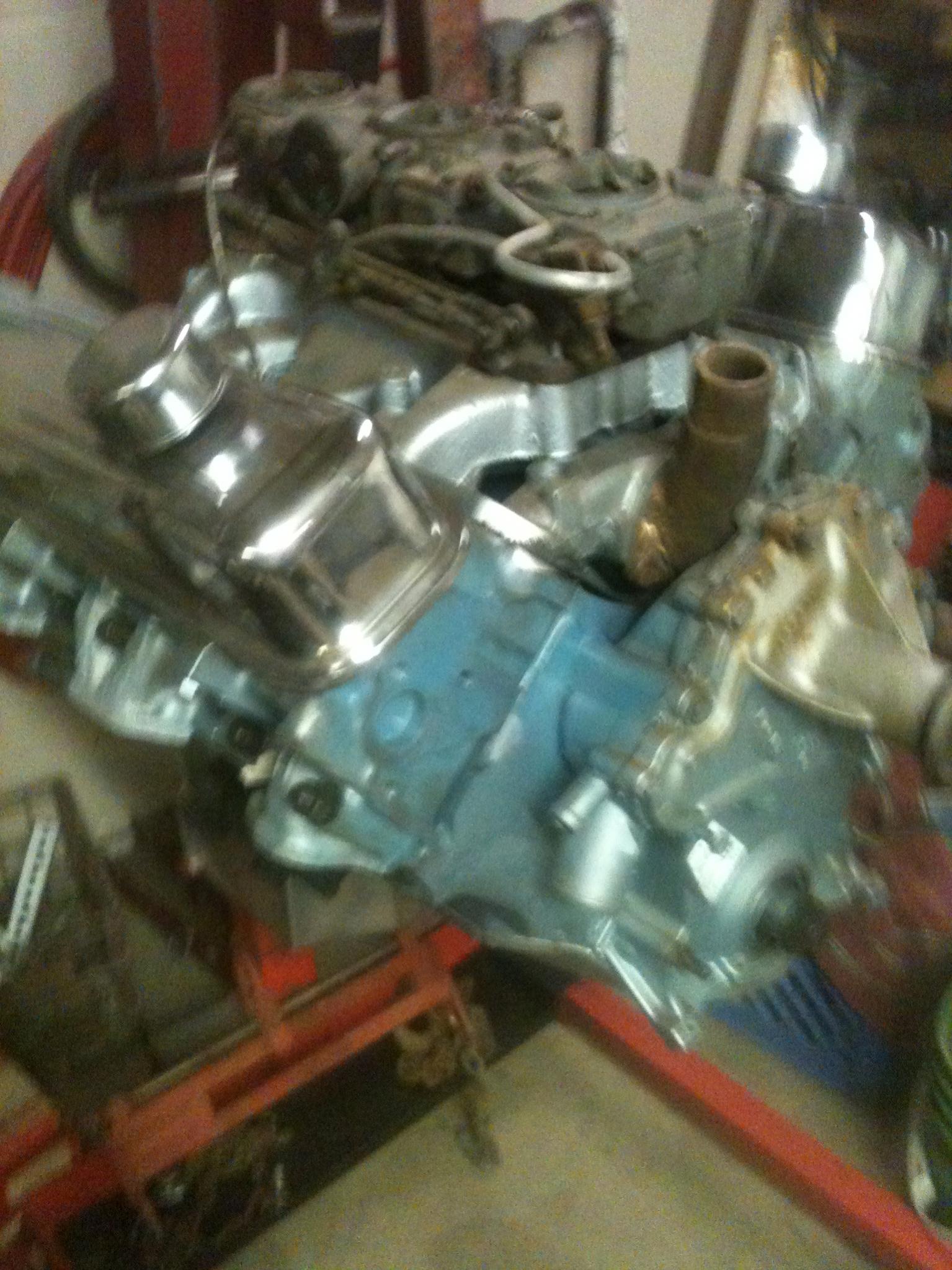

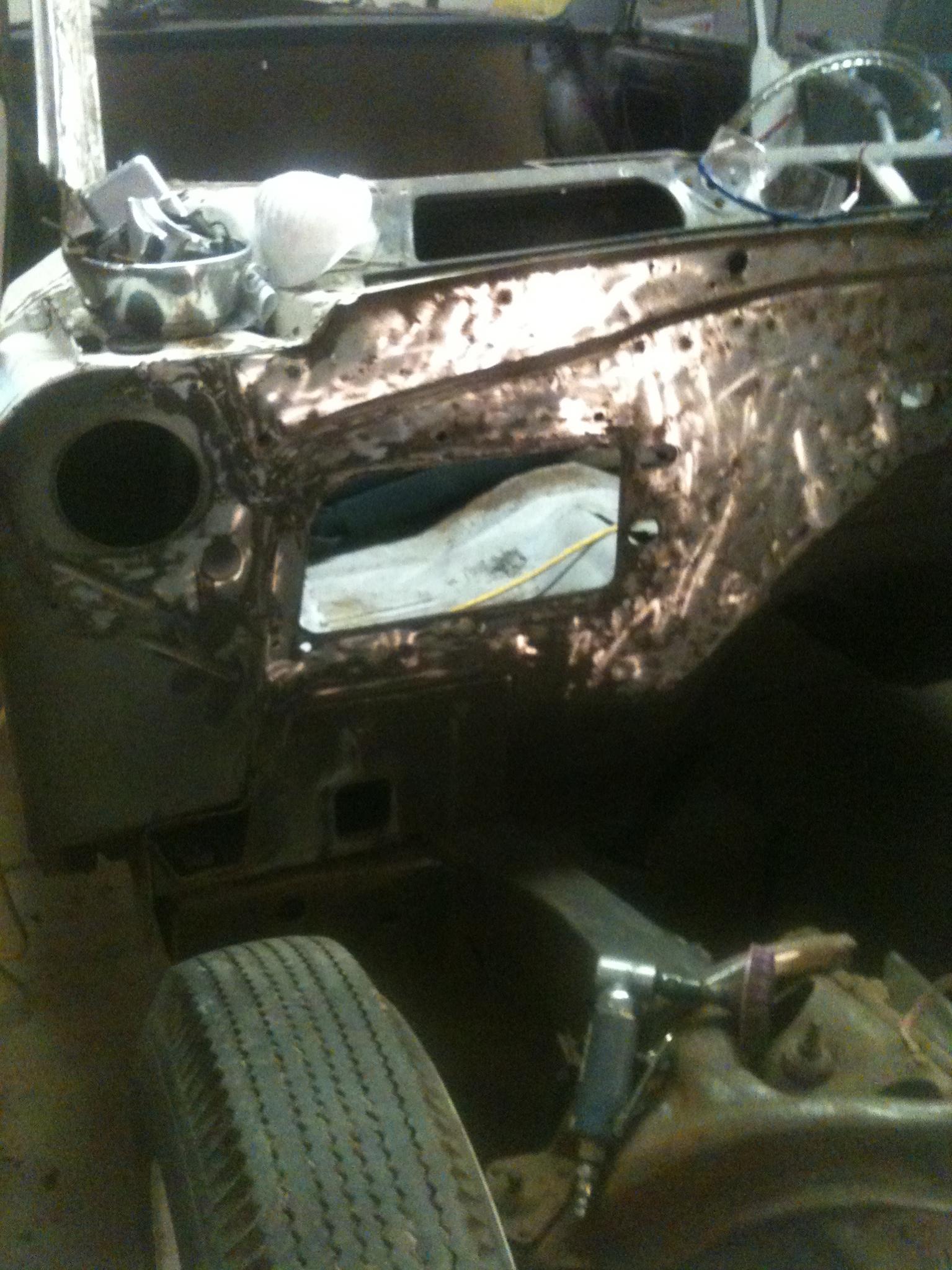

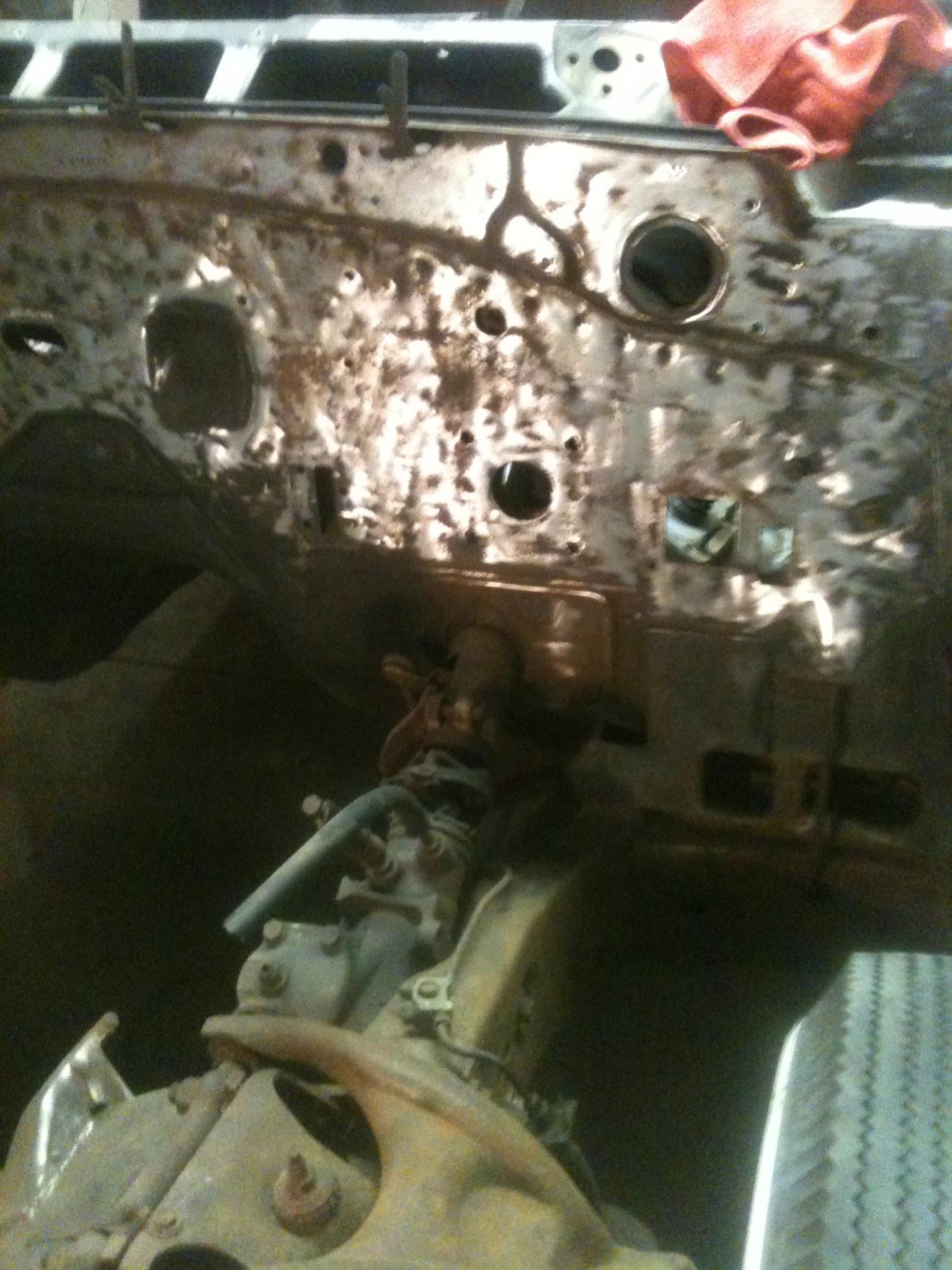

    Also got firewall stripped,waiting on my heater delete plates to show up.I put my motor together and set it and trans in car to make sure my oil pan and trans will fit. still haven't painted motor,still trying to decide on correct 64 blue or later blue metallic . Oil pan was tight going in but plenty of clearance once bolted in mounts.Had to modify tunnel for the trans tho,made a t cut on tunnel and spread it out for clearance,I ordered a 4 speed shiftier perch for it will finish tunnel up once parts come in.

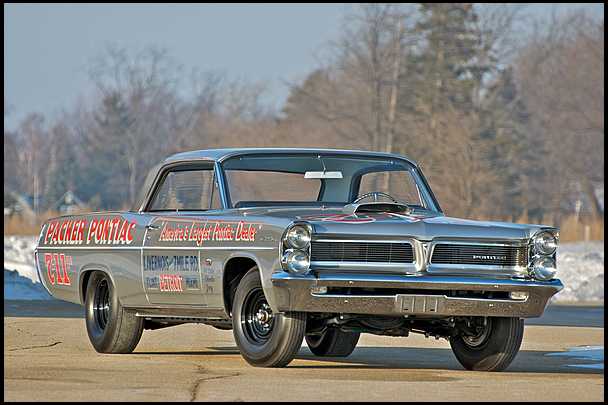

    Here is a pic of packer pontiac that ran at detroit dragway back in the 60's was a 63 though. They looked and ran good.

    Hey 4tford,that's one of the Swiss cheese car,it's a wonder they held up with all the holes they punched in the frame to save weight.

    They had to cut the holes to compete with chevy, ford, and chrysler because they were too heavy. I always liked the 62-64 pontiacs they helded there own at the strip.
