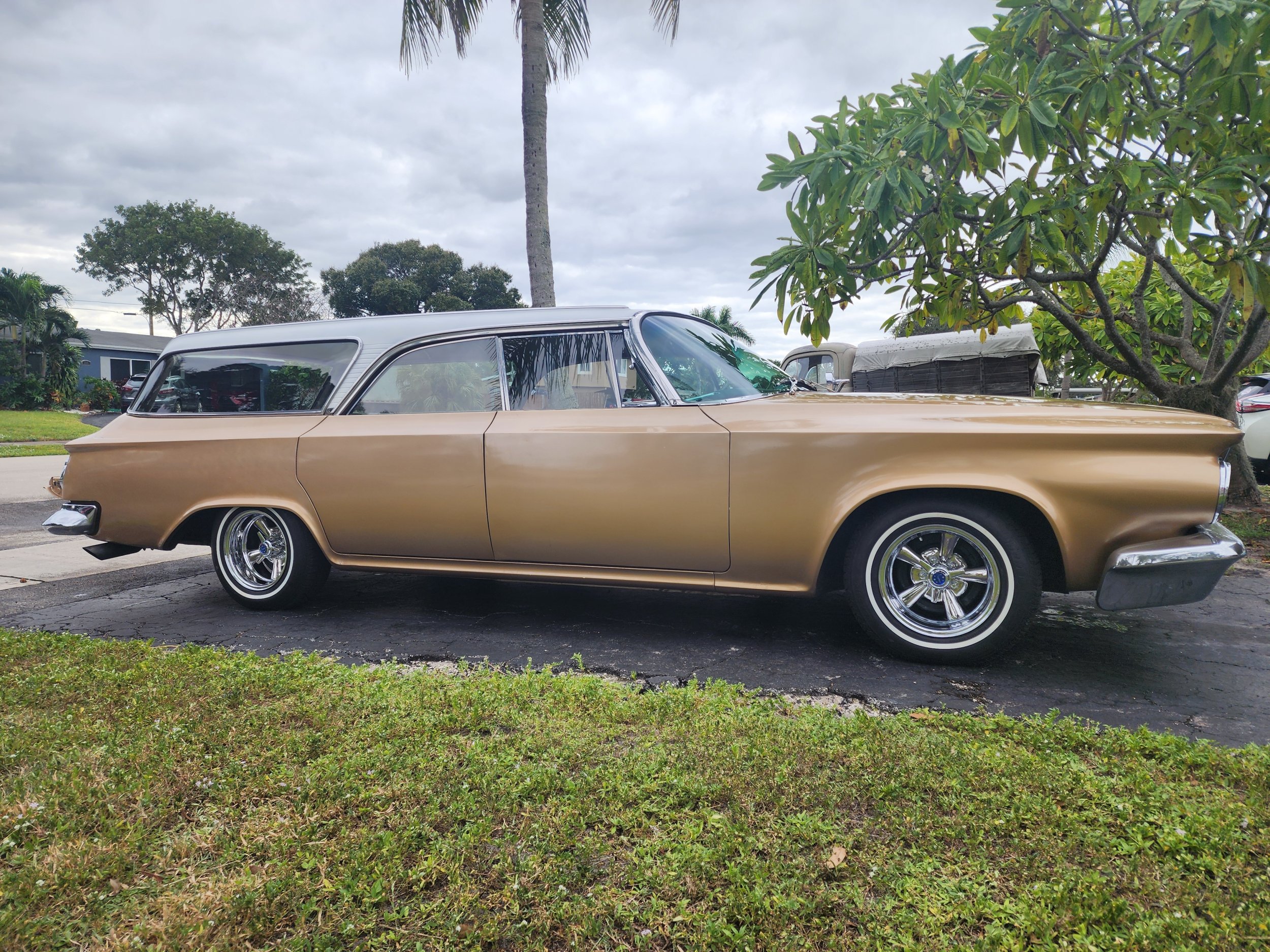

    64 Chrysler Town & Country wagon, 2.76 rear. Weak acceleration and early shifting. I haven't jacked it up yet to see if the kickdown is adjusted correctly, actually I'm thinking there isn't one due to not seeing it hooked up on the carb. This is my first venture into this section of Mopar and I could use some help. The engine runs great and revs well in neutral, just seams to not have ANY get up and go. I realize that the 2.76 aren't helping anything but come on man! We did just remove 275/60/15s and replace them with 195/75/14 all the way around and that seemed to help a bit but I would certainly expect more out of this engine.

    It belongs to my wife, TexasTrader on here.
