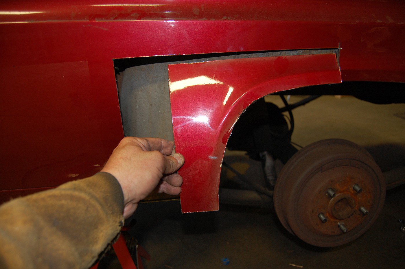

    Started laying out the groundwork for the rear. It's gonna be a sublte alteration, as the rear wheel centerline is already very close to the centerline of the roof pillar, an important visual for me. The Comet already has quite a graceful rear quarter, I'm just going to tweak it slightly. You'll know its been altered, but you are going to have to take a couple looks to figure it out. Thats the plan at least. There is almost six inches of untapped space behind the front edge of the Comet's rear wheel opening. Thats where I aim to push the tires up into!

    After garage fighting with other cars, I parked the Comet at the "Shed" for some work, finally. After cutting into the rear quarter panel for a four inch move, it just did not "eyeball" up, so I did what any other hotrodder would do, I cut more:
    This'll now give me about five inches or so of rear alteration. Not much when you think I cut my old Dart at twelve inches. But remember, the Comet's rear quarter goes on forever. It now lines up real nice to the B pillar. I also ran into a MAJOR setback with the Econoline axle I was going to use. I set it up in my jig, to cut the requisite five and a half inches out of the center section. Its so badly out of square, there is no way to cut,section, re-weld, and have it all line back up. It'll look like a major P.O.S. under the car. This'll now only work on a full -size, like a tri-five, or other big car. Back onto the storage rack it goes. So, I'm going mix and match parts. A Speedway lightweight front tube axle, with the old econoline springs, and homemade arms that should give it the homespun appeal the car needs.
