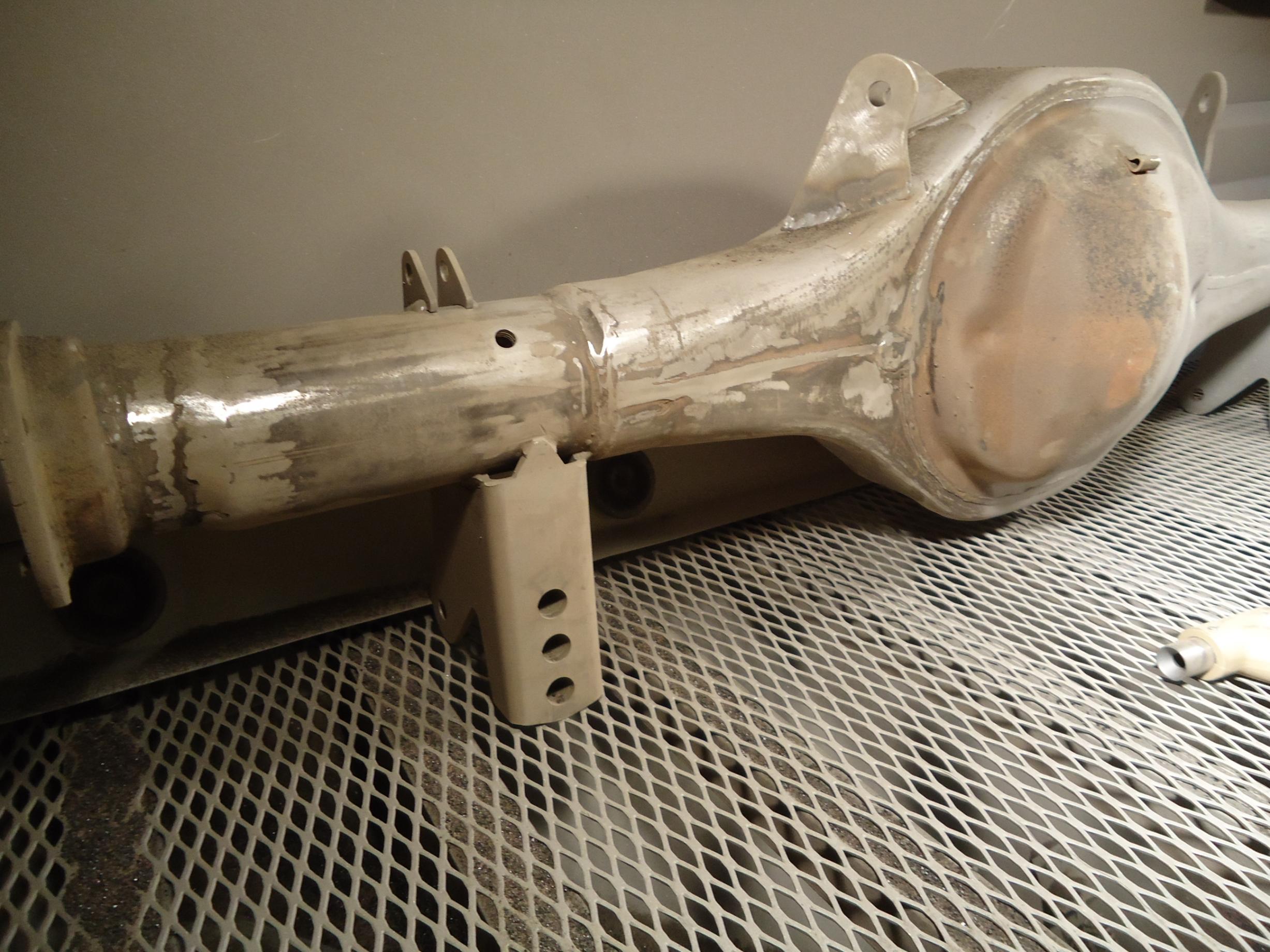

    OK-

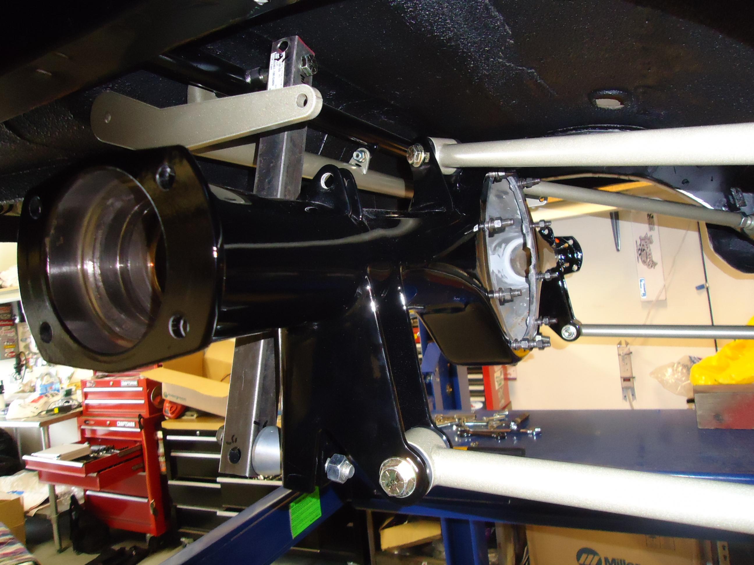

    I couldnt resist the ole' from this to this pic!
    From the rear end rack,
    to chopped up and rewelded,
    and finally "Alainized" to perfection.
    SWEEEET!
    Total Perf-

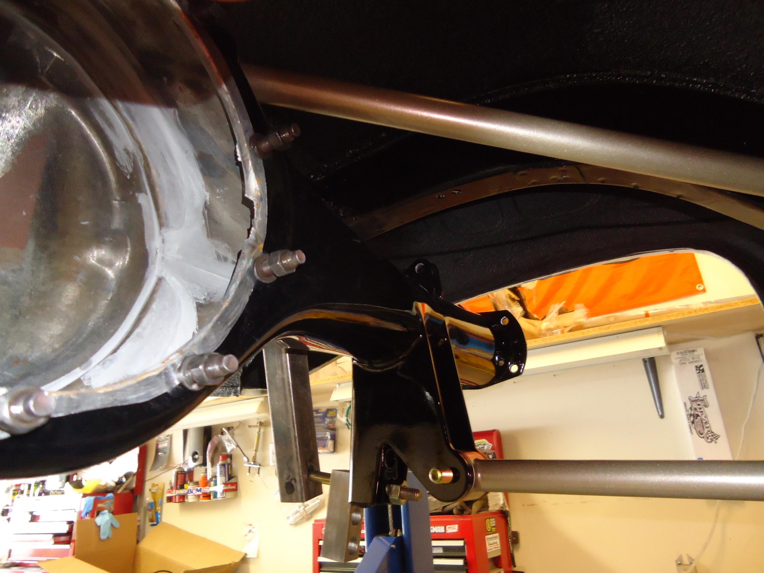

    Hey Roy, you'll love this. Alain is so detail oriented that when we were fitting the Welder Series bars he noticed that the shine on the axle wasn't quite to his standards. So he keyed up the ole' buffer and got after it. Iv'e never seen whats captured in the attached picture. A guy under a car buffing components. Thats awesome and I'm glad iv'e got Alain in my corner! By the way, imagine buffing a rear end---its all corners and round edges. Very hard to do.

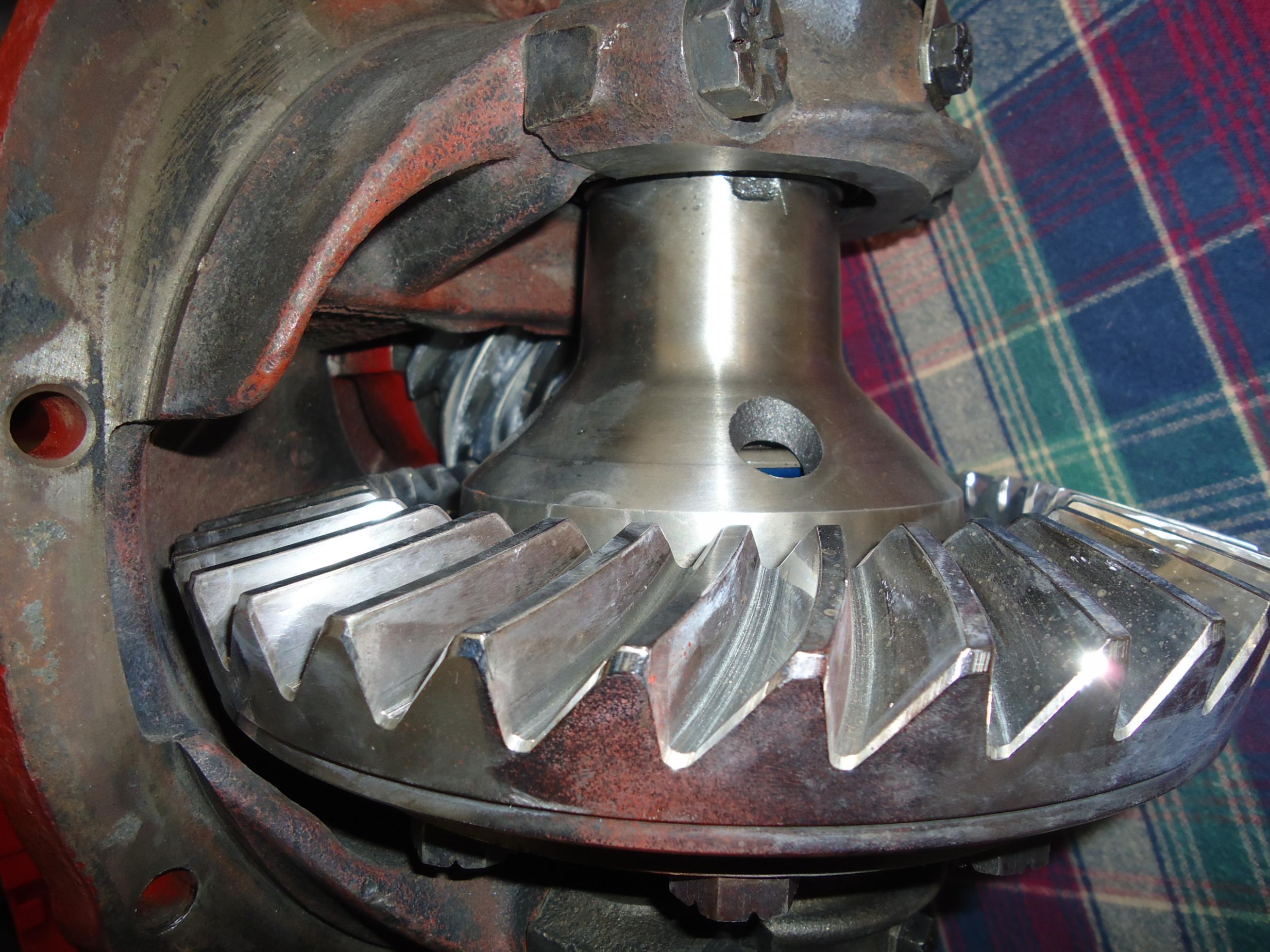

  7. Total Performance
    Joined: Jan 4, 2011
    Posts: 1,496
    Total Performance
    from Nor Cal

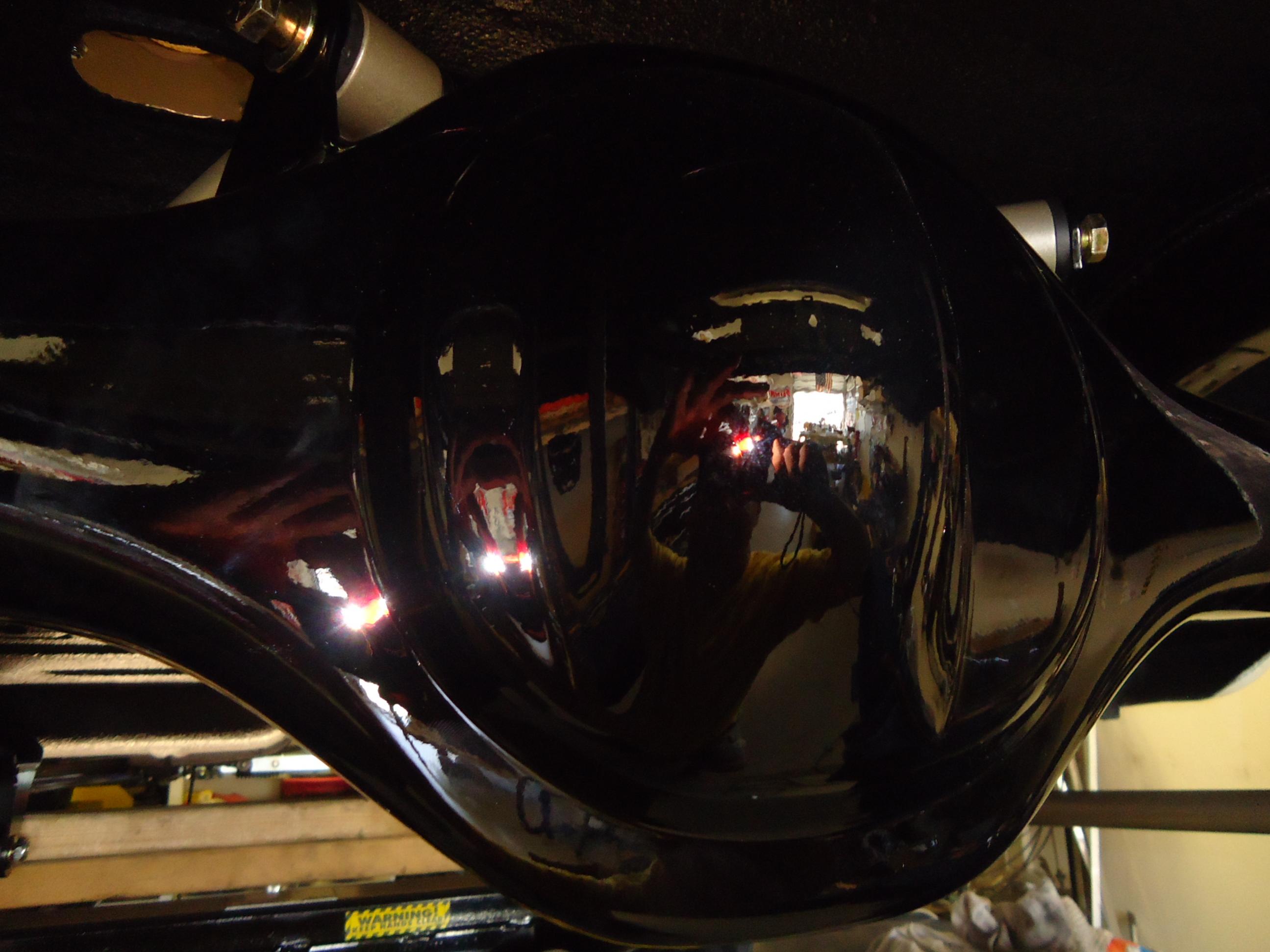

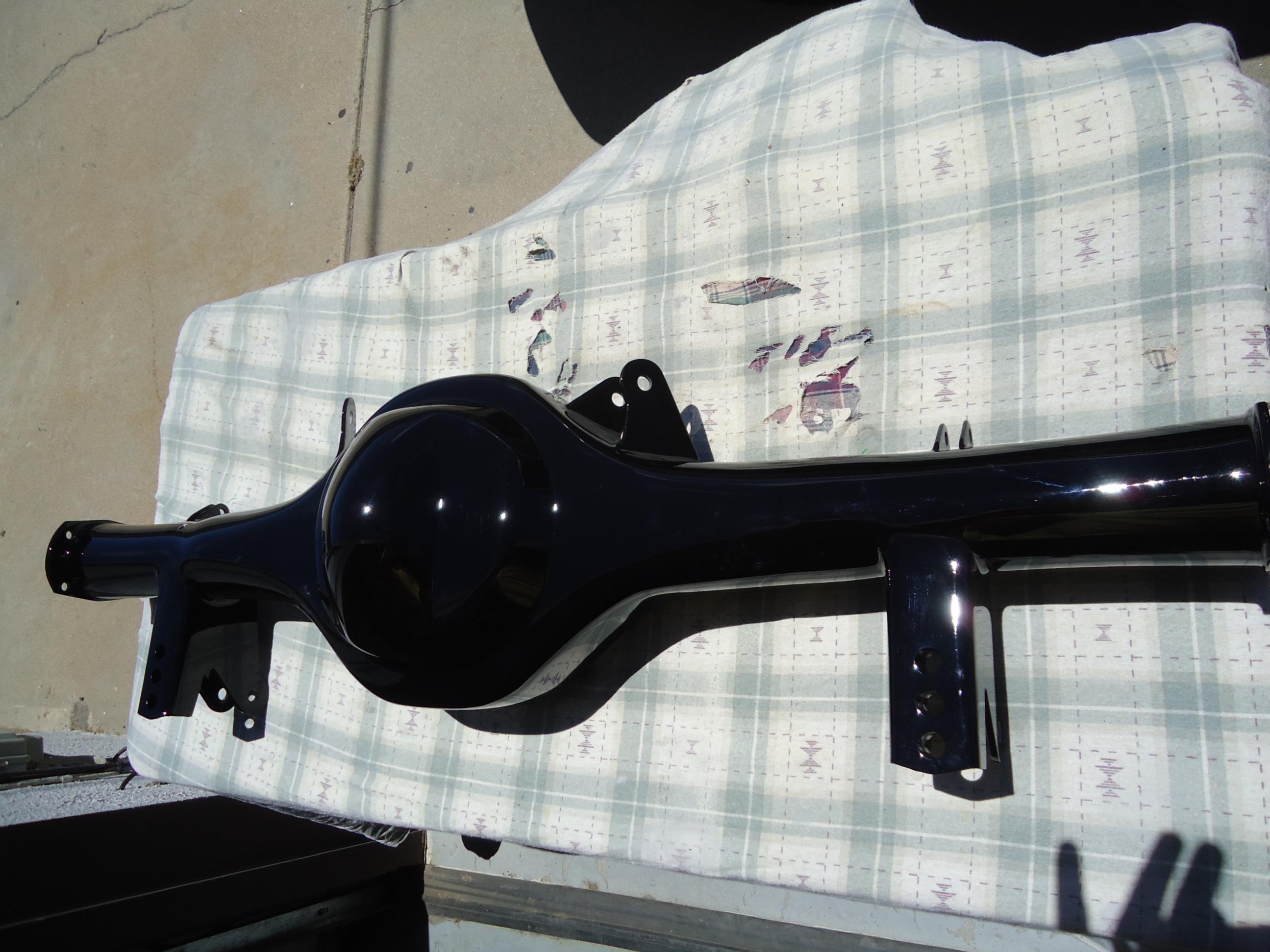

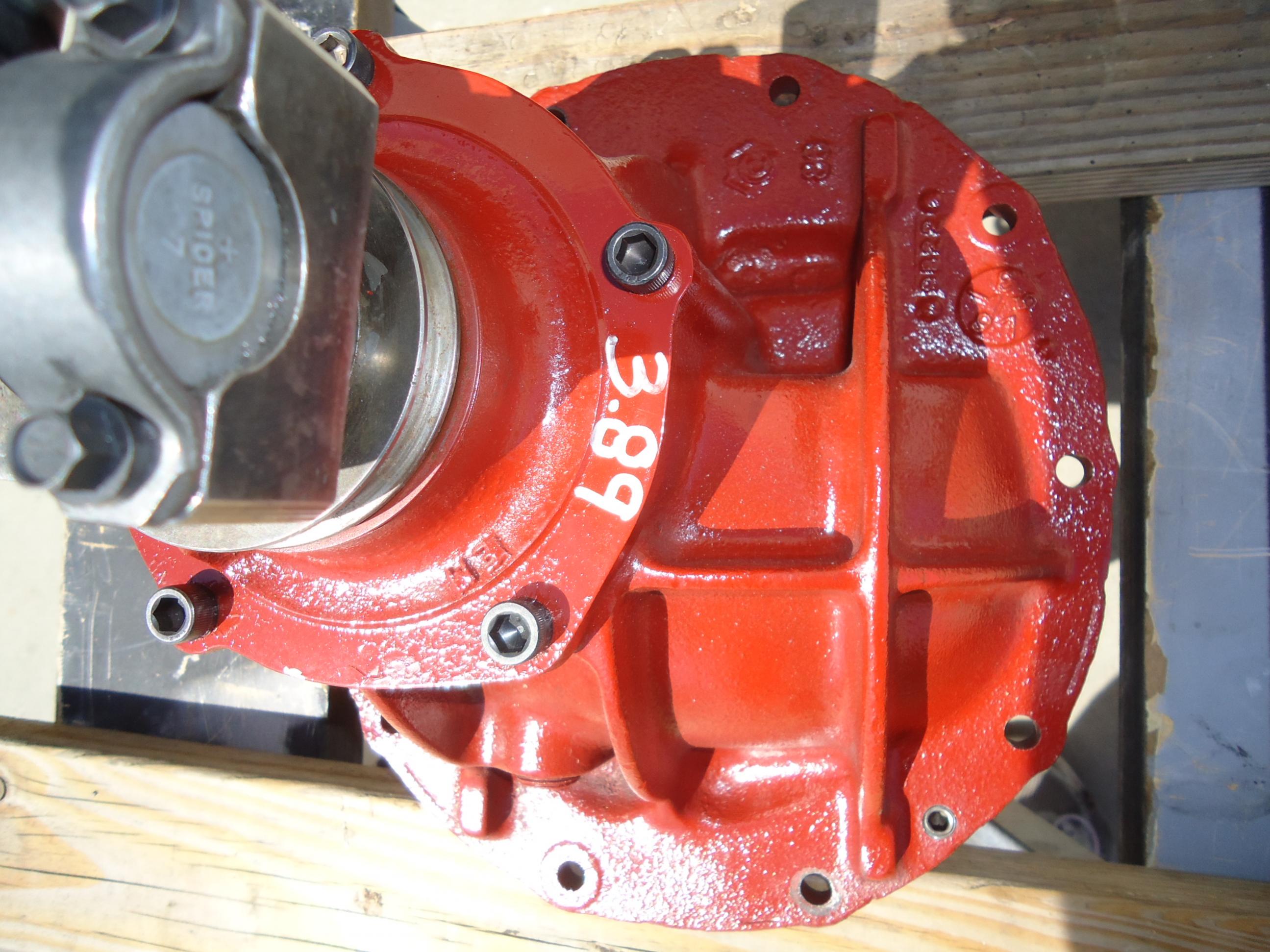

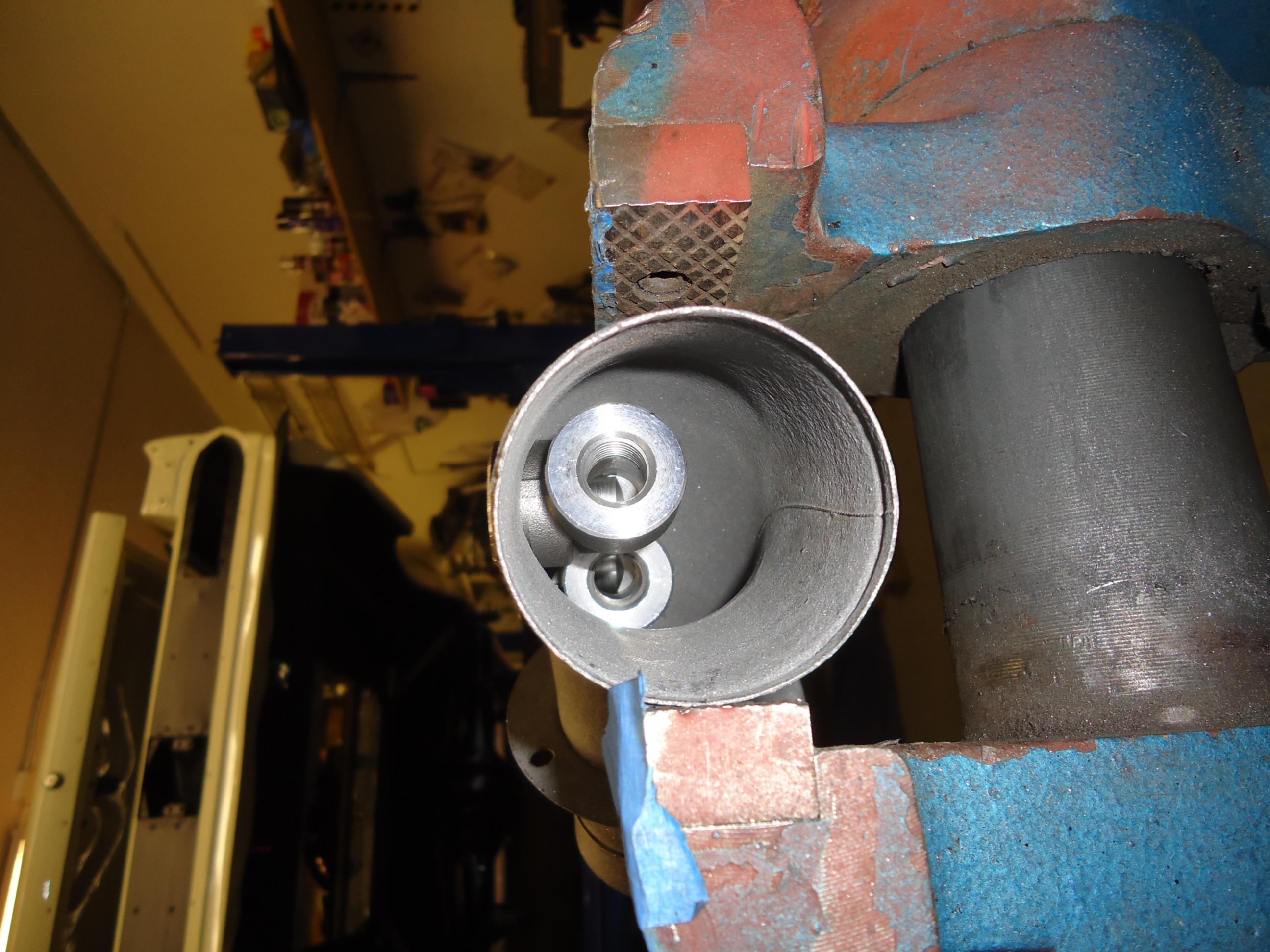

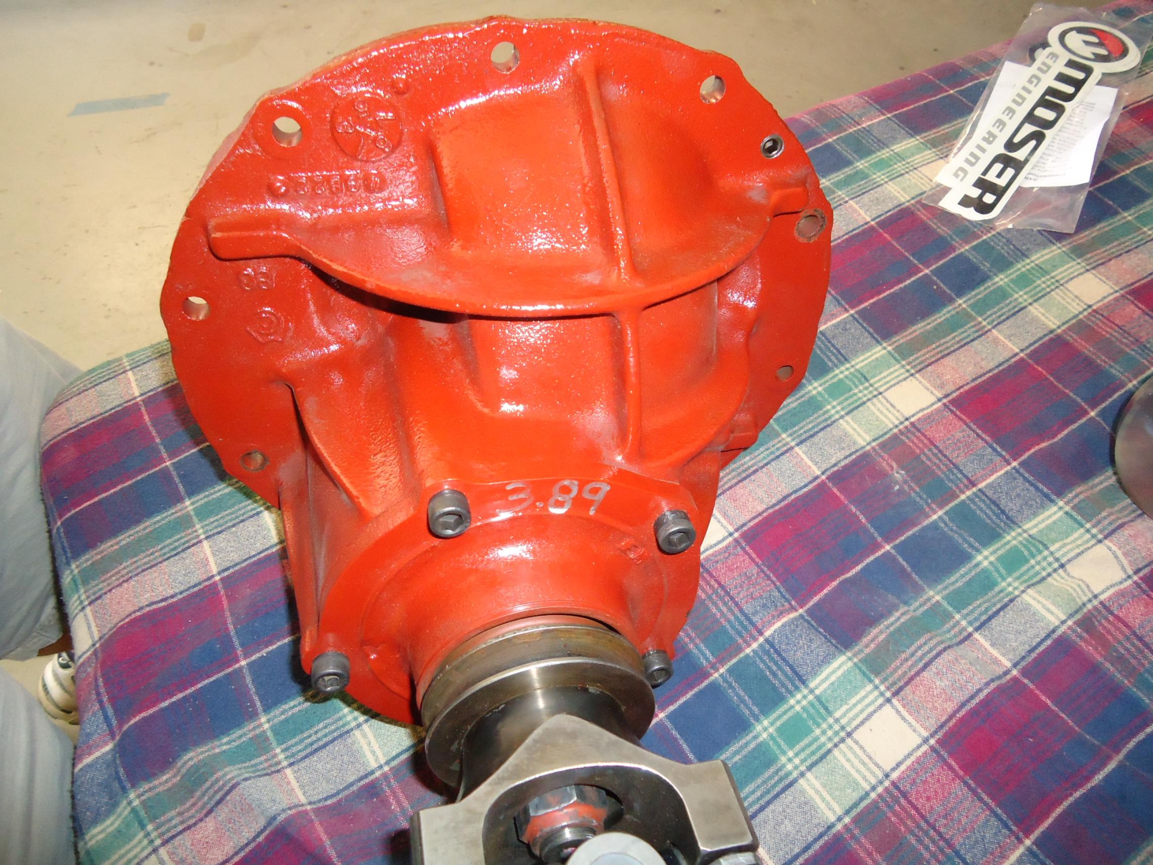

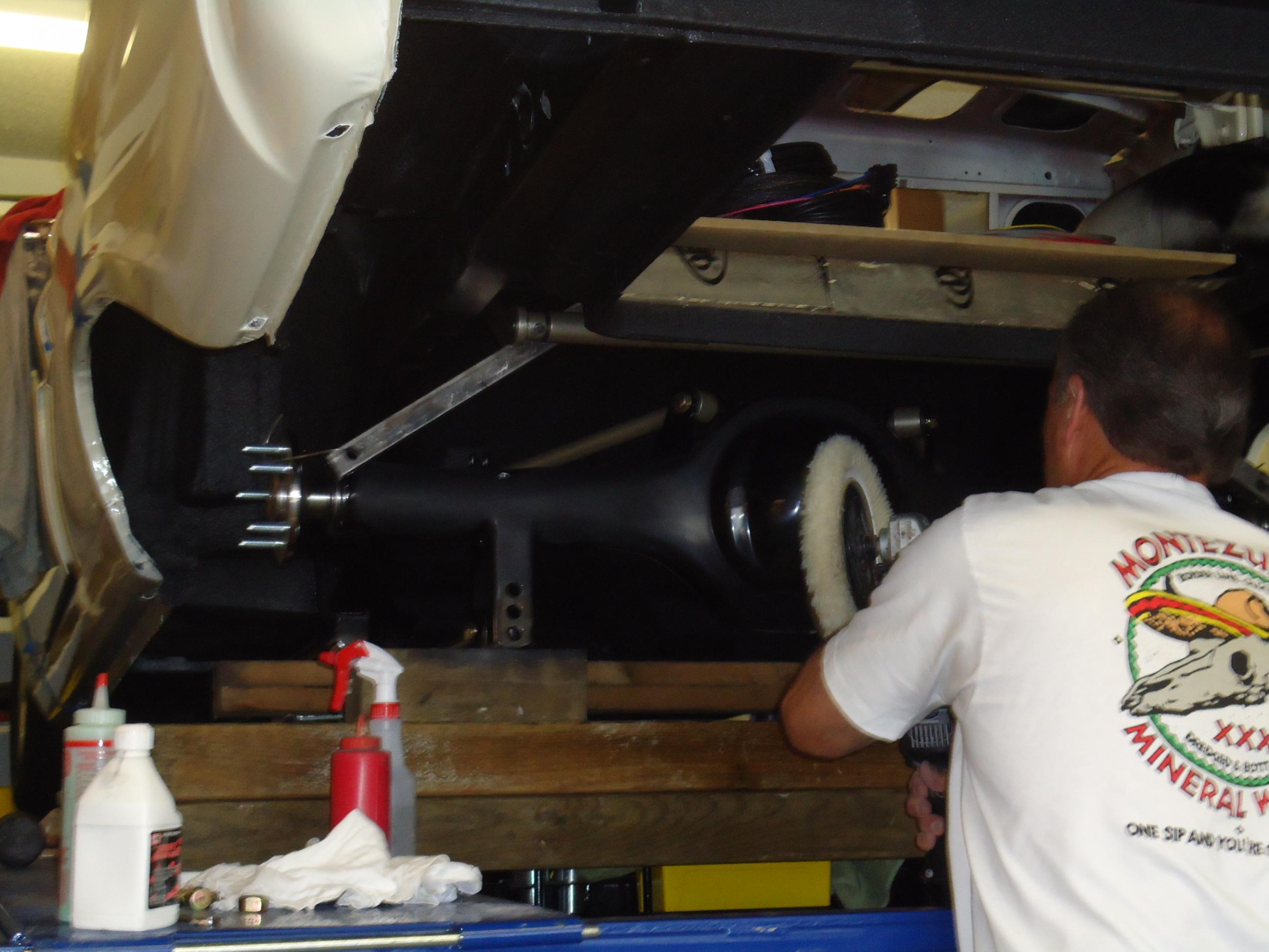

    It was time to drop in the 9" center section with the 3.89.1 locker gears. I had to go with the traditional red oxide primer on the center section just as another nod to the vintage aspect of the build. It has a billet yolk and a pinion pulley as well just, well, because I thought it was kinda cool just in case I wanted to use it for an add on later.
    Total Perf-
      506.1 KB
      240
      473.1 KB
      250
      512.4 KB
      241
      500.1 KB
      255

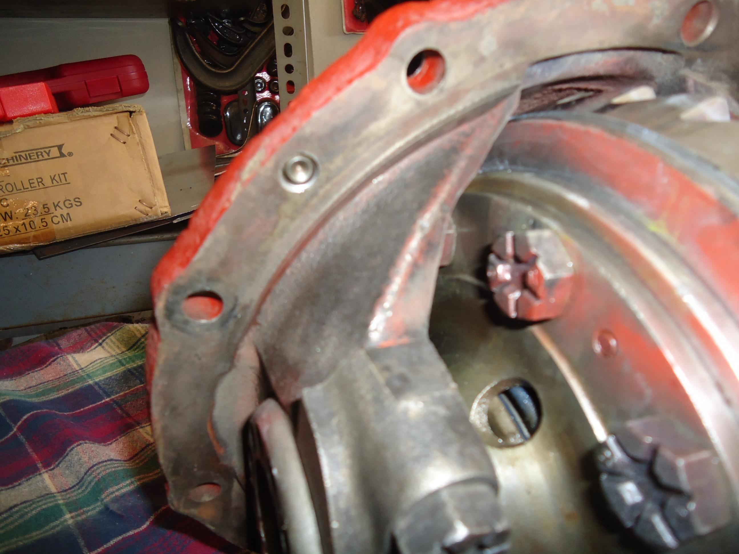

  8. Total Performance
    Joined: Jan 4, 2011
    Posts: 1,496
    Total Performance
    from Nor Cal

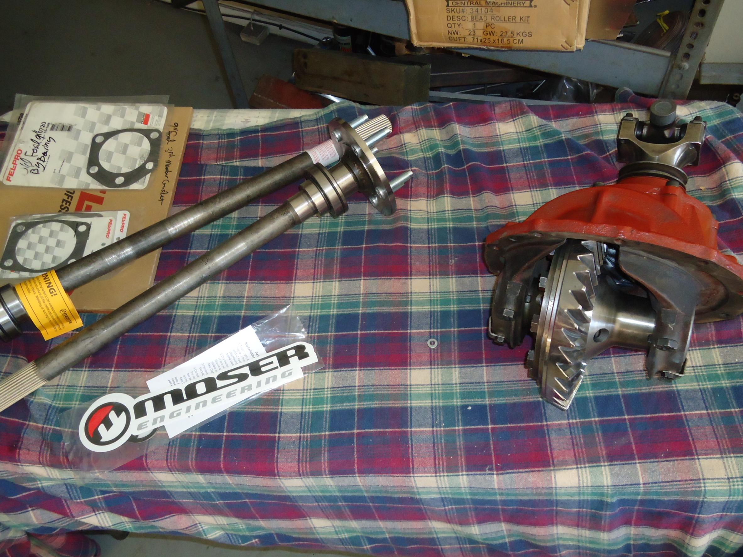

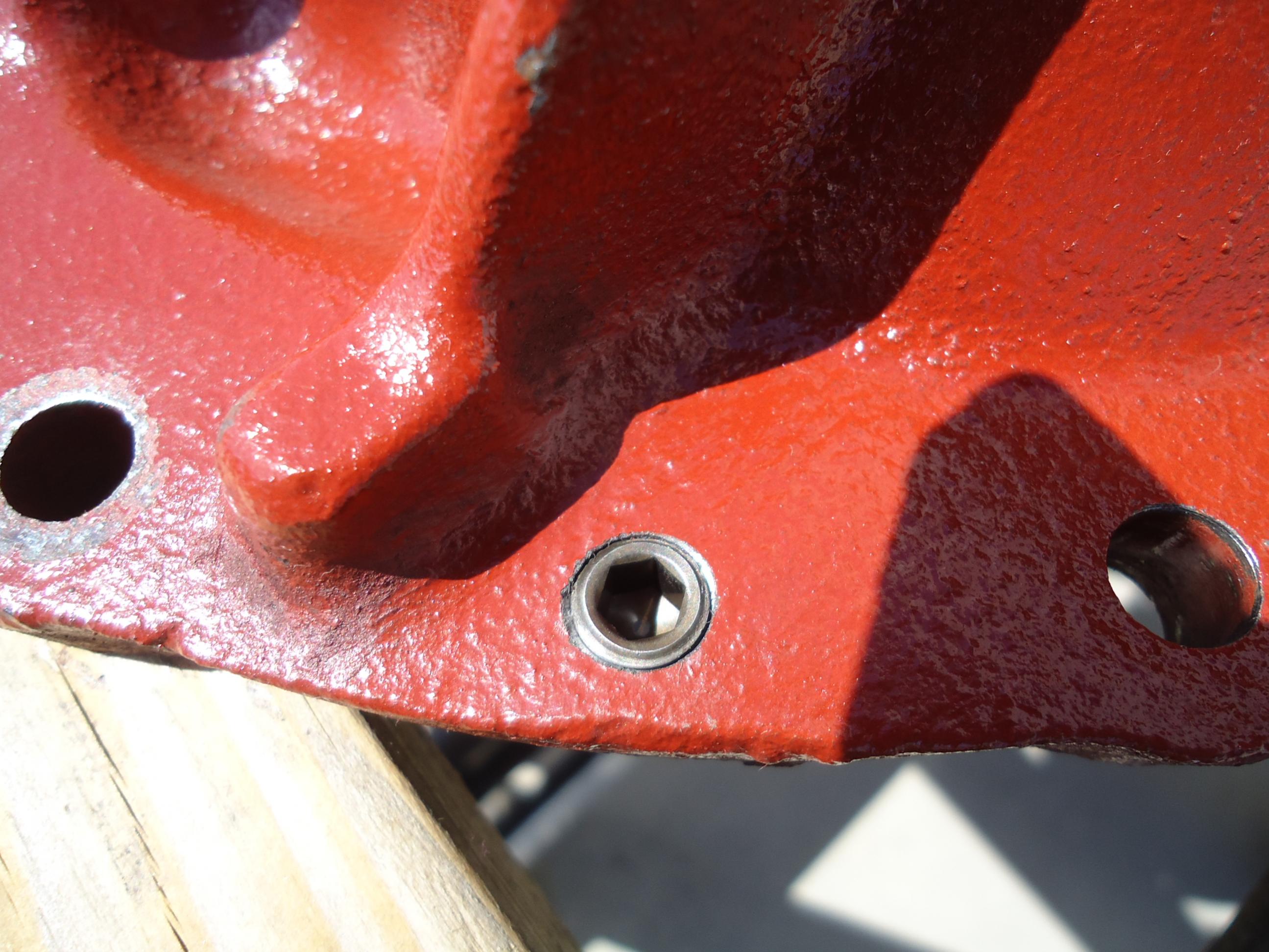

    While Alain and I were fiddlin with the rear end he had a great bit of knowlege that we used. In the off chance that we will have to pull the center section there is really no simple way to pop it away from the housing without prying it off with screwdrivers and pry bars, scrathcing the hell out of the great looking axle. Until this tip from Alain. I drilled and tapped the mounting/sealing ring with a bung. It seals up along with everything else as well as when the time comes to pop the section out you just grab a hex key and screw in the hex to break it free. Great Idea!
    Total Perf-
      466.8 KB
      227
      363.9 KB
      249
      512.4 KB
      227

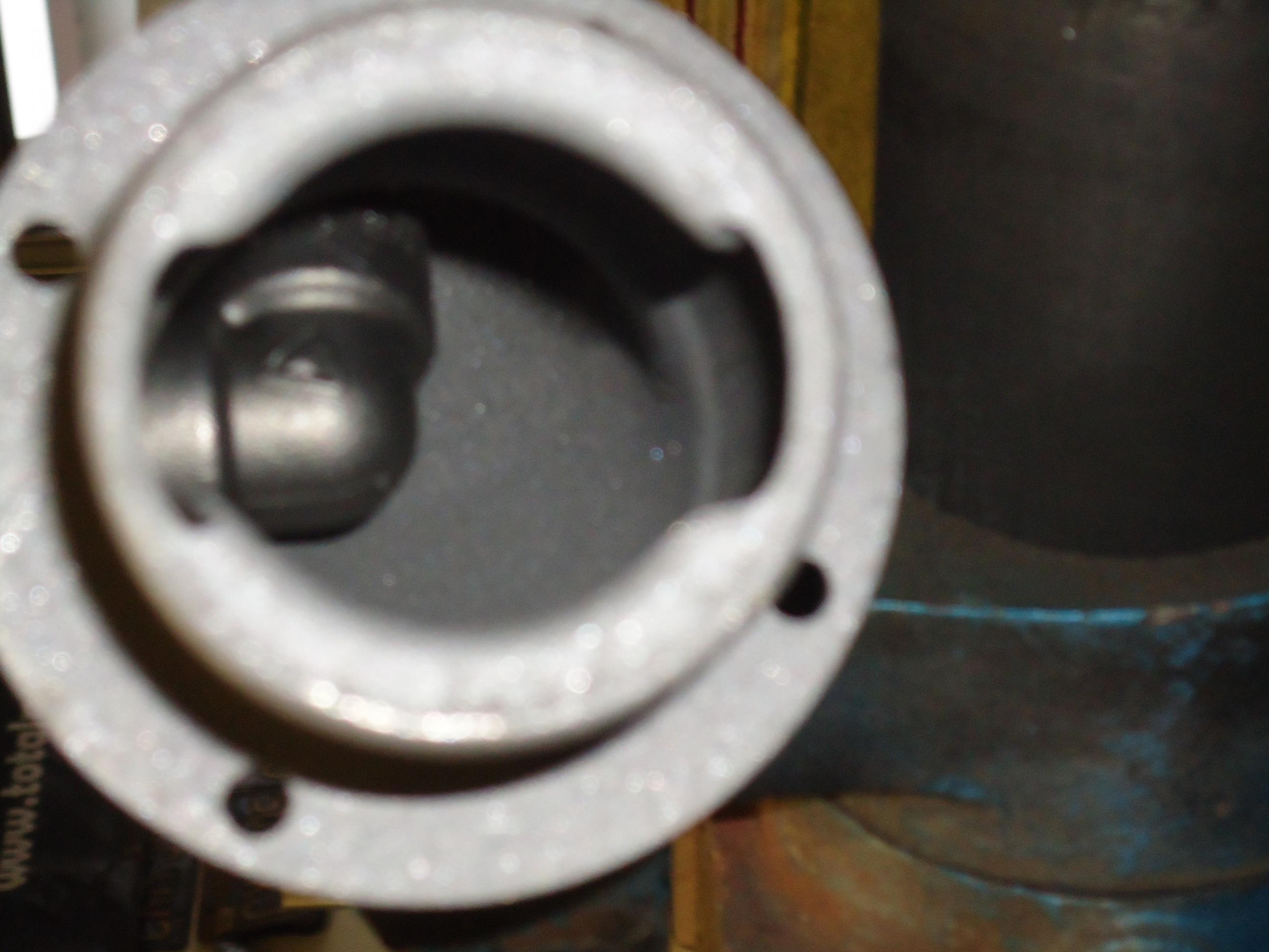

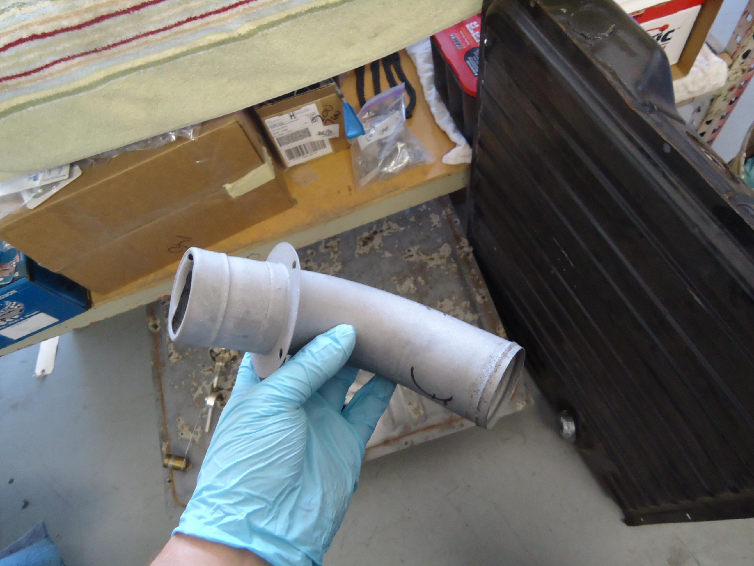

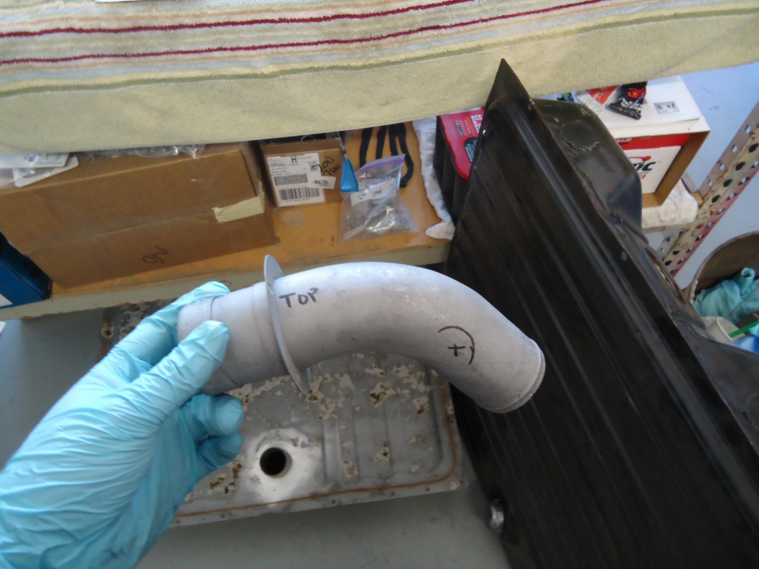

    We were waiting for a the rear brakes from Speed Warehouse ....again, so I decided to work on the fuel system. Were using a fiberglass fuel tank so there are some issues I had to deal with to make sure it would last. Firstly, I had to make sure it would be able to stand up to modern fuels and not break down as most of the fiberglass tanks do these days. My solution was to coat the tank with a tank sealer. The trouble with that was most tank sealers say that they aren't compatible with glass tanks. When I called the tank manufacturer Crites, they recommended I use the Eastwood to seal the tank as they have in the past. I looked at the tech sheet for the Eastwood product and saw that it was exactly the same as the product KREEM tank sealer that we had at a local cycle shop. So we used it with great results. I wanted to pass this info along. It took me a day or two to figure it all out. Hopefully I can save somebody some time. Anyway, after appluting the product to the tank the sloshing and drying process took a few hrs. Put aside the better part of an afternoon for applying this to your tank properly. End result was a good sealed tank with no soft or melted fiberglass. Very happy.
    At this point Brian blasted the fuel inlet tube in preperation for some fabrication.
    Total Perf-

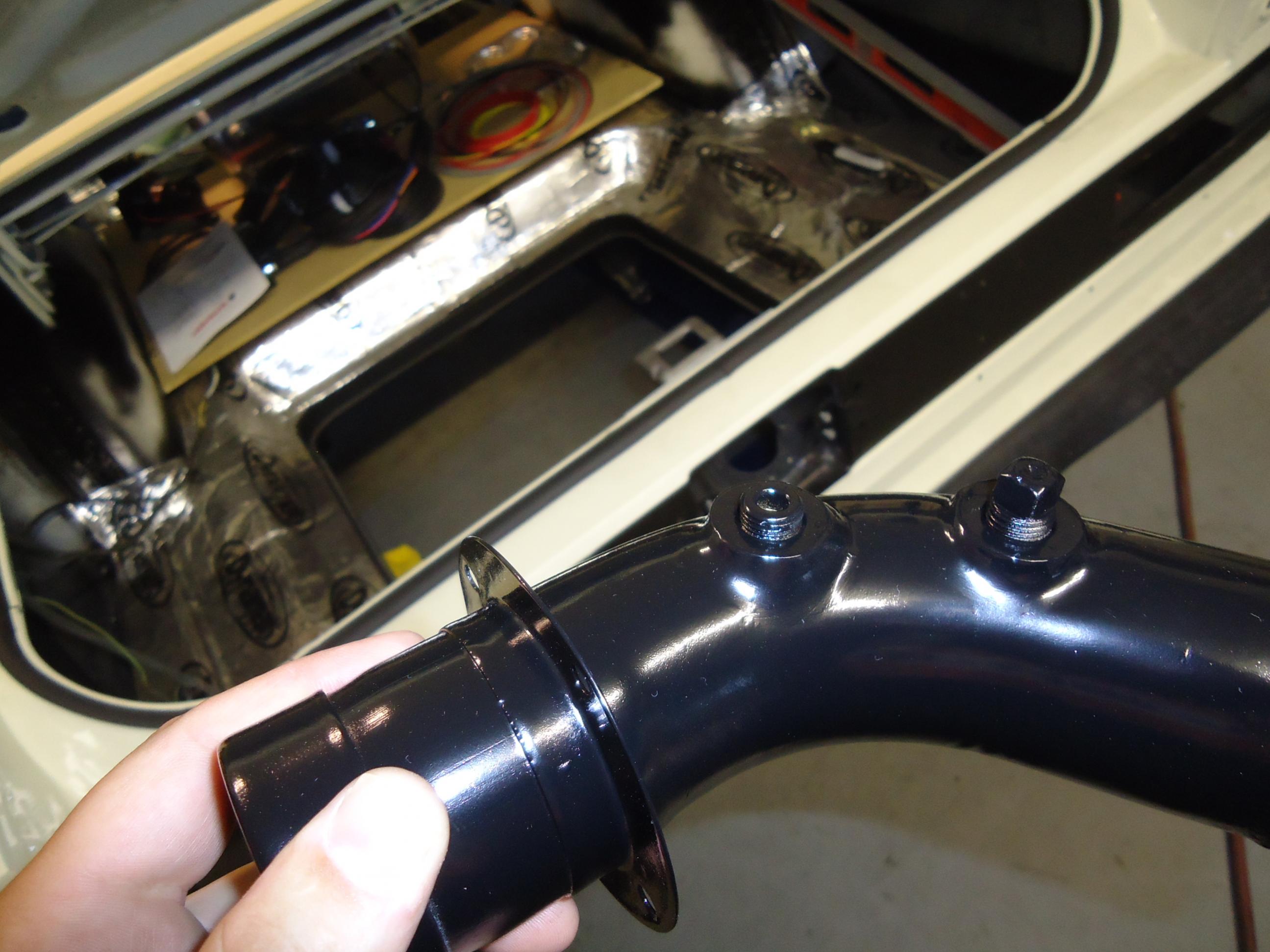

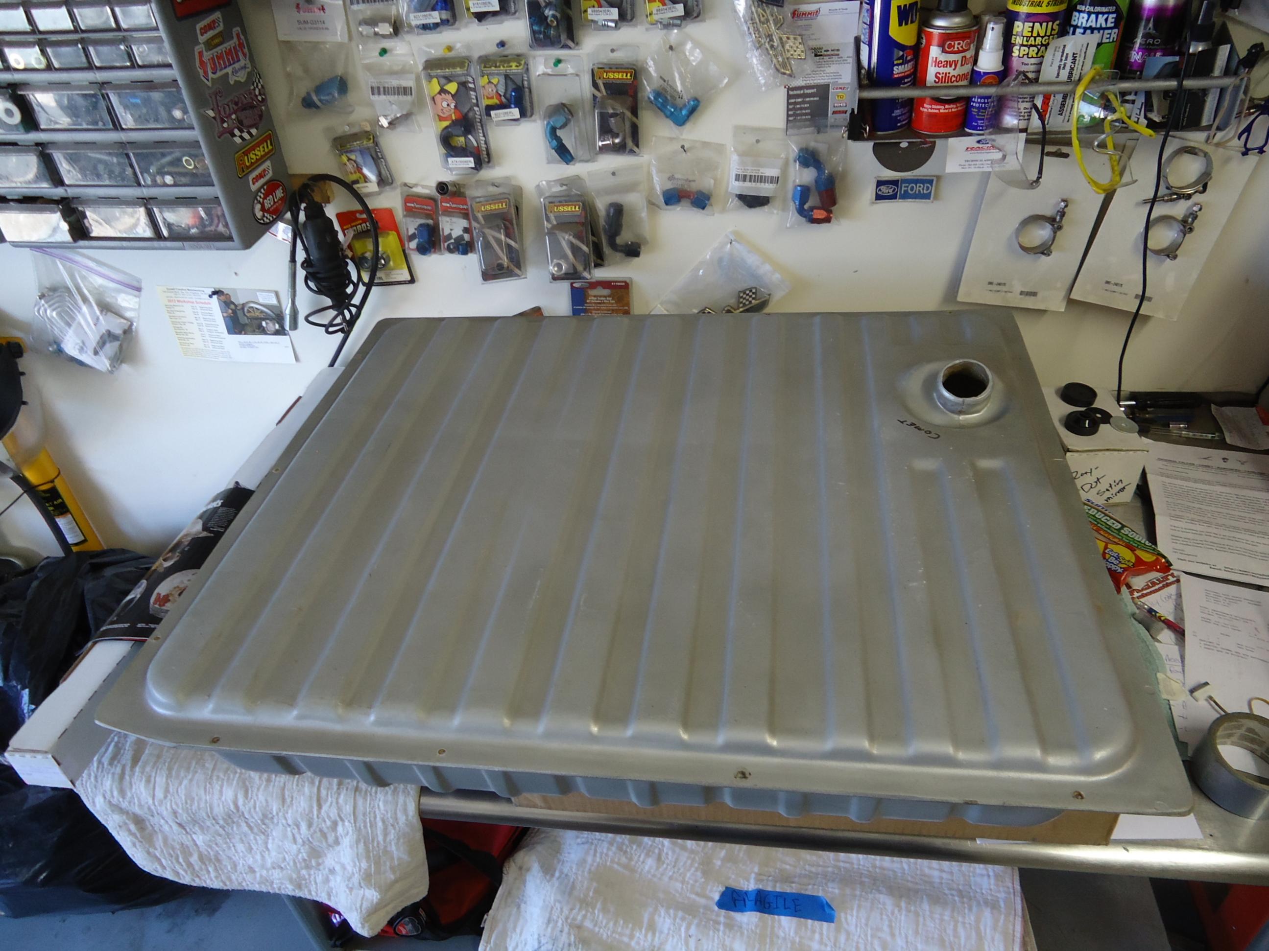

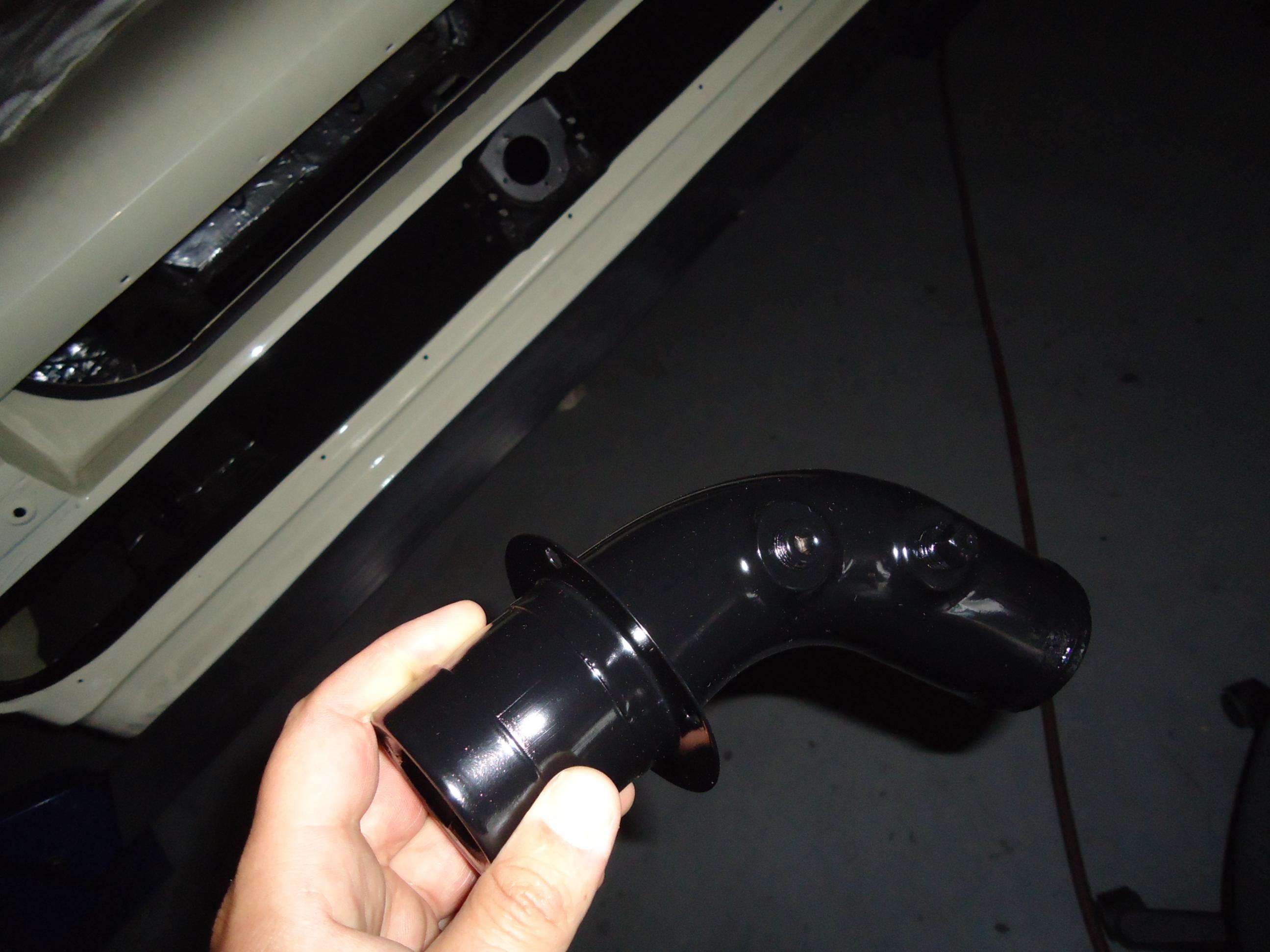

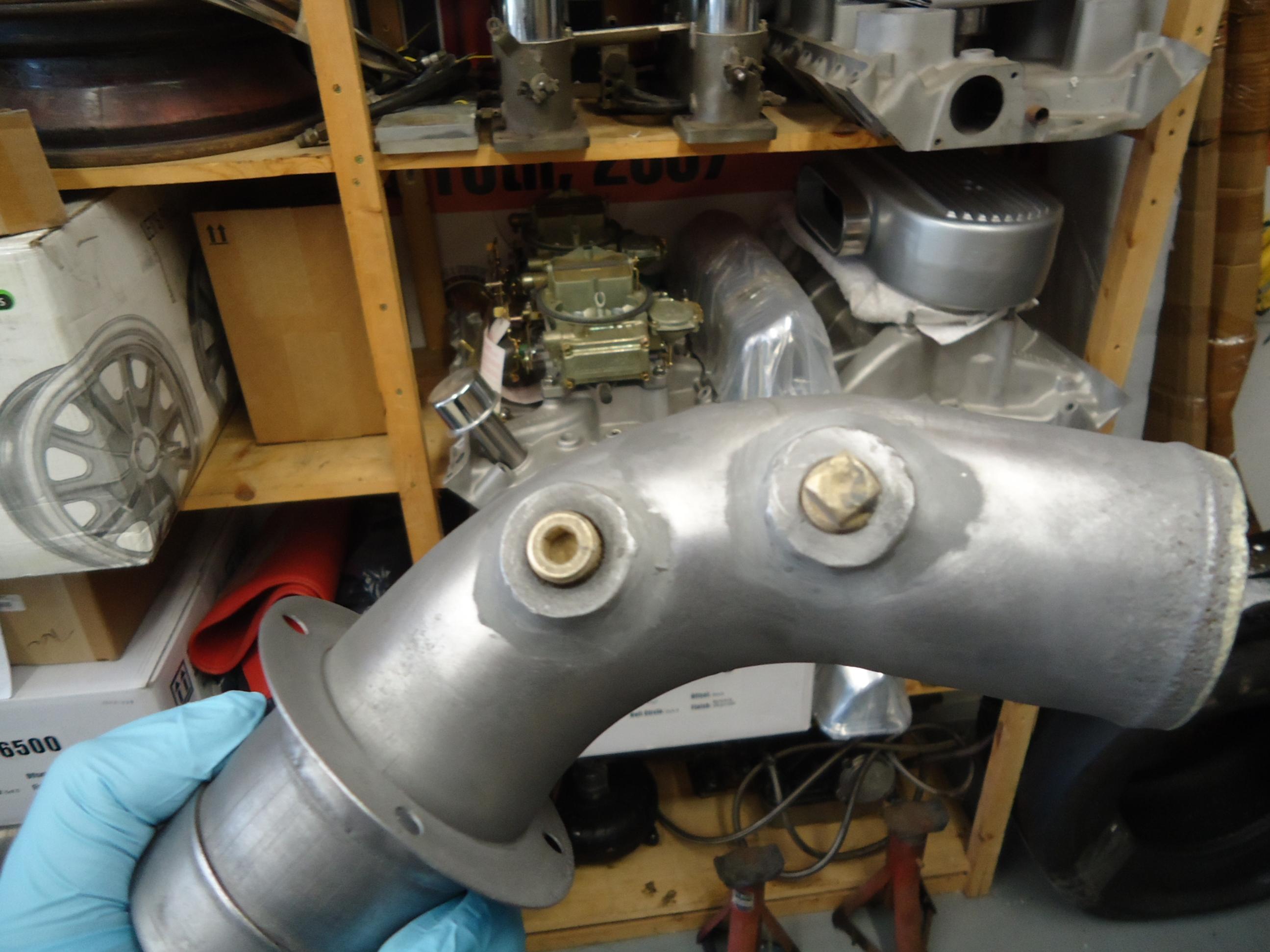

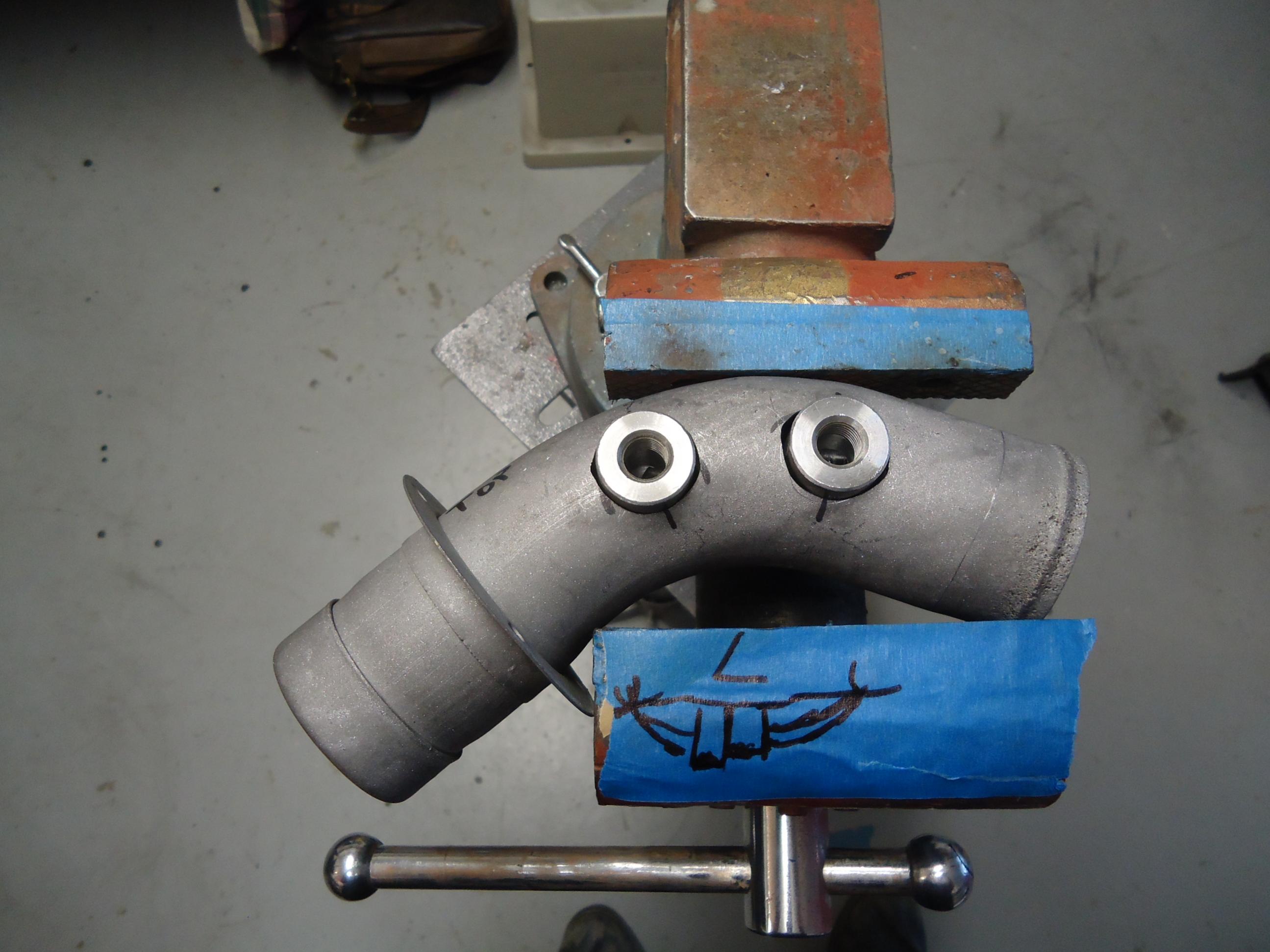

    Due to using the fiberglass tank we didn't want to alter the tank by drillin placing fittings and reglassing the tank. Se we used a method that has worked for us in the past. Thats two bungs in the filler neck. One for an air hose/breather into the tank and one for a return line from the engine. I had to weld the bungs in at the right location and in line to slip it into the relieved external body hole and still only have enough reliefed that the filler flange covers it when installed. After welding it all in I sealed the inside with KREEM sealer. Outside I filled it with a sandable fuel resistant metal material for extra toughness. Then I let it cure for a day before I cleaned it up enough for me to shoot it.
    Total Perf-

    Then I shot a semi gloss black over the filler. After the lines are ran the filler will be buried underneath Denny's uphostered trunk work.
    Total Perf-

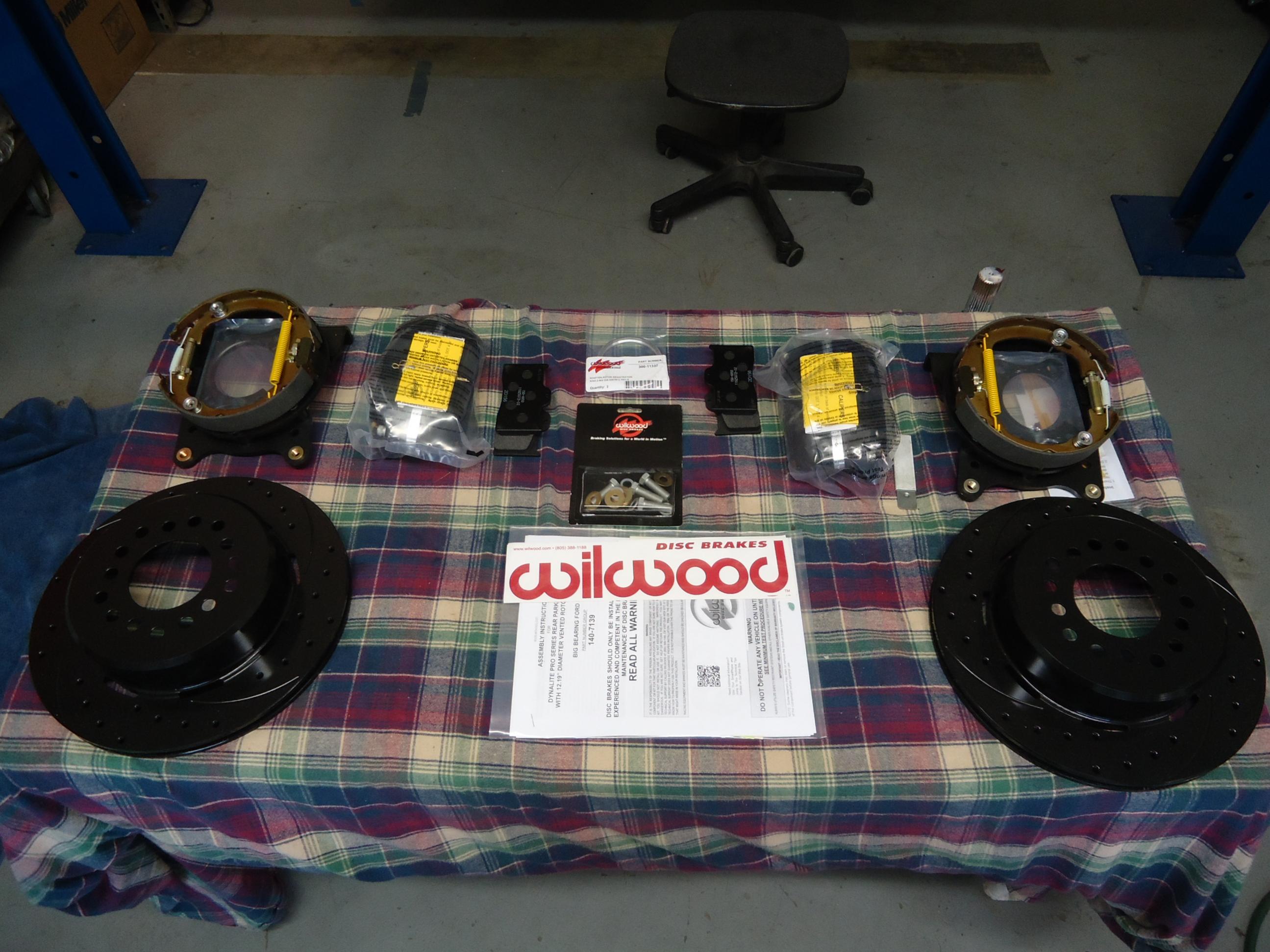

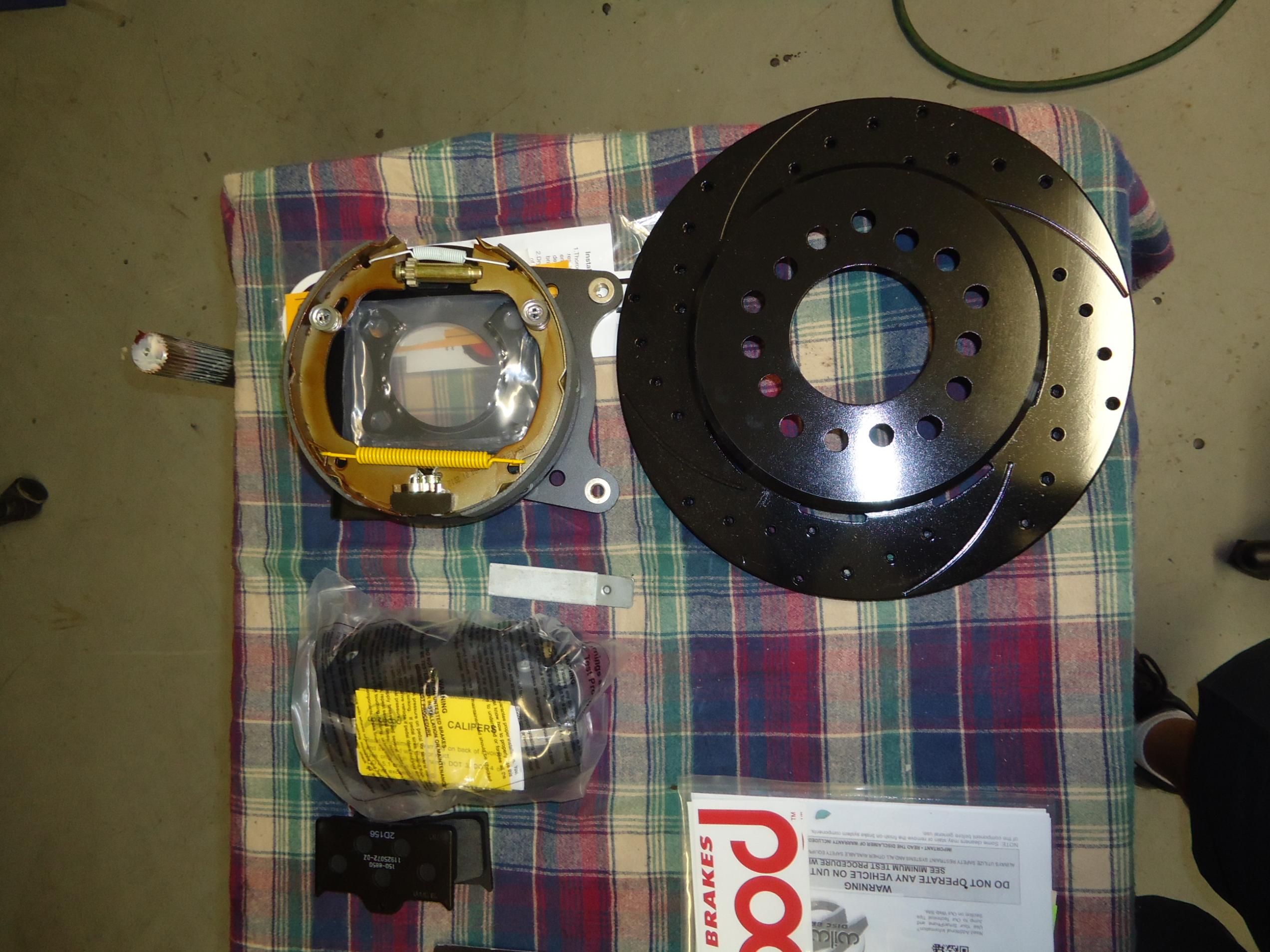

  14. Total Performance
    Joined: Jan 4, 2011
    Posts: 1,496
    Total Performance
    from Nor Cal
    Finally the rear brakes came!!! It only took Speed Warehouse 6 weeks for me to get the brakes. Seriously waiting for parts is the worst part of this thing. The car couldnt get on the ground until the we got the brakes. Thanks Speed, you killed about 5 weeks for us, waaaaa, thanks for letting me vent a bit....Anyhow I use only Wilwood at this point. Wilwood 12" 4 pistons with internal emergency brake part number 140-7139D.
    The brakes took me about 1 hr to put on the car. They couldn't be easier and actually very fun to get on the car. I love these Wilwood brakes!
    Total Perf-
      470.5 KB
      250
      495.1 KB
      266

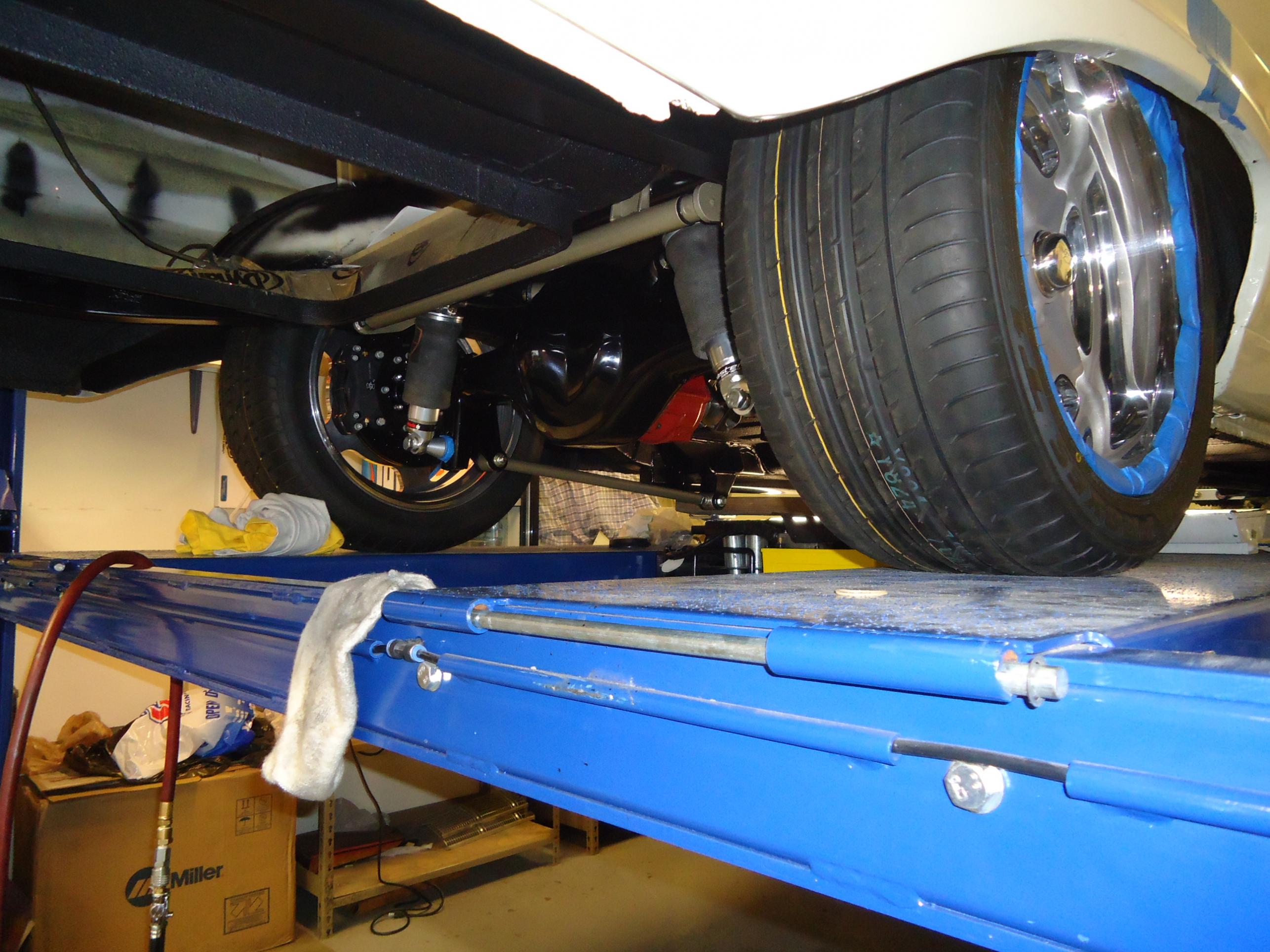

  15. Total Performance
    Joined: Jan 4, 2011
    Posts: 1,496
    Total Performance
    from Nor Cal

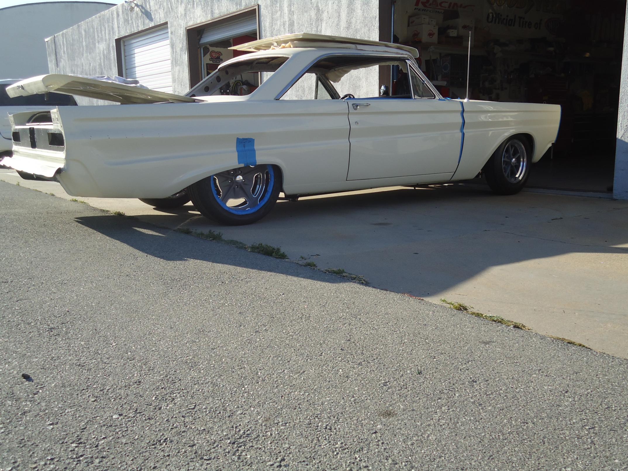

    FINALLY ITS ON THE GROUND!!!!!

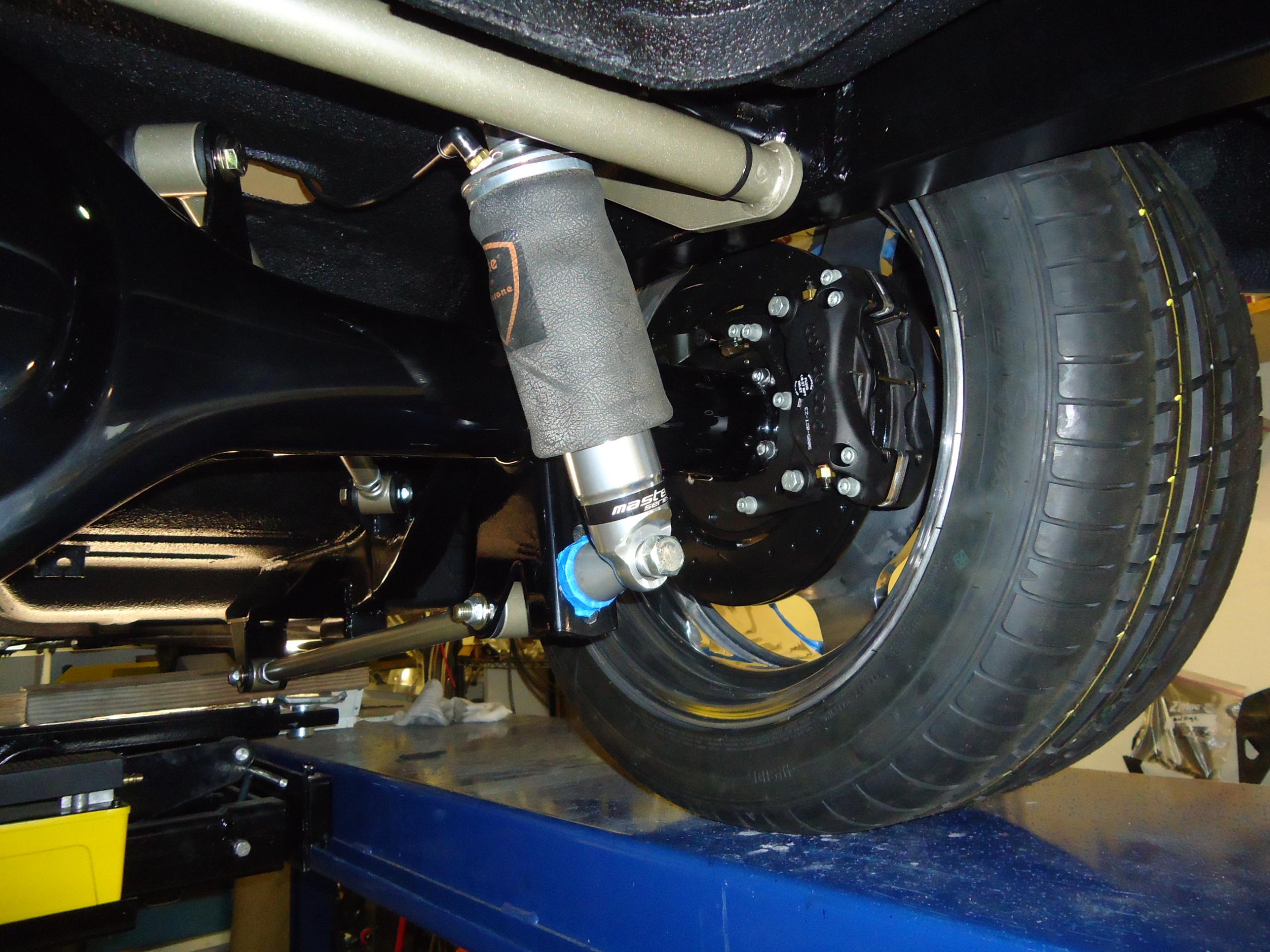

    We dropped the car on the ground today with the new suspension and the bags aired up and down. As always there is always a question if the car will sit level or if the car will list or inflate even. We are happy to say that it sits perfectly level and airs up fantastic!
    The Welder Series bars went back in the car perfectly and functioned just as they are supposed to as we aired and released with zero binding and zero resistance. Perfect!
    Now now with only minor adjustments that are needing to be made to even out and center the combination we are very close!
    Total Perf-
      493 KB
      385
      493.1 KB
      312

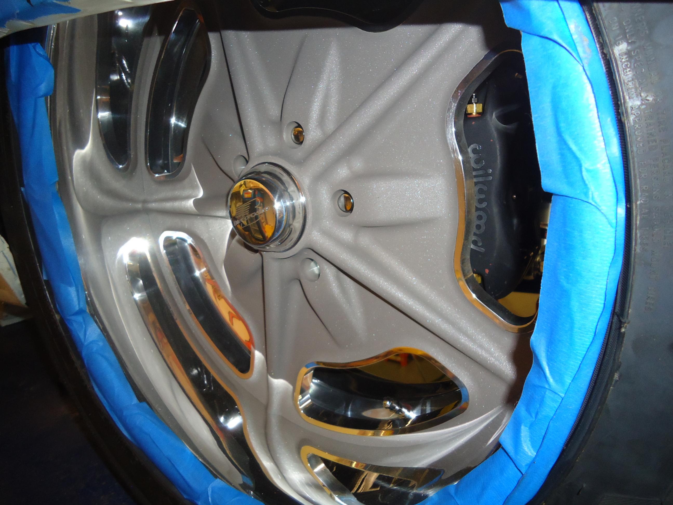

    I taped up the wheel a bit so they wouldnt be tore up by tools, dust or anything. Thats something I would do. I seriously love these Bonneville g wheels! Wilwood should be stoilked that the wilwood is seen through the wheel window. It was a great day! Now were all beat, even Daisy-Time to roll home.
    Total Perf-

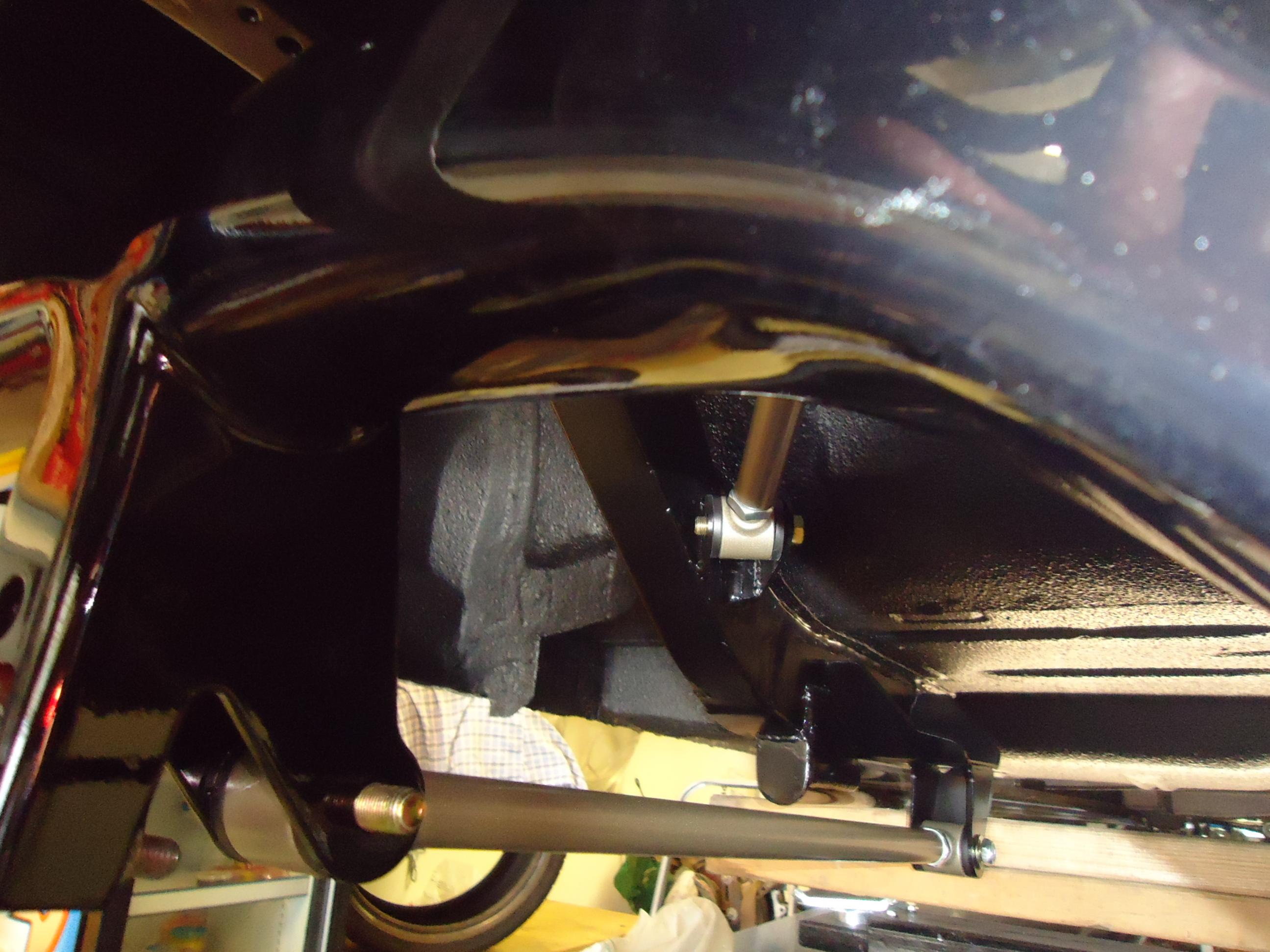

    A bit out of order though here is a better look at the bars going in. These pics are all pre-adjustment so things arent set yet here. But it gives you a better idea of the painted contrast.
    Total Perf-
