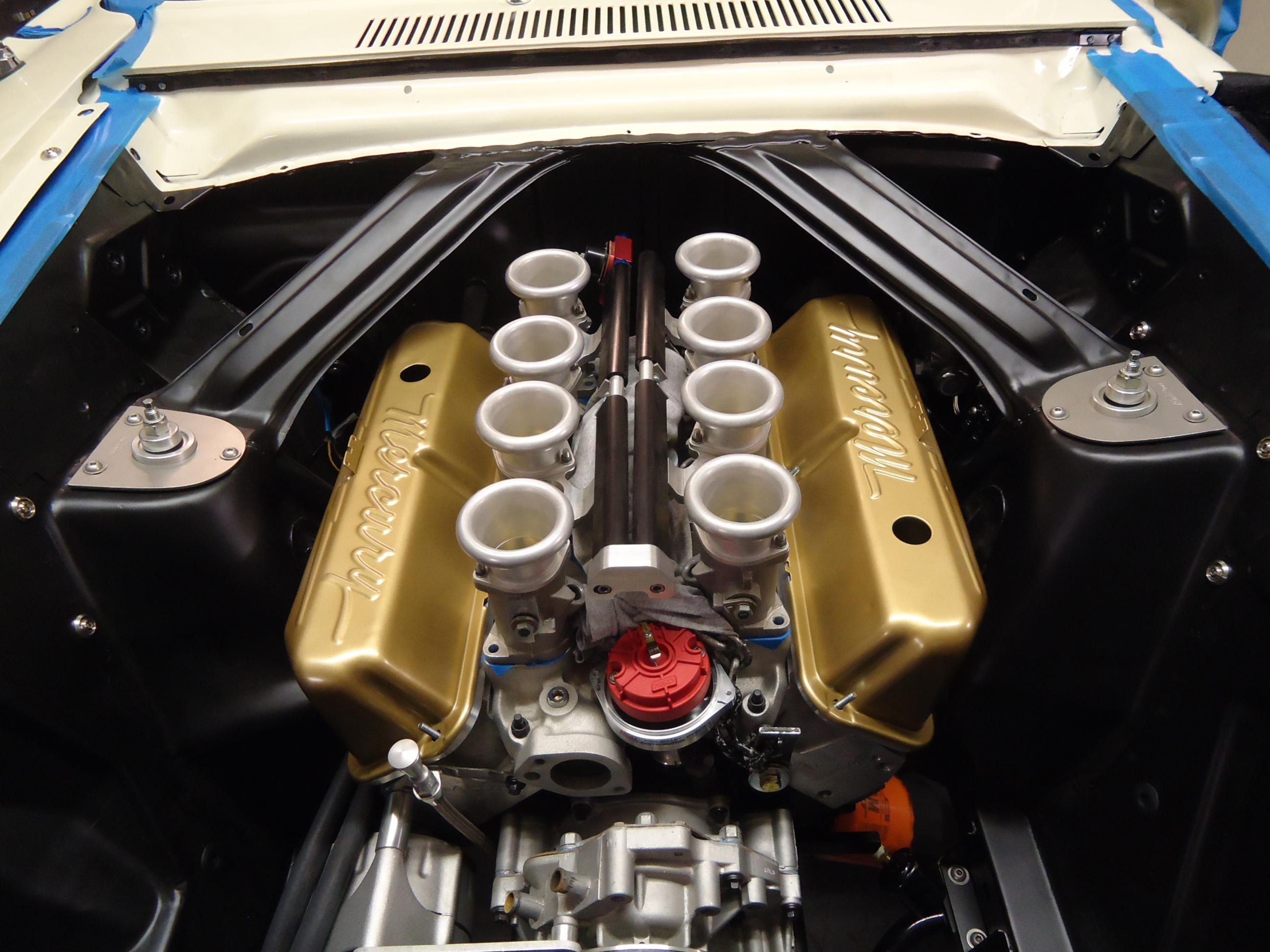

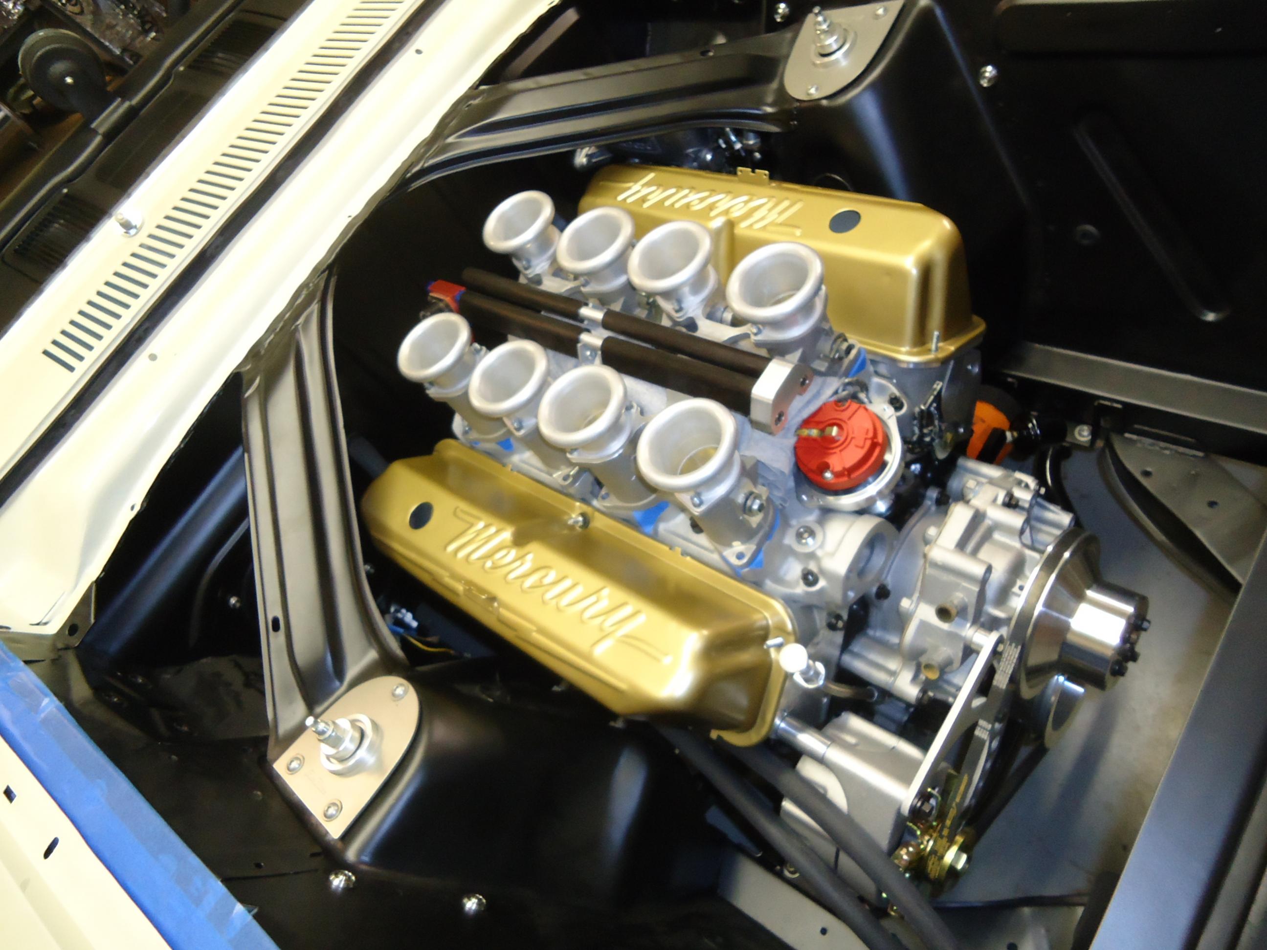

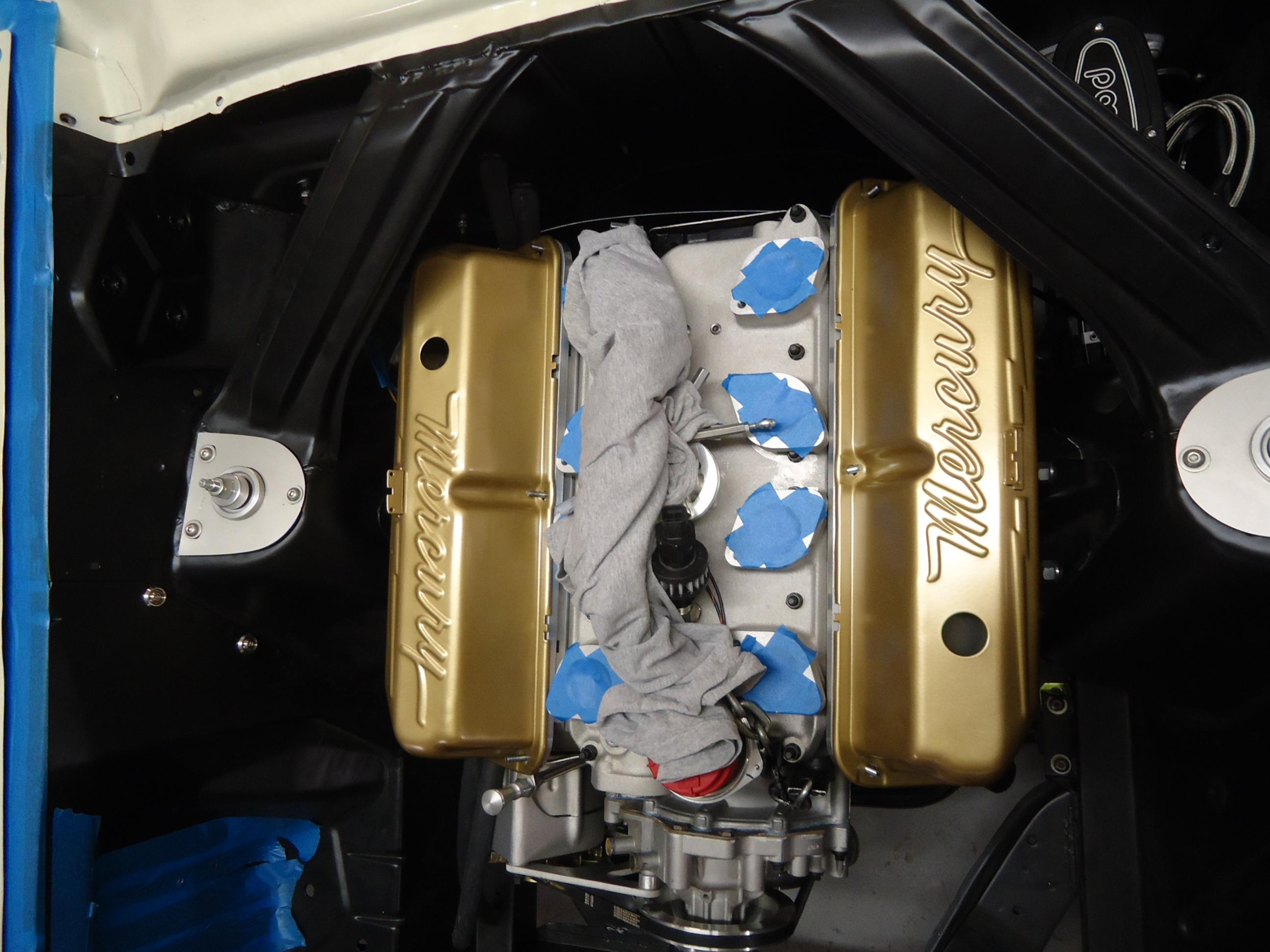

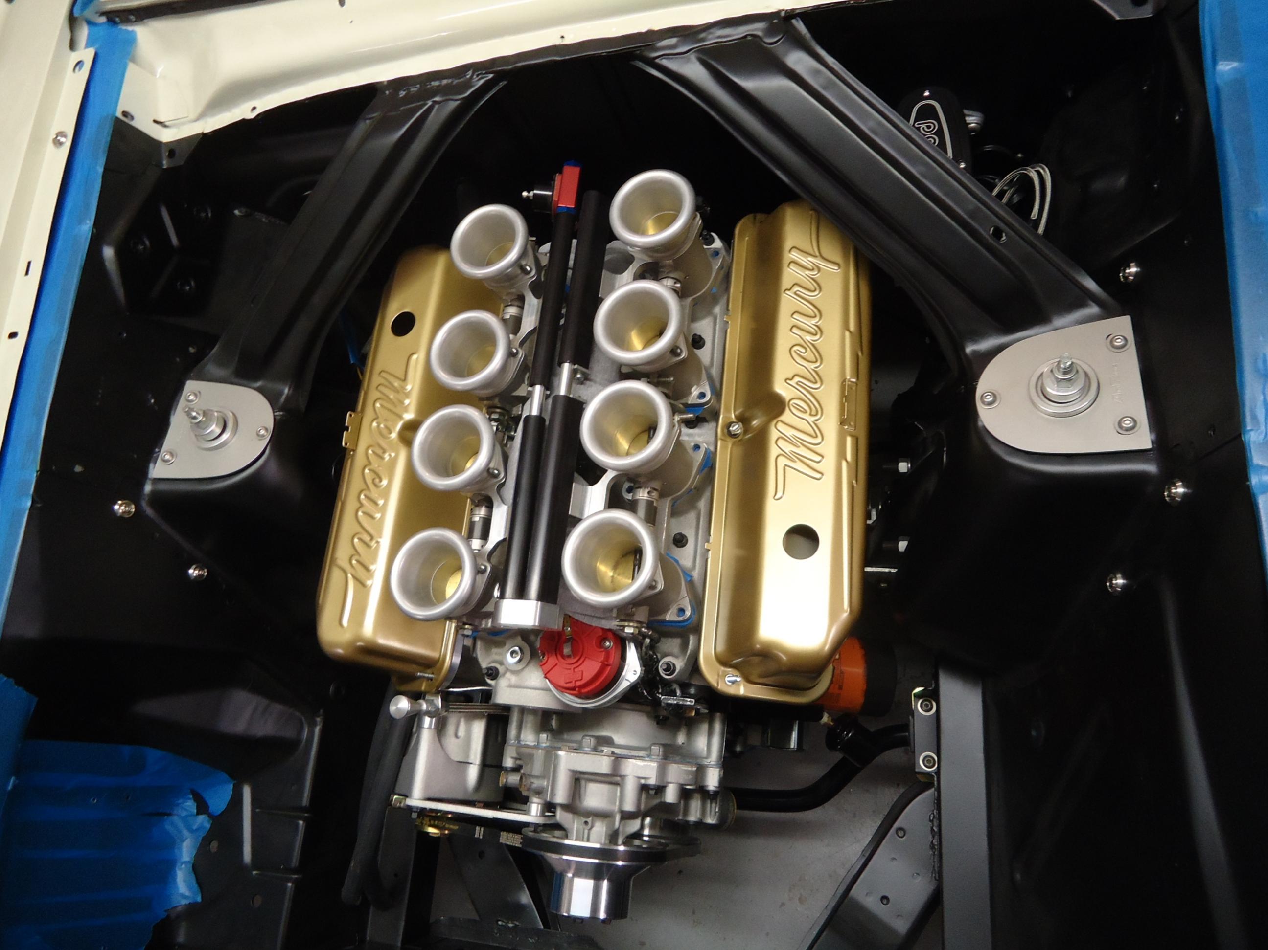

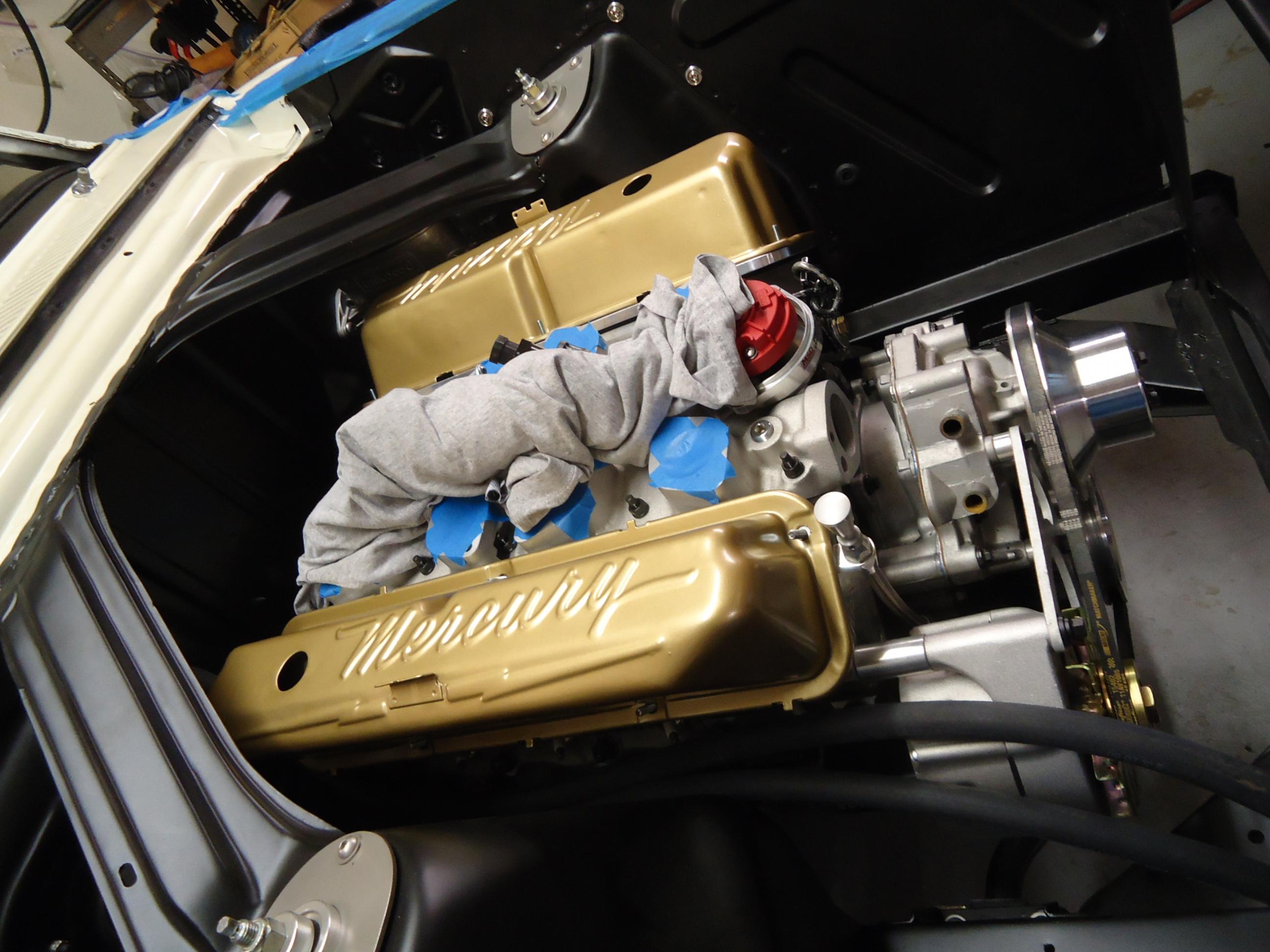

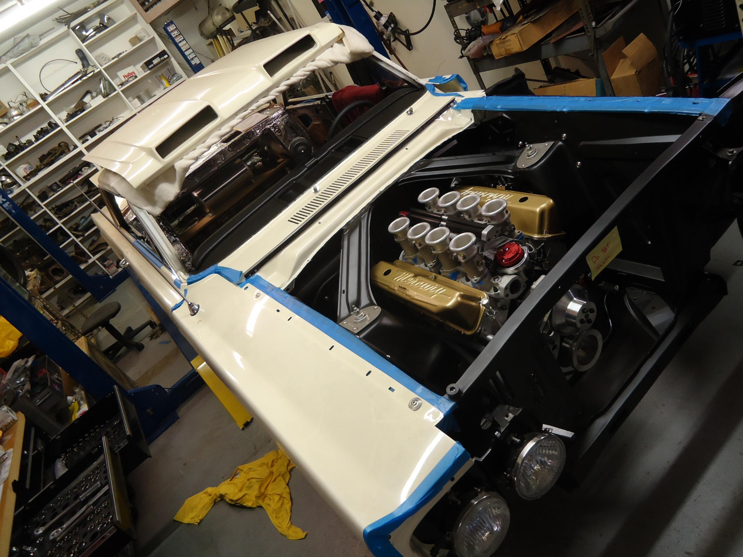

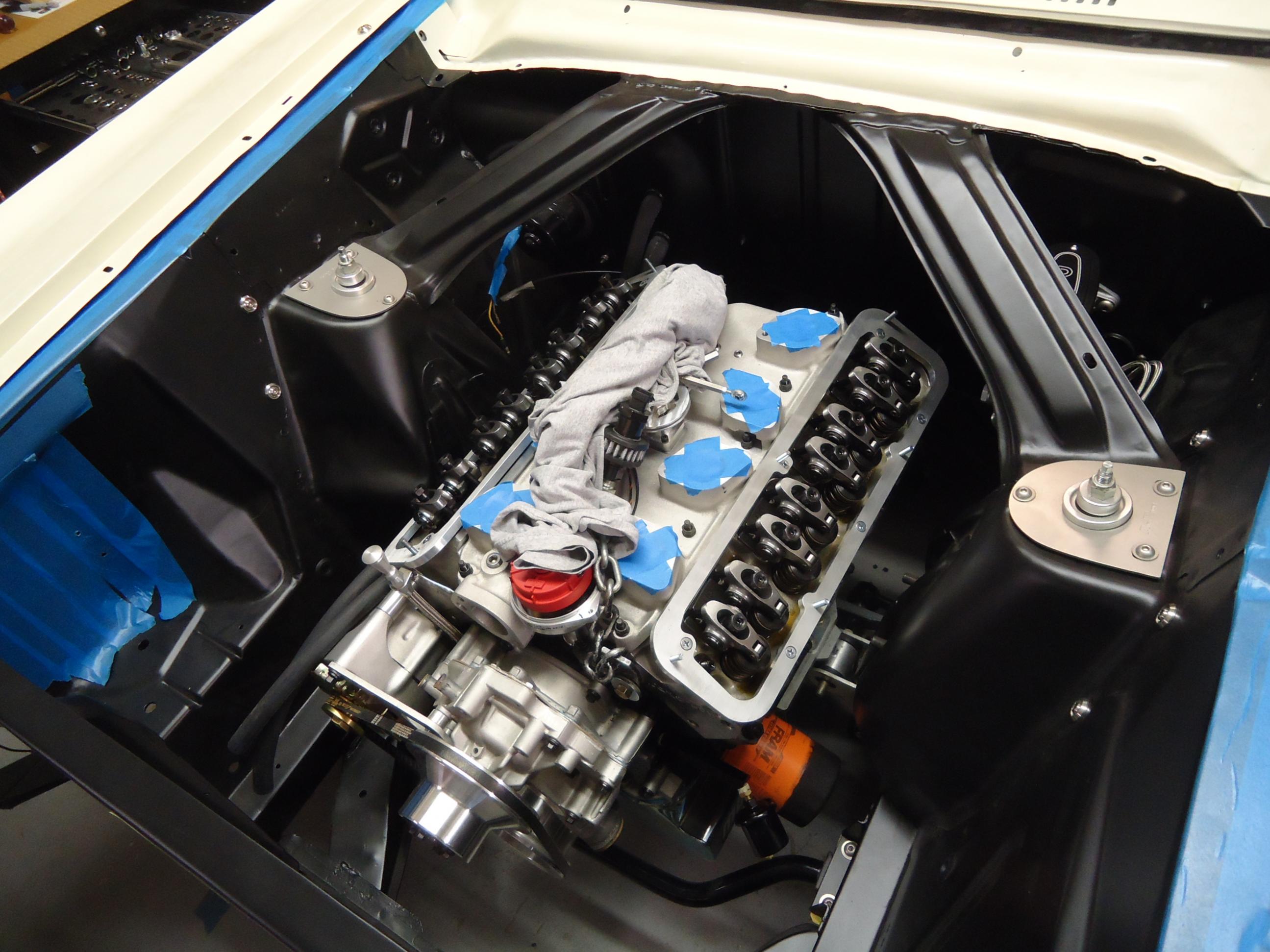

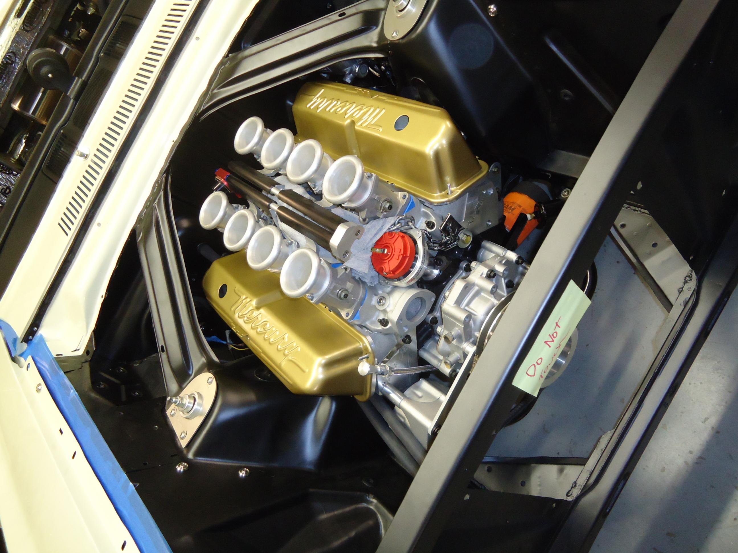

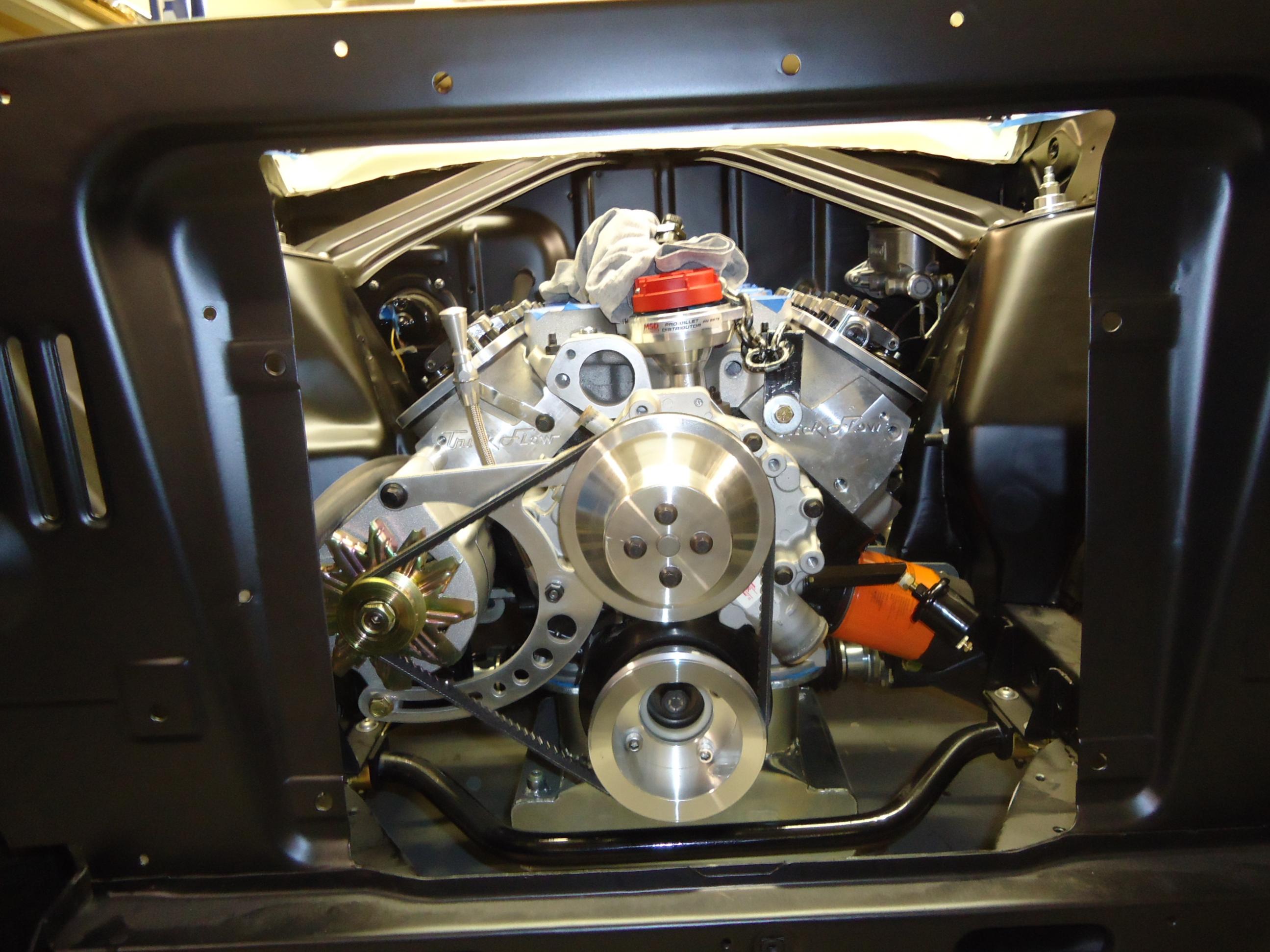

    Hey guys- Here are a few pics of the Engine going in the car. I'll have a few installation notes on the next post.
    Total Perf-
  5. Total Performance
    Joined: Jan 4, 2011
    Posts: 1,496
    Total Performance
    from Nor Cal
    The shop lights make the Mercury Valve Covers look more yellow than gold. Those babies are very gold though!
    Anyhow, I used the adjustable engine mounts of Ron Morris for this application. These move the engine down for clearance of the valve covers as well as help with the center of gravity for handling and overall driveability. We have more room for the Wilwood master that an original 66-67 Fairlane would have in a big block FE application. I was very pleased with the fitment all around. Furthermore we were able to move the engine front and back and that came into play when installing the AOD trans. The AOD has a larger bell housing flange and a larger "bulge" in the converter area. The mounts made it poss for us to avoid any trans tunnel fab as well as any fitment issues. Yeah! to Ron Morris!
    Also to note is we had to drop the trans in seperate for our application. I wanted to avoid any paint damage as well as with so many variables I wanted to take it one step at a time. For all the time we spent making it all fit we probably saved twice as much in any issues we may have had to deal with.
    Total Perf-

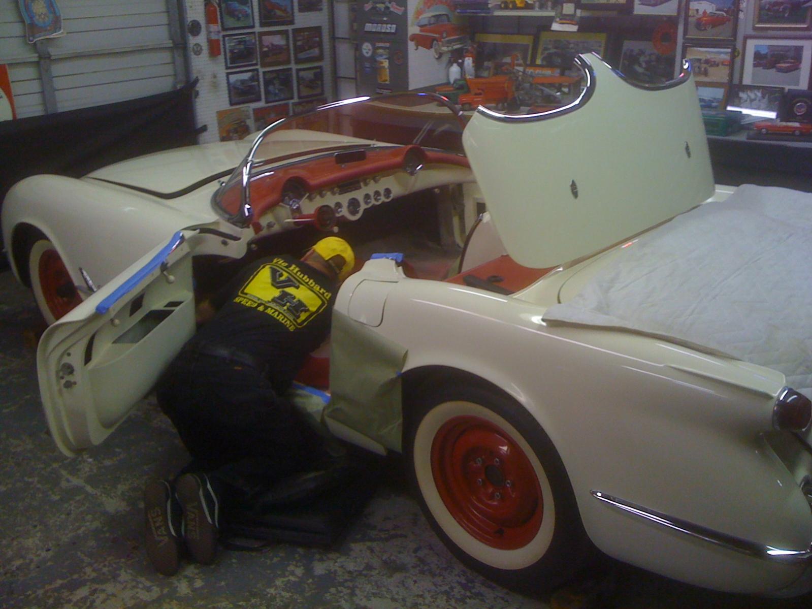

    At this point the car was getting ready for Denny to do the interior and add some of the special touches that we had in store for the inside of the car. But first I had to finish the headers and trans install. Then it would be ready to roll over to Denny booth about four bays down from the Psyclone's bay.
    First though Denny had to finish the top on the convert and finish the complete interior on this 53 Corvette. This car is going to be featured at the Peterson Museum. It's the #18 car in 53. Cool ride and Denny is doing a great job bringing it up to factory original specs.

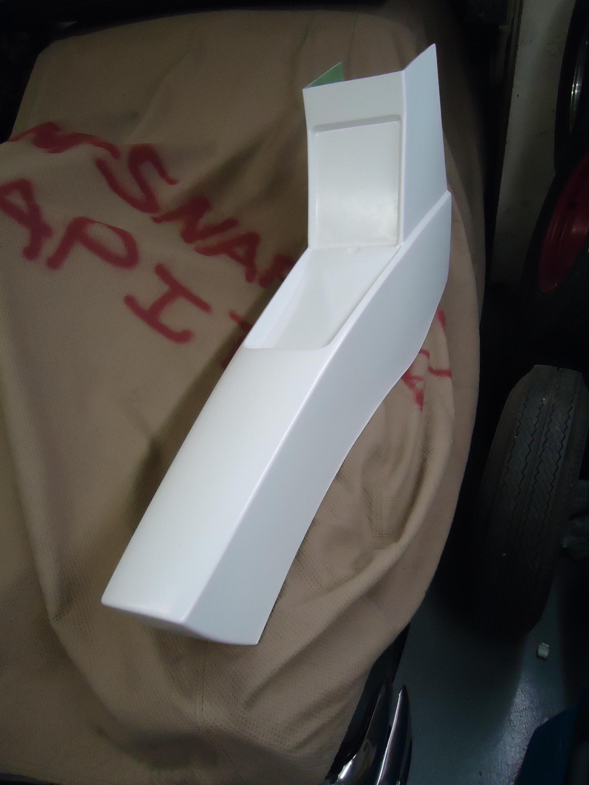

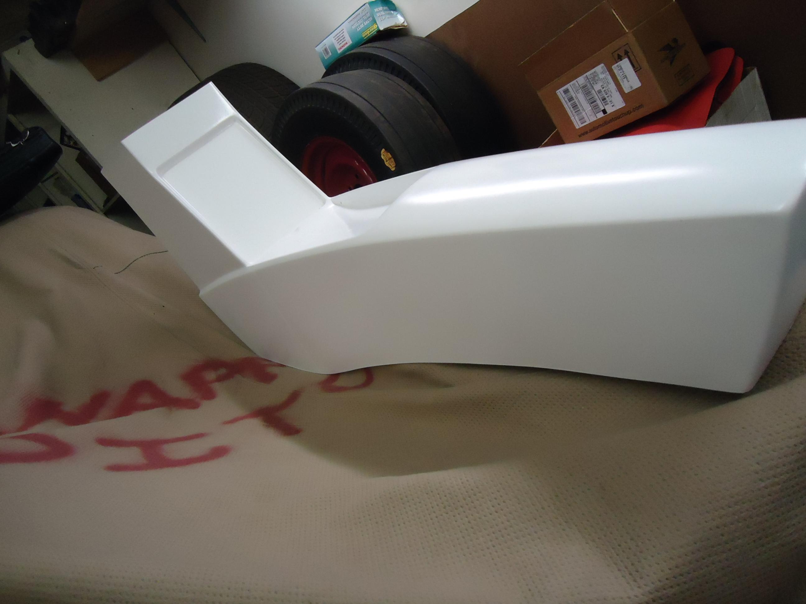

    I'll include a pic of the console we are using in the Psyclone. This will be one of those modern features though trust me its going to be VERY cool and be made to fit the car completely. Modern Classic Interiors, Mike, www.modernclassicinteriors.com did a great job of doing a custom console for us just as we wanted it done. Thanks Mike!
