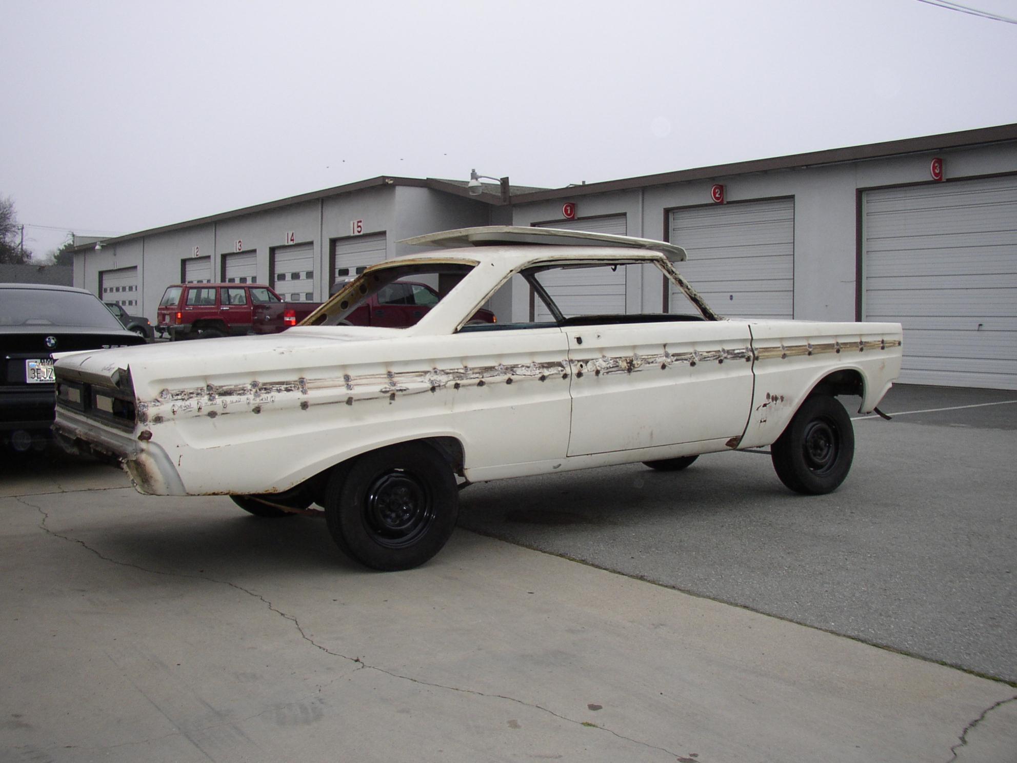

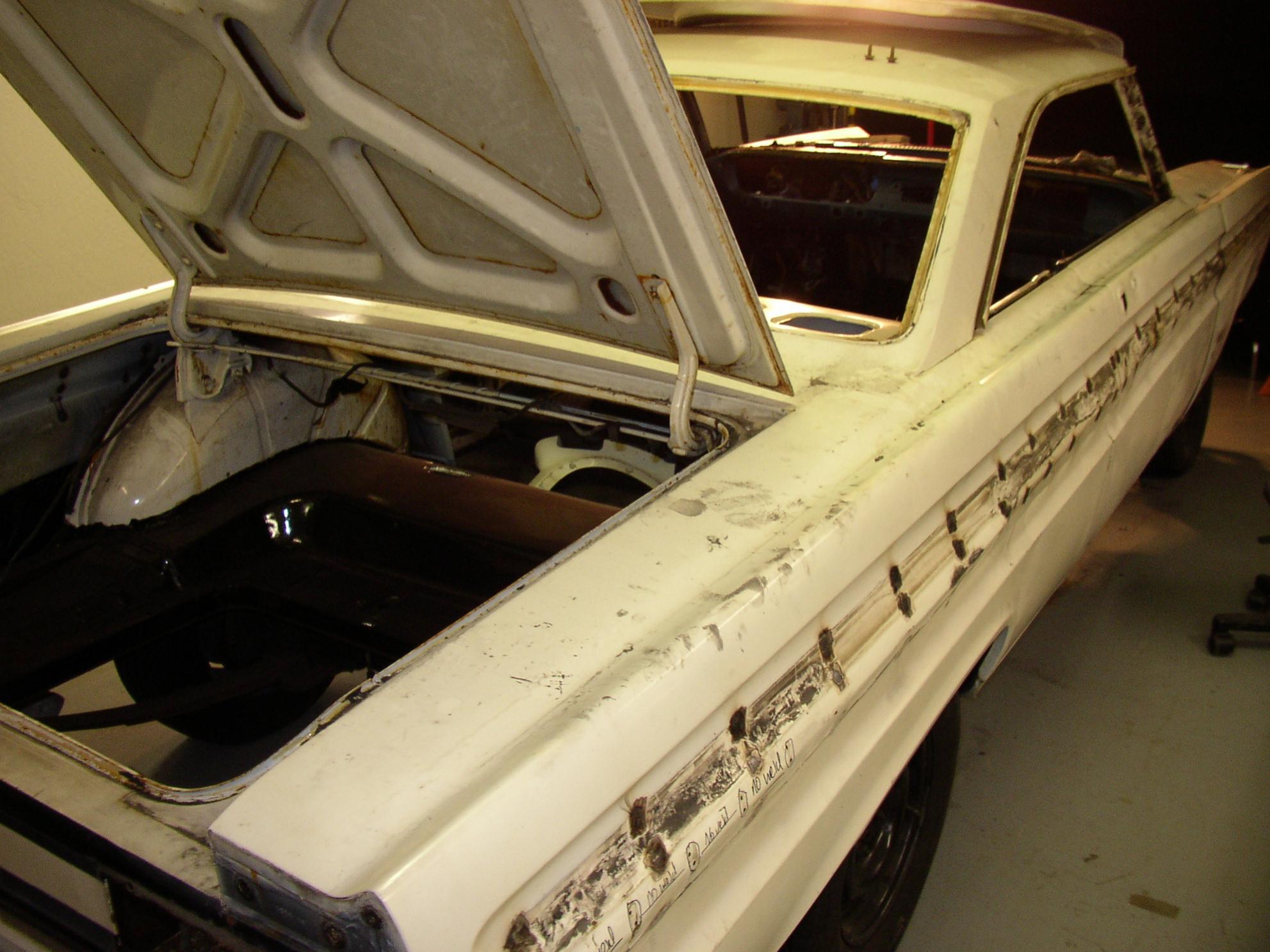

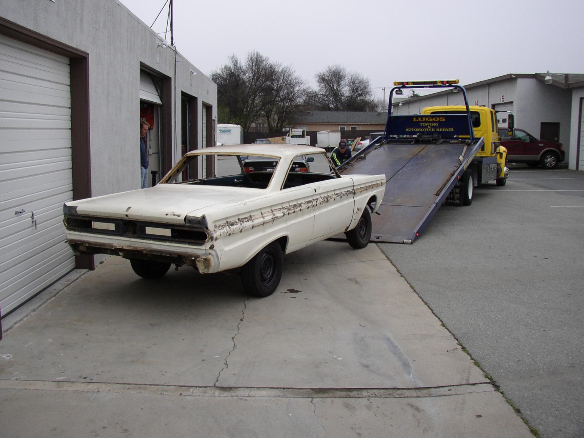

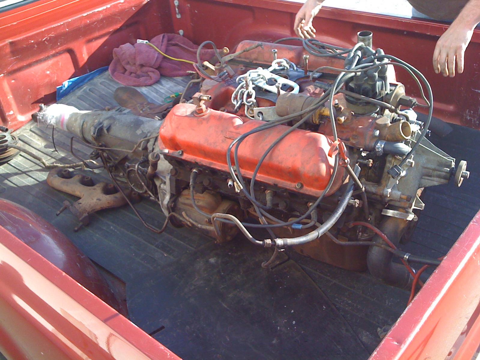

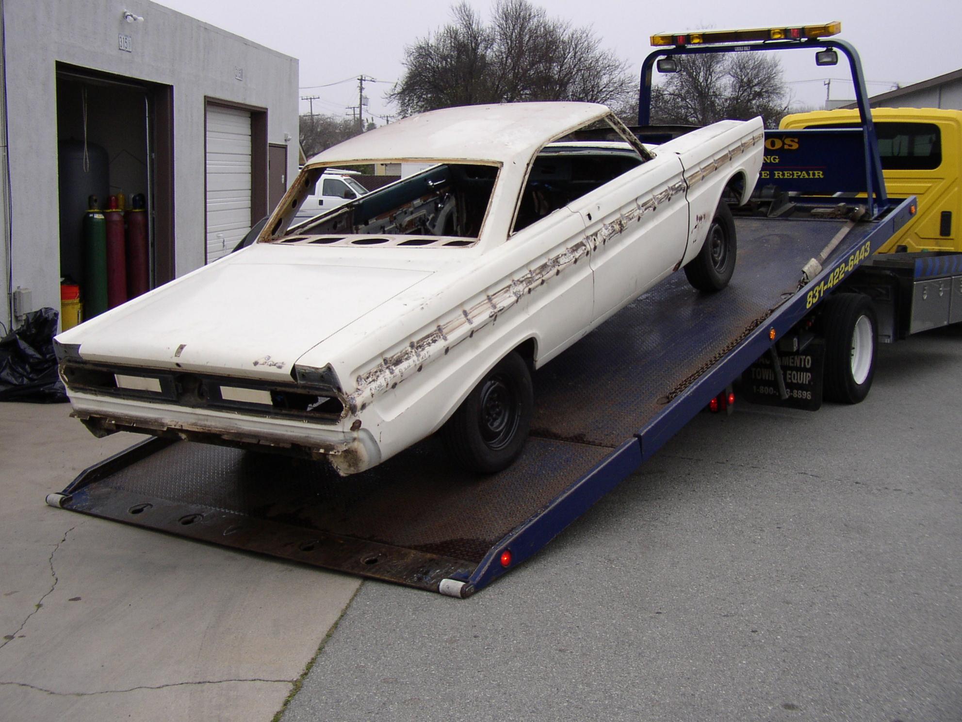

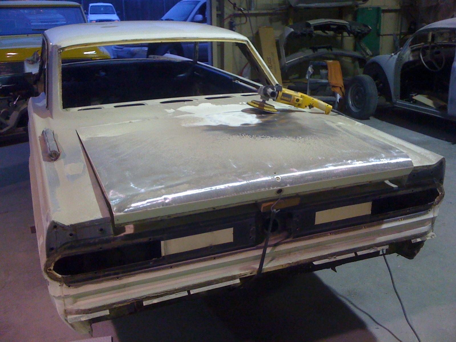

    O.K. Here is a bit of what the car has been going through recently. These pics may be a bit out of order though here they go....

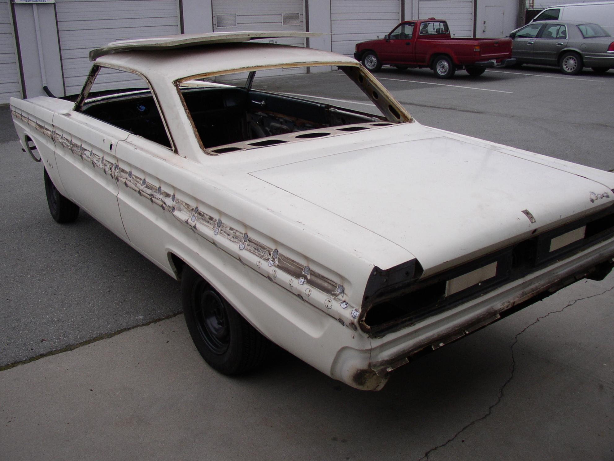

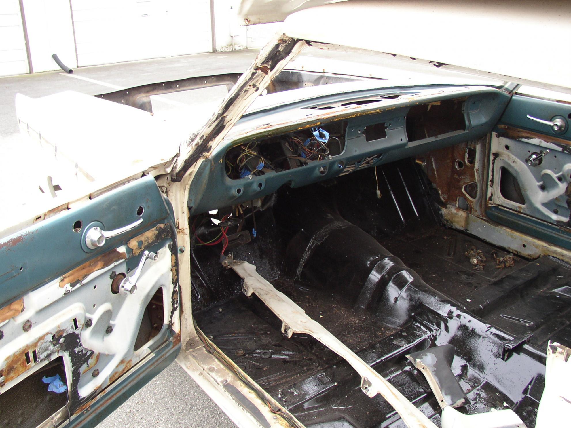

    I finished stripping the exterior trim, engine and trans, soft trim, headlight and tail lights and anything else I could get off.
    Removed the steering as well as the, side gl*** and window ***emblies.
    The car is completely naked.
    At this point I welded up all the holes that I needed gone on the sides of the car(172), its a ton of them. This process took me quite a long time so I didnt warp the sheet metal.
    Here are a few pics, i'll have to use a few posts to get you a bunch in there. Here goes..

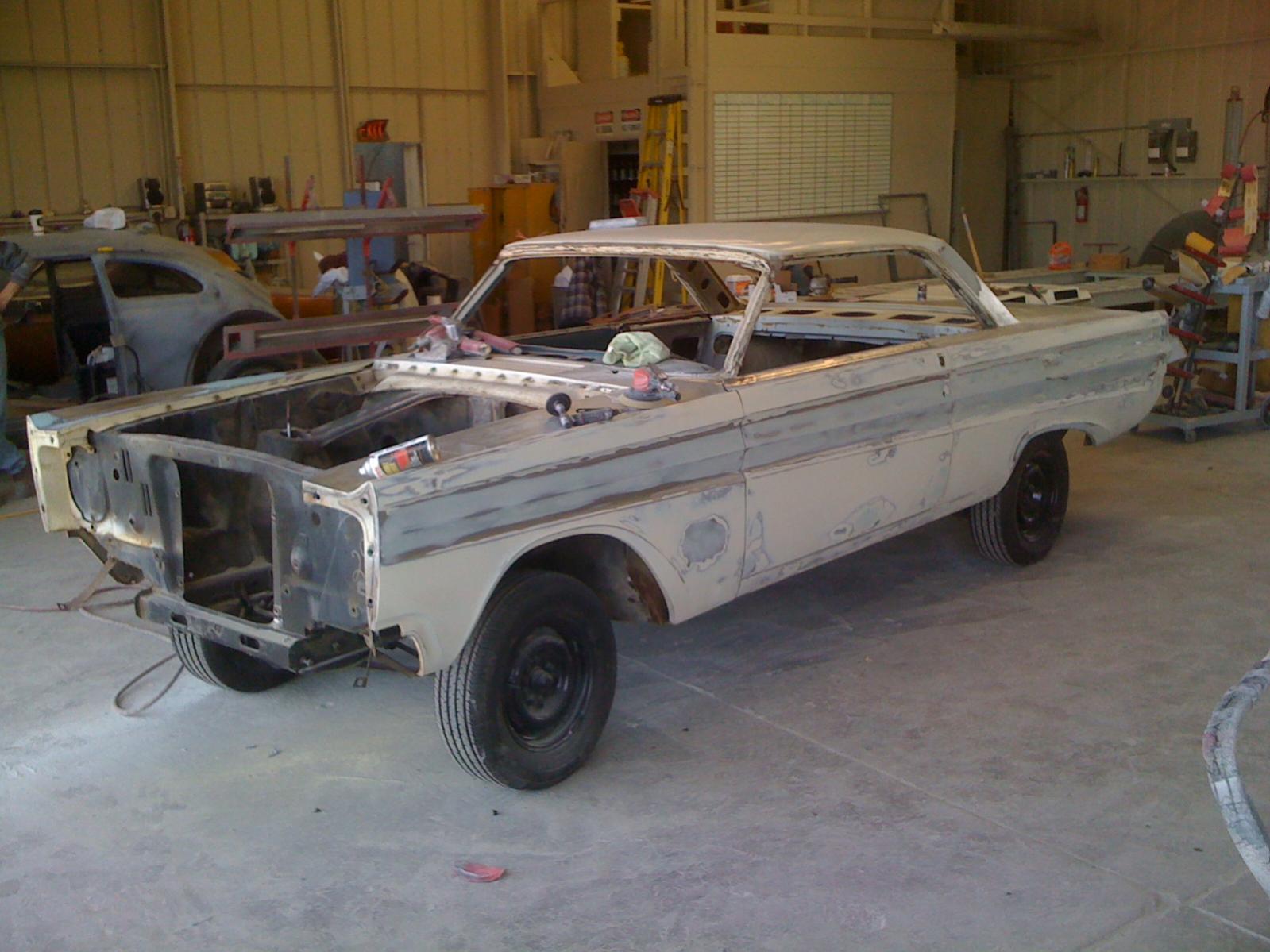

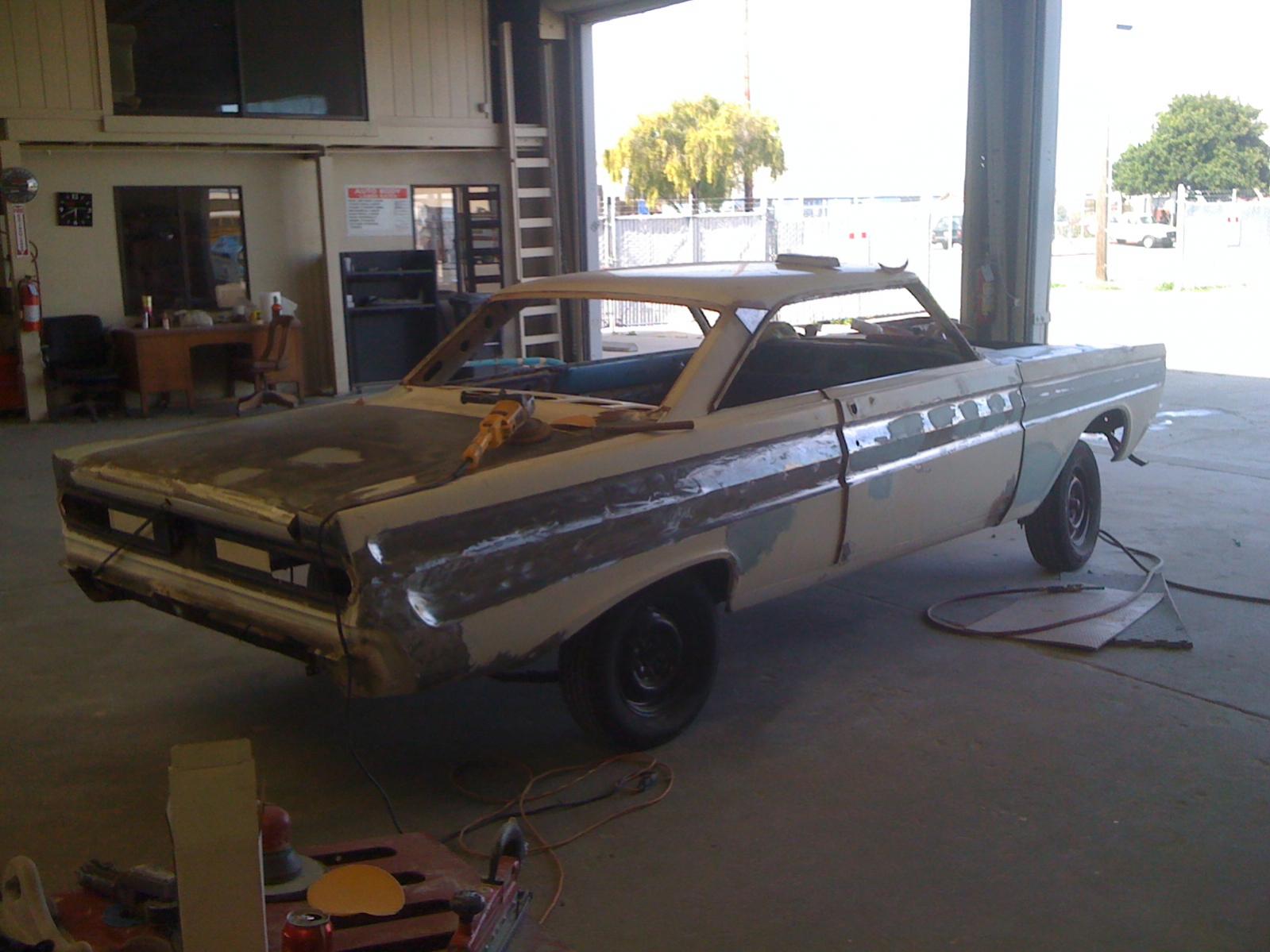

    Here is a few more from the weekend and today.......
    After we got all the goodies out of the car we sent it to the paint shop this afternoon for its new look. Psyclone will be gone for at least 1 month and should be no more than two. She will get painted inside and out as well as the engine compartment.
    While Psyclone is away i'll concentrate on the engine build as well as aquiring the components for the brakes and suspension.
    The engine will be mine to build. I have yet to get any response from the honcho's at Ford for any help on the build. SOOOOO, it looks like its up to me. That's fine too. I actually love to build the powerplants behind each of the projects I do. It makes me feel way more bonded to the project. Off to the drawing board I go, remember its gonna be something awesome that I can still drive 500 miles if I wanted to.

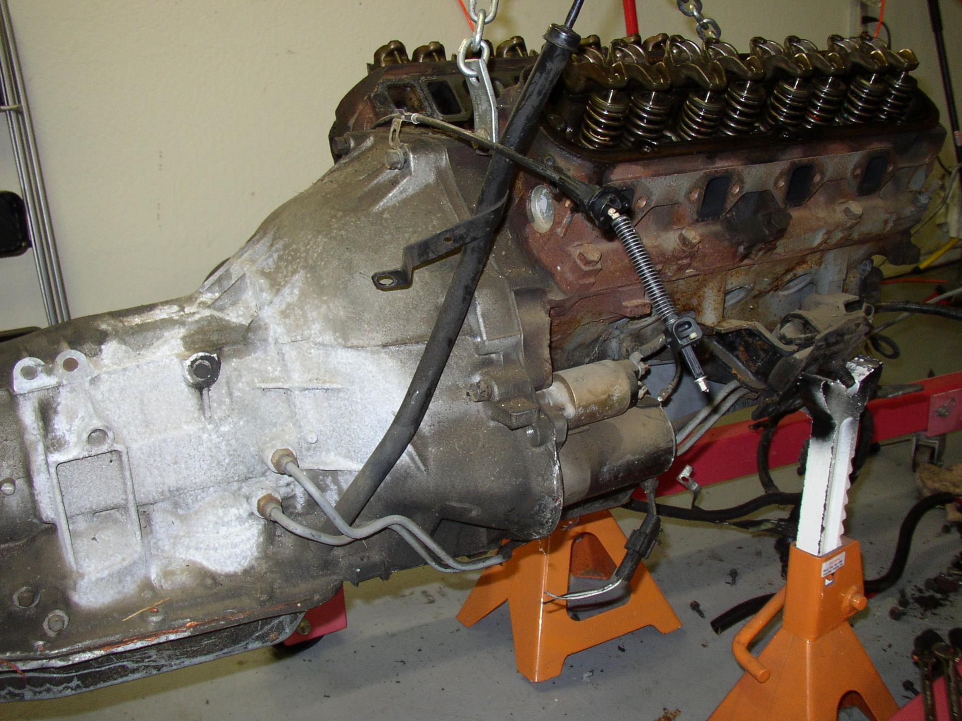

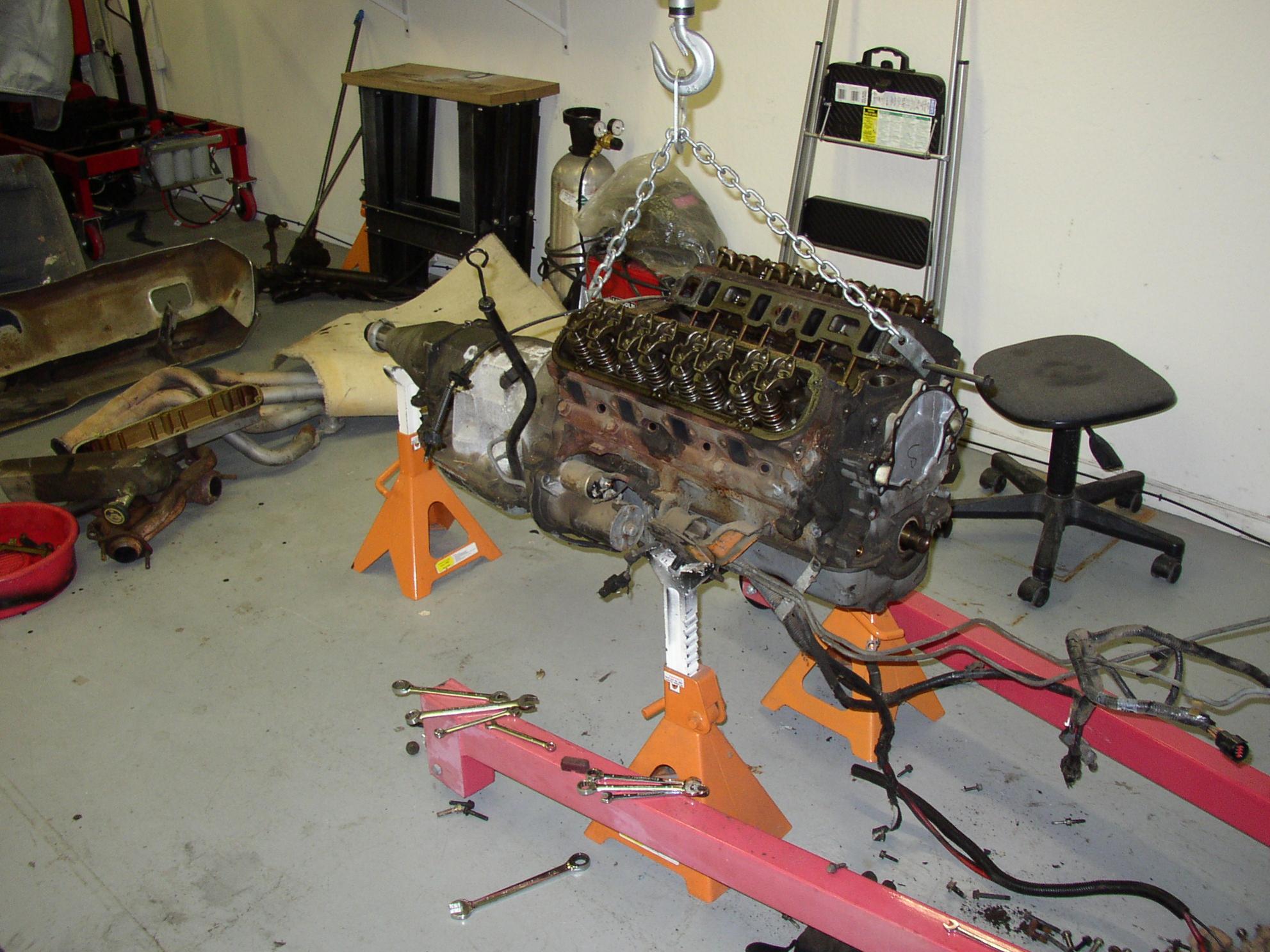

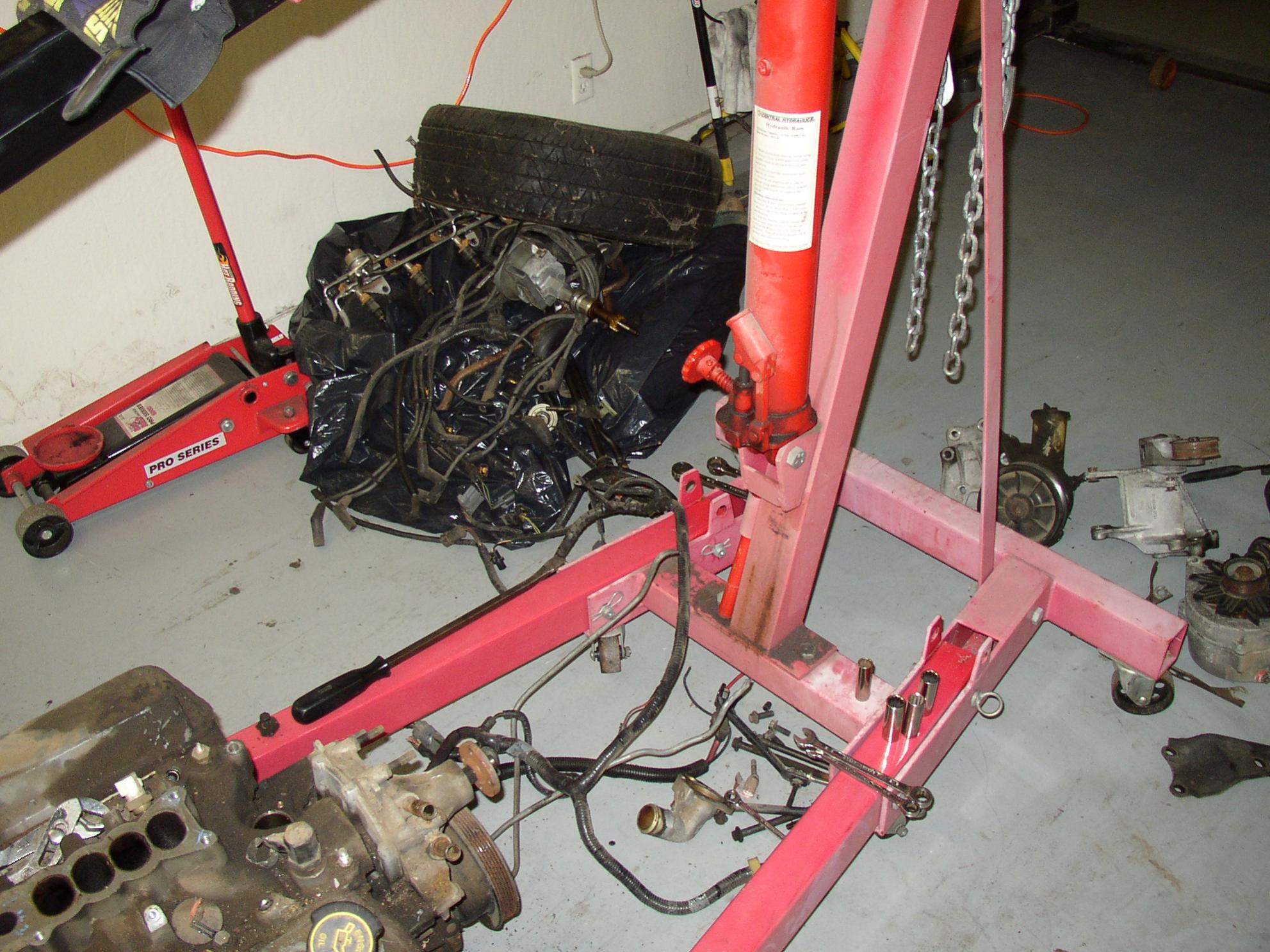

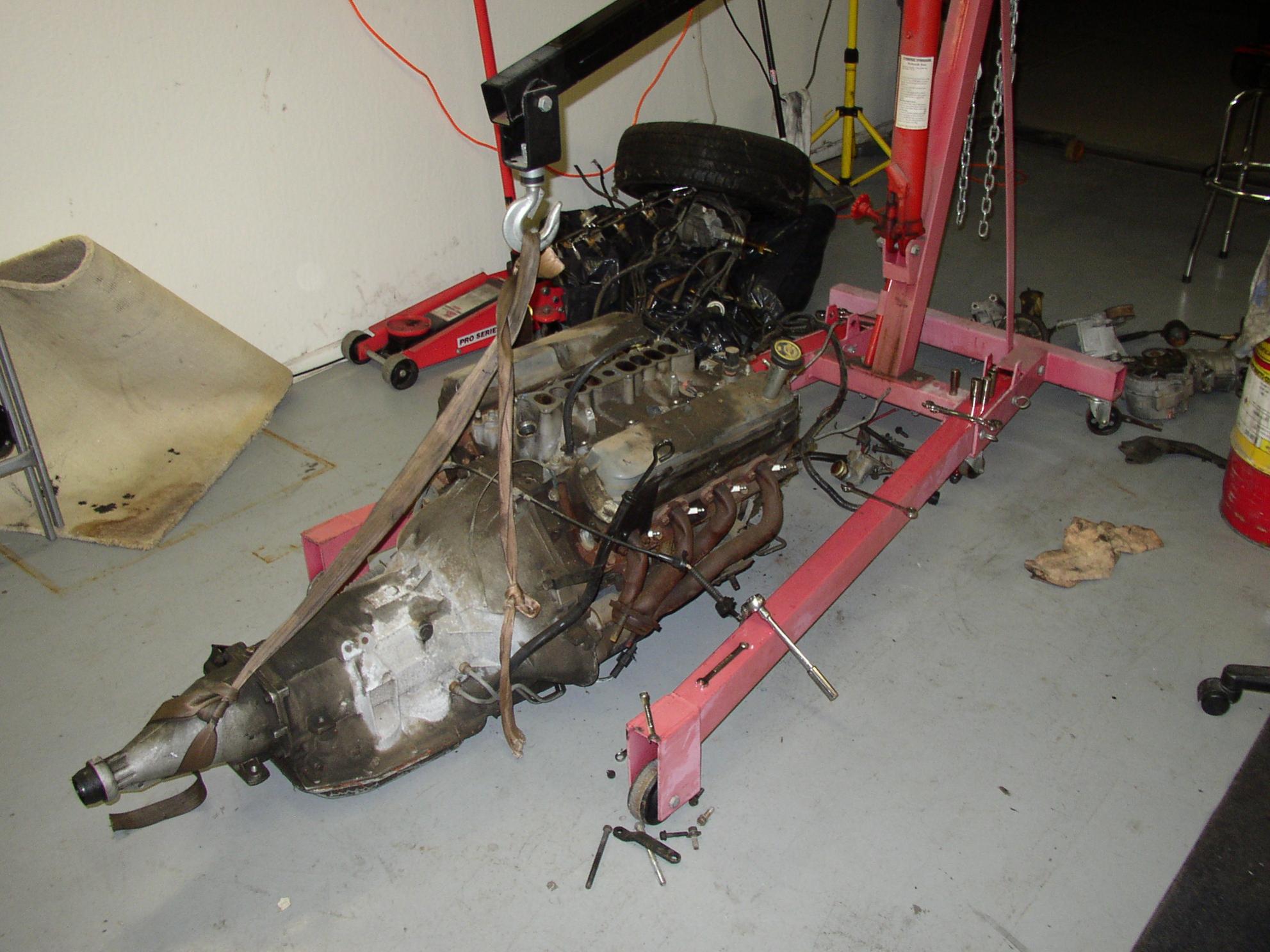

    The H.O. 5.0 is pulled down and has went to the machine shop. I should be able to get going on the rebuild by this weekend. Hoping that I have the parts by then. National Parts Warehouse, my supplier is really lagging though when it comes to getting the parts I need. Im probably going to go to SUMMIT Racing. There always really fast and good with sending the correct stuff. On the parts list is;
    Forged short block ***embly,(Inglese) 8 port (elect) injected forged 331 C.I. roller Ford with a FAST engine management system, Comp Cam custom grind, Aluminum water pump, stainless steel roller rockers, aluminum heads, Cloyes timing chain, Melling H- Duty pump, ARP hardened pump shaft, Hardened comp cams pushrods, comp cams roller lifters, MSD ignition, MSD Coil, MSD distributor, Dougs Headers - coated, Professional Products 50 oz dampner, Aluminum radiator, natural finish 120 Powermaster alt, March pulleys ....

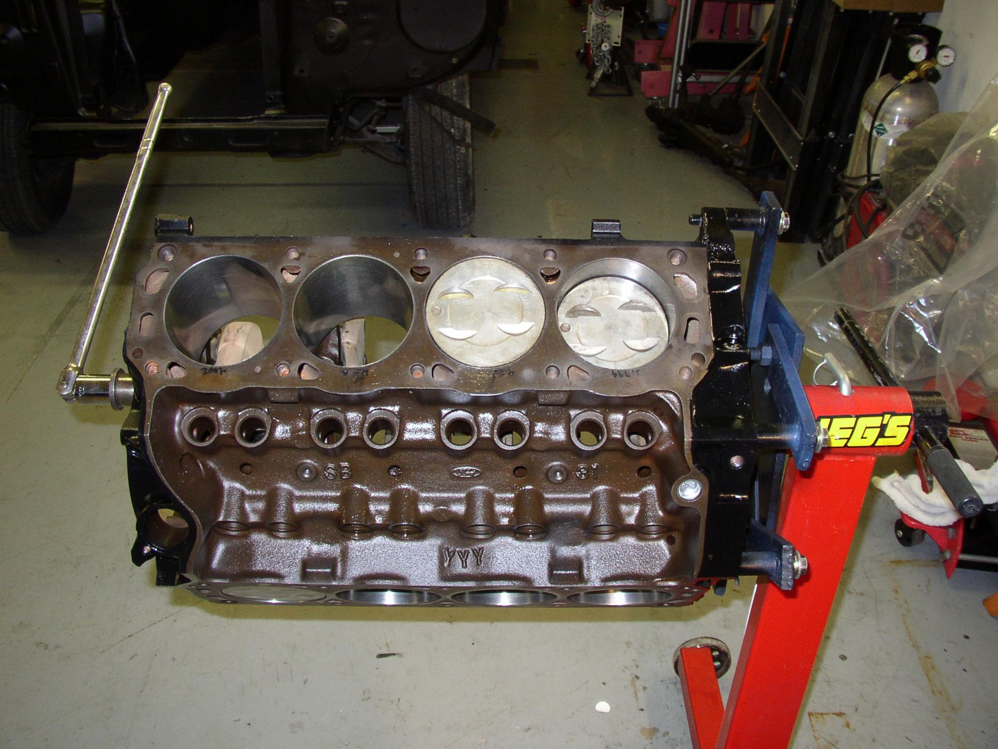

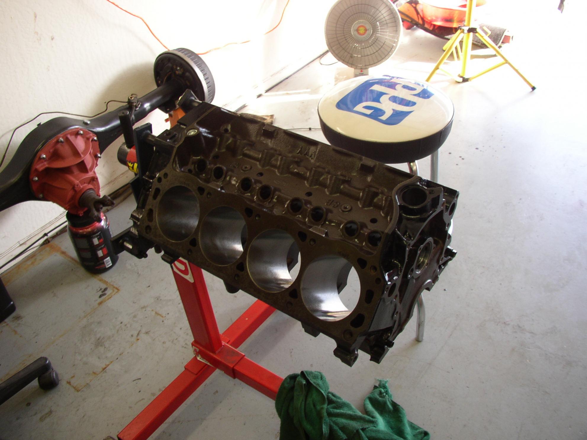

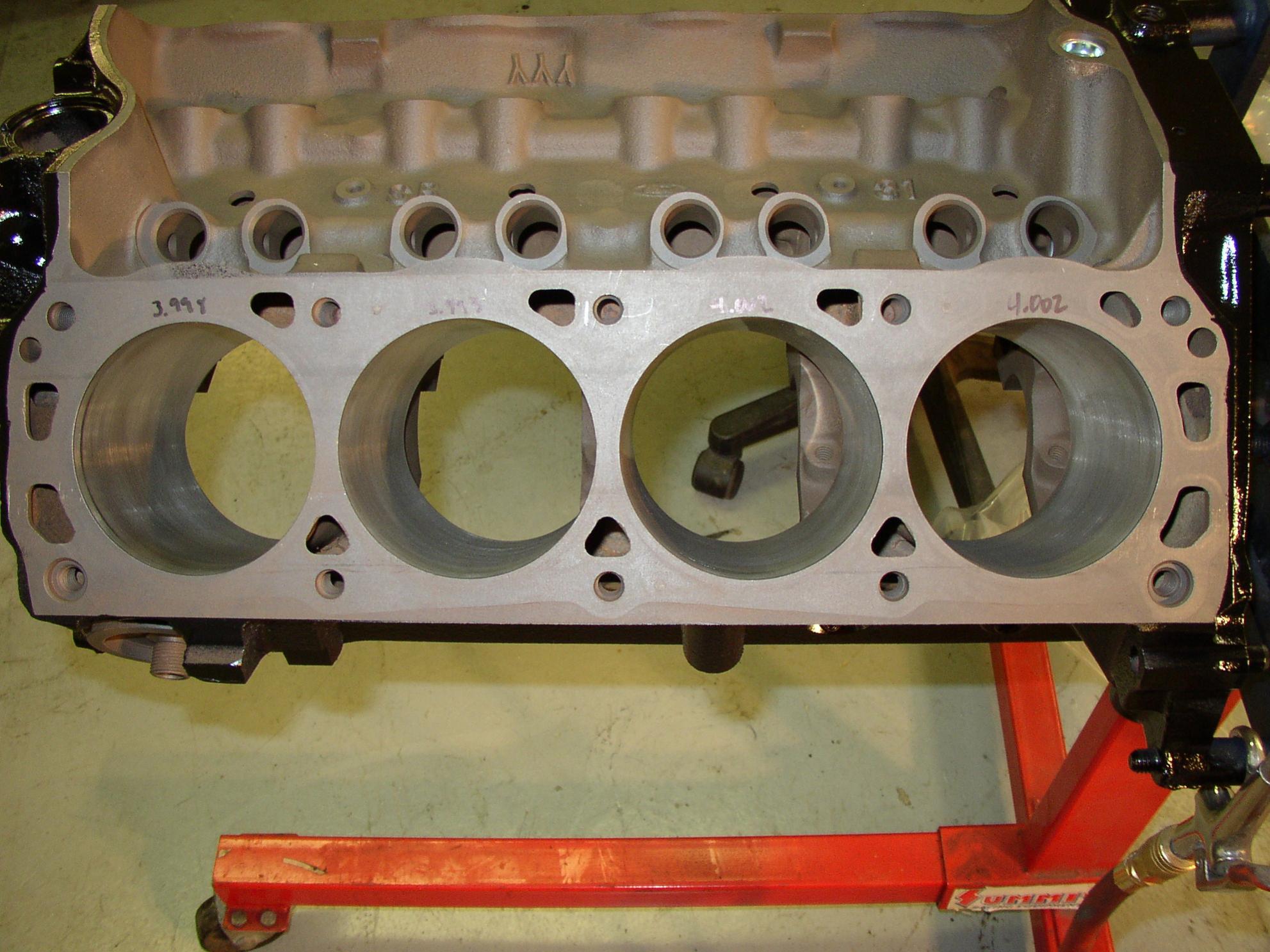

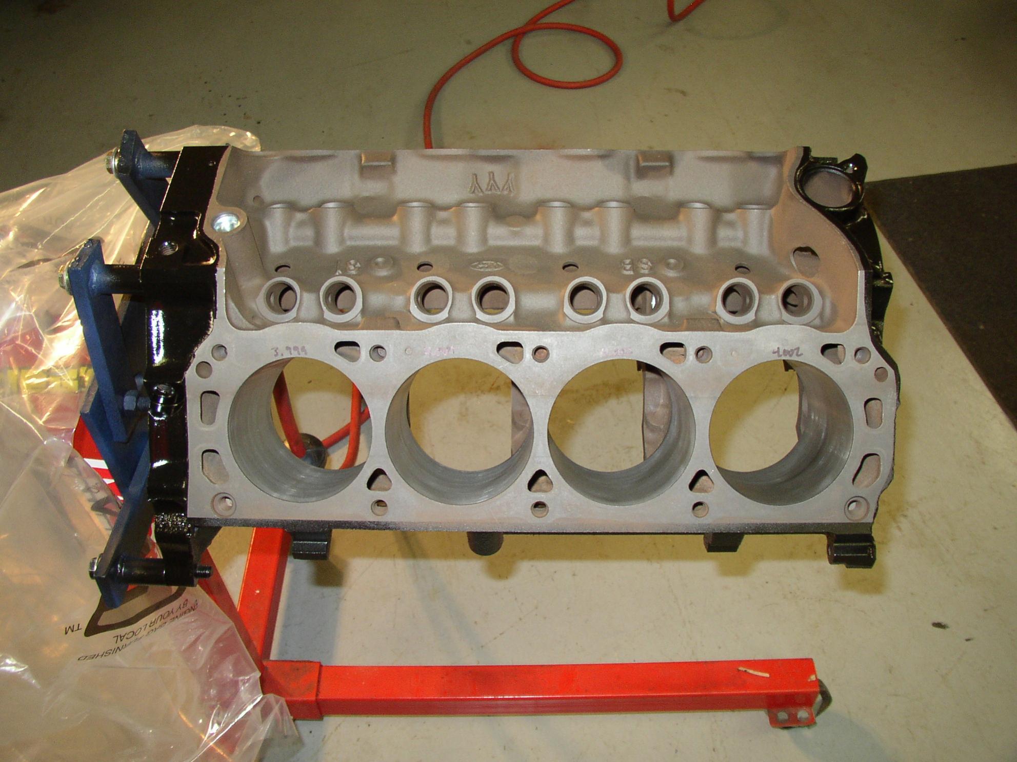

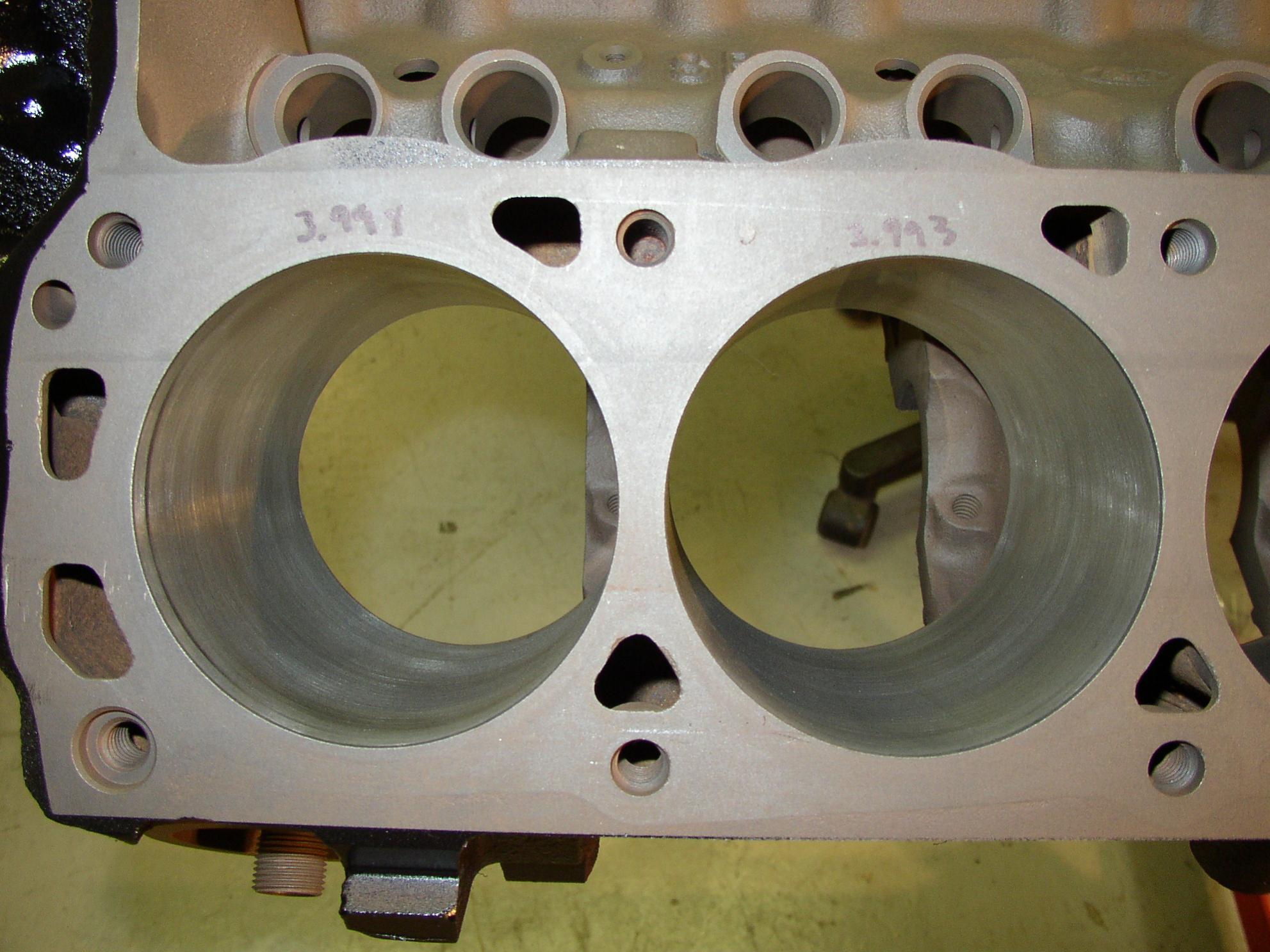

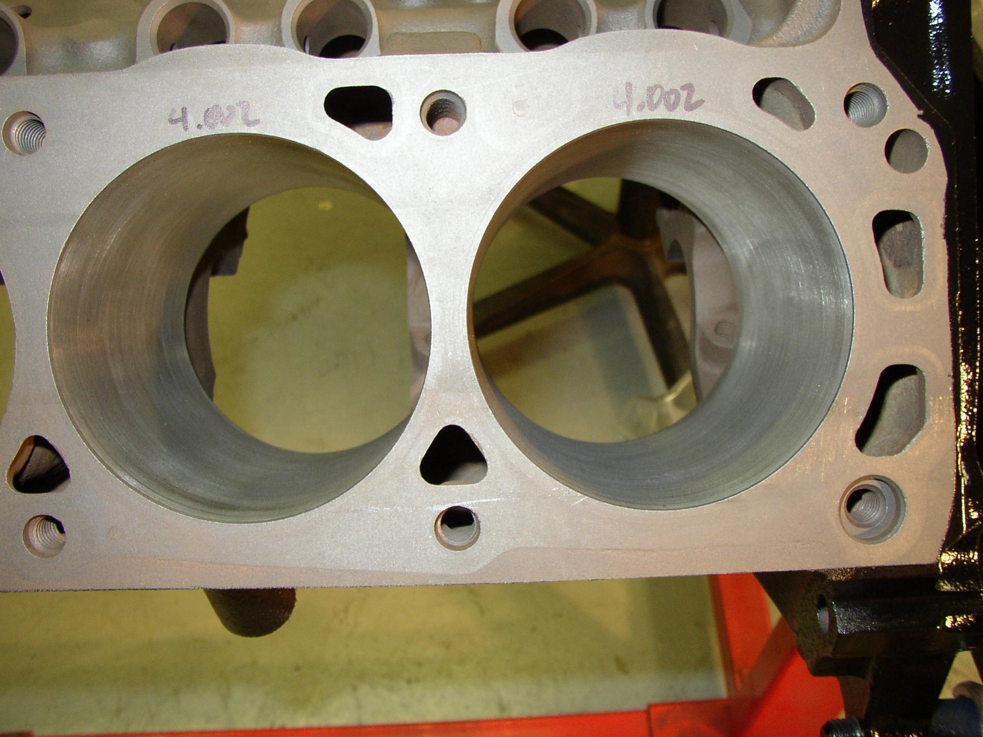

    Oops, sorry I pre-posted. Anyways, I've got the block back from the Machine shop. The little block checked out OK and is ready for my personal once over before I start to ***emble it. I usually go over all of the mounting serfaces and bearing areas to make sure all of those areas are good. I'll be checking out all of the tolerances and making sure the cleaning and reaming of the oil drain back areas I did before I sent it off are good. So that's what I'm going to do. Here are some pics of the process.

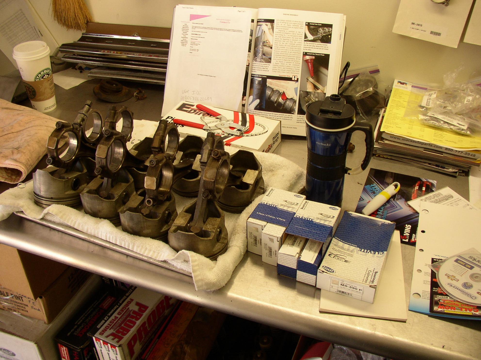

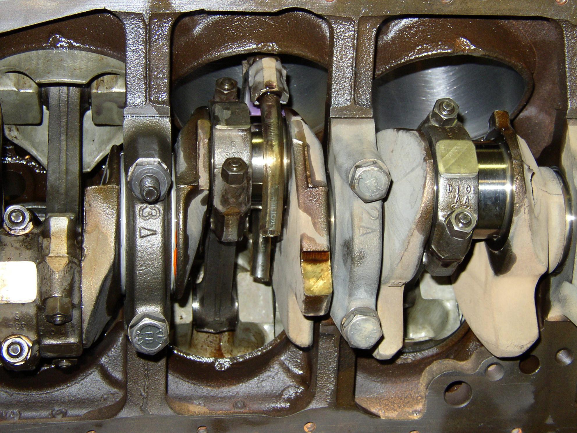

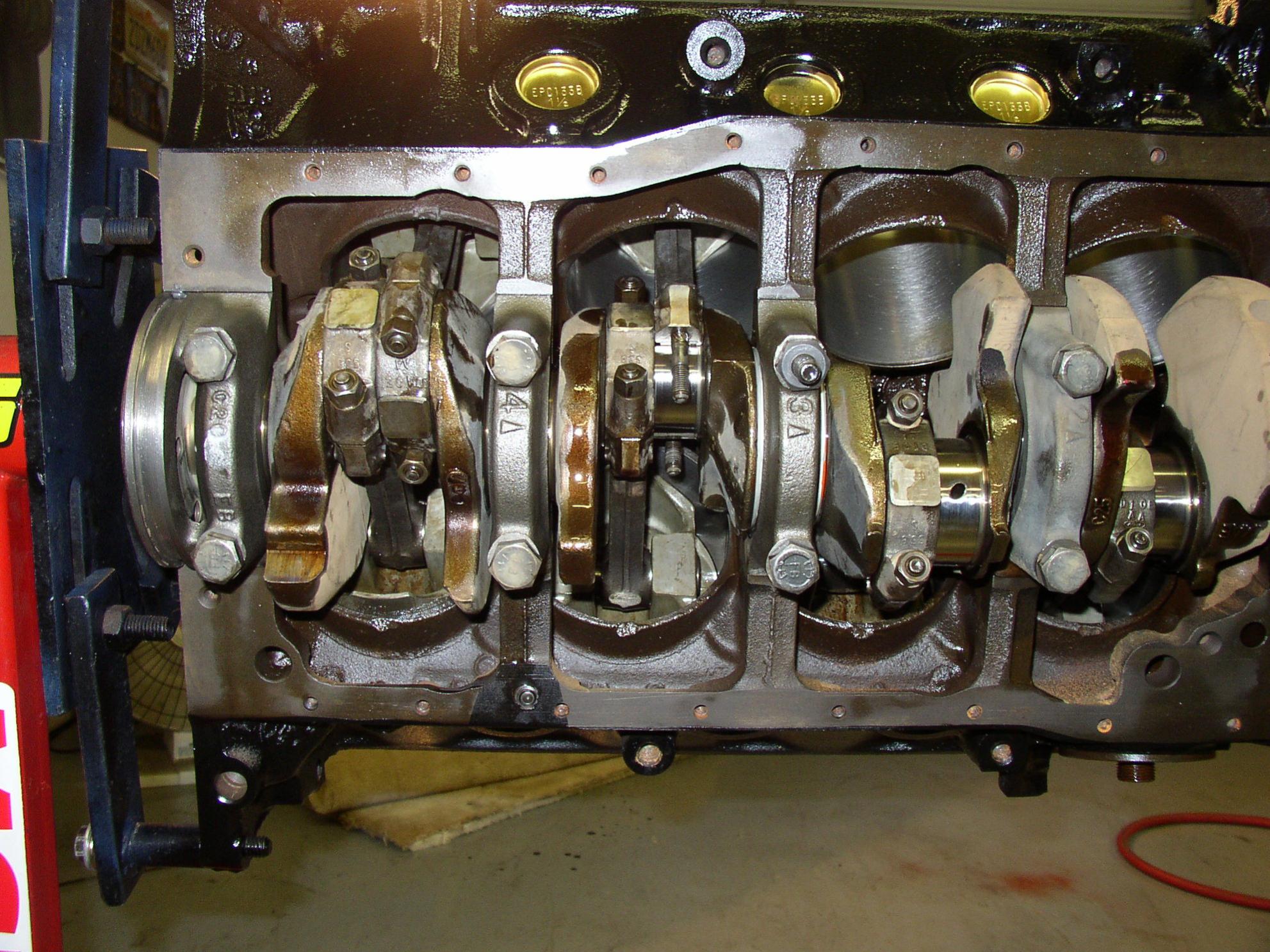

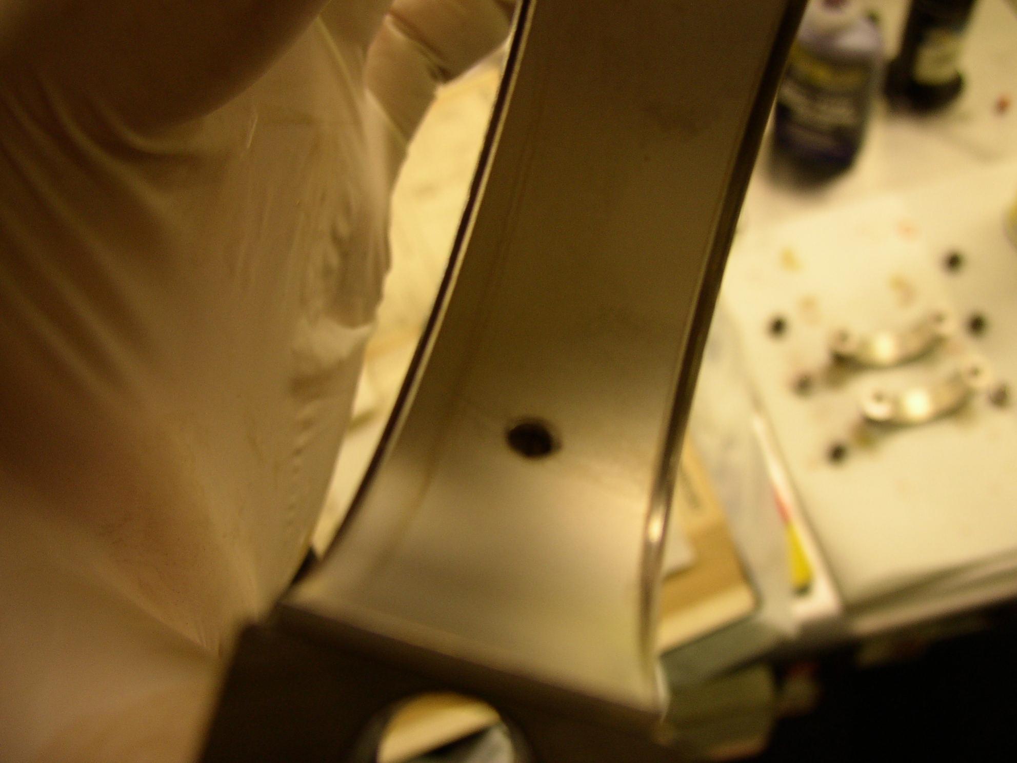

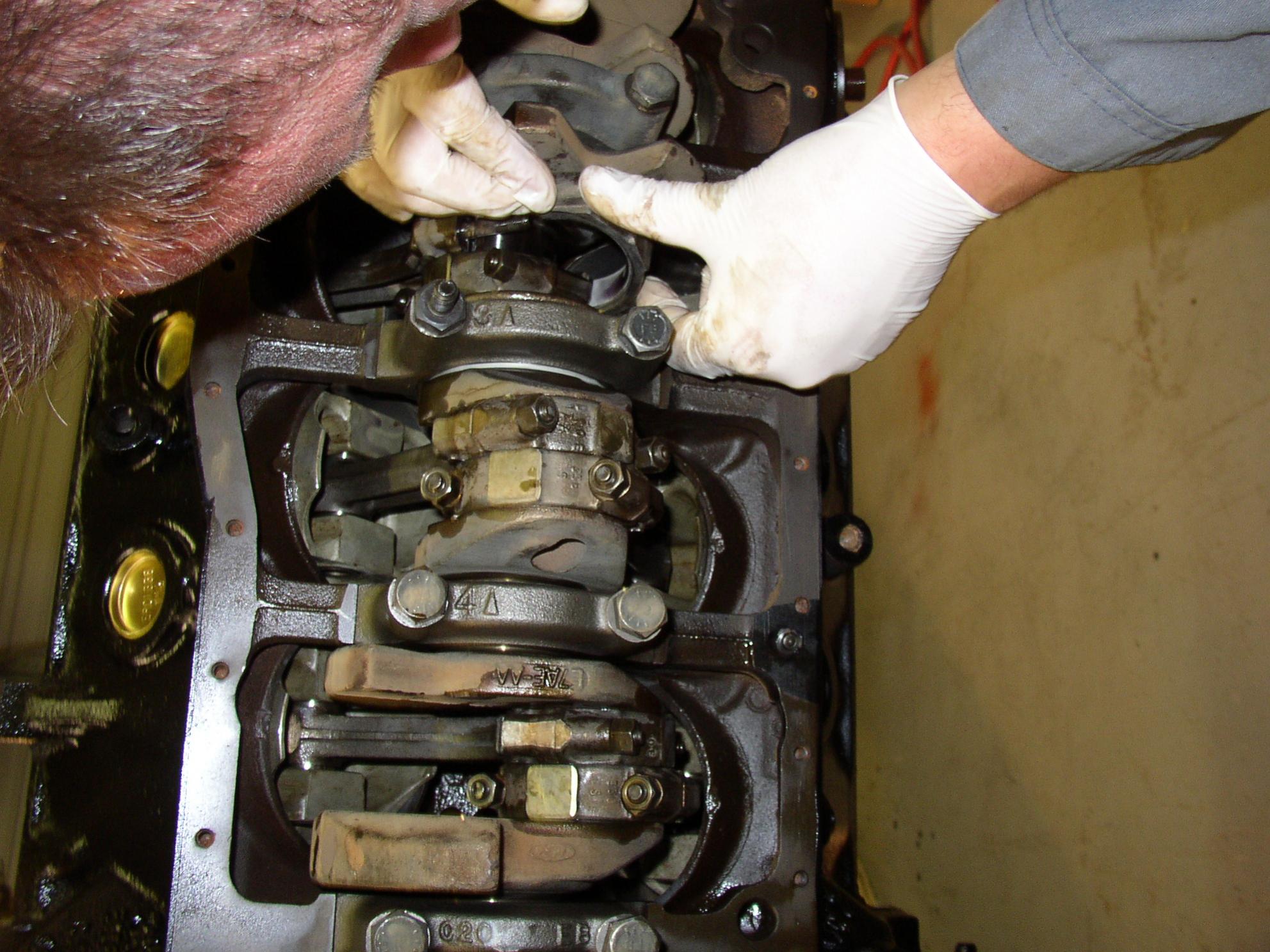

    Had some issues with the Clevite bearings once I put the crank in. It was a bit to much drag as I rotated the crank. That thing should be very effortless when it rotates. Made sure I put the bearings in the correct way, yep , good there. Ruled out and issues with the crank journals. So I had to get some new bearings sent over. There went three days on the build.... Just got them late today. I'll drop them in tomorrow.

    The engine short block is together. The bearings seemed to have machine flaws in them. Though my supplier didn't want to replece them so I just pomied up for new. I stayed with Clevite because they are a great company. Everyone has an off production issue now and then. The new bearings went in perfect. Now its time for heads and the rest of the top end. I'll post picks of that process too as I decide, so very soon.

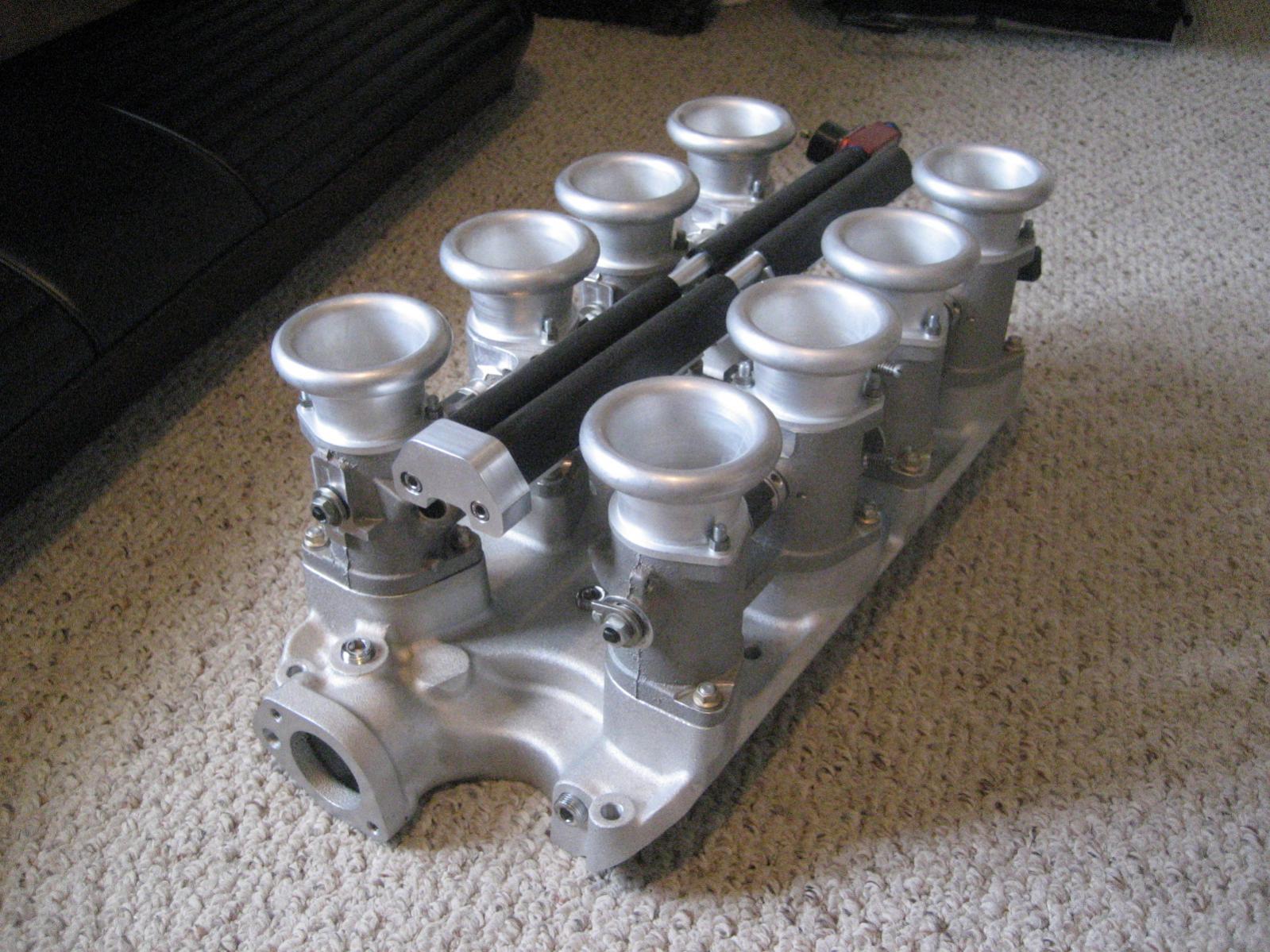

    Here is the actual manifold I will be placing on PSYCLONE. I LOVE IT AND CAN'T WAIT!
