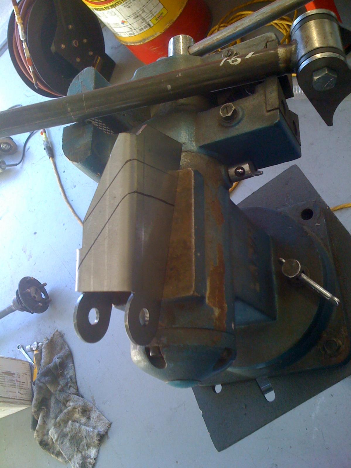

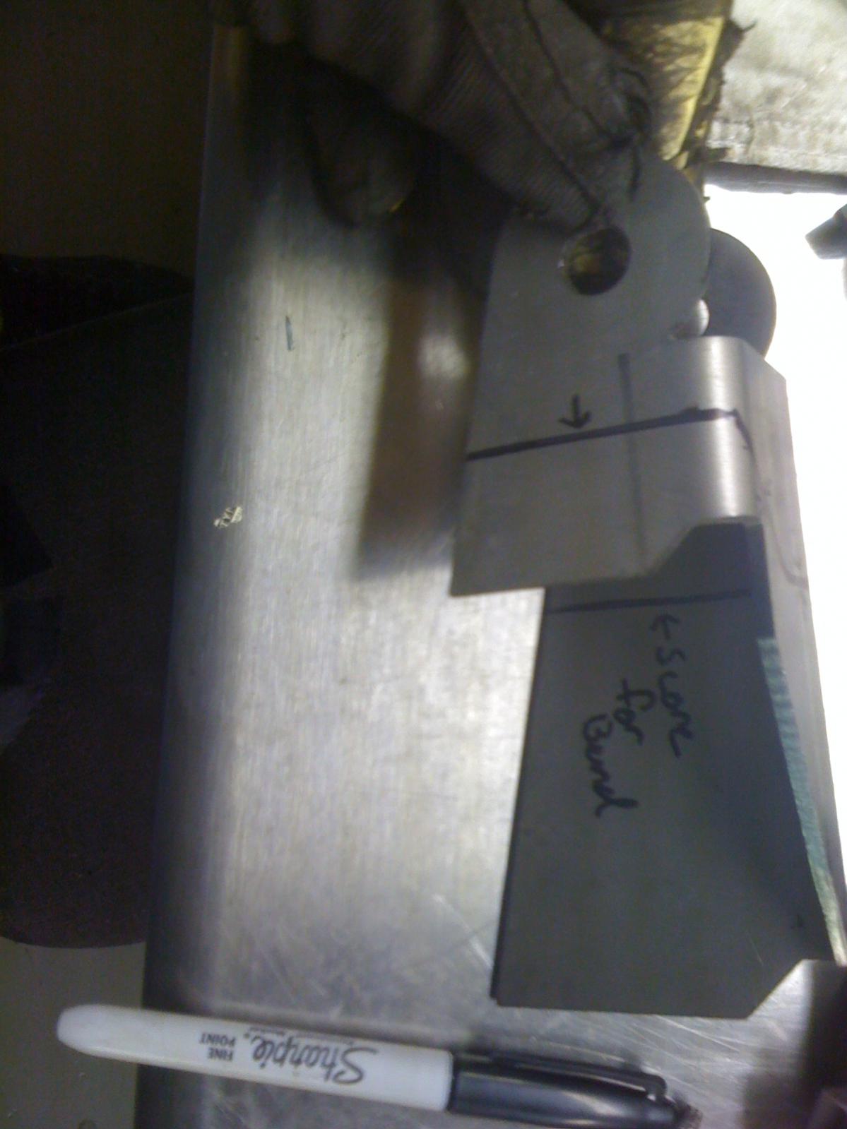

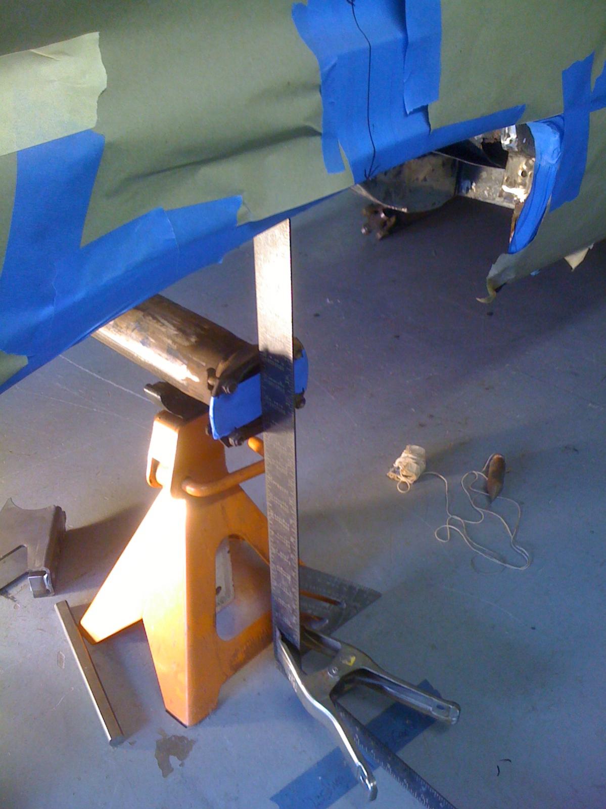

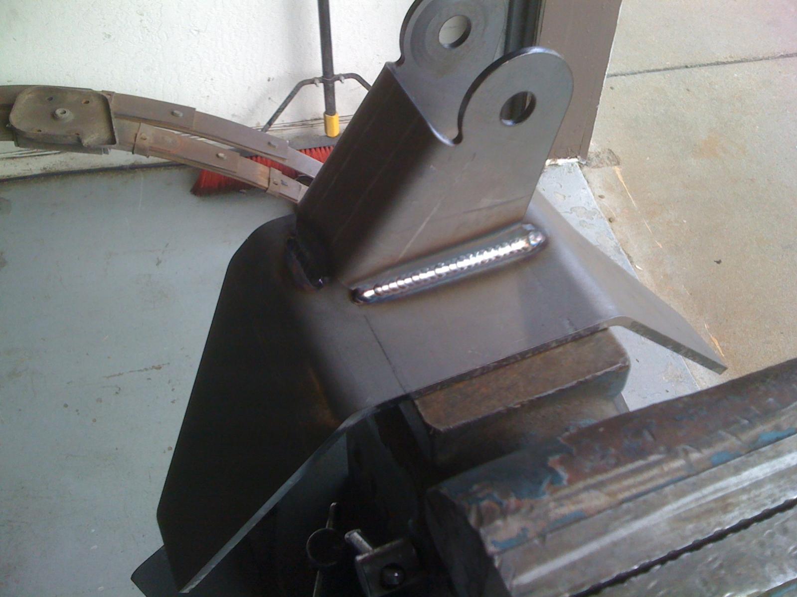

    Here's a few shots of us using the Welder Series parts and making them fit the proper dimensions for the Comets unibody. We had to chop quite a bit from the units and reform some of them extensively. But thats actually a plus with the Welder Series components. You have enought to do this and make it all custom to your application. Just remember to measure twice and cut once.
    Attached are some pics from quite awhile ago when we pulled out the rear suspension of the car and set the junk yard sourced Ford 9" in the car. We had to accomodate for the car being slammed and laying the driveshaft in the trans tunnel. So we offset the pumpkin and at the same time set the pinion angle so the universals will lubricate and move through the suspension travel angles correctly. More on that later.
    Also here is more pics of the inner frame supports rough welded in, again, welding on galvanized*****s. Make sure you clean it the best you can.
    Total Perf-

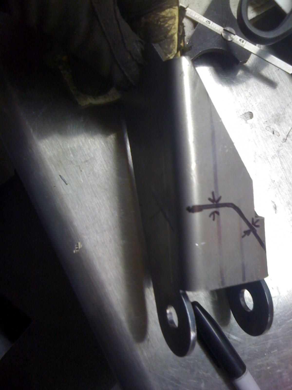

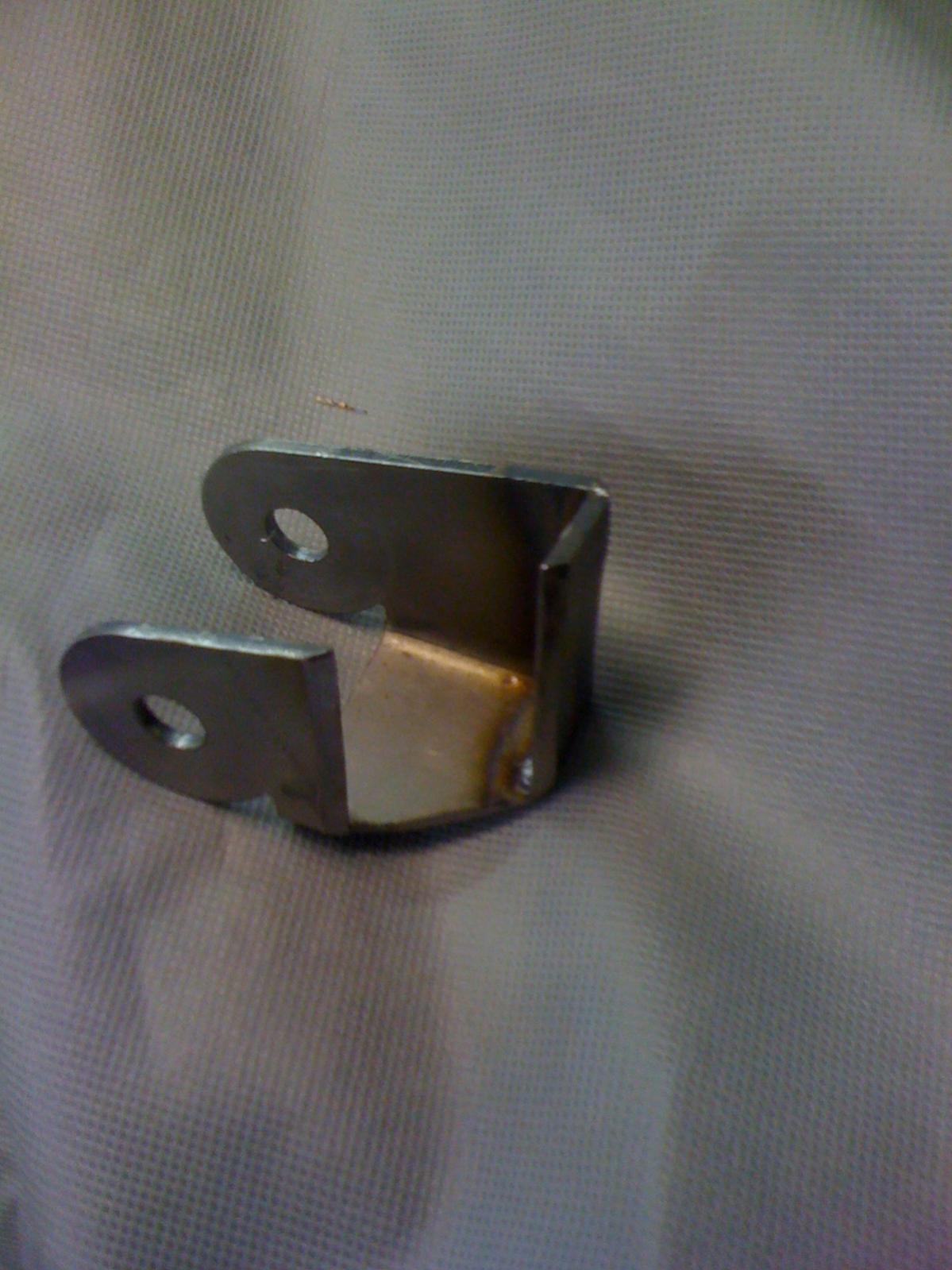

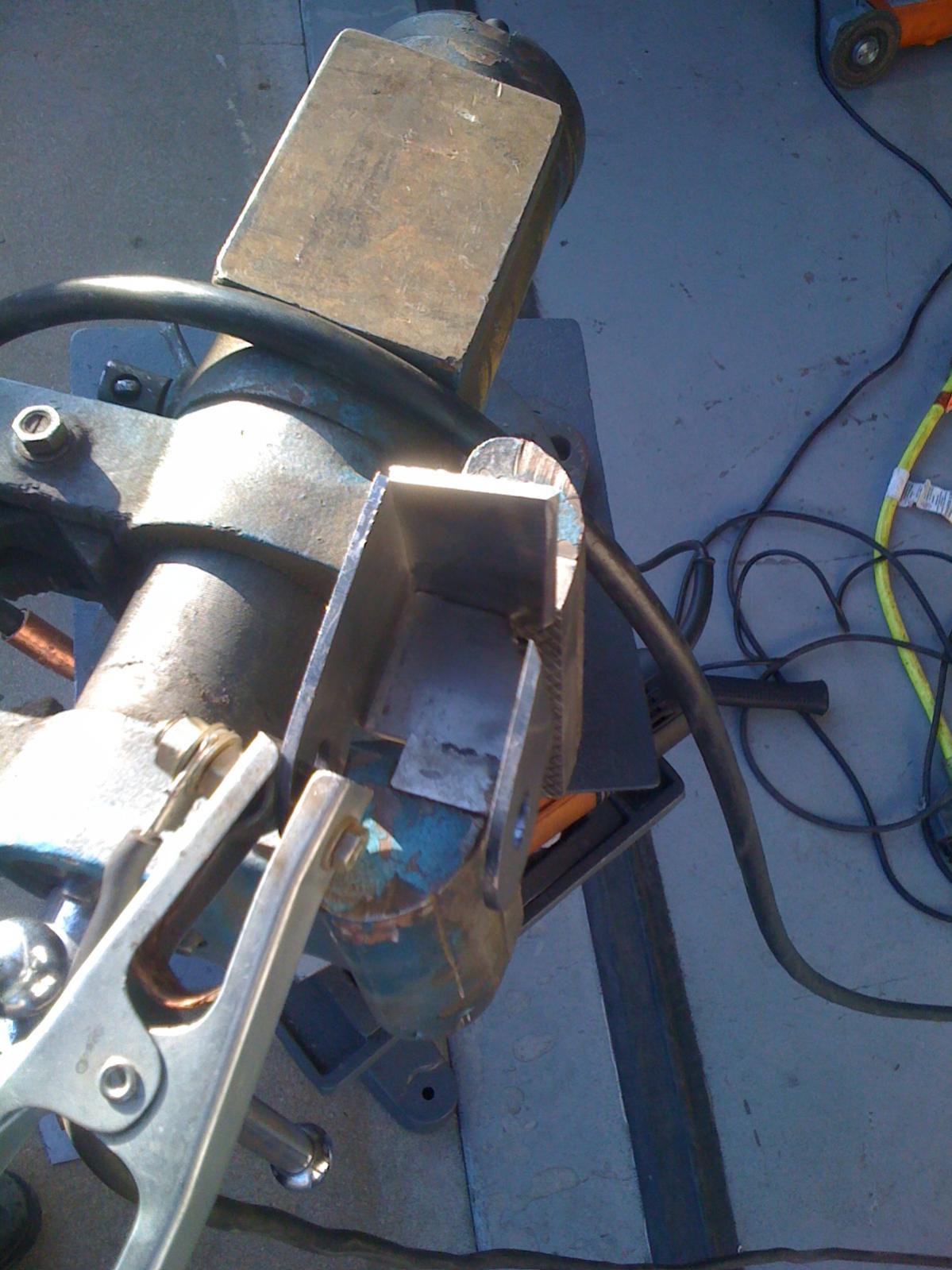

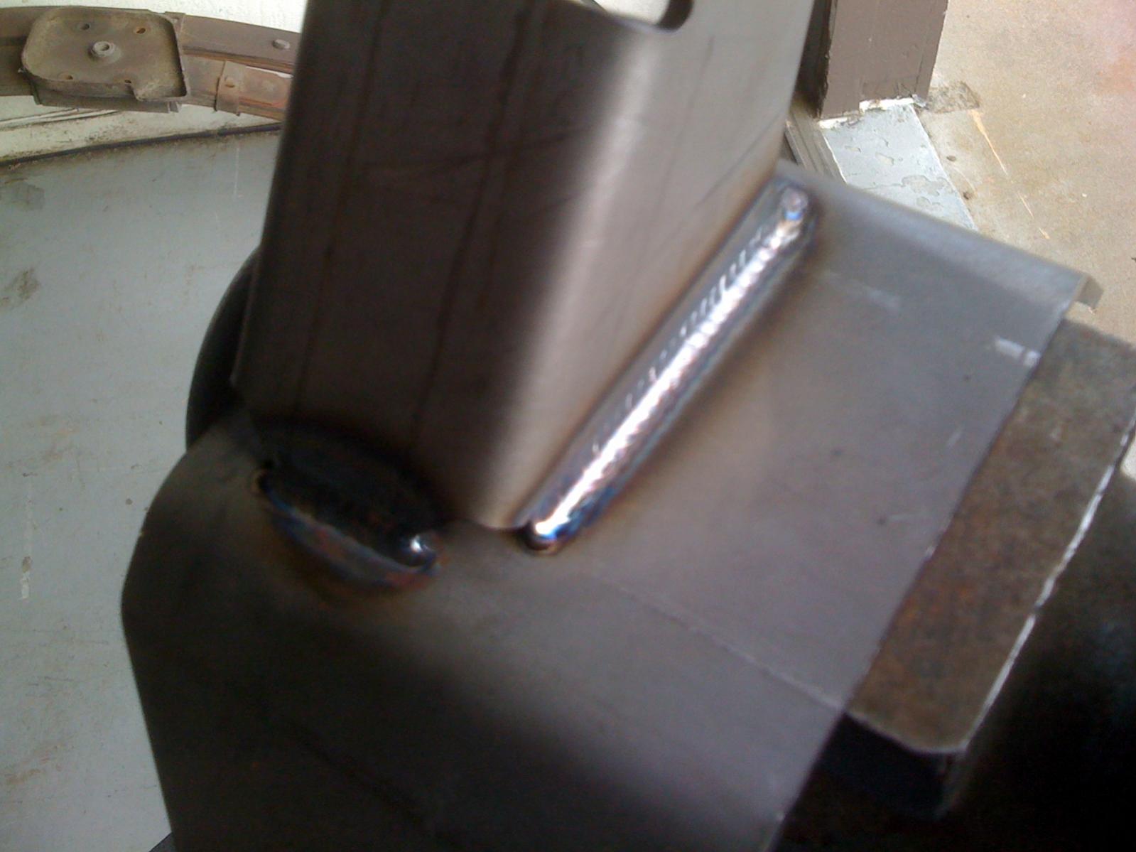

    Total Performance
    from Nor Cal

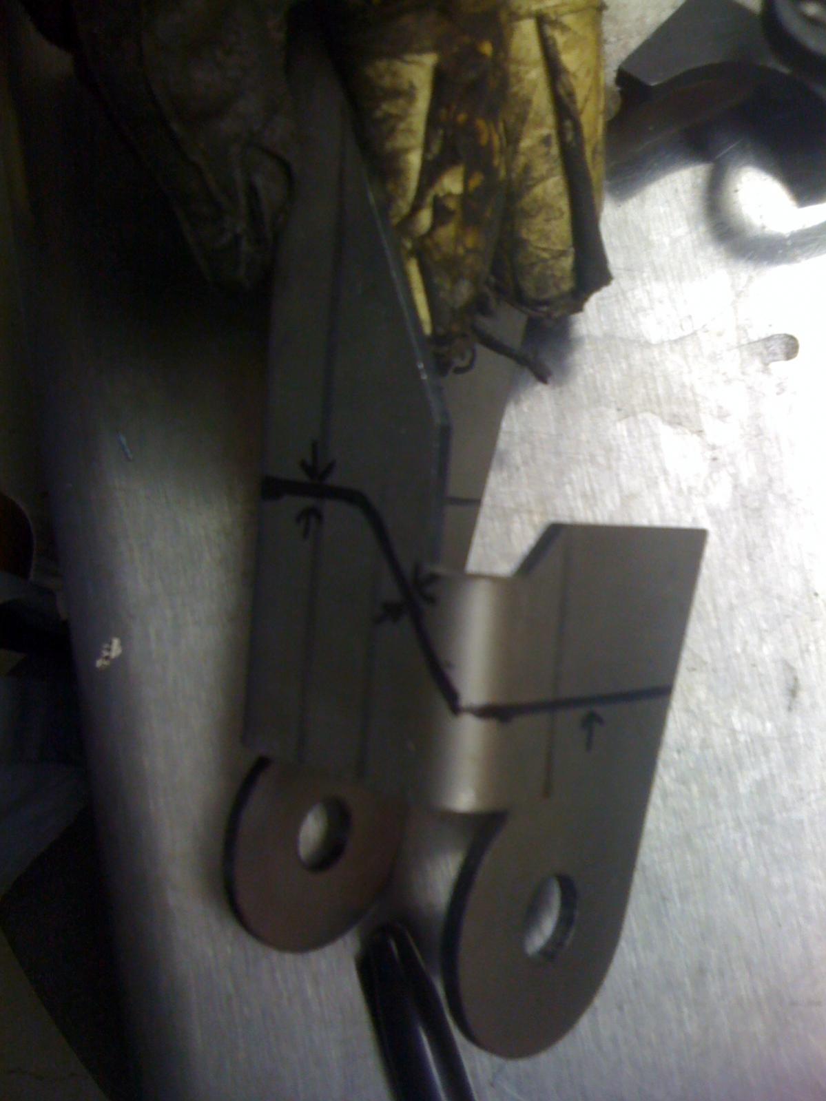

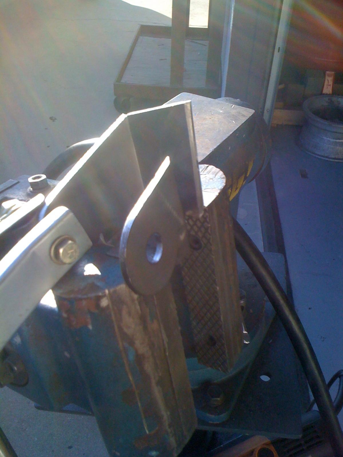

    After the rear is set in there, and my "imaginary" lines from the trans to the third member are calculated we were able to establish where the mounting tabs on the frame boxing supports will be welded to hang the suspension. After that we found the angles that best worked for the car and started to trim the Welder Series components to fit. Sounds kinda easy but it really took awhile to make sure its right. You may have noticed the blue tape all over the car and floor. As well as all of the writing on the ground. Those are all measurements to get the car going down the road straight and the suspension to work correctly. Im old school in this respect. I do all of this off the lift or rack, this is done on the part of the shop floor that is laser straight and if there is a mistake than I know it was most likely mine, or........Matt's. Yeah, Matt's, thats the ticket.
    Anyway, here are the pics of me chopping up the awesome Welder Series components. Great stuff here guys and they are HAMBers, so they get it.
    Total Perf-

    These are the bottom bar mounts that go from the frame area under the torque box area to the bottom of the rear end bracket. You can get these as pieces or as a prewelded unit, we actually went with pre-welded and then as usual we had to cut them apart, modify and reweld them. We cut a piece of the inside mounting area down and moved the mounting brackets in. Perfecto!
    Total Perf-

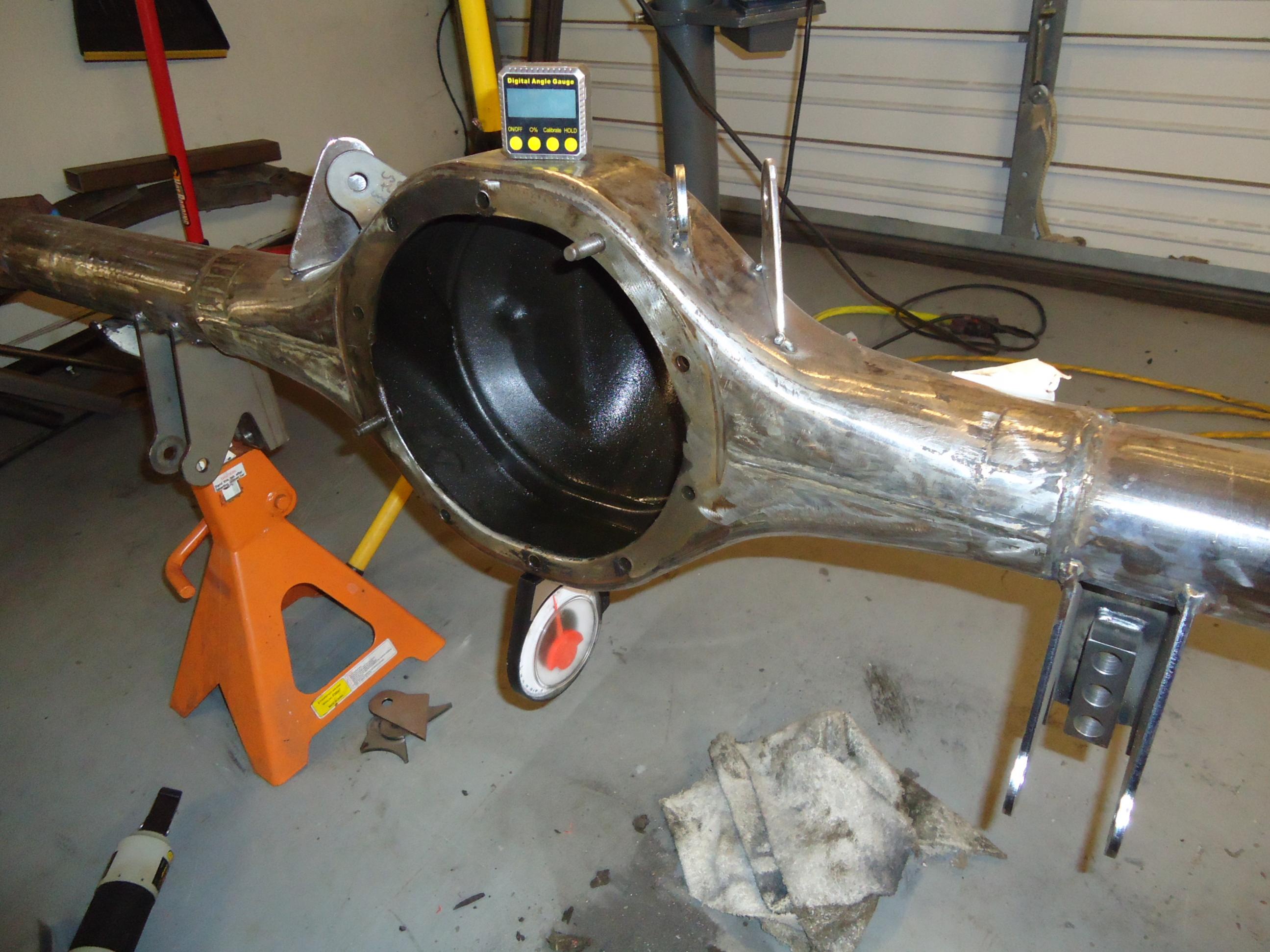

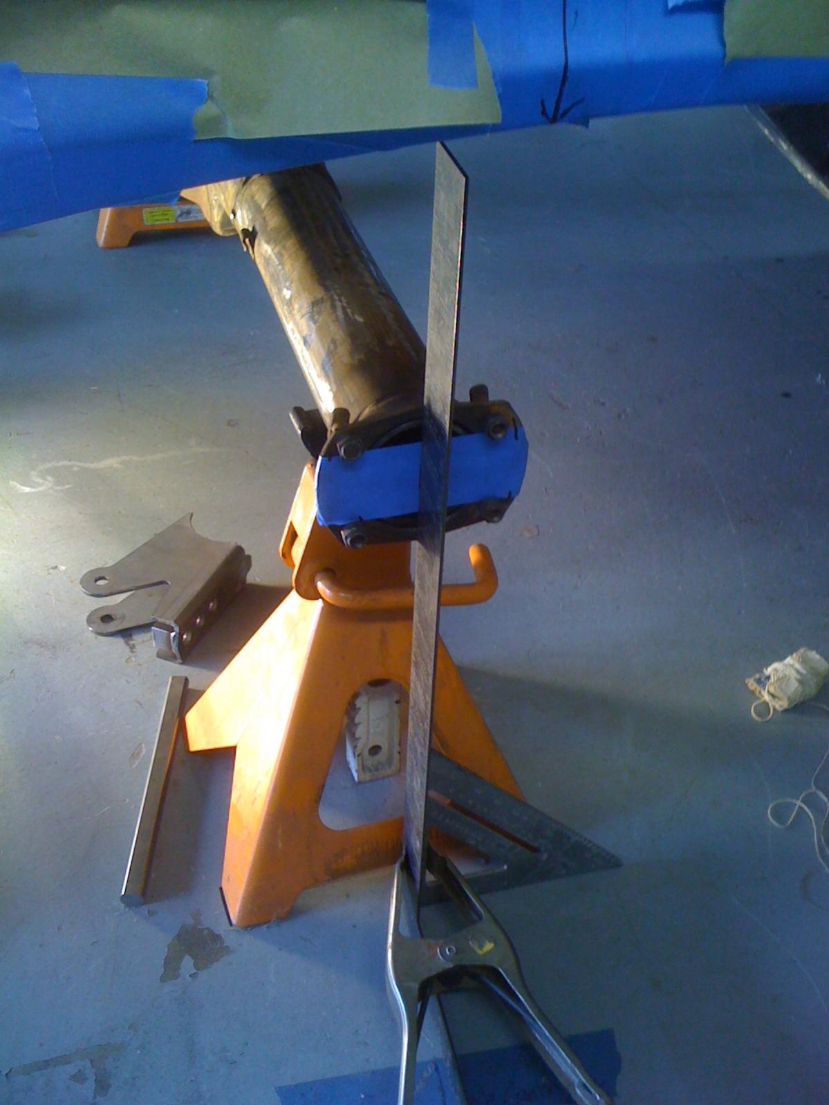

    Total Performance
    from Nor Cal

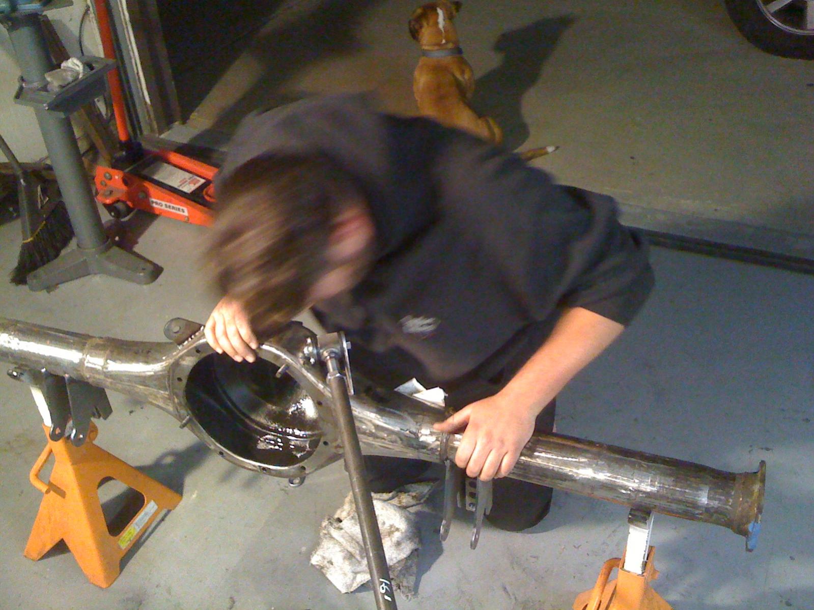

    We got the brackets rough welded to the rear end and now Matt making sure the bars fit properly and the heat didnt mess up our measurements. Note the tabs on the top of the axle are mounted one facing front and one facing rear to help stabilize the load on the arms a well as ease movement. We welded the lower mounts and the upper mounts in stages about 3/4 inch at a time so we could avoid as much warpage as possible. Even then the remaining oil in the housing was smoking us out of the shop as it got hot. Thats why Matt is at by the door. Clean this better than Blake and I did and save your lungs.
    Also when your setting up your housing in the car make sure to set it at ride and your pinion is correct for your build, once you have that then tack on your brackets at 90 degrees floor. This way your shocks/coil overs/air ride will travel correctly, straight up and down.
