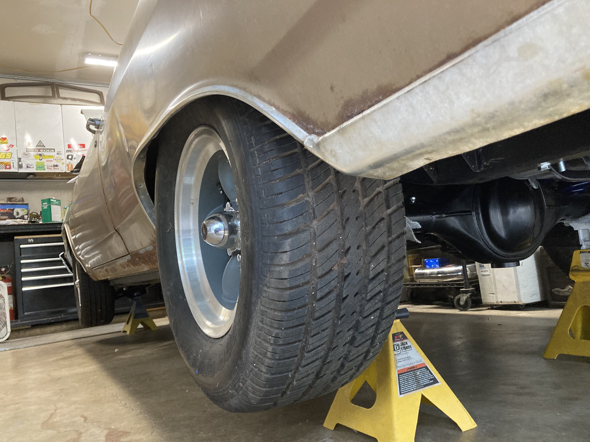

    15x8 with a 275/60. The outside currently rubs the wheel tub but however I end up doing it, the rear end will be narrower to make them fit.

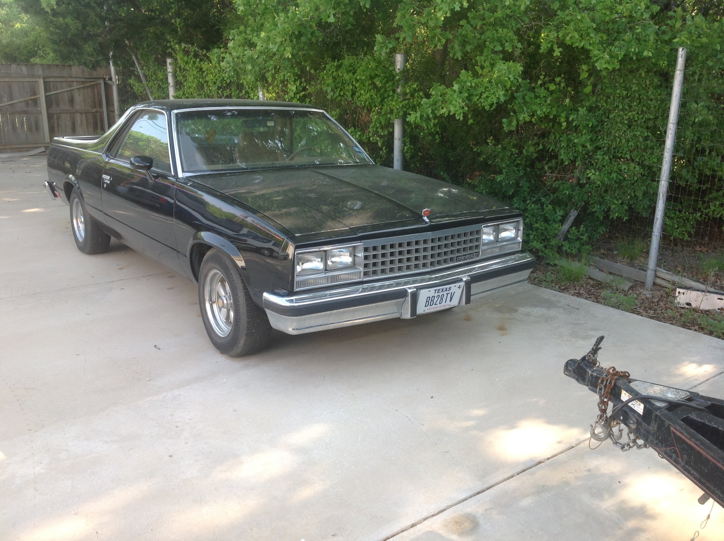

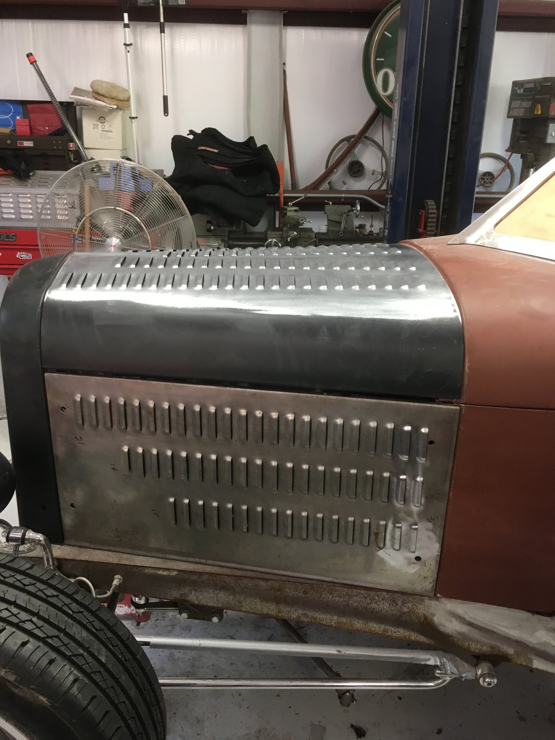

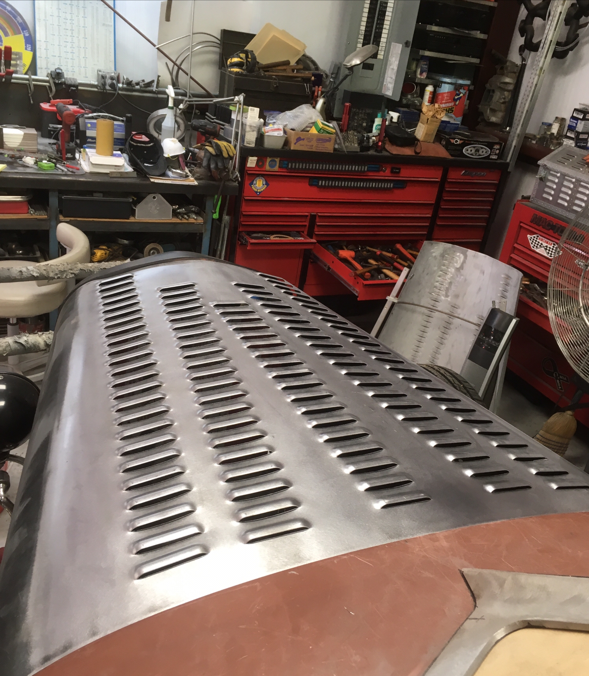

    I have a 29 roadster I am finishing up and a 80 ElCamino SS with factory 4 speed and a 410 small block. I did my own louvers.

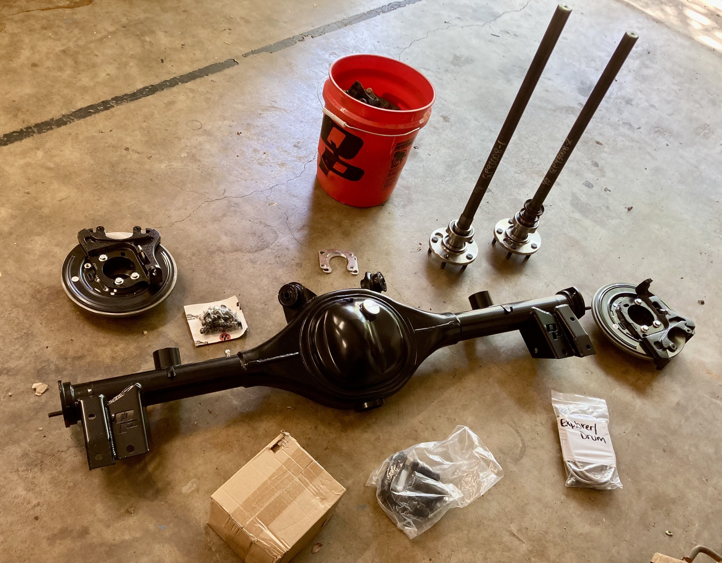

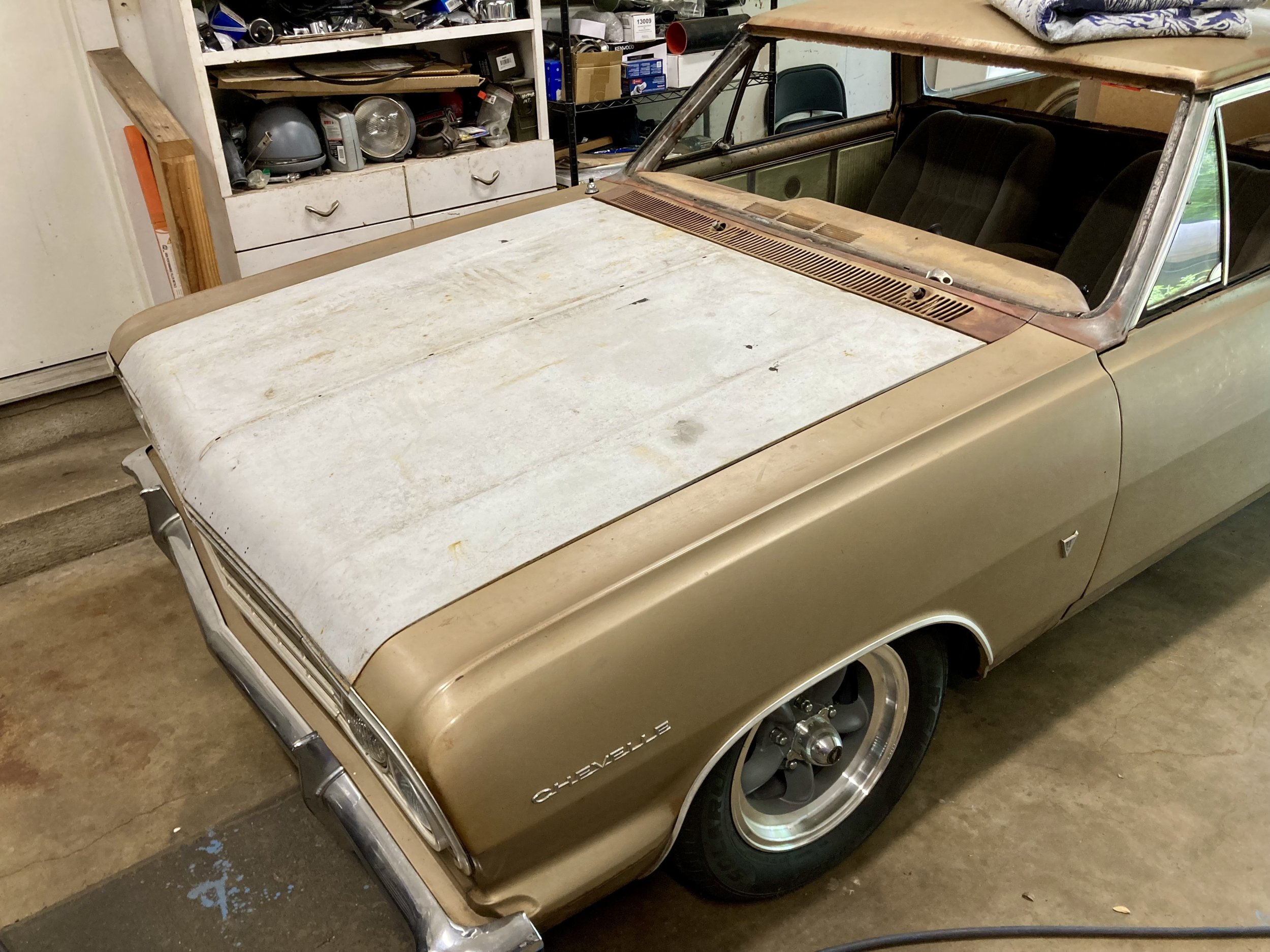

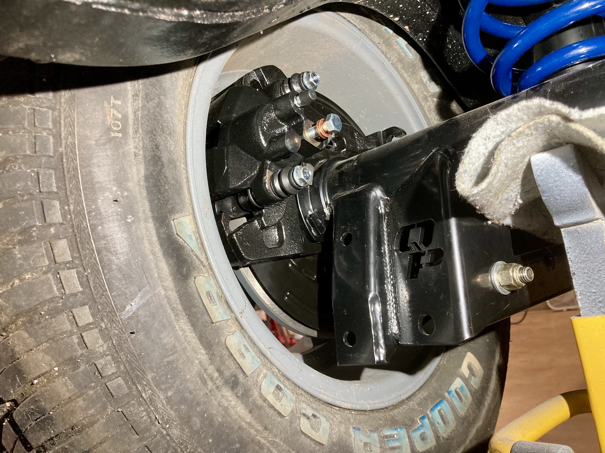

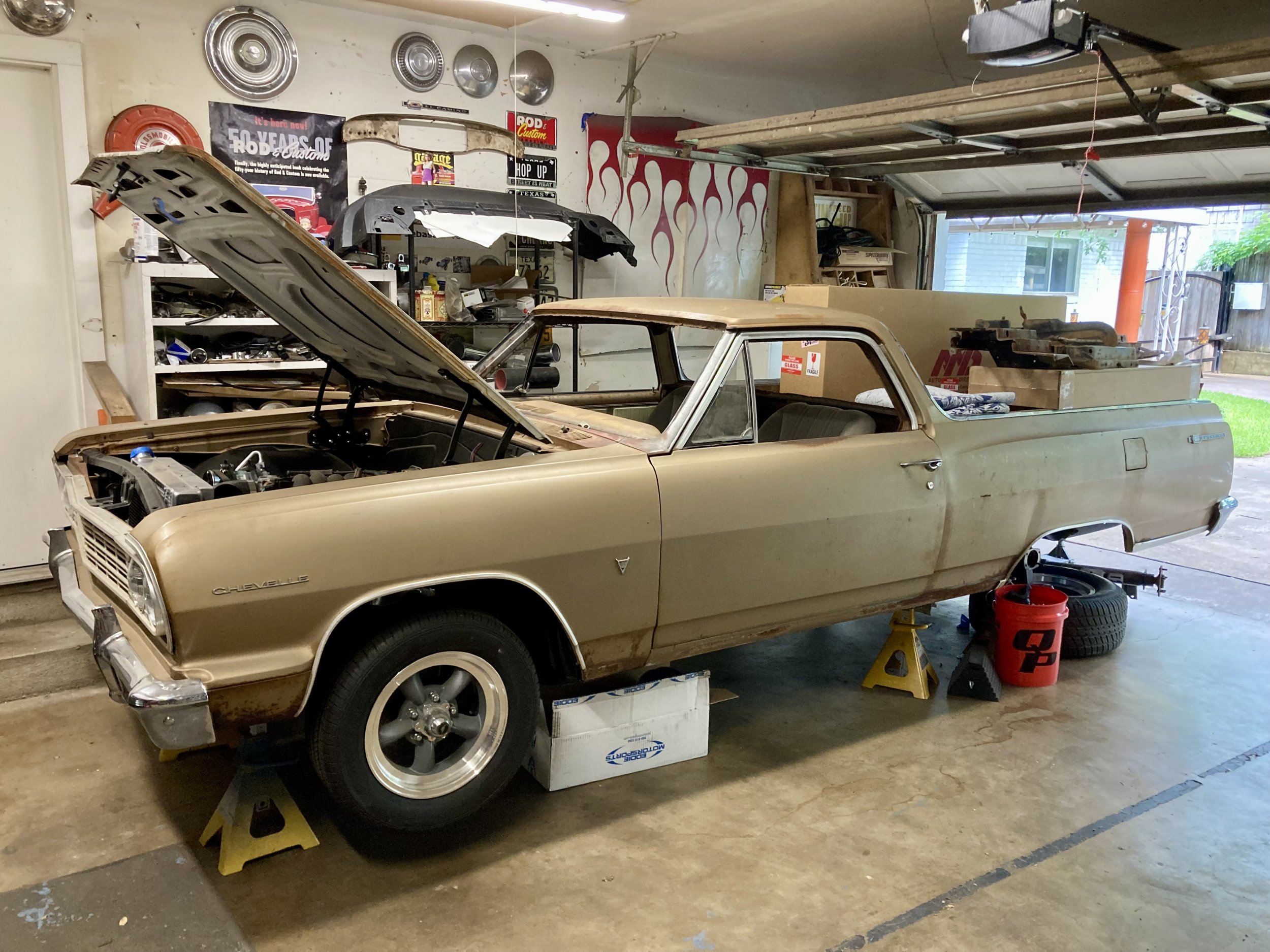

    It took about 8 weeks for the rear end to show up, but I did have them make it a custom width and powdercoat it for me. I was in no hurry either. They shipped the brakes within a couple days of ordering…third member showed up about a week later, then the axles shortly after that. Finally the housing this week. Looks great…and almost fits. The angle on the upper 4-link mounts is a bit off. I’ll probably end up modifying the UMI adjustable upper links to correct. Or maybe just swap the upper bushings out for swivel joints. And the lower coil-over brackets that fit the original rear end don’t fit this one because of the lower control arm bracket they make and use. But I really didn’t like those C/O brackets anyway, so I’m looking for a better option.

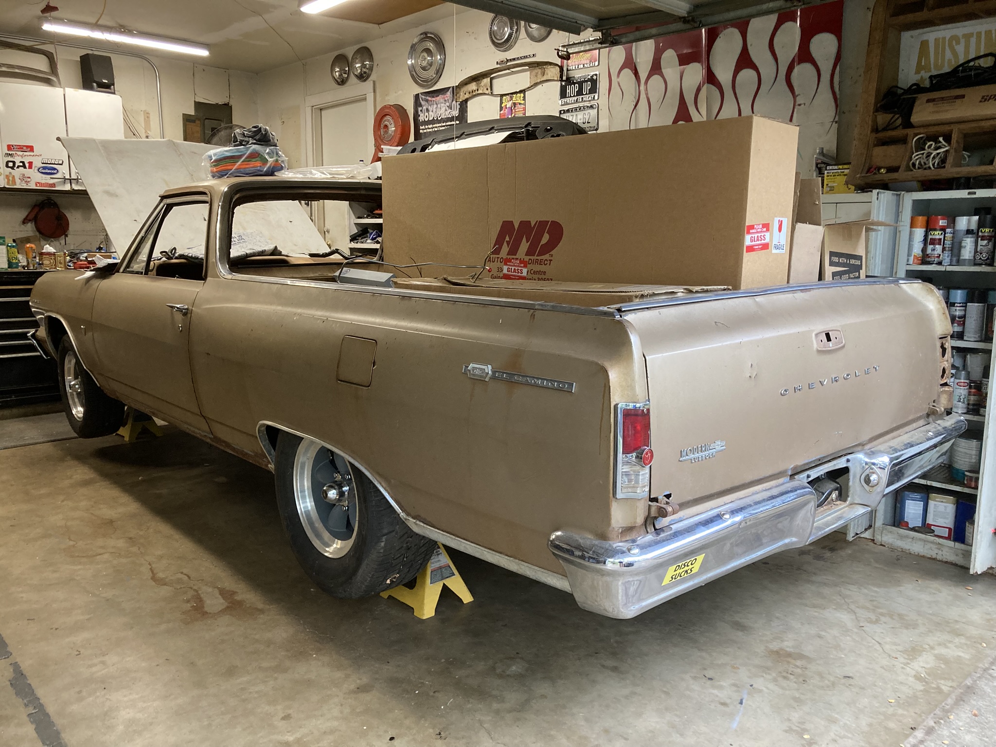

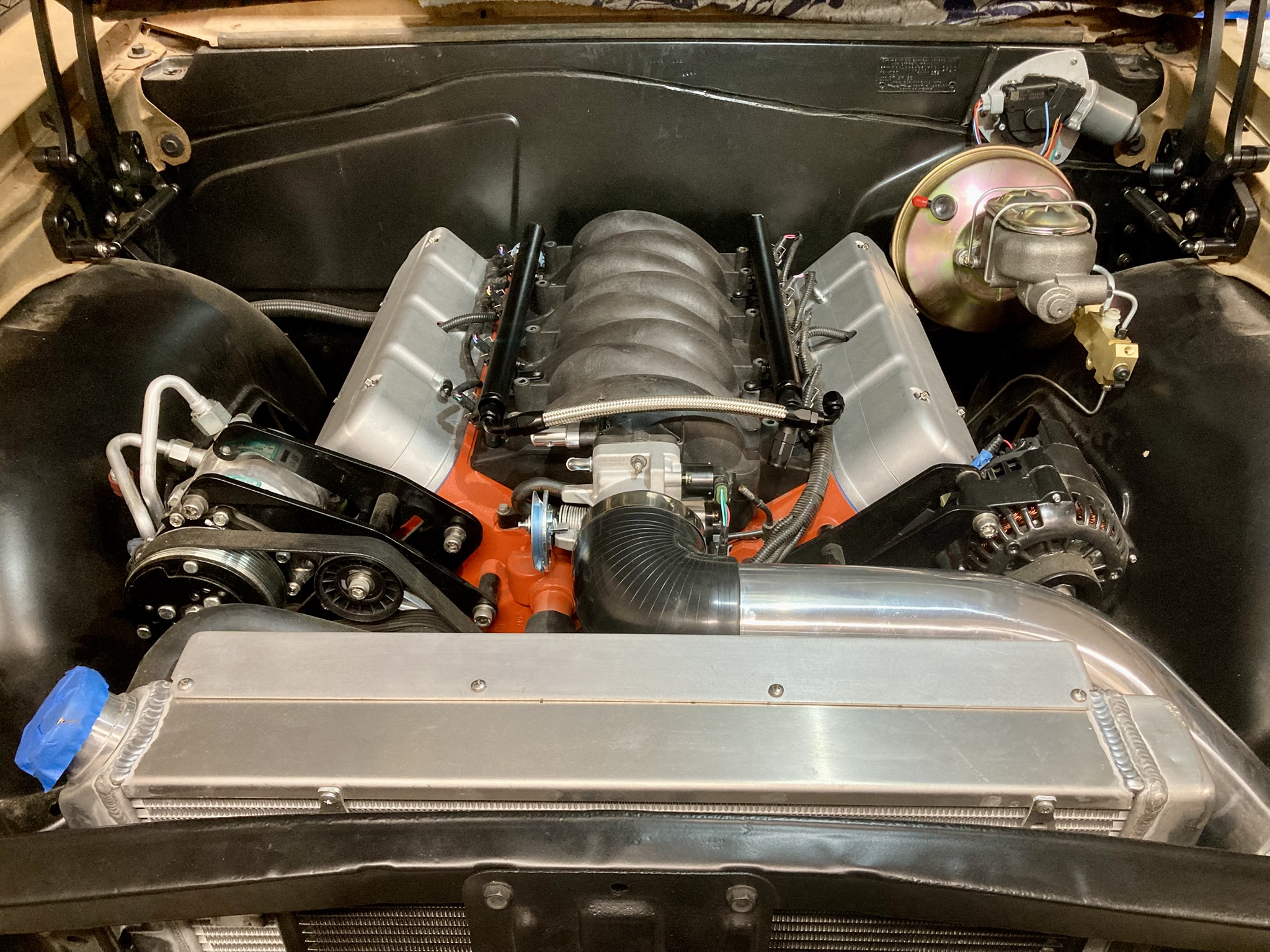

    Also got my hood mounted. The hood is pretty bad, the skin is warped and wavy like it was in a fire. It’ll do for now because ‘64 hoods in this area seem very hard to come by as I’ve been looking for a nicer one for the better part of 2 years. I also opted for Eddie Motorsport billet hinges with struts I picked up for a pretty good deal on eBay. I’ve had bad luck with stock ‘64 hinges weakening and the arms collapsing inward when closing. ‘64 was a one year only hinge too I believe, they must have beefed them up for ‘65. I had to cut a hole in part of the inner hood structure to clear the radiator cap…odd since this radiator is made to be a bolt in, and there’s no way for it to be lower. Not a big deal though.

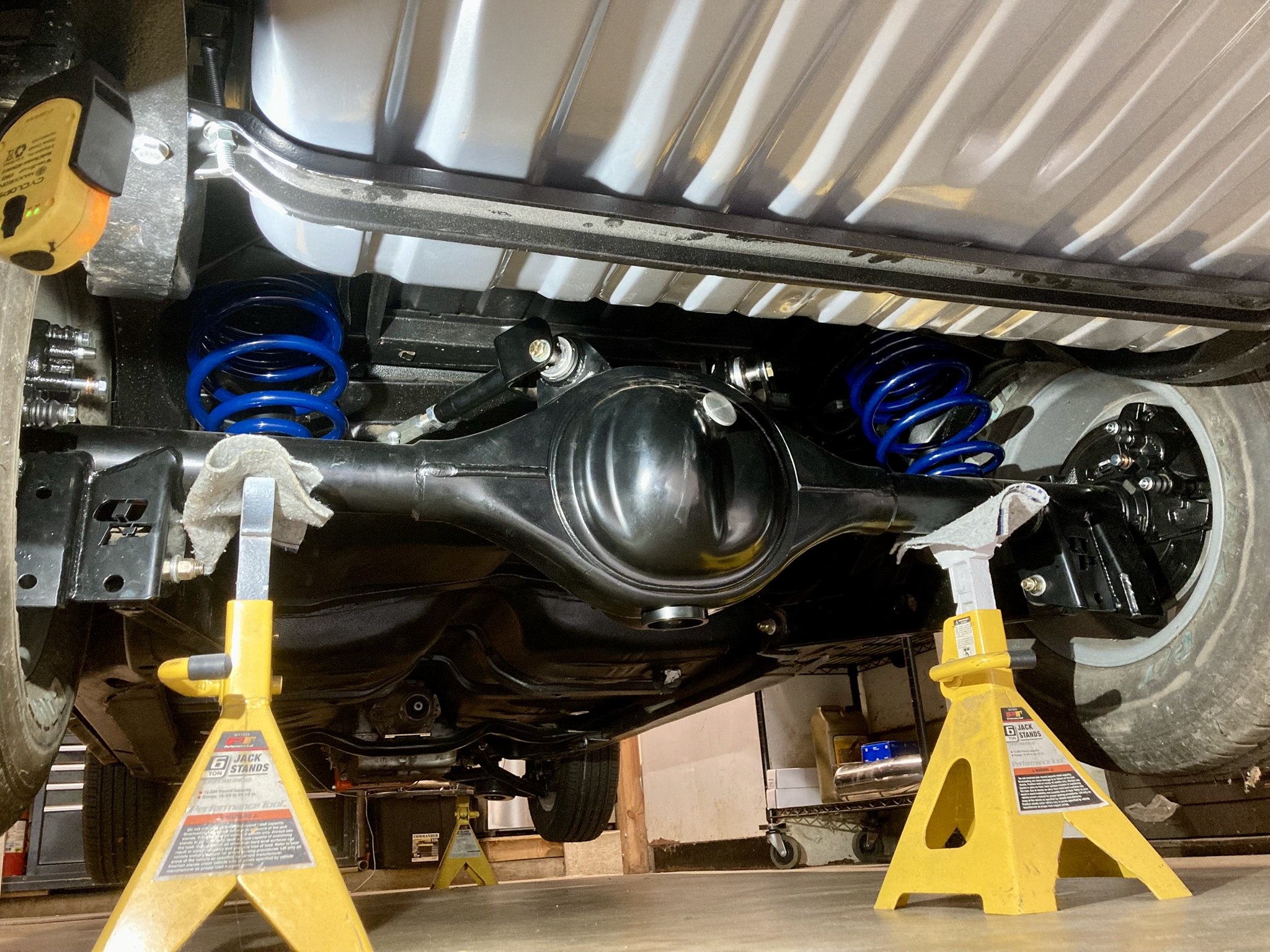

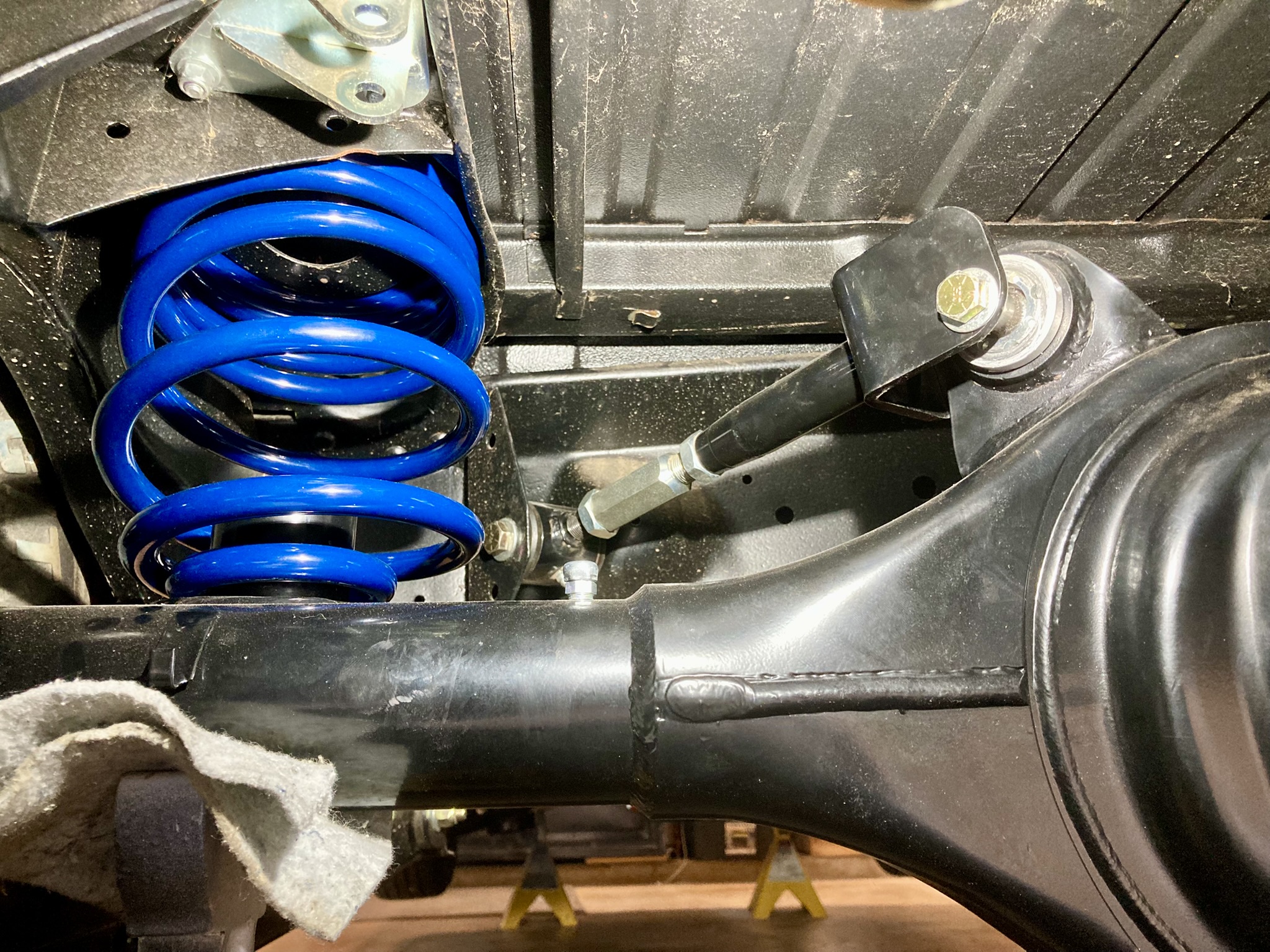

    Nearly 5 months later...finally got the rear end in. Switched the stock rubber bushings on the housing for swivel joints to work around the bracket misalignment. ****-canned the coilovers for some Detroit Speed lowering springs and will use the adjustable coil overs (minus springs) for shocks. Got some under-hood stuff done and am closing in on ch***is plumbing.

  22. BigJoeArt
    Joined: Dec 12, 2011
    Posts: 991
    BigJoeArt
    Hell yeah! glad to see it moving again!
    Looks like you starting working on yours again about the time I paused work on my wagon.
    are you gonna paint the hood to match?

    Image 9-18-22 at 11.16 AM.jpeg James did wonders with my old ElCamino after I sold it to him as a stocker
    Deuces, enloe, loudbang and 2 others like this.
  24. Anderson
    Joined: Jan 27, 2003
    Posts: 7,558
    Anderson
    Eventually. It's a lot more wavy than I realized when I bought it so I'm hoping to find a nicer one. I need to paint the a-pillars too and a few other spots. Somewhere I have a quart of that gold but I've seemed to have misplaced it since I bought it a couple years ago.
