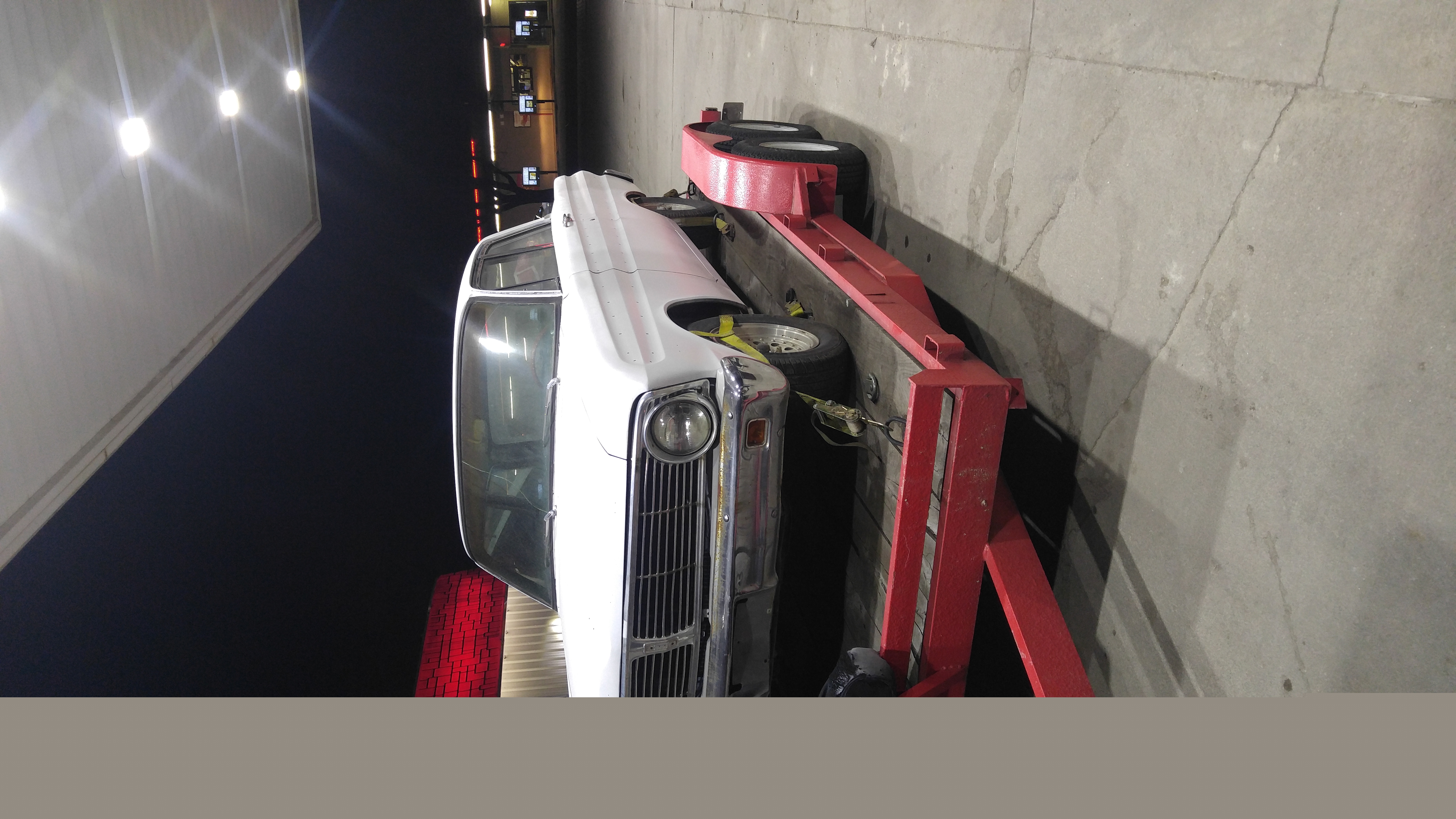

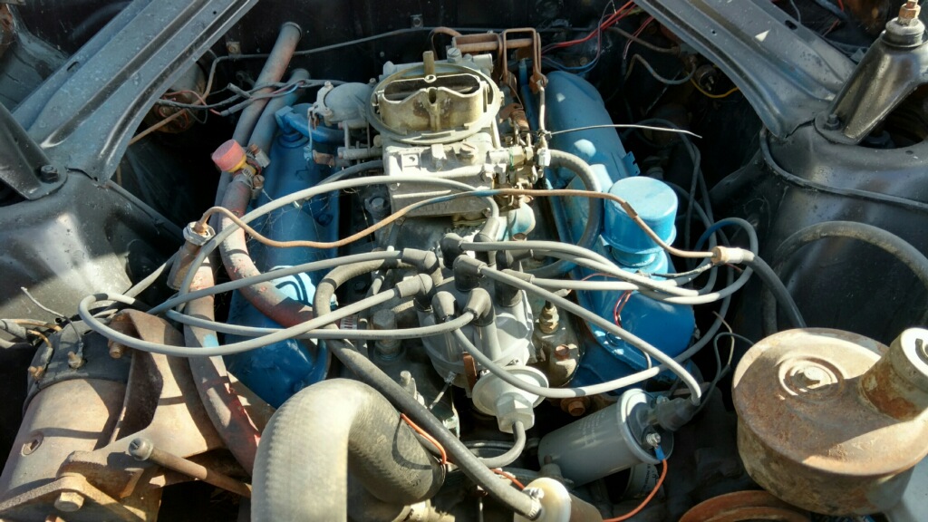

    hello all it has been a few years since i have been on here because i had sold my car. but i now have another 64 falcon 2 door futura. it currently has a 260 and cruise-o-matic in it with an 8 inch 325 gear.
    But i am wanting to go the extreme side with the build of this car. I am looking at either doing a coyote engine or a supercharged 5.4 out of a lightning. with that being said im going to need stiffen up the car. with what all im wanting to do it brings up a few issues. In order to fit either engine in the car i will have to get rid of the shock towers which makes me think of trying to kill 2 birds with 1 stone.
    The easy solution is to put a mustang 2 front end under it but im thinking about trying to make a crown vic front end fit which is where the 2 birds thing fits in. If I use the crown vic i can use the whole frame and just shorten it to fit under the car. so i will have the nicer newer suspension, four link rear end, and the rigidity of a full frame car. and have 4 wheel disc brakes.
    What I am wondering is if any one has done anything like this to a falcon and will my idea work? i am going to go take some measurements off of a vic frame later this week. i do know that i always have the option of making my own frame for it but i dont feel that my skill set is good enough for that part of it. If anyone has had any experience with this or has any suggestions or as another idea for this please feel free to chime in.
    Thank you
    Millz 64
    p.s. I included some pics just because
