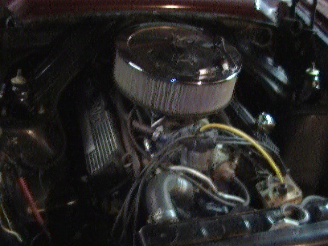

    Pics are of 351 in lyrics 072.jpg Moms camera, steves car 084.jpg my 64 Falcon.

    Oh ok I must have misread. Just out of curiosity did you run a spacer between the carb and intake? Any steering issues? Nice Falcon by the way!
    Thanks,
    Mark
  18. speedracer6
    Joined: Mar 3, 2006
    Posts: 38
    speedracer6
    from w pa
    No spacer, Edelbrock Performer with 750 Holley. Hood scoop is from when i had tunnel ram on a 289. Steering is 65 Falcon linkage with original 6cyl box, Granada spindles. Have some bumpsteer issues because of the spindles. Stock front suspension with dropped upper a arms. Tired v-8 springs, no sway bar. Front end alignment was real pain, can't get at upper control arm bolts with headers installed.
